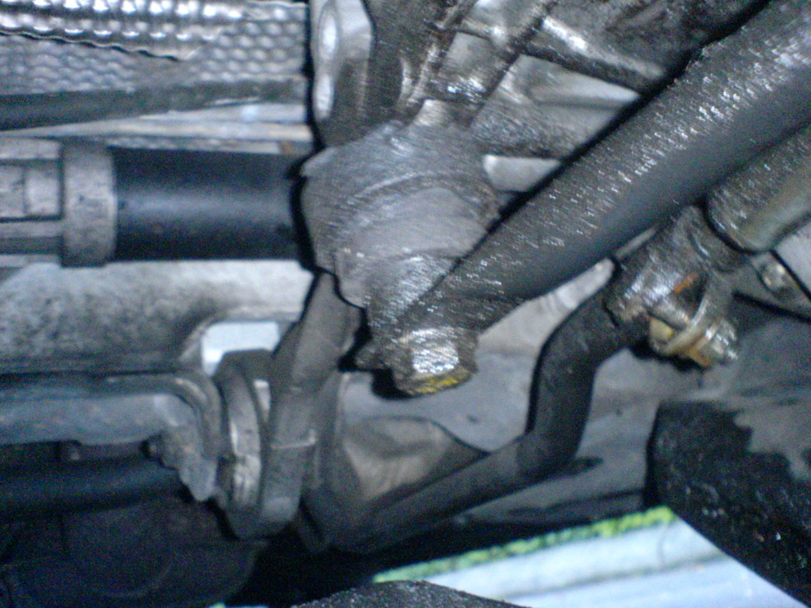

Can someone just confirm for me that
a) the thing in the picture is a dogbone (at the back of the pic)
and
b) its a twisted one.
It looks like a twisted dogbone to me but thought I better confirm before ordering a few bits.
Big Iain said:
yes it is
dont bother with the k-tec bushes imo
How come ?
Alan, thats pretty bent.. maybe mine is defective.. dont think they are mean to be AS bent as that..
lol.. i was joking
Gonna order the ktec dogbone mount, i know it can give you a bit more vibration at idle.. but it should be worth it.

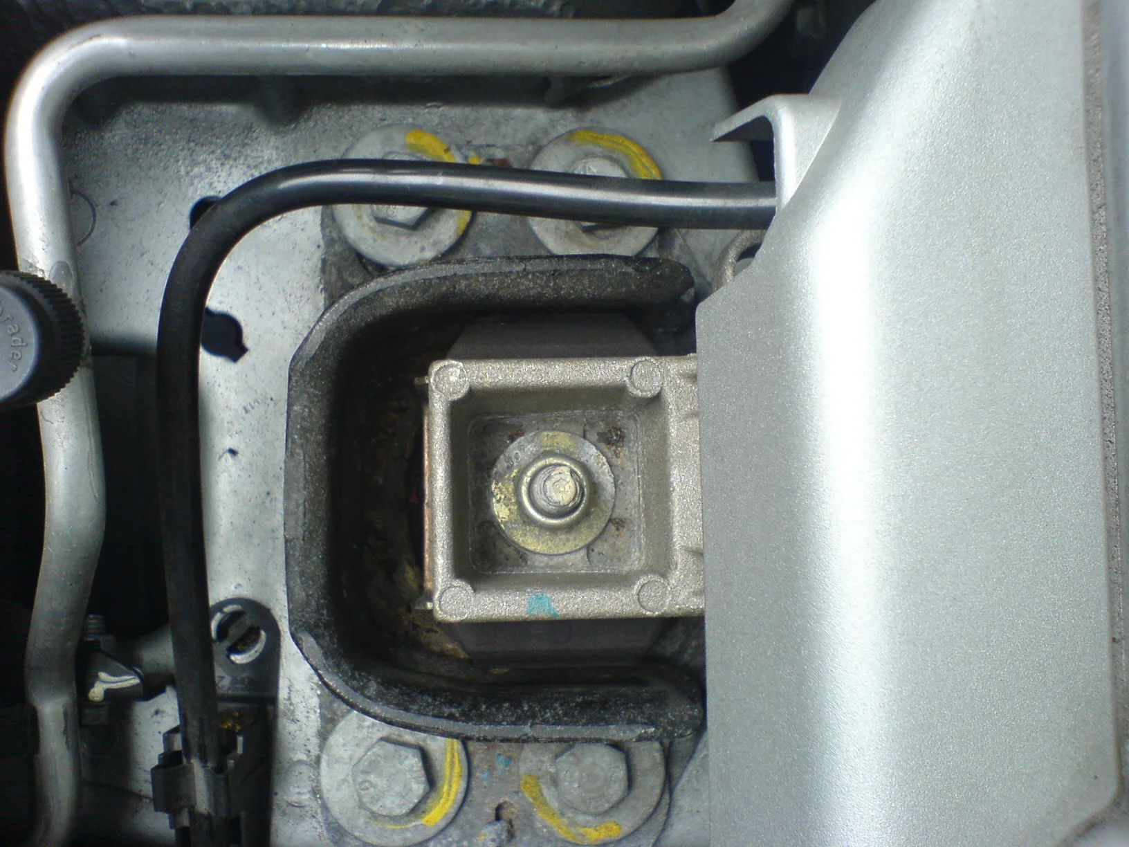

My drivers side top mount... look worn ?
well ive have the ktec ones. Been fitted for over a year, and my car has done 62 thou, no problems, a little vibration on idle though
cant tell from the pic but there does look like a bit of a gap at the bottom side, I replaced mine but im gonna have to do the gearbox mount aswell I think. anyone want a 172?
are you changine the dog bone due to the knocking/banging in 1st?
imo you are better adjusting the drivers side mount, slacken it off, 'pull' the engine as far forward as you can, then whilst the engine is still in this position, re-do up the mount, that should work
my car was fine untill it had the cambelt done last year. (drivers side moun needs to come off/apart) So got my mate who works for renault to adjust the drivers mount as said above, and press in the ktec bushes, i get NO knocking at all, and it gets raped pretty much daily
