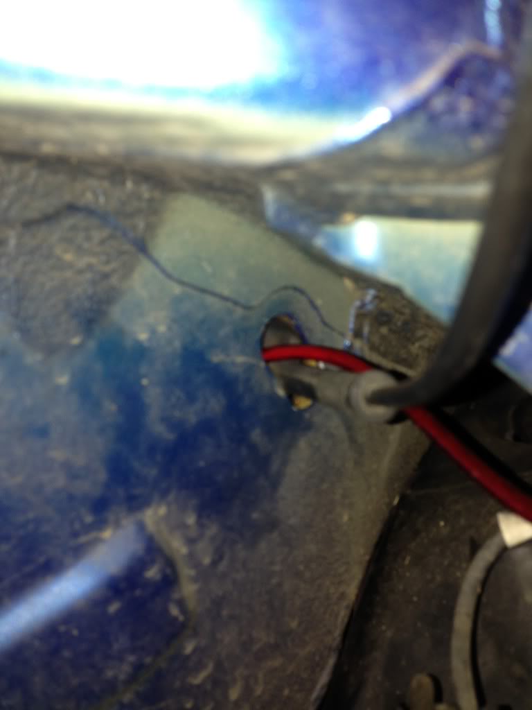

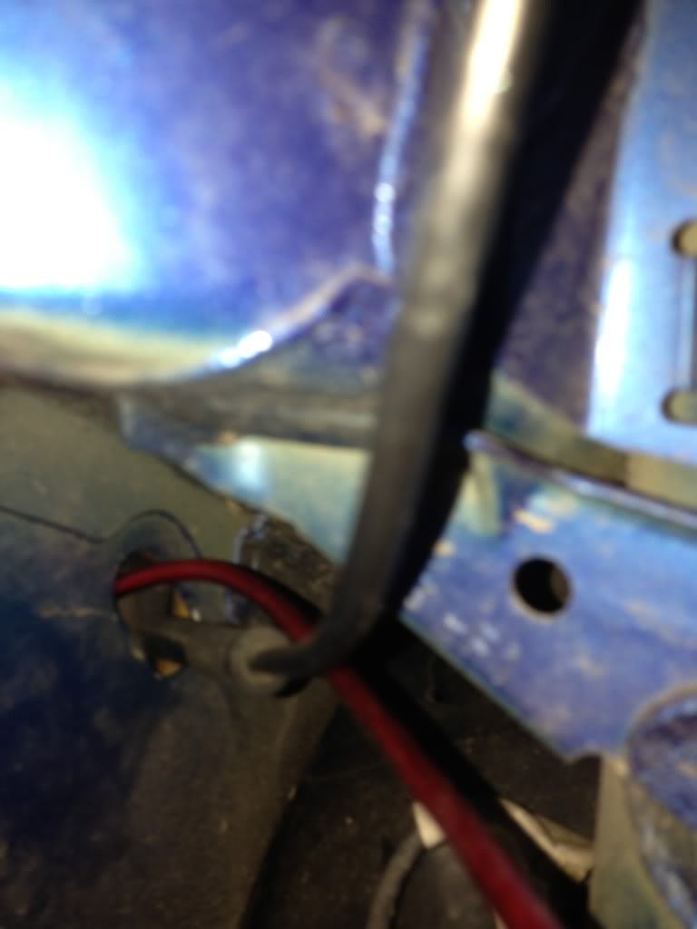

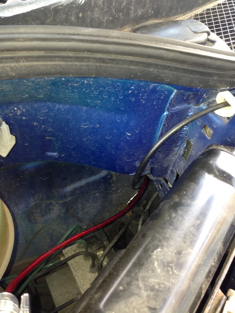

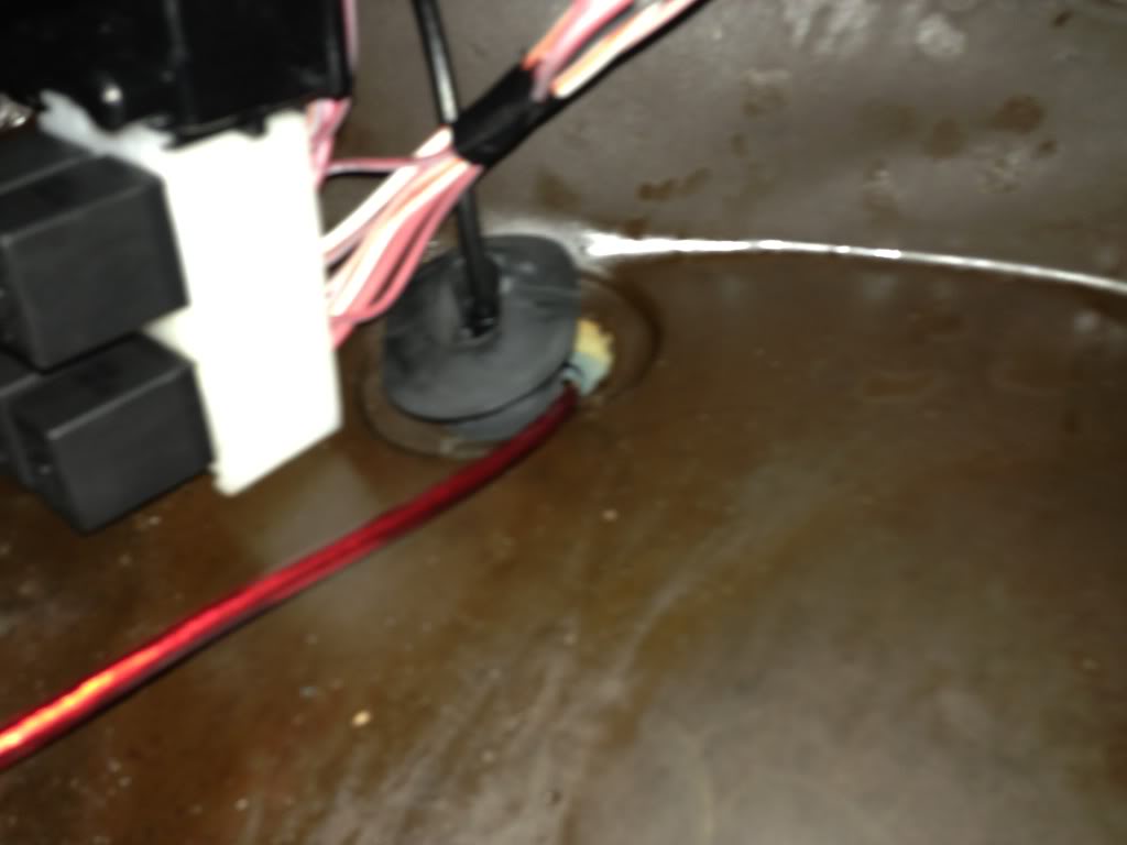

I've got a mk2 05 plate clio 1.2 16v and I'm trying to find a place to thread the power cable through from the passenger side to the engine bay, does anyone know where there is one?
Pull up the carpet in the foot well and then follow the relapse cable from the handle that opens the bonnet that cable goes through the firewall and u can put your power wire through there also
