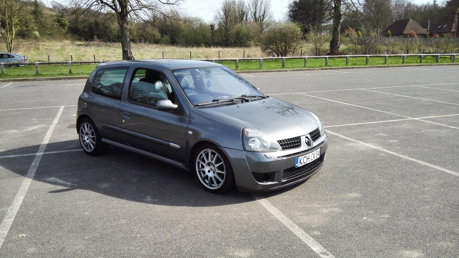

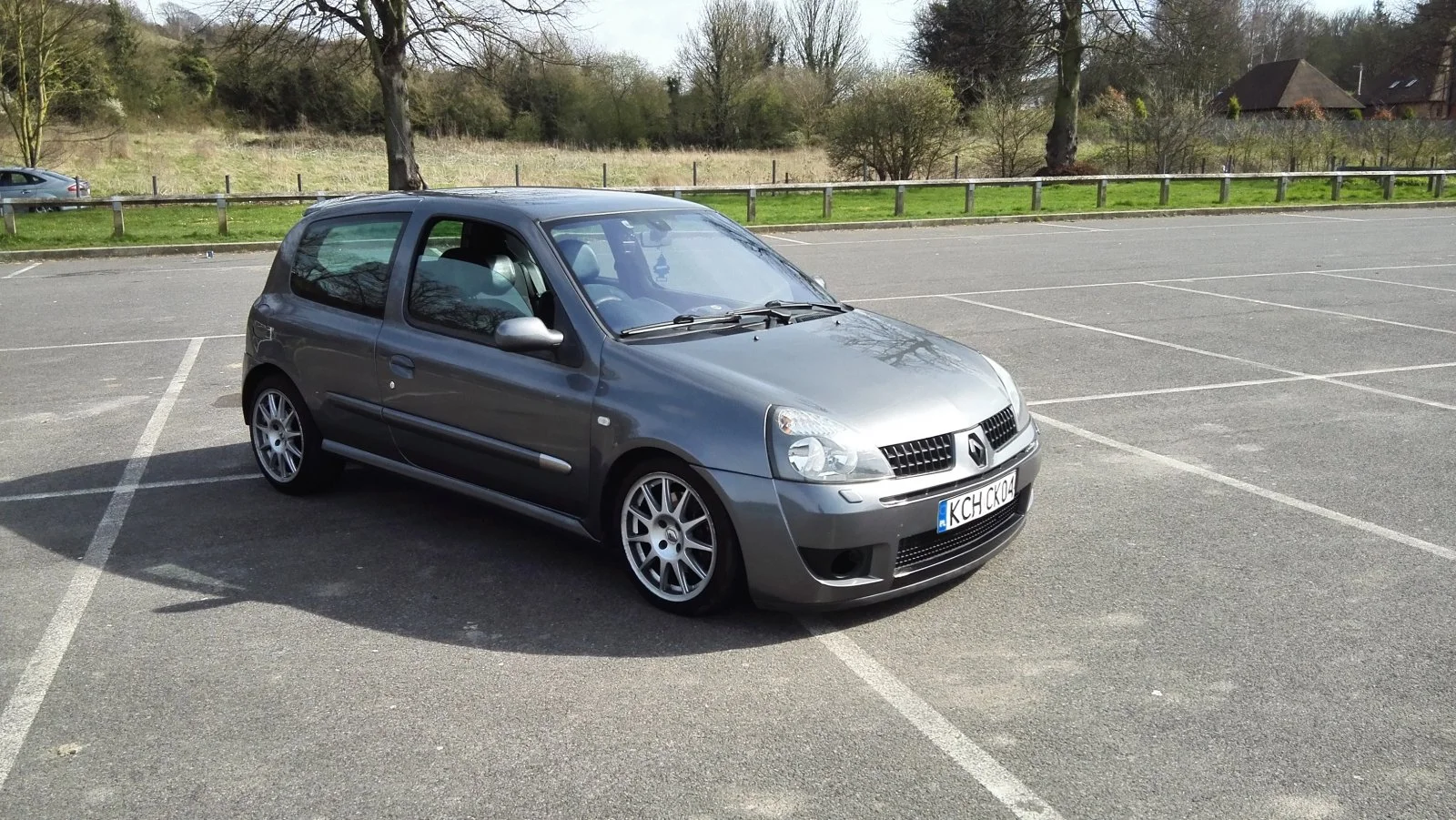

Just a small update, and a review on what i can only say total transformation to the car.
The Brembo 2000 pads combined with the Brembo Discs and the Removal of ABS with the Bias Valve along side the PF665 Fluid has made the car now wheel some what safe when breaking no longer does it float at the back end...
The breaks had only done 5000 miles, and when i serviced them this time the front carriers had stuck, so that may well have been part of the issue.
Cup Shocks and Eibacjh springs at the back, well what can i say how the hell did i ever live with the Vmaxx i do not know!! what a pleasure to drive.

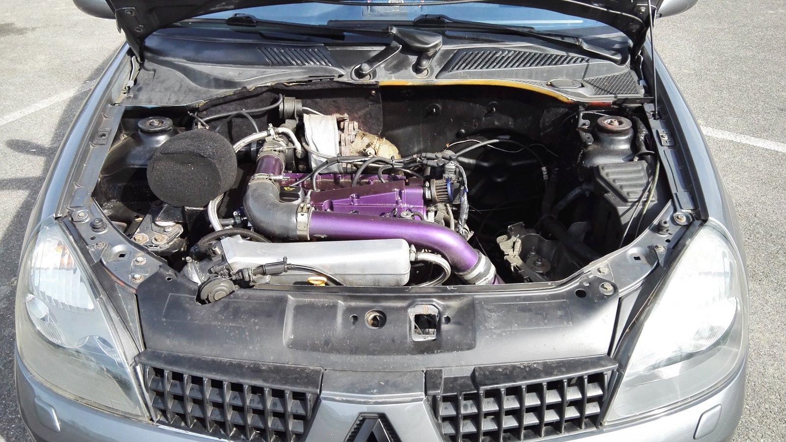

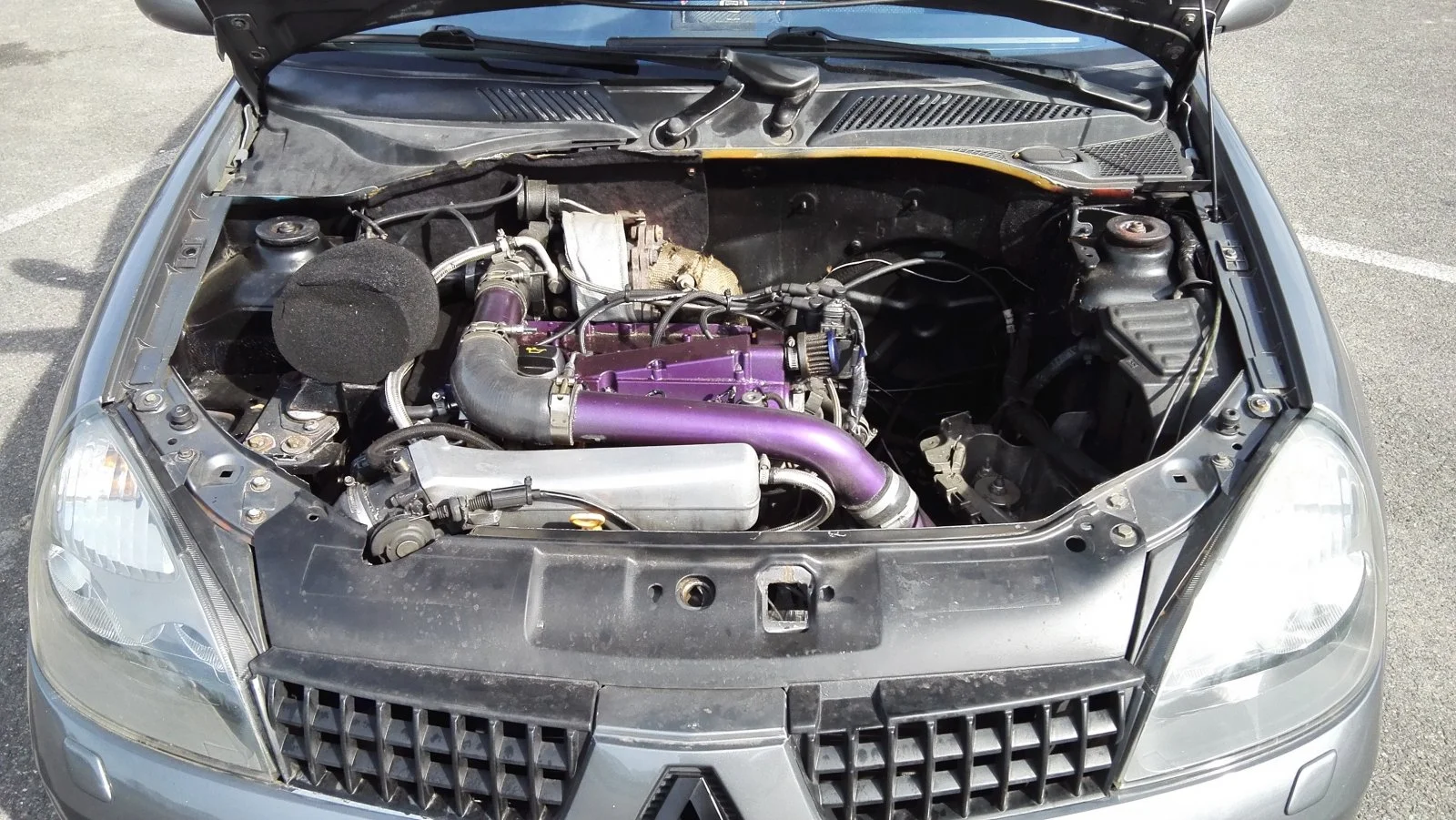

Boost been turned down to a Small .8Bar until i can get the mapping sorted after the "ring" it feel so slow its unreal!!

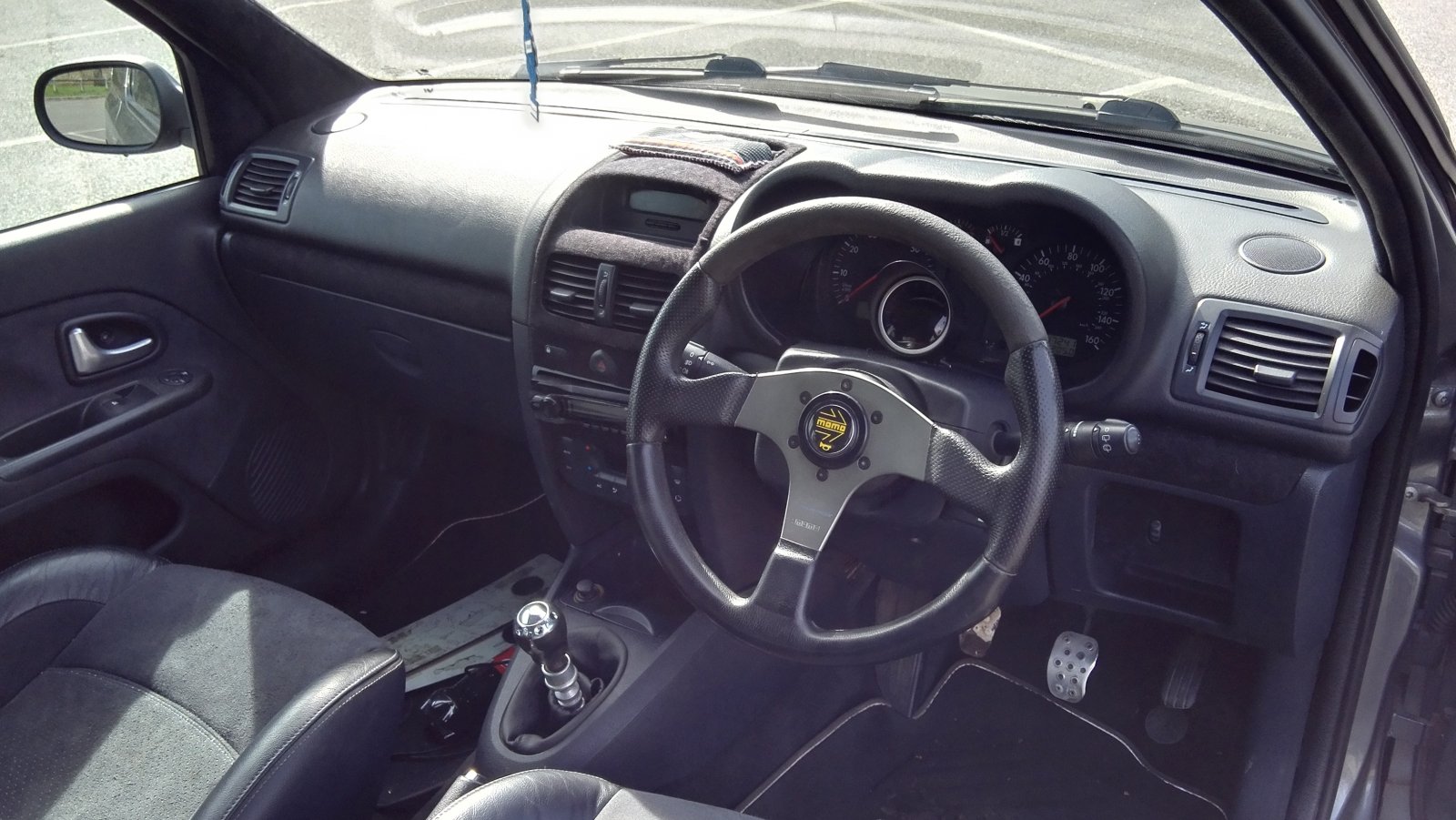

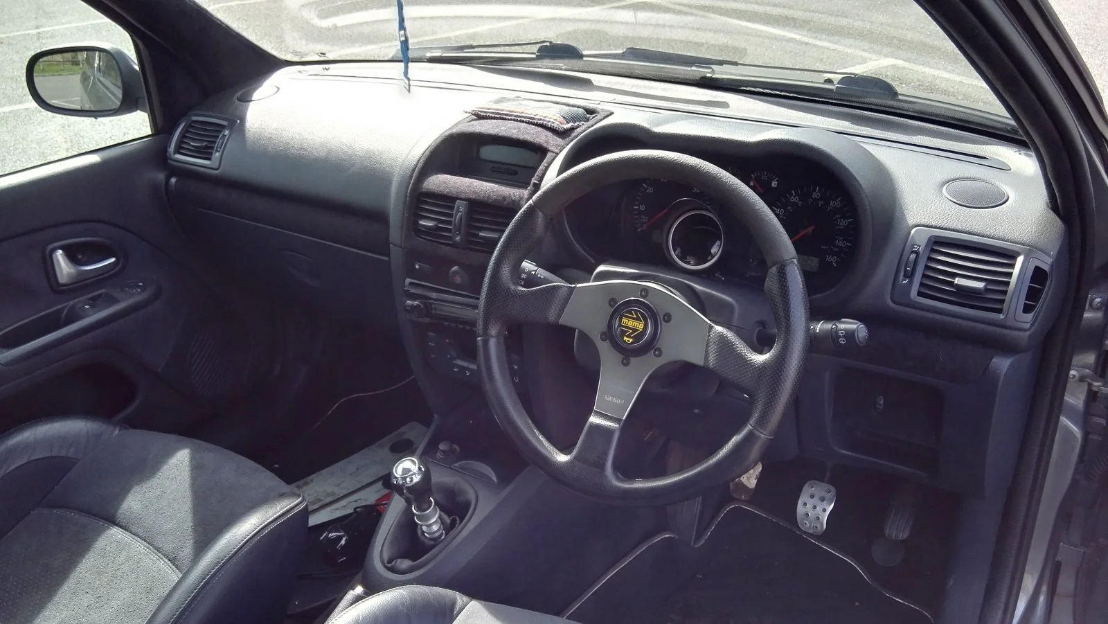

Next to do is the interior tidy ups and then mapping
Photos of a large scale tonight
