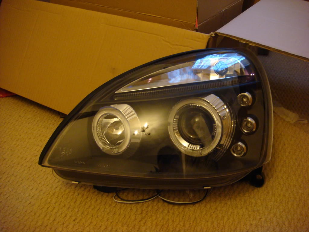

today i purchased as set of black angel eyes.. not to everyones taste but thats not what this is thread about.

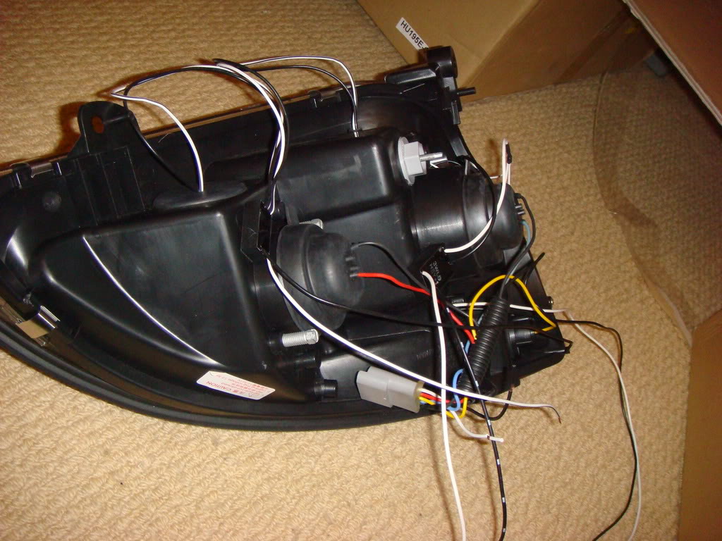

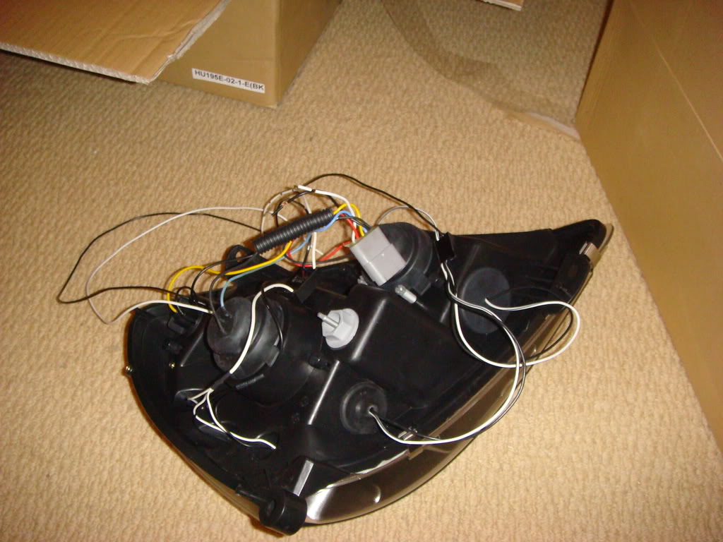

i removed the bumper and lights and took the angel eyes out, i thought it would be an easy job, but there are black and white wires scrambled all over the place... :S
The main lights are assorted into one main plug. but the the black and white wires, presuming these are for the angel eyes and sidelights have all got different markings.... can anyone whos experienced how to fit these angels guide me please :dapprove:
these are the angels
back views

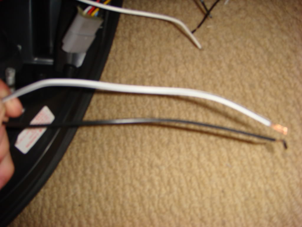

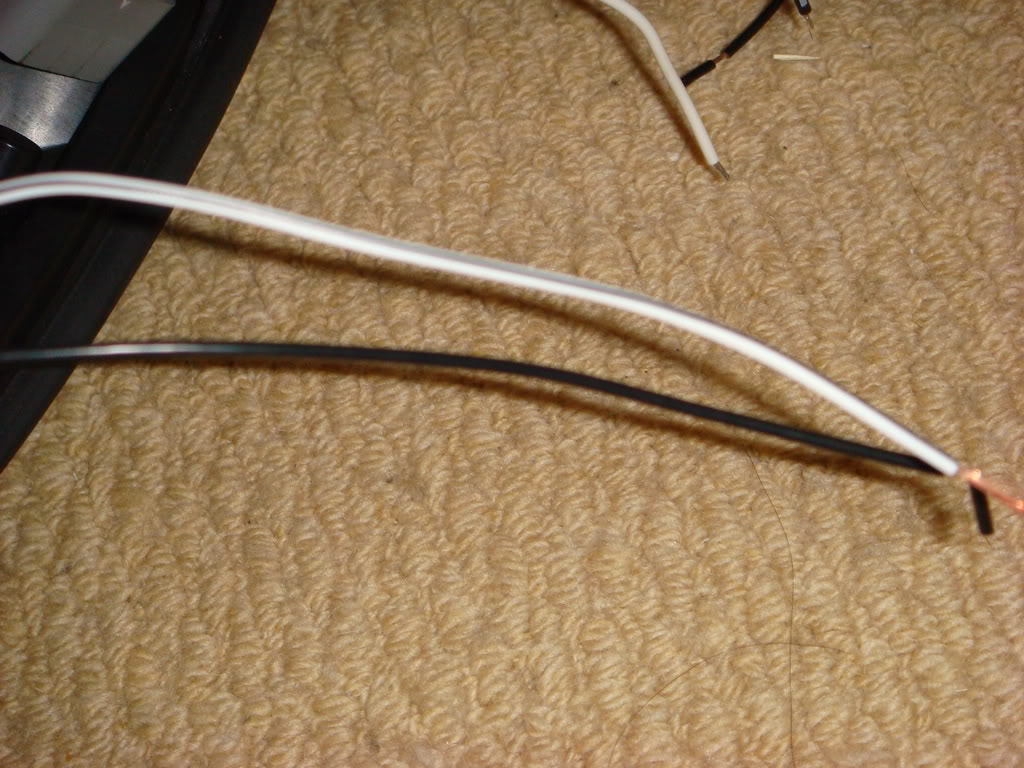

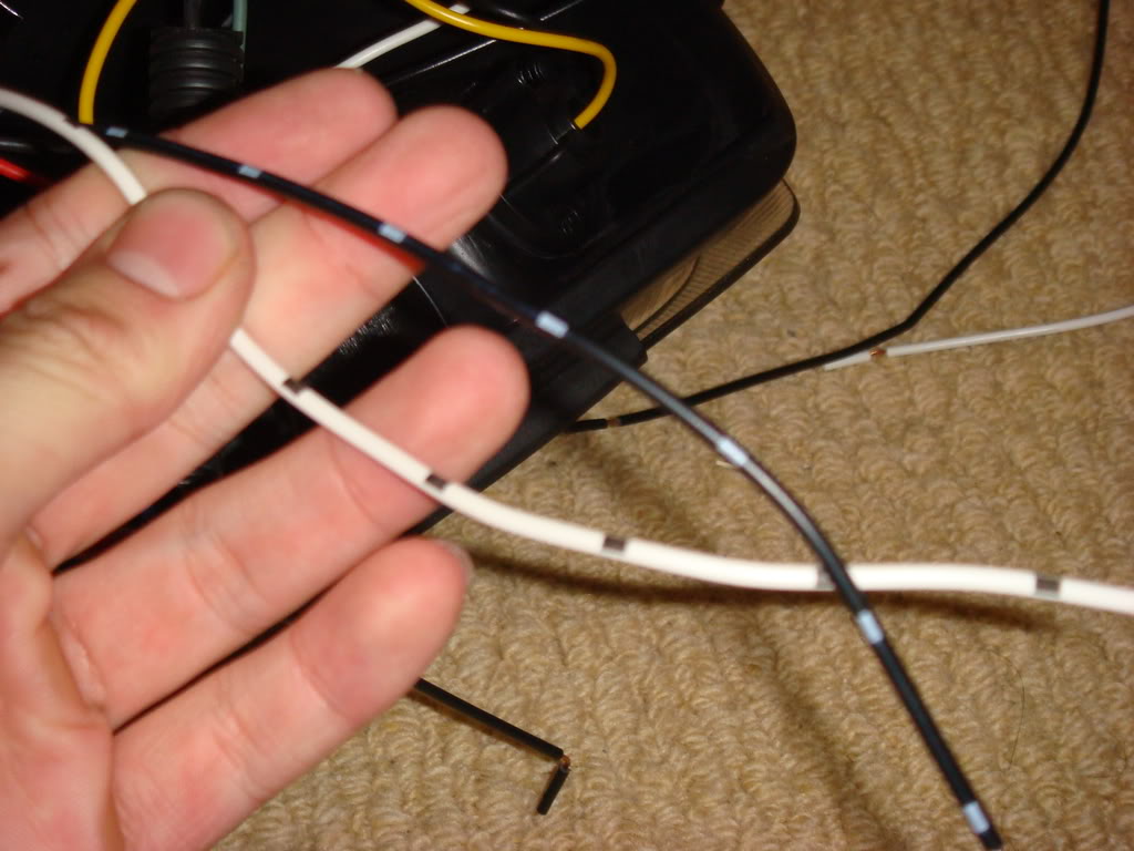

dashed black and white wires
white wire has a black line through it
normal plain black and white
any help to this would be GREATLY appreciated.. thanks joe

have you tried just plugging the main plug in and see what happens
Right well the main plug looks complete, so as said above plug it in and try it out.
As for the white and black cables, they appear to be the +ve and -ve cables to the LED's that are mounted in a line down the side of the cluster and the Halo's. I can only assume this is so you can have these on a separate switch to activate the LED's without switching the sidelights on, R8 stylee!

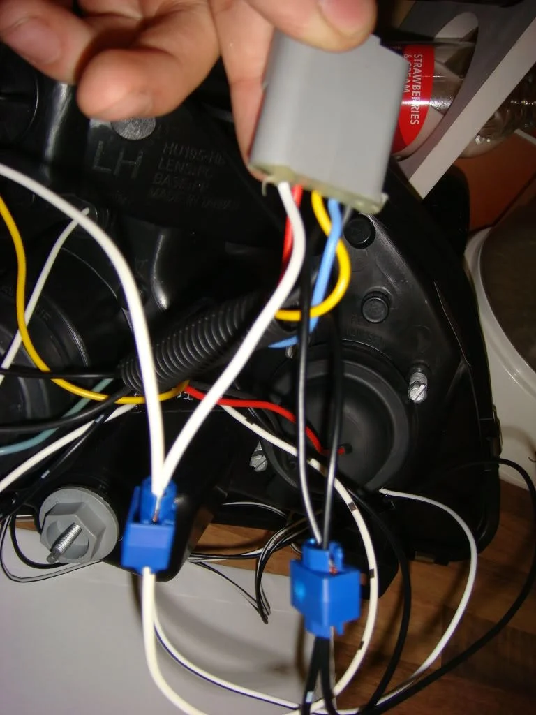

cheers guys, someone said that wire together all the black to black and white to white, the dashed symblols means which wire is which such as the the dashed ones would be the extra sidelights along the side wire them all together to the main plug.
they look like the mk3 lights to me for the phase two thats why i liked them. lol
update

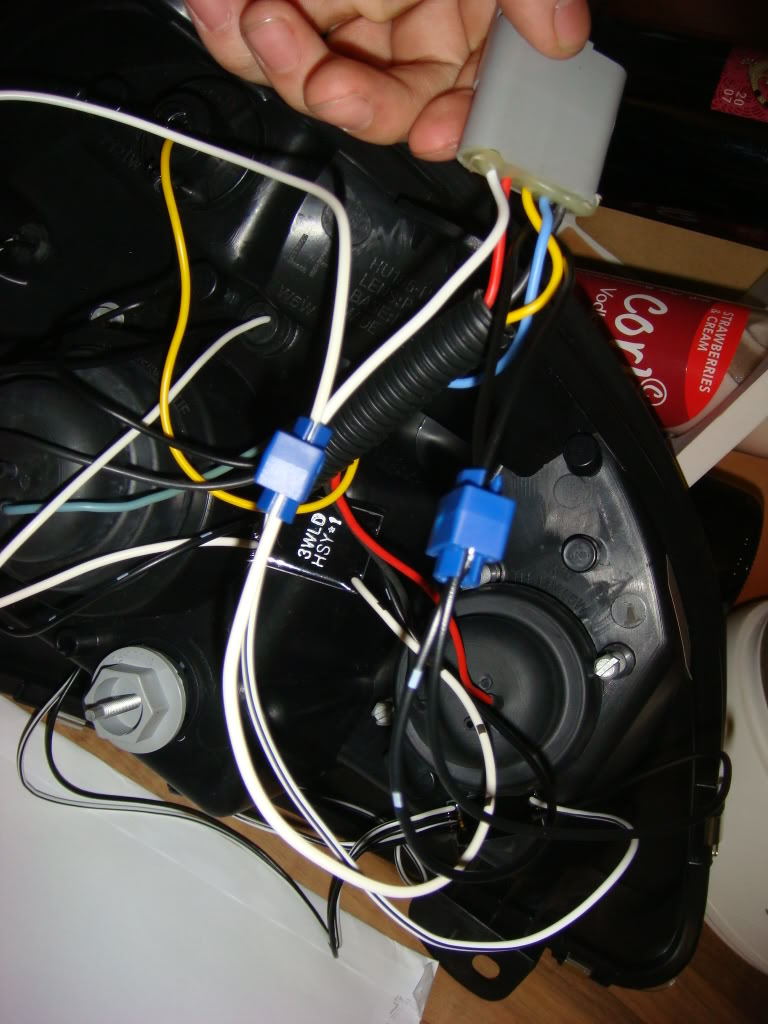

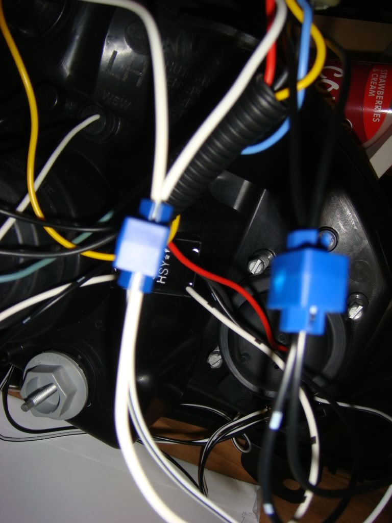

heres my configuration
correct me if ive done it wrong before you give me the go ahead.
4 wires are connected to each clamp. including the plug socket wire of course, the symboles represents which wire is which such as dash would be side lights, lines would be halos ect.
black is negative / earth
white is live
here are the pics
cheers joe
