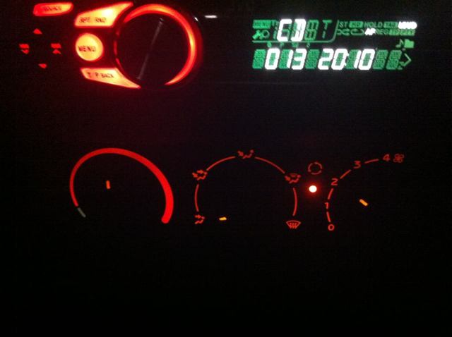

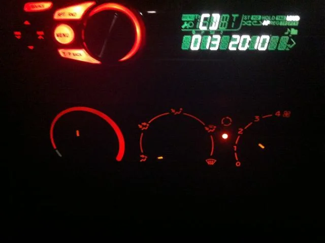

Is this the circulation button?
If so mine is stuck on and I get the same whistling noise!!!
yeah thats the circulation button. mine has climate control but i'm assuming they work the same way. when you say stuck on, does the light not turn itself off when you push it?? i done some more research and apparently the flap gets stuck... it's located under the drivers side scuttle panel...

Yeah that's the one the light never goes off lol so u reckon follow the guide and the light will go off or the button will function at least?
So, I think the problem is solved!
The recirculation button wasn't working and the flap was stuck half way. When you push the button it just kept clicking but not moving. I have pushed it open and the whistling noise is mostly gone. It is there but very faint - a noticeable improvement.
