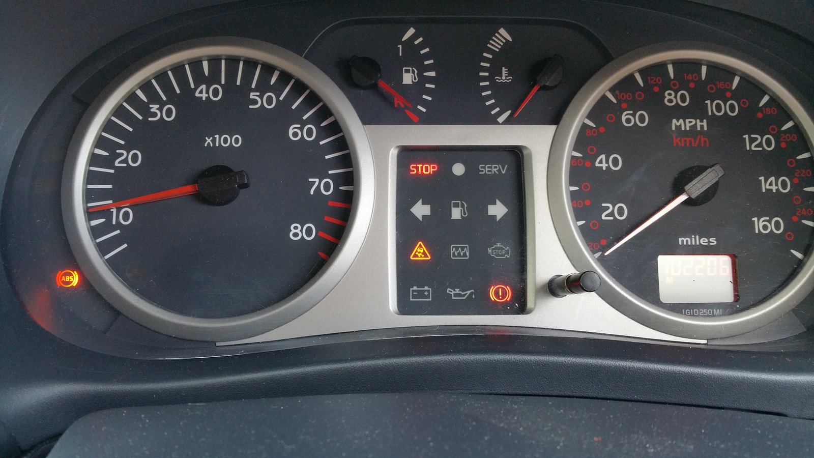

Woke up to this now (see attached) no abs and braking bias now 50/50. Getting really sick of this car now. Having a read and could be an abs sensor but not sure this would give the lights I've got and disable the abs?

Yeah first thing I tried was the fuse, no difference. Checked the harness to the abs pump as it's been changed recently and seems fine. I did find metal shards all over the front sensors after bedding in the 4 pots, maybe this has caused the issues, tried wiping them and spraying with contact cleaner but no different. Can't even pull them as the torq bolts are rounded. Gonna get the jet wash in there in a bit and pull all the connections and clean with contact cleaner.
Just when I think it's ready to go this happened and to boot my sparco 15"'s don't fit over the 4 pots which have just been rebuilt, re-sealed with skimmed discs and new pads.
Right, the car has just been hooked up to the diagnostics and in the live data within the abs system with the ignition on the nsf,osf & osr where reading 0.3 (not sure what measurement it was as I was in the passenger and it was sunny so couldn't see the lcd) the nsr was reading 0. The guy then reversed 5 yards and went forward again and the nsr went nuts and read something like 1750 the other 3 stayed at 0.3.
Gotta be the nsr abs sensor right? I've tried cleaning in with contact cleaner and a tooth brush but no different.
OK so just been for diagnostics again (no charge) and took the car for a spin this time and the readings where in km/h so wheel speed as @bloke suggested and the NSR was reading crazy like 2000 km/h when doing 30, the rest where spot on. So it's defo a duff sensor. Also managed to source the correct ATE part from ECP for £59 so all good. Just need to get the stubborn git out now, think it will have to be knocked out with a socket with the disc off.
