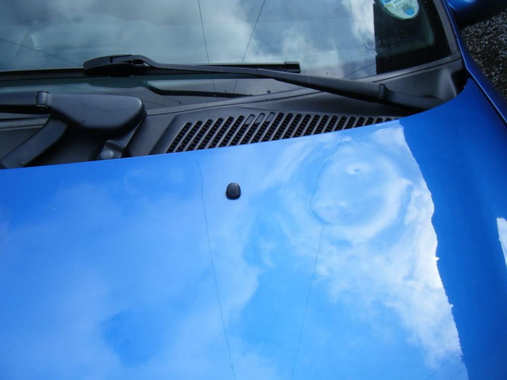

Next up for the clio is a new bonnet. unfortunately over a year ago now some drugged up little f**k started kicking off outside my old house and puched a fair dent in my bonnet, after having to look at the dent for over a year iv now decided it has to go asap.
the disfigured bonnet...

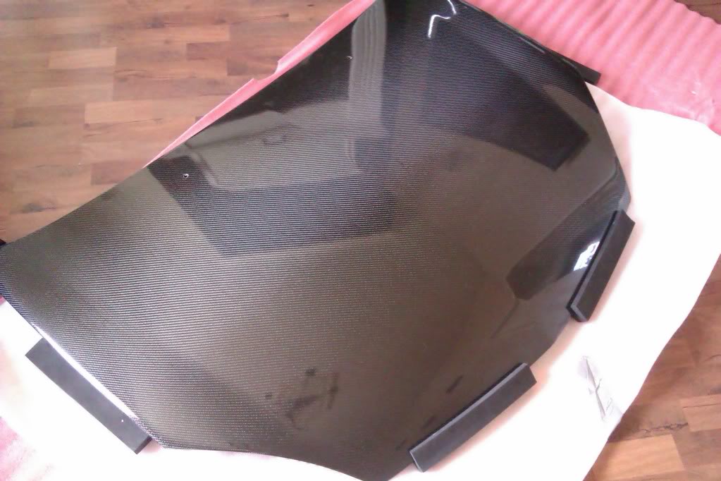

i decided to go for a carbon fibre bonnet to save a little bit of weight and also i just quite like the look of them.
It is just an old ktec 1 so the top is carbon fibre and the underneath is fiber glass, still pretty light though and it should look good when its on.

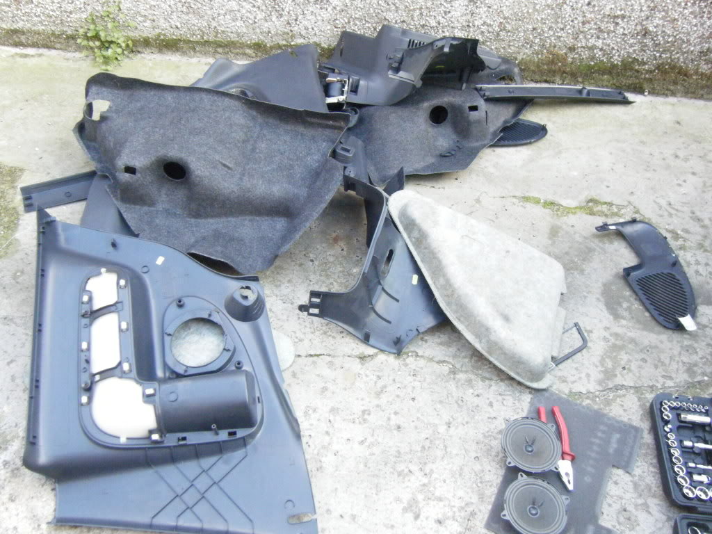

So here is my progress from yesterday, nothing major mind.

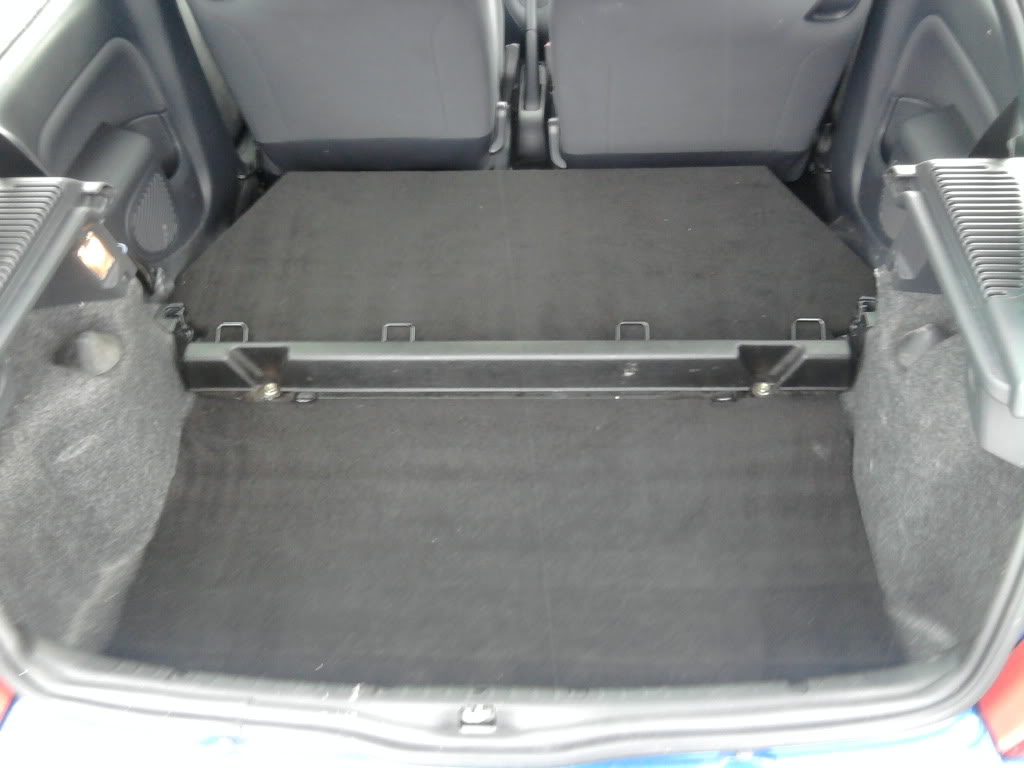

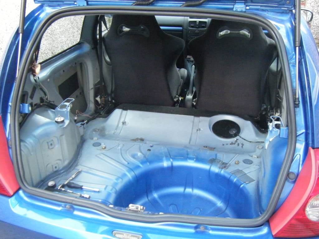

The back end got properly stripped out, as it only had back seats out with a false floor in before hand.
This is how it looked before. Tidy, but not saving all that much weight.
during...
Then after i was left with this.

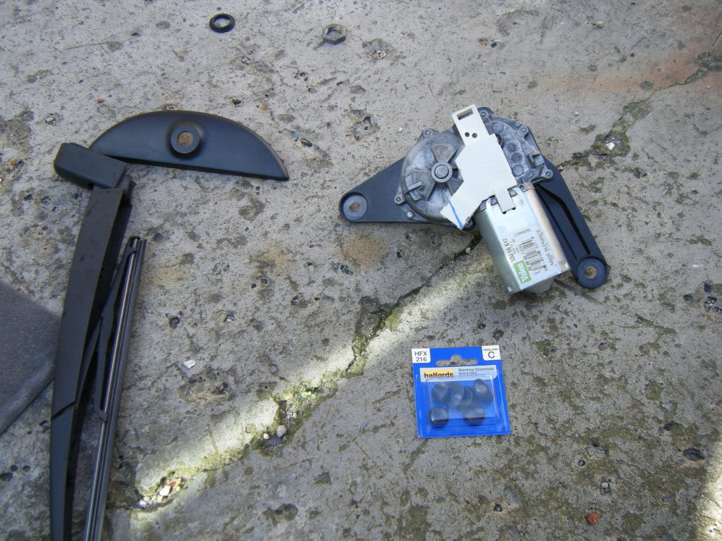

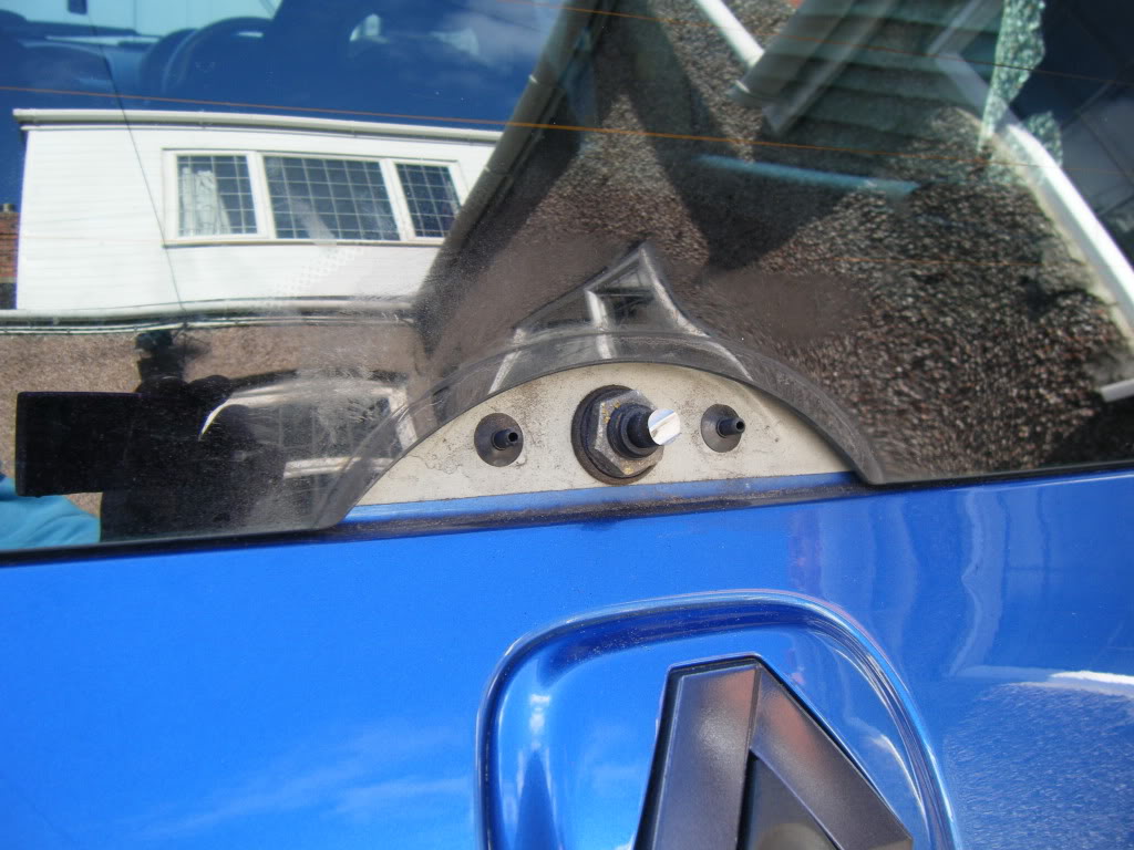

After this i made the decision to remove the rear wiper and motor, at first i tried to follow a guide off here but it just wasn't working for me. so out came the trusty hacksaw :S
Which left me with this
Once at this stage it was a fairly simple case of unplug then unbolt and the motor just slides right out.

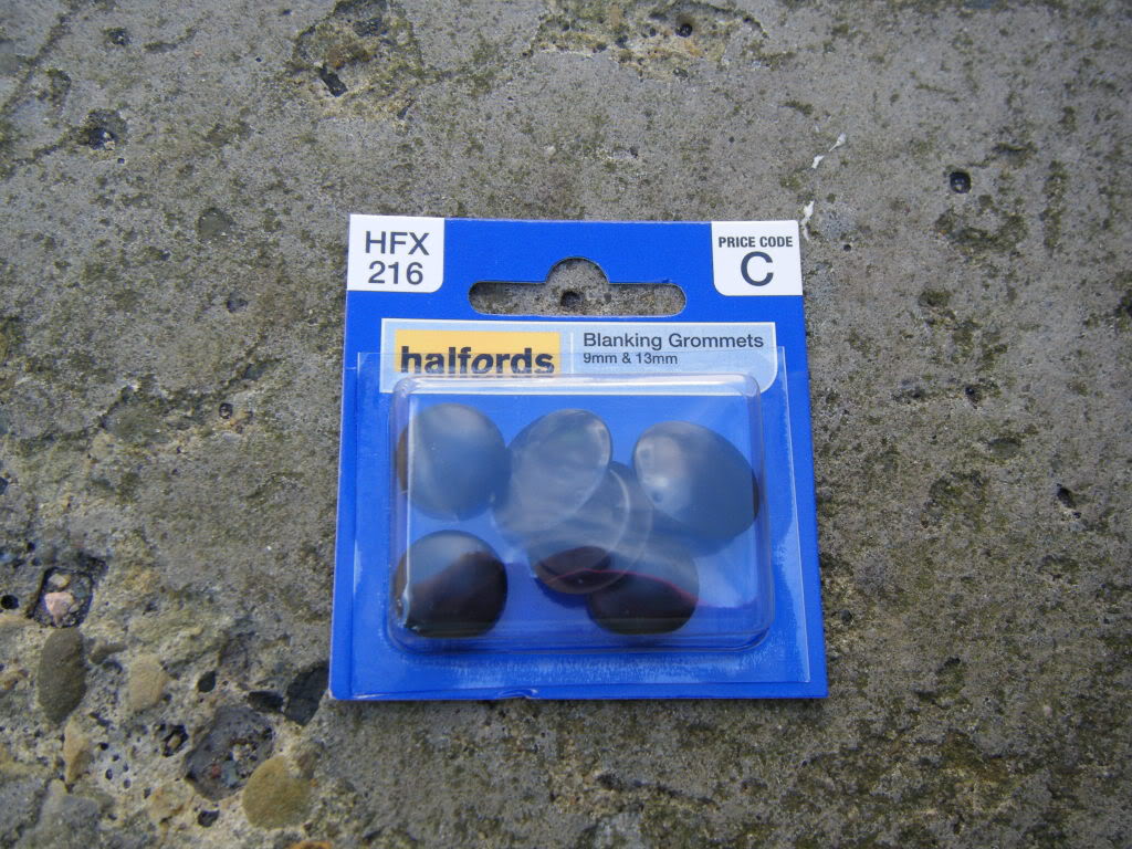

For the plastic i got a selection of small rubber grommets from halfords
The 13mm grommet turned out to be the winner
on the inside i used a 24mm grommet to prevent any leaks, 24mm was the biggest i had but it was a tad slack so i put a bit of silicone around it just as a precaution.

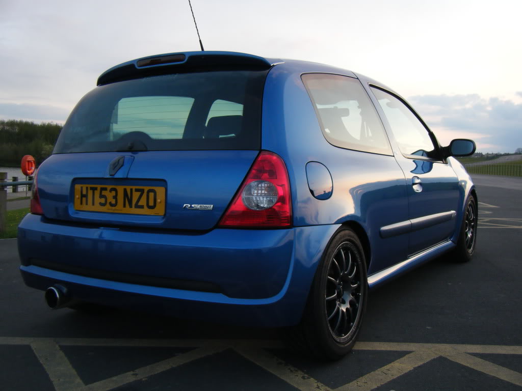

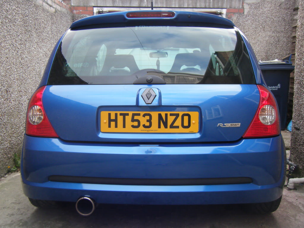

so all in all saved some weight in the rear end and the tailgate now looks like this.
I wasn't too sure about how it would look when i started but im quite happy with the result :)

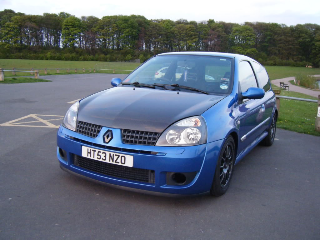

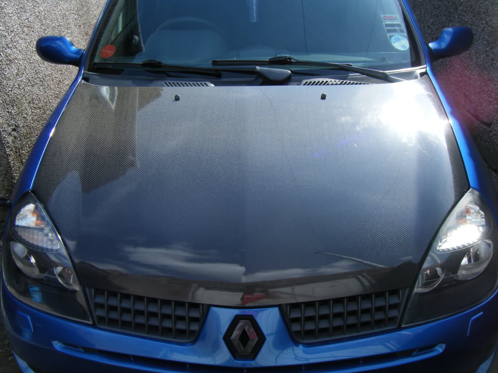

Finally got round to getting the carbon bonnet on yesterday, it wasnt too hard just a little fiddly.

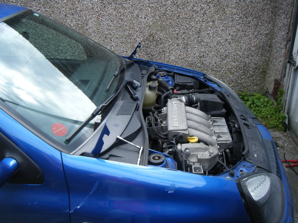

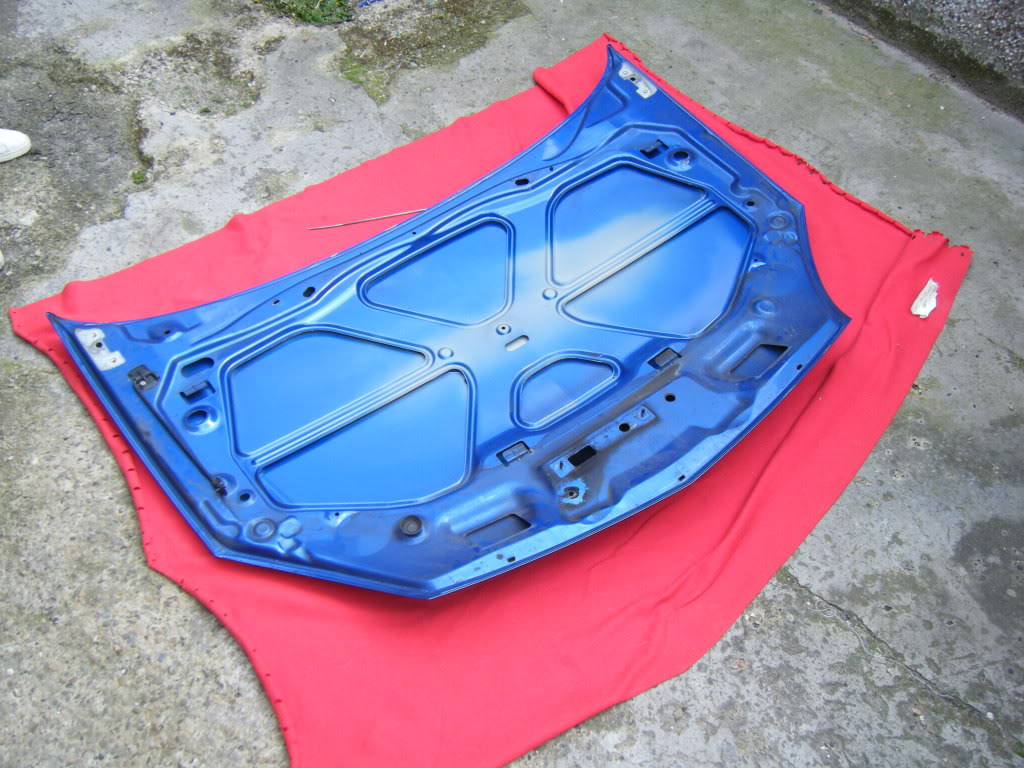

made fairly quick work of removing the heavy dented old unit.

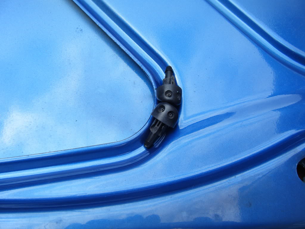

took a few minutes of messing around to get the old washer jets poked out...
Once all the the fixings had been changed over i loosely bolted it to the hinges, i had to lay it in the shut position a couple of times to line it up and when it was finally lined up properly i nipped them up tight.
So here are a few pictures of it fitted, not the best because you cant really see the weave. I'll get some better photos at some point soon.
and a quick picture from the back end too..
more to come at a later date.
Thanks for looking

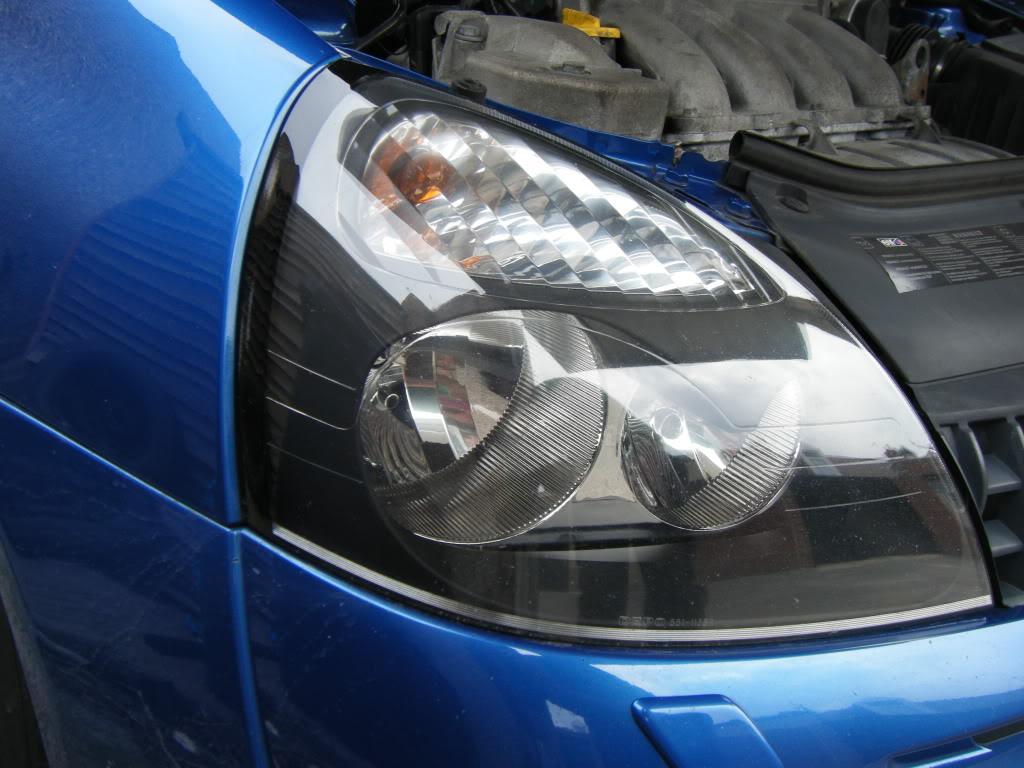

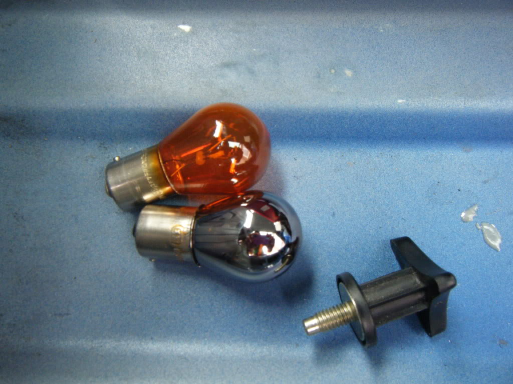

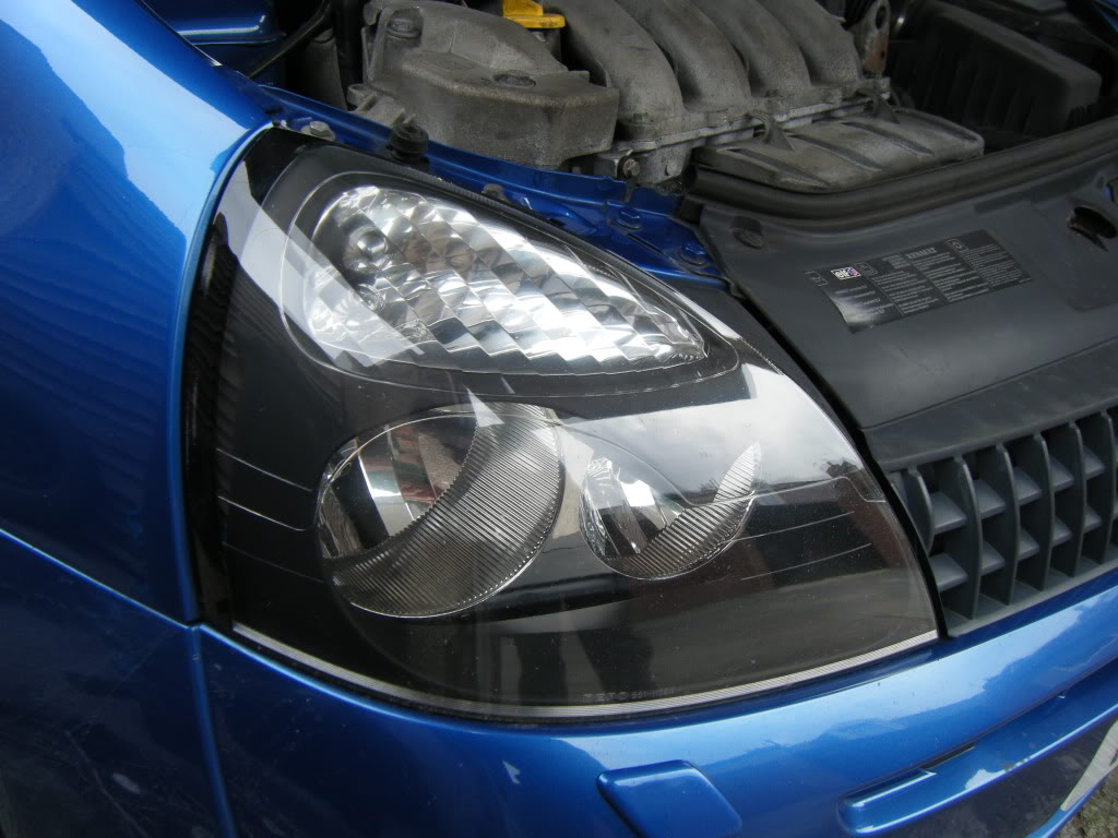

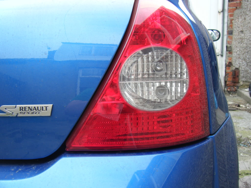

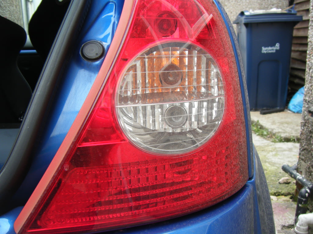

Just a little update. Silver visions came today, i wasted no time and just popped them straight in. Heres a few photos from along the way.
old and new bulbs together
Rear before
and after
front before
and after
im really happy with how they look, definately a worth while little mod :)
