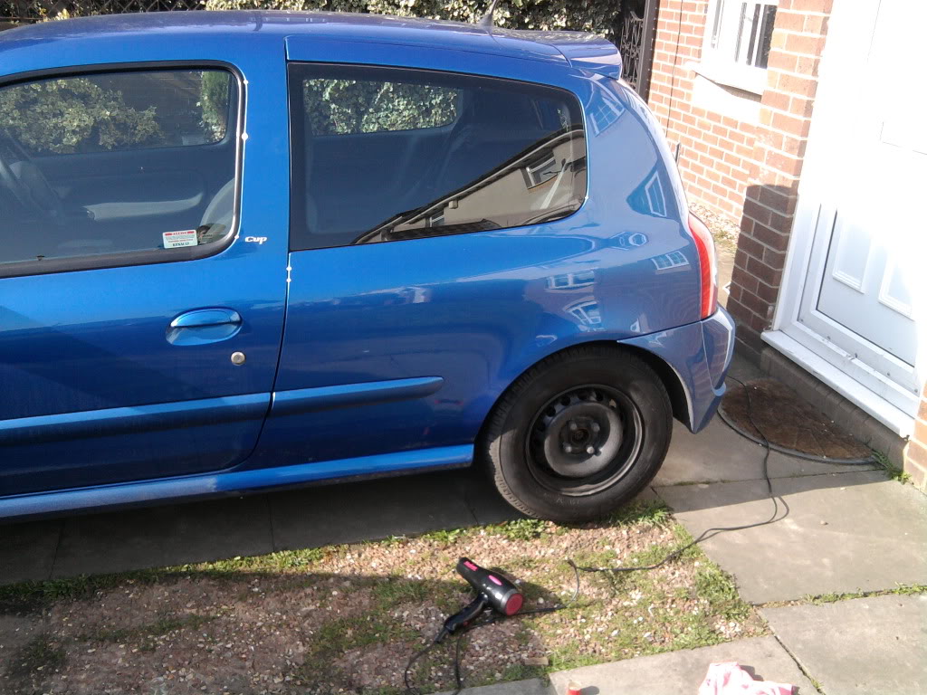

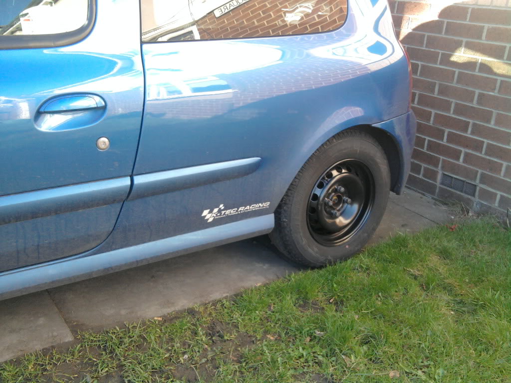

Any how, things eventually started to change when this happened
while the special wheel was on i decided to get rid of the big stickers on the sides.
so out came the girlfriends hair dryer and vodka haha

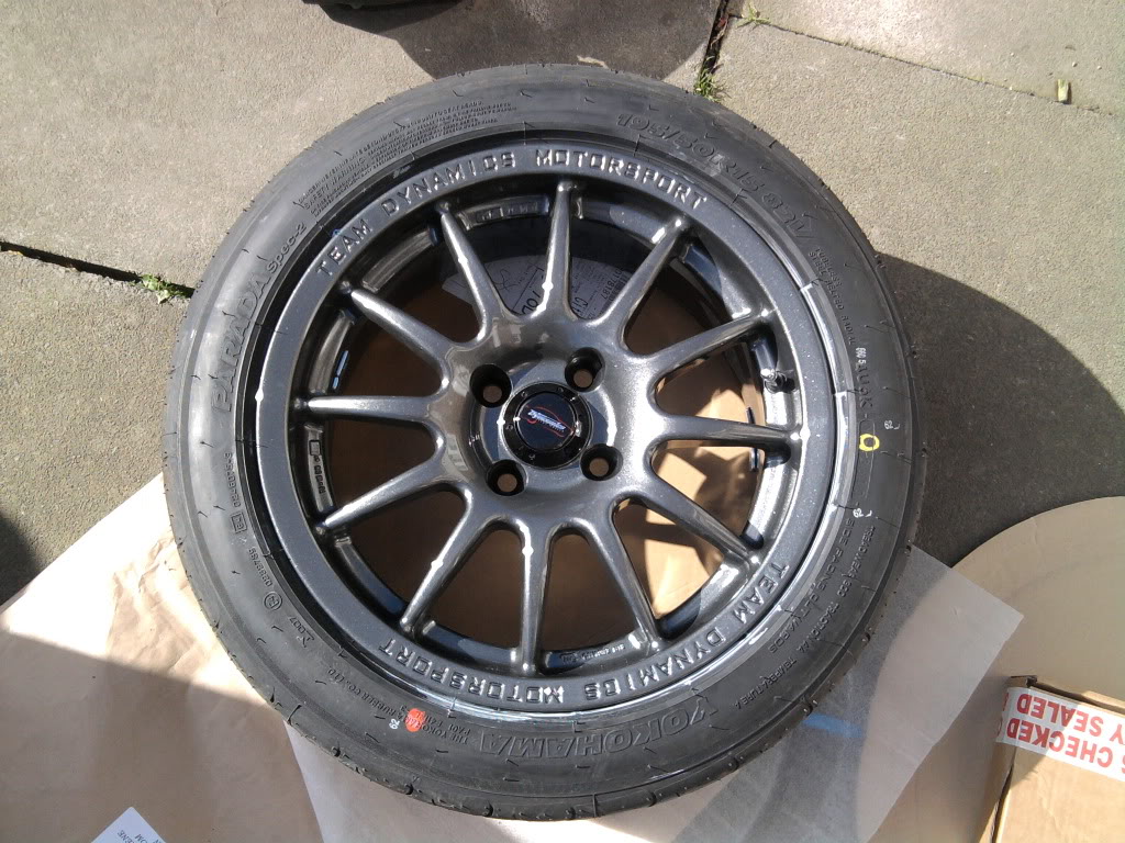

I'd been eyeing up some anthracite pro race 1.2's for ages and this was the push i needed to make me buy them. I ordered them with yokohama parada spec 2's, I also chose to drop a wheel size to 15's as the tyre prices were unreal! at the same time i ordered a fresh number plate for the front and a skoda fabia splitter.
One sunny day work began...

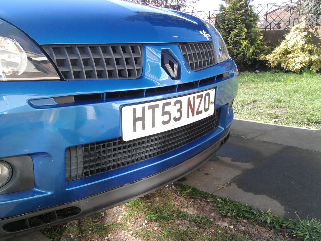

gave the car a quick wash then the plate was first to go..
before
after

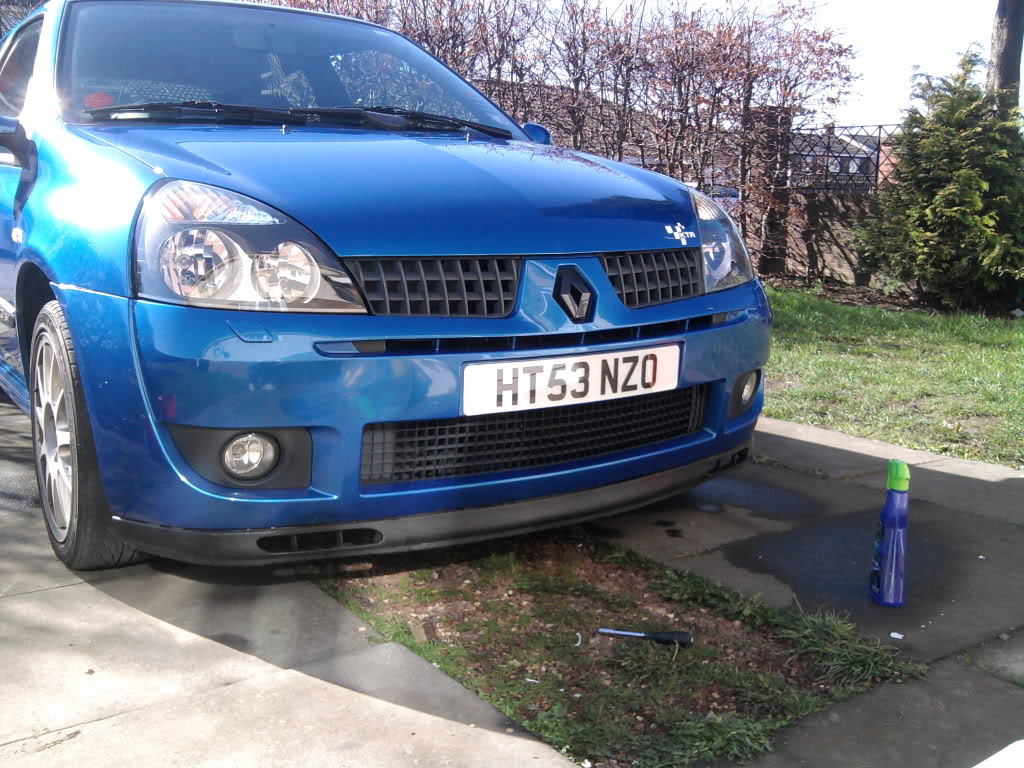

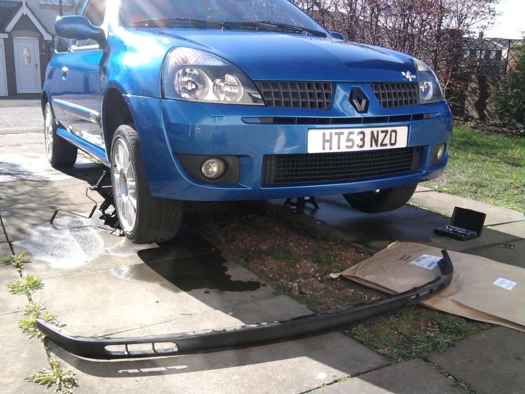

then set about the splitter

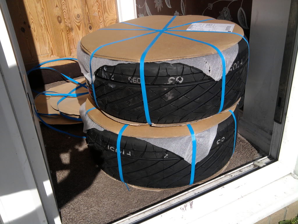

while doing this the wheels and tyres arrived ready to fit.
after a bit more work it looked like this.
after this i went off to check tyre pressures.

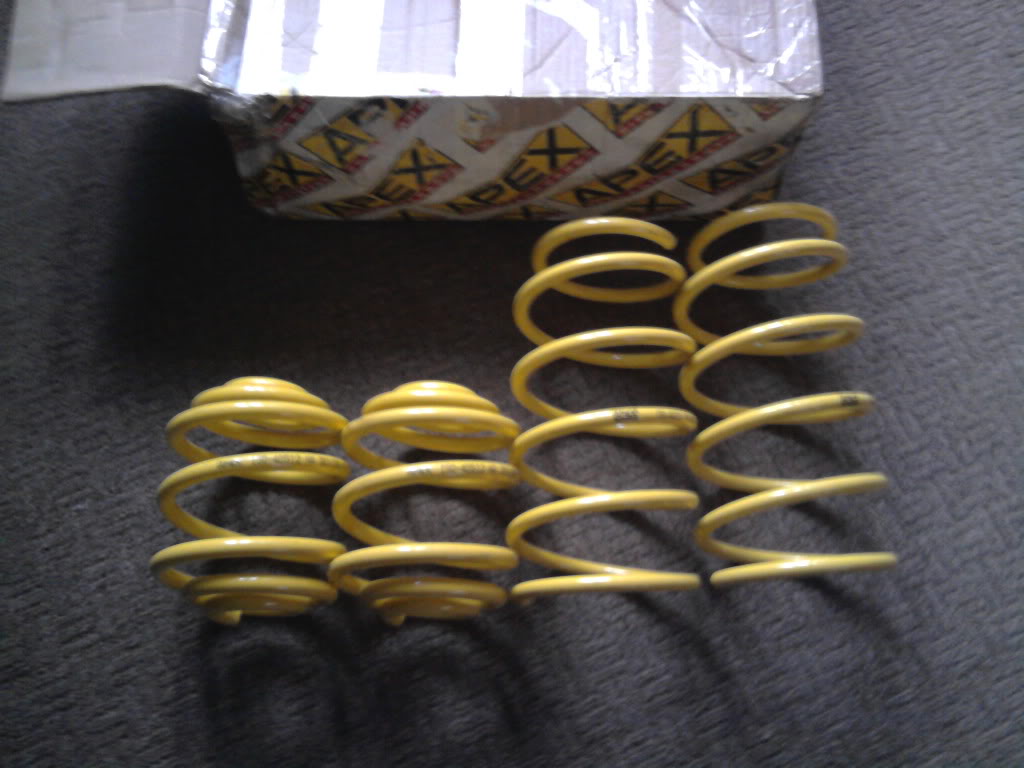

it did look like a tractor on the new smaller wheels, but i didnt have much money left at the time. desperate to sort out this crazy ride height i ordered some apex springs, not the best but were fine for the time being.

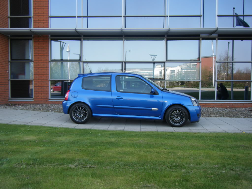

So this is how things were looking...

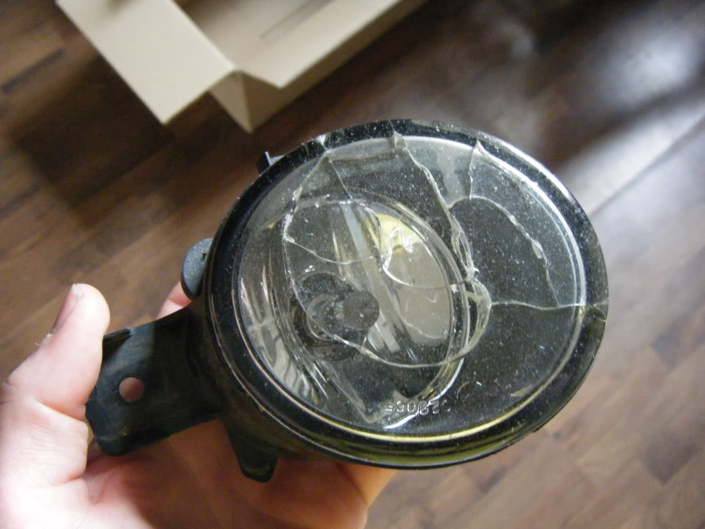

also removed fogs. mainly due to this...

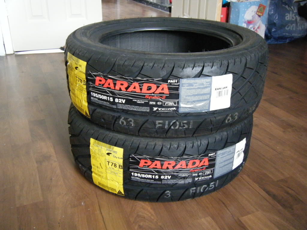

so heres a few pictures of the things i have lying around the house at the minute..

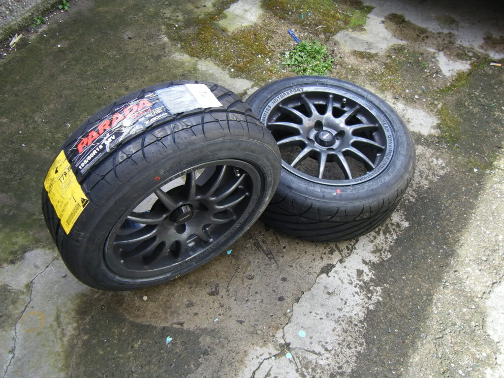

2 new parada spec 2's as the fronts are looking fairly well worn now, these came at a very good price from camskill.

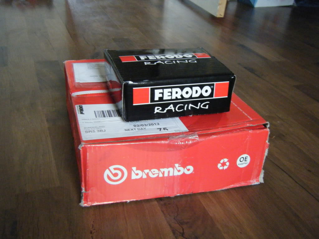

mintex pads are pretty good but when going on a drive up hartside last year they seemed to go a bit soft after some enthusiastic driving... so this year im changing to ferodo ds2500's as iv heard they're a brilliant pad, even on track. discs were looking a bit worn on the inside so got a new set of brembo plain discs to go on at the same time.

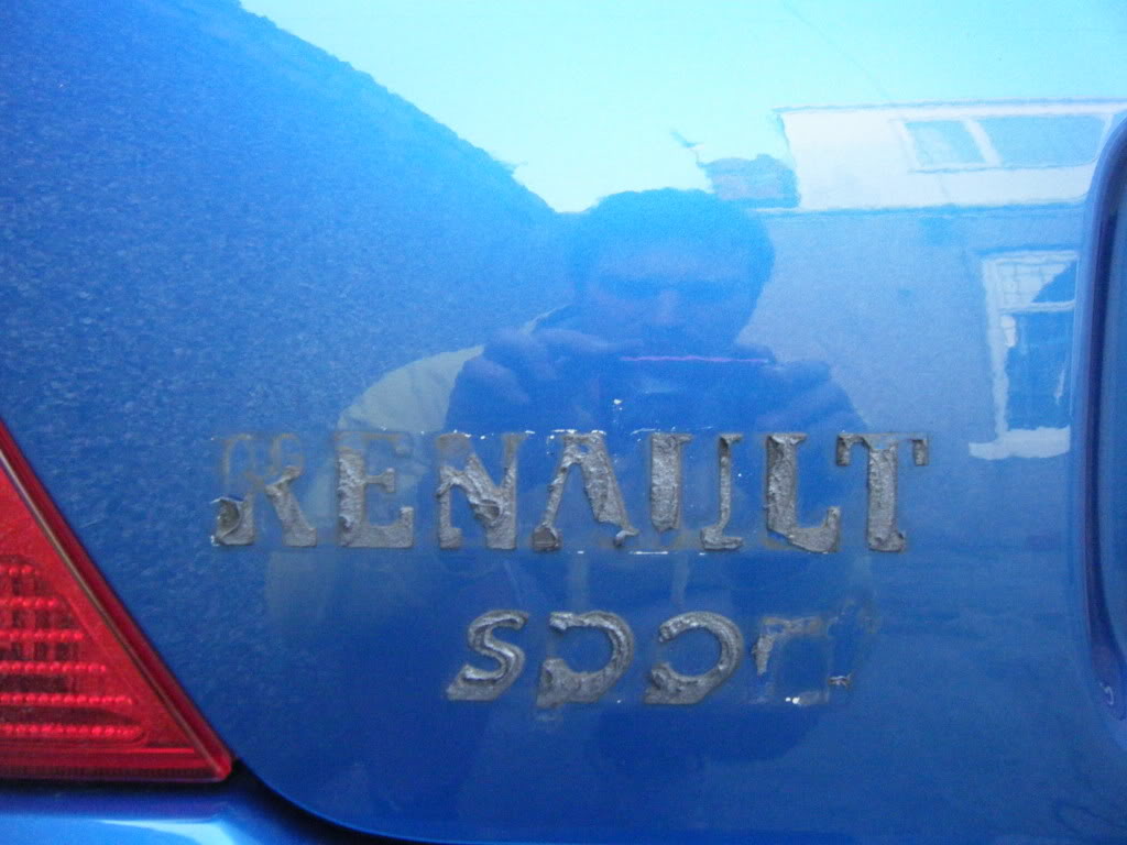

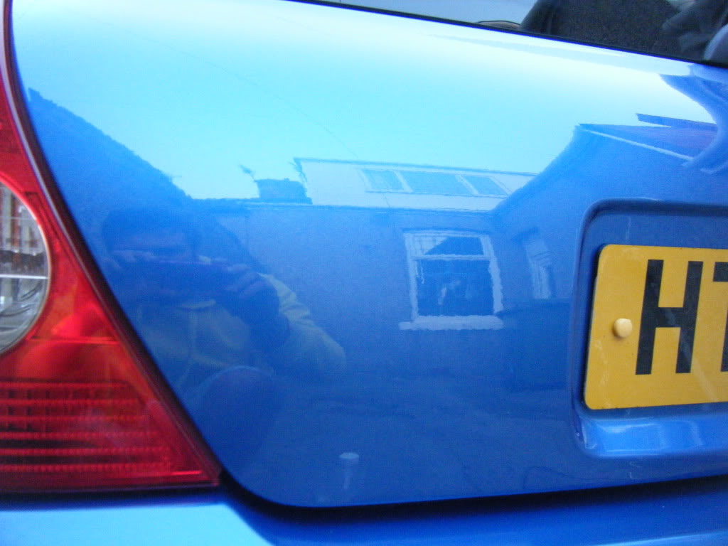

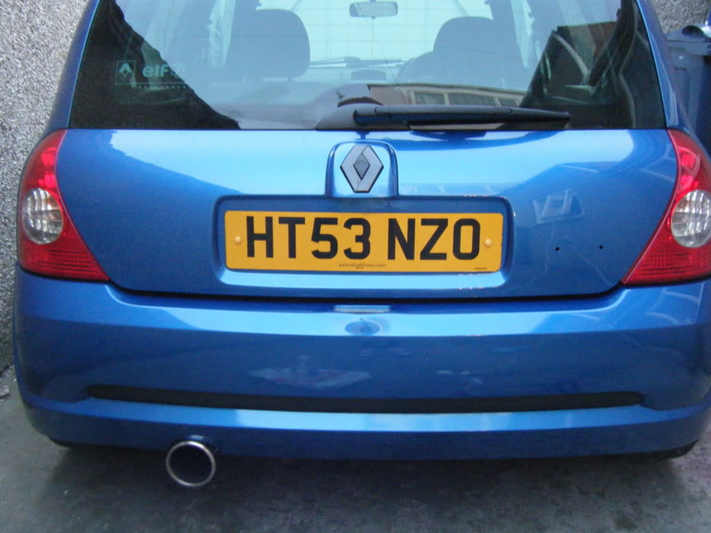

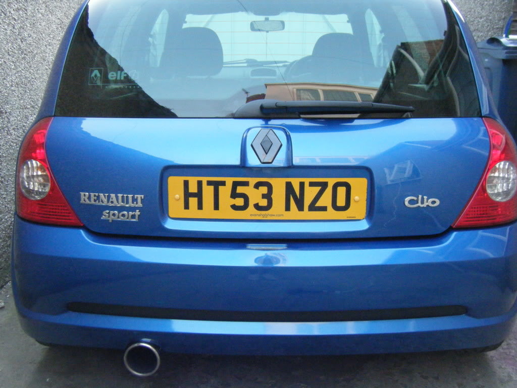

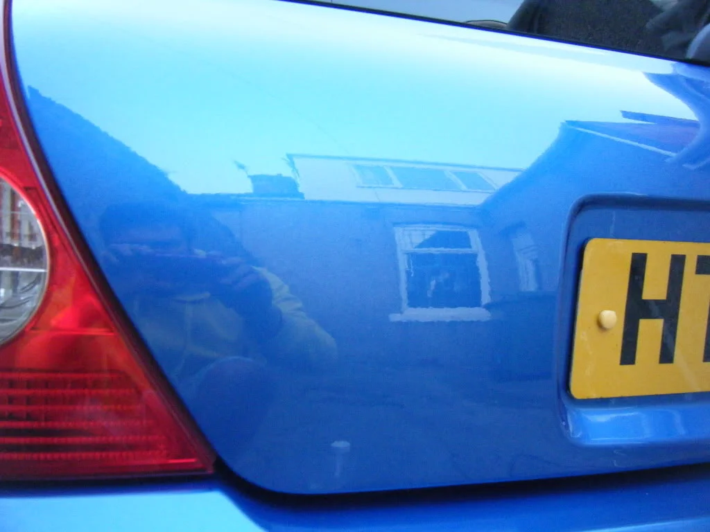

quick little update... had a spare few minutes to myself when i finished work today, so i decided to set about removing the badges from the back end of the clio as iv always thought they look a bit cluttered. so out came the good old hair dryer and dental floss.
started with the obvious usual...

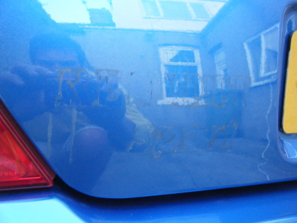

when the first 2 badges came off i was left with this
after a bit more peeling and a quick wipe down this is how it was looking
after this i decided to hit it with the old white spirit just to remove the excess glue that was left behind, i then washed it off and put a quick coat of polish and wax back on. so this was the finished product.

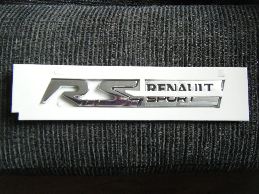

the two holes from the clio badge are to be covered up by a new style renault sport badge after iv ran the polisher over the back end on sunday, just dont see the point putting it on till thats done...

that badge looks good! i just went on ebay to look for one! are you made of money?? jesus! 35quid for a badge!!!!
Cheers mate. aye they are a rip off like but been saying for ages that I'll get 1 and never did lol in the end it came to me in the form of a birthday present haha.

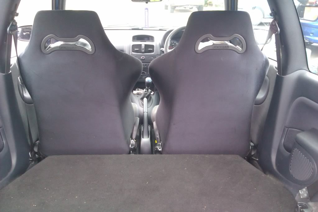

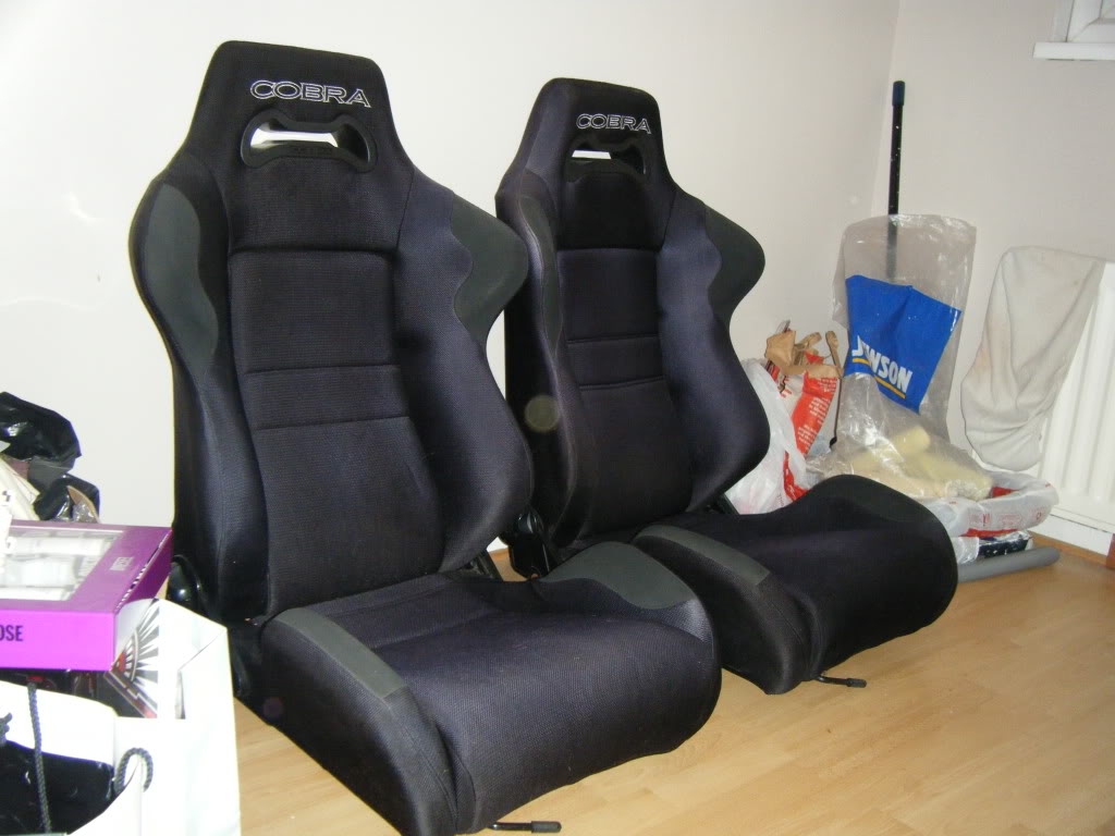

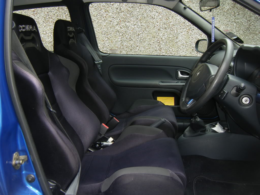

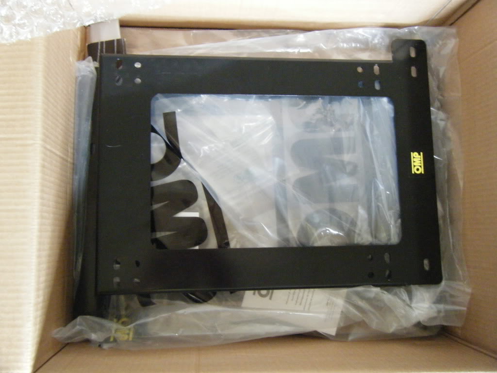

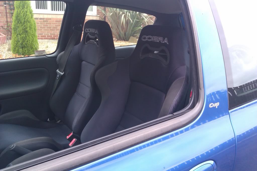

had a busy weekend working on the car over the bank holiday. I had new seats to fit, didnt imagine it would be as much of a faff on like.
these were the seats i had managed to get a hold of. They came from a friend at the bargin price of £160..

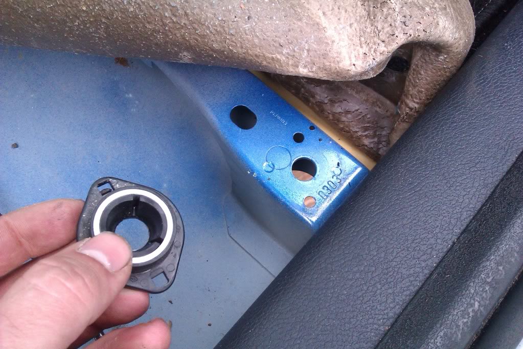

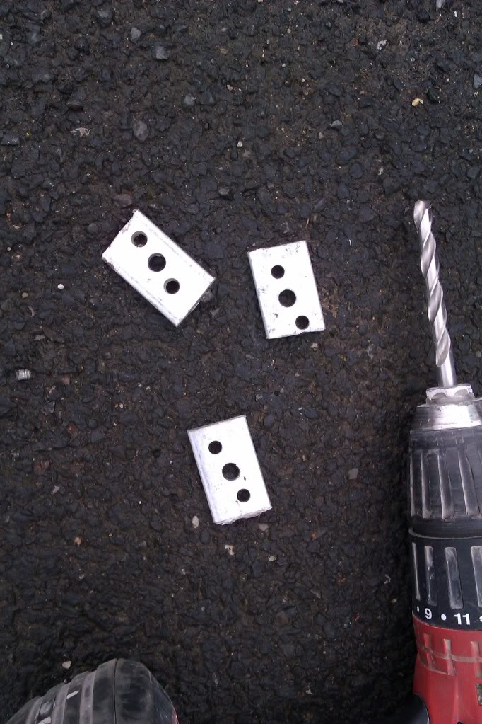

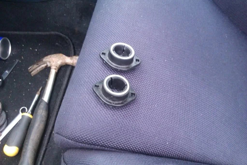

i also got these omp subframes which i had to drill to get them to fit the the runners on the seat.
Once the seats were sitting on the frames properly we bolted in the first 1, but there was a problem... It wasnt sitting straight, it was leaning into the middle of the car. So next came some fiddling around to try and get it sitting level. In the end we got it sitting level by looseing these 2 spacers on the door side.
and then had to pack up the other side with some of this metal strapping.
After sorting out the first seat we knew exactly how the second 1 was going to go and got it straight in.
This was the end result.
that is all for tonight :coffee:

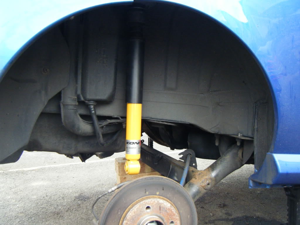

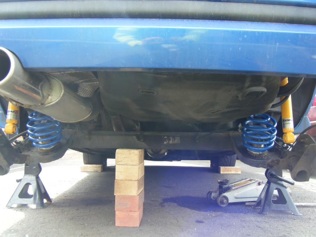

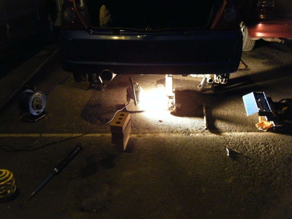

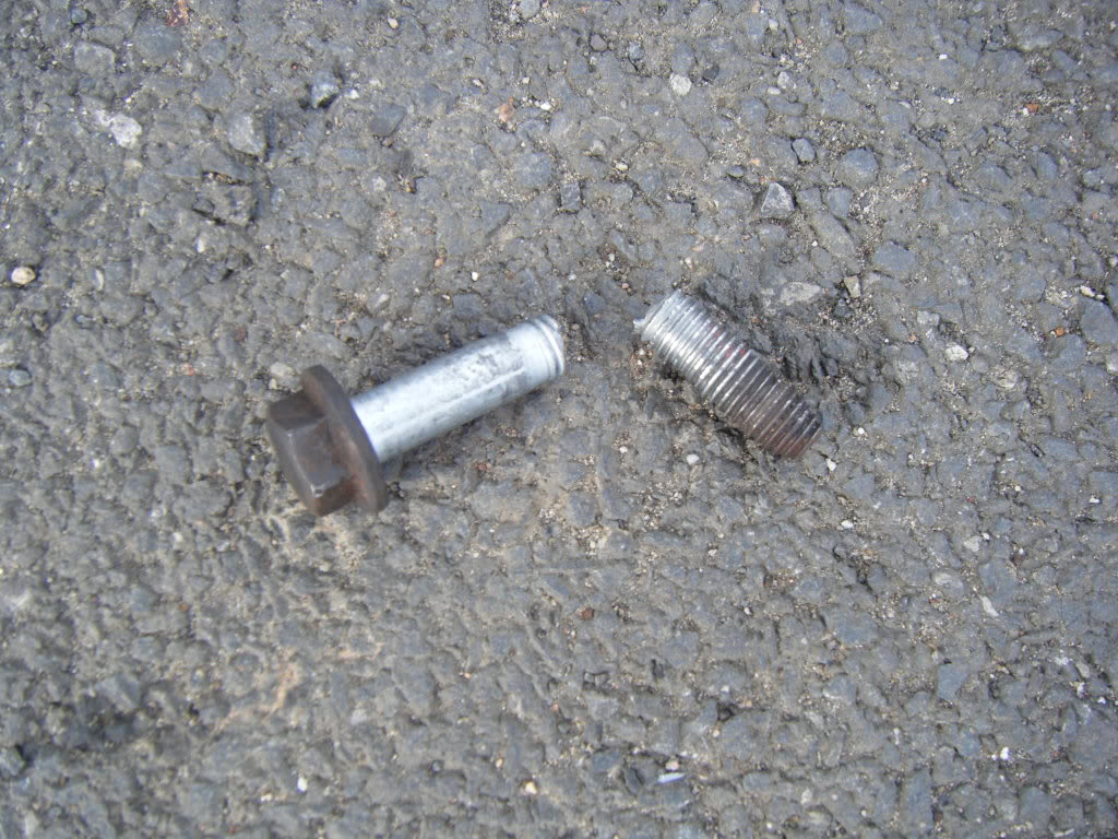

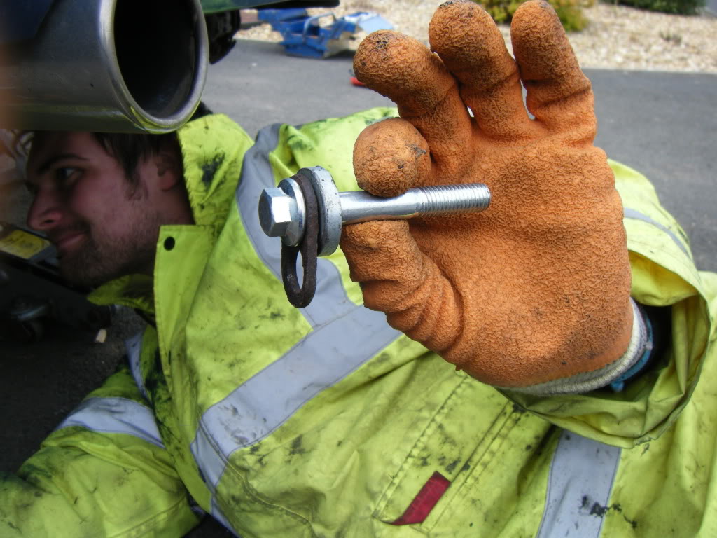

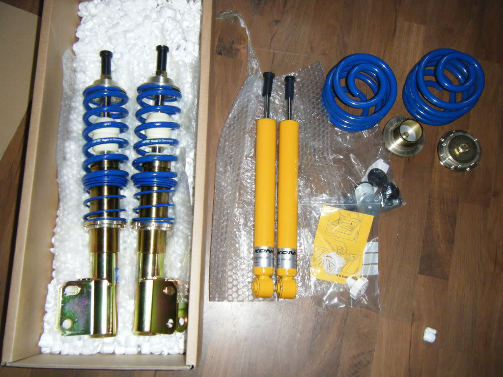

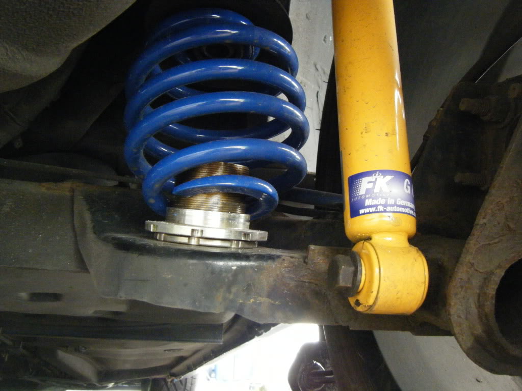

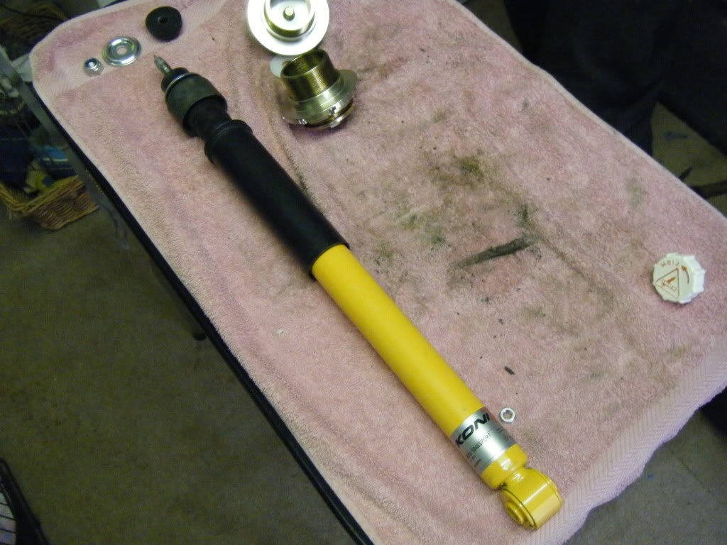

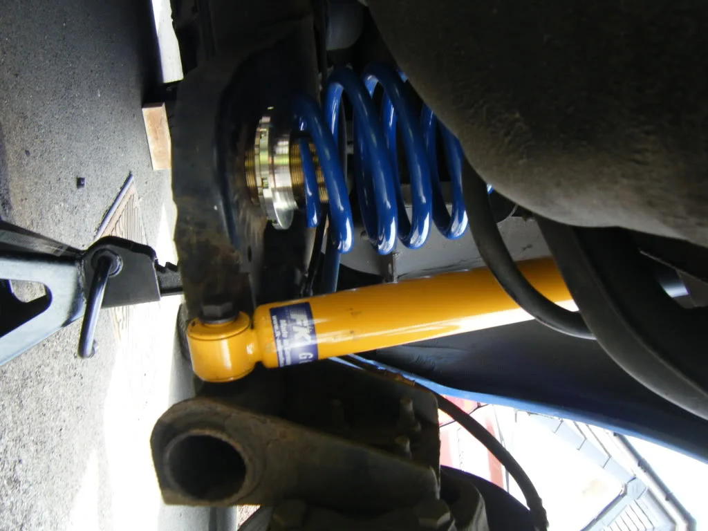

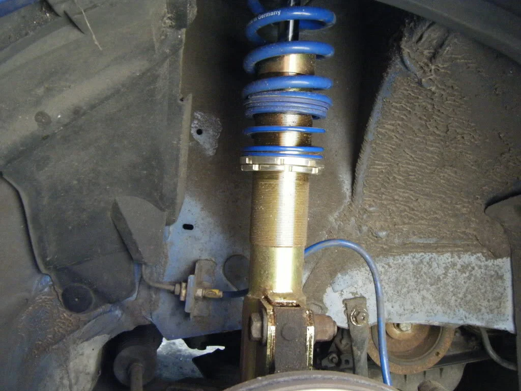

bank holiday weekend part 2... after seats were sorted me and a mate started on fitting my new coilovers. We started with the rears and all was going well... till this.
we ended up working into the dark fannying on with that... but got it out eventually.

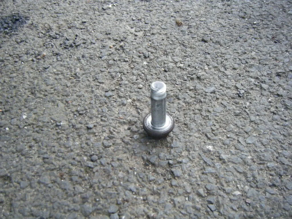

starting again the next day we had to find a new shock bolt, this was a fairly hard task on a bank holiday monday. We ended up having to use a make shift jobbie from kwik fit as a temporary solution, it was the closest match we could find but we had to use some spacers.
old bolt
temporary bolt
i know it looks a bit rough but it was all we had haha.

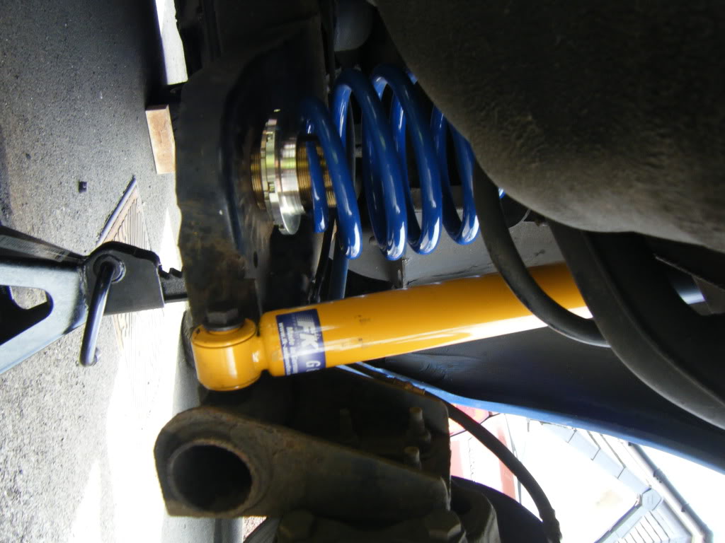

few pics of the shocks built up and going onto the car.

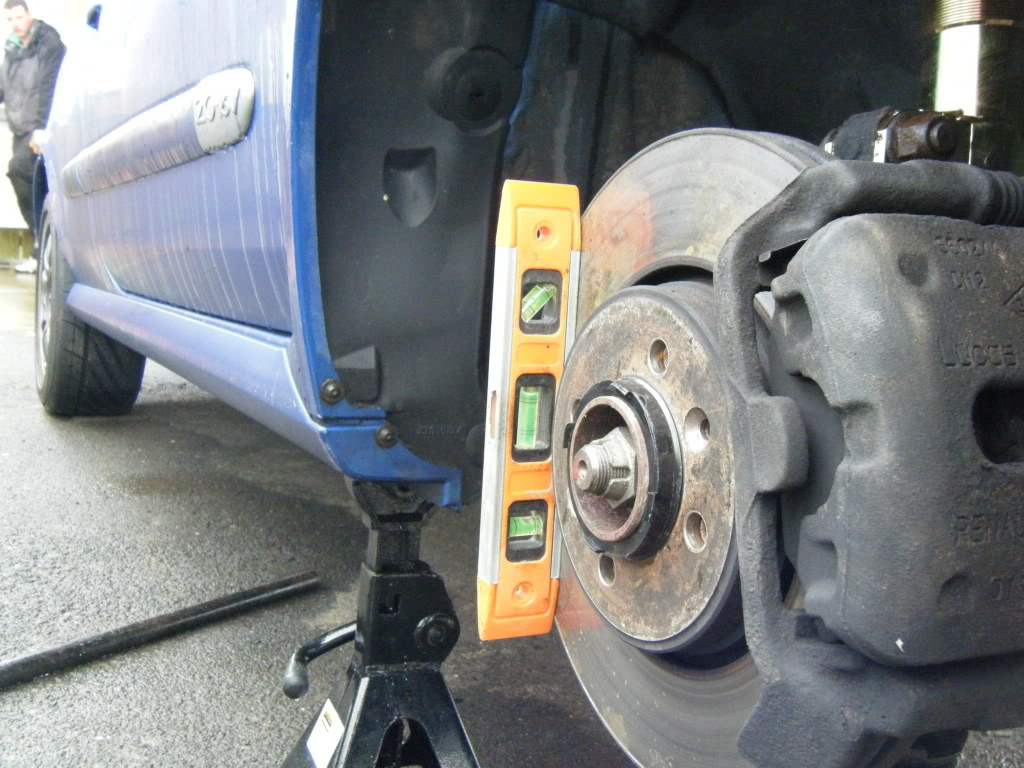

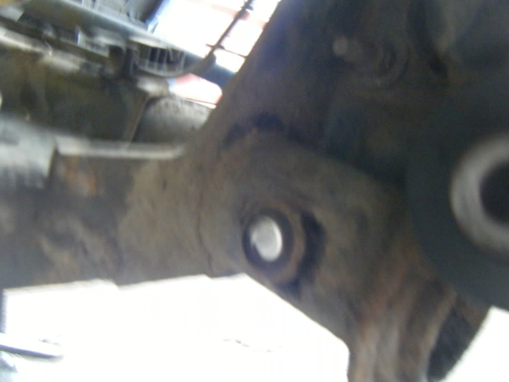

dont really have any pics of the fronts going on because it started to rain so put the camera away. but this was our getto camber adjustment method haha

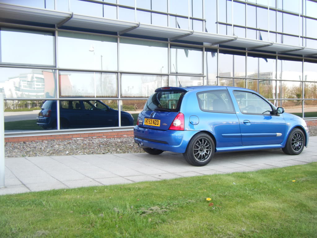

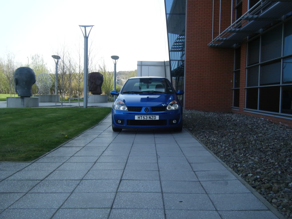

i was very happy with the result, so here are a few quick snaps i got of it once all done.
i will get some better pictures next time i clean it. the front end has been lifted 15mm as it was rubbing. new bolt has been ordered from renault and will be collecting it tomorrow.
Cant wait for some good dry weather now so i can see how it handles :).

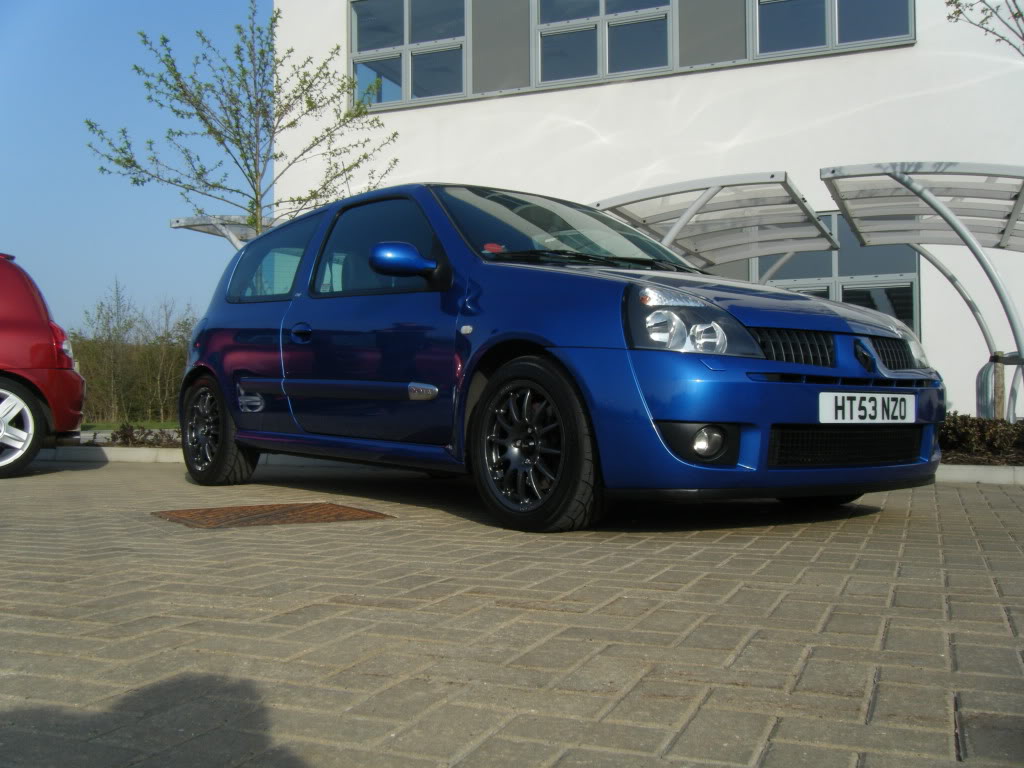

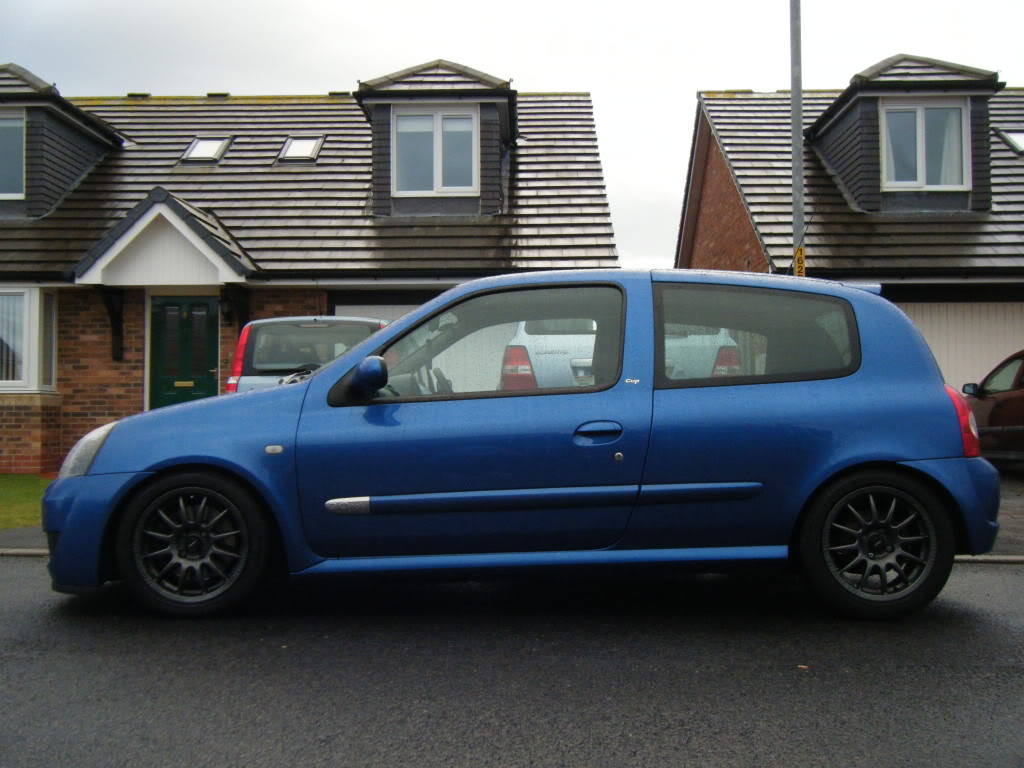

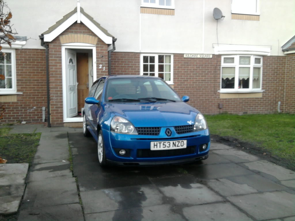

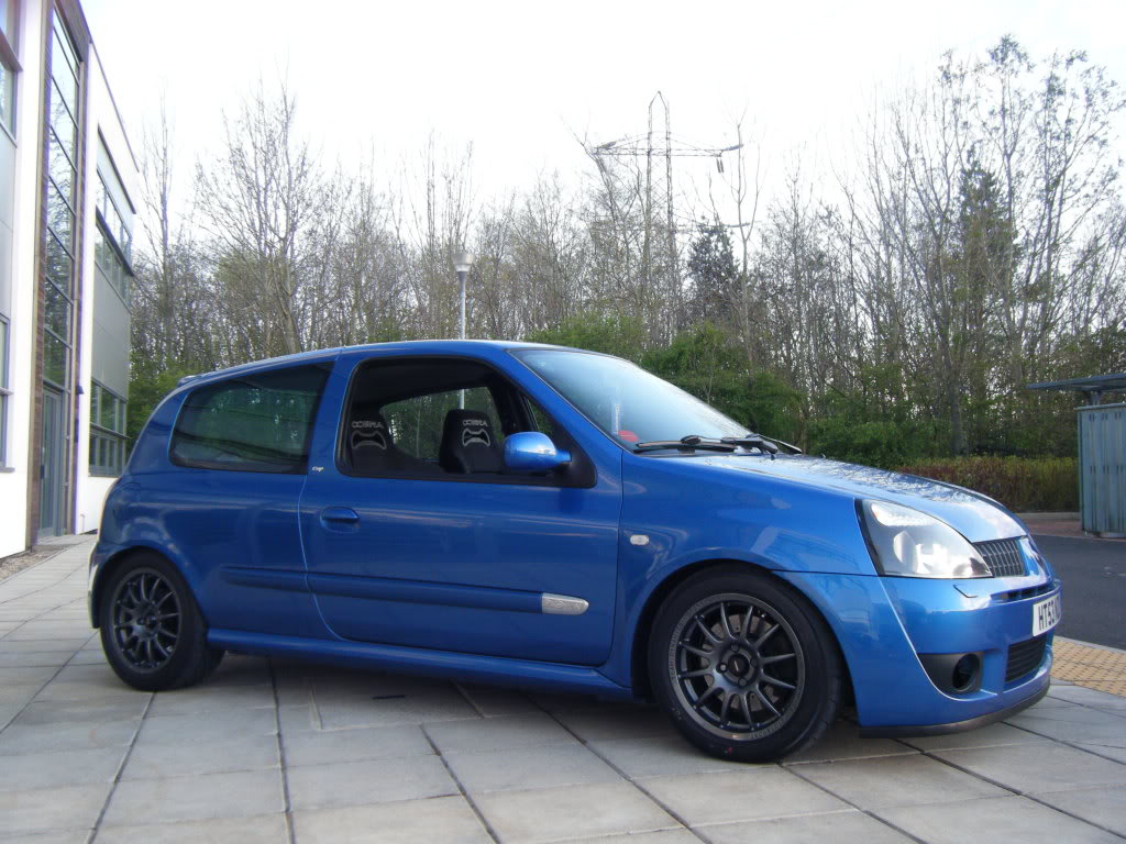

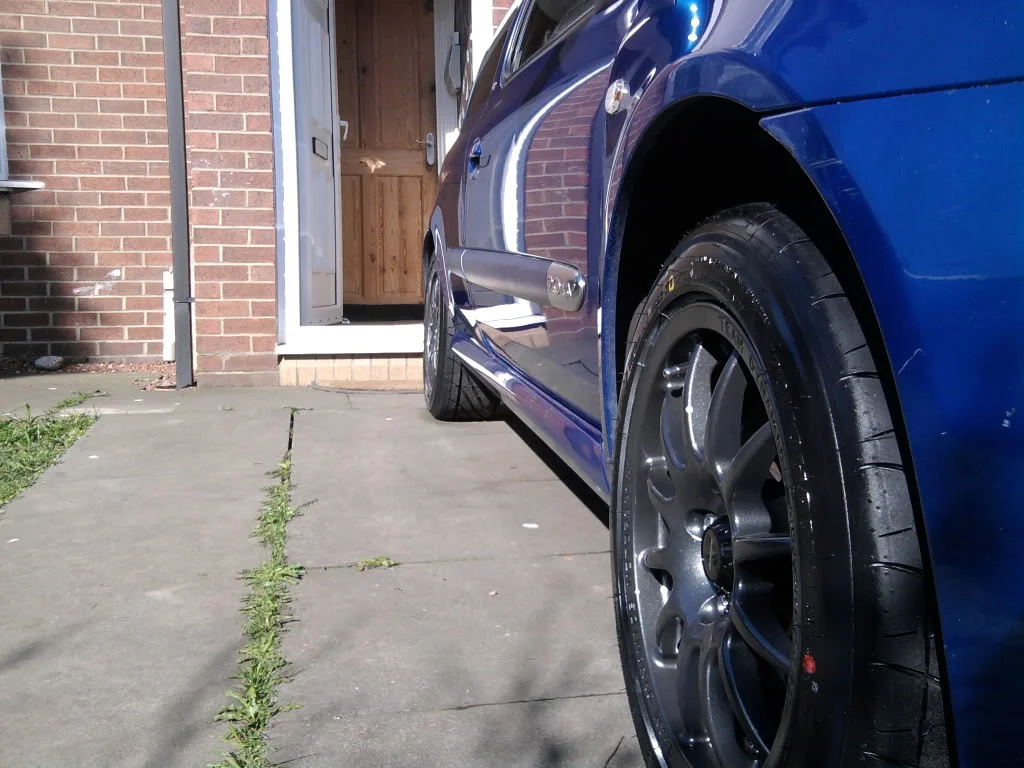

got a few bits and bobs done on the car this sunday, got the new tyres on the front wheels

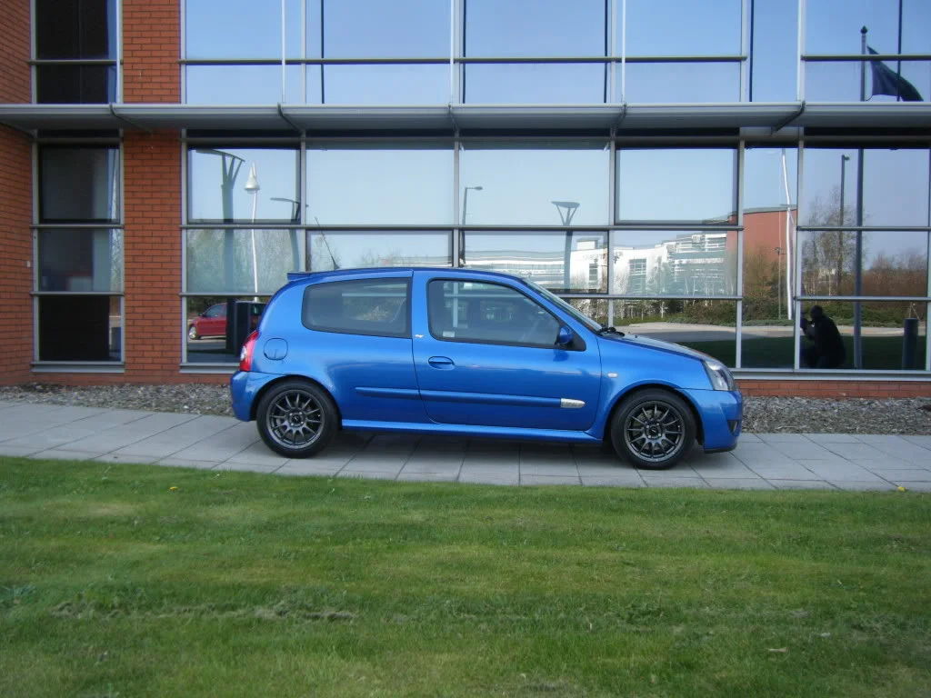

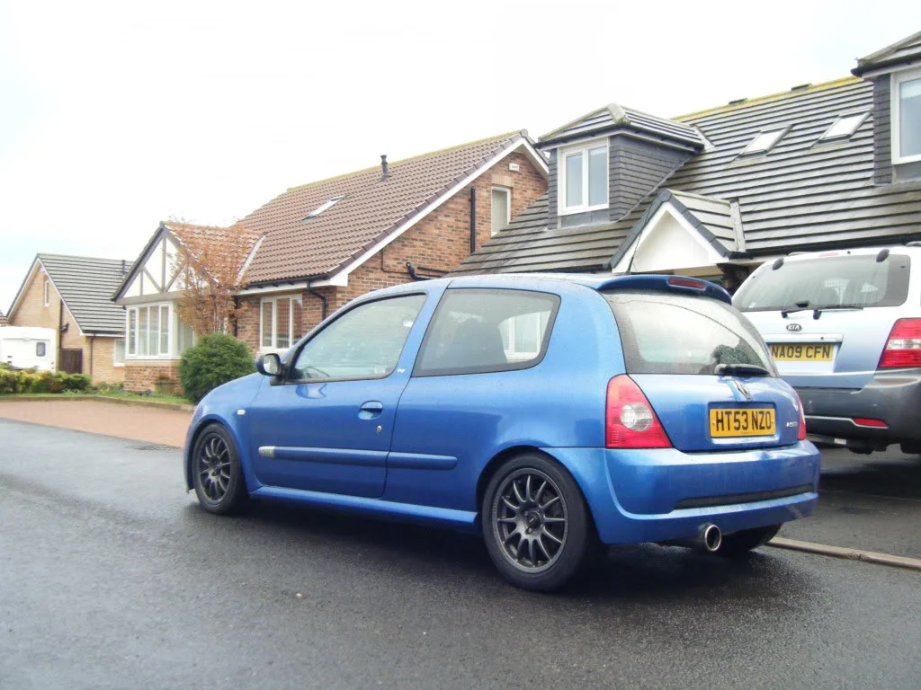

also i fitted the correct replacement rear shock bolt and got rid if the bodge... after that was fitted i had a play around with the ride height, the front got lifted another 10mm and the rear went down 10mm
Rear adjusters are now all the way down
and a quick shot of where the fronts are sitting

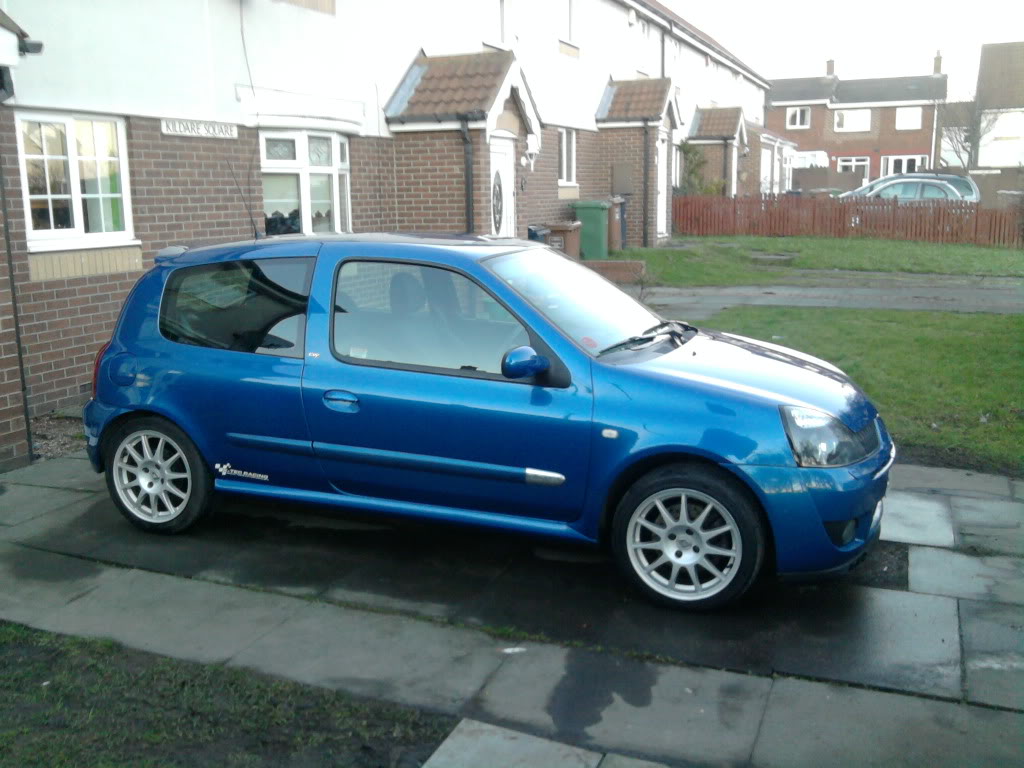

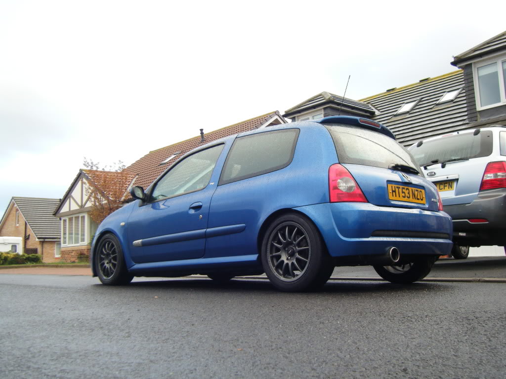

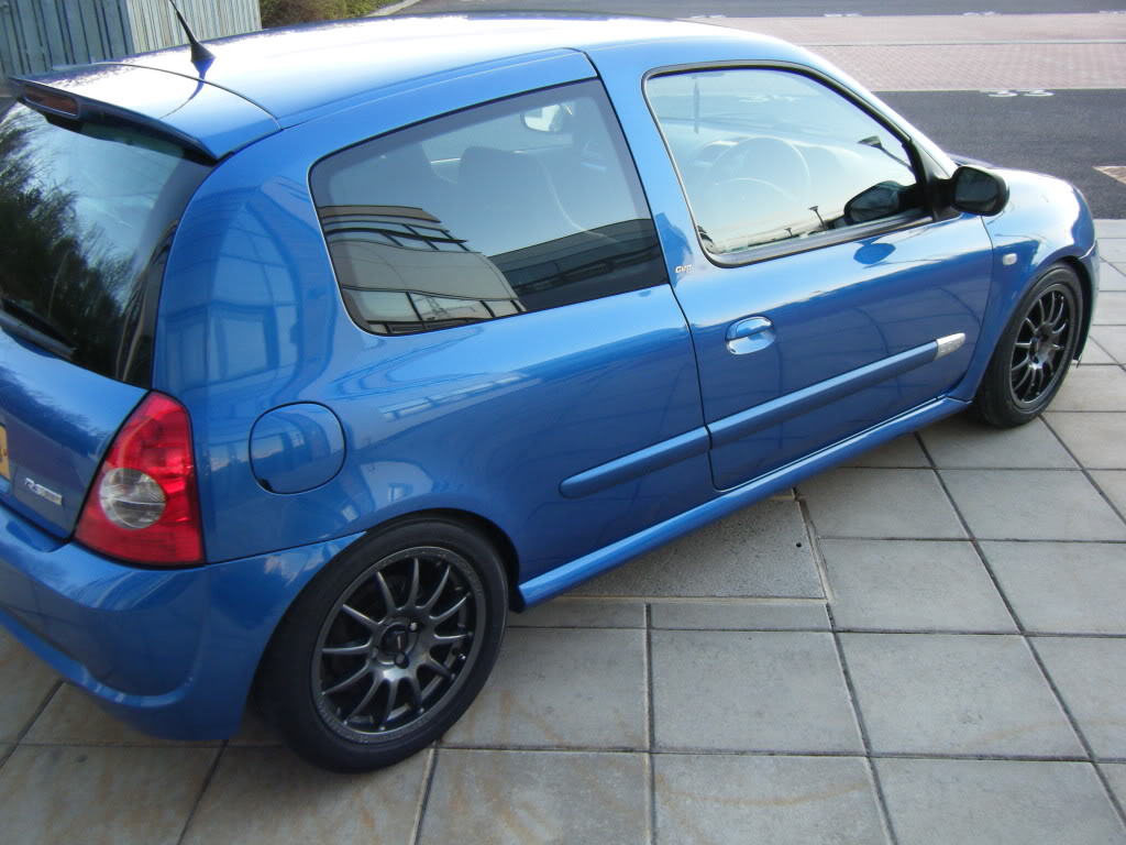

when this was all sorted i gave it a quick wash and went out for a couple of photos, so this is how its looking...
more to come soon :)
looks spot on mate, however i cant help but think that exhaust is a bit too ghetto for the rest of the car
