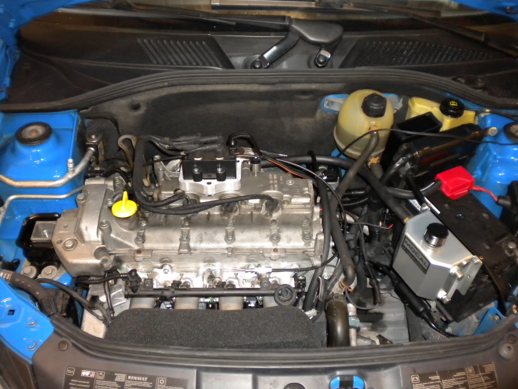

mines the blue one at the back, spot the ITB's

+ 30bhp'ish on average. It depends on the health of the stock engine which is why we'll always dyno and comp test a car before starting any work so we know where we are starting from! Having said that Jay and Tonys scrap yard race engine is down 2 bar on one cyl and still makes 197bhp on our kit! Owens car pictured above made 198bhp peak with a great torque curve!
