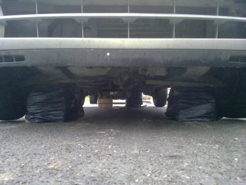

My car has been damaged and I need to get under it to look at / fix some stuff. Because of the snow I need to do it in the garage, but its too narrow to jack it up in the usual way. Does anyone know a way I can jack the car up from the front? I can then insert the axle stands in the normal place and remove the jack and get under the car. I now have the Arcan jack mentioned above so its pretty easy to get it under the car.

I think there is a guide, I will find it for you, but I have taken a pic for you anyway. Give me a few minutes to sort it for you!

I just did it from where the subframe mounts to the body, or just a bit forward of there. Its not "central" so to speak but will give you good access to underneath. Failing that use two jacks, one on each side if you require both wheels off the floor?
I have got 2 trolley jacks so that is a possibility, but I need to be able to put the jacks in under the front of the car as the garage is too narrow to get down the side of the car and jack it.
Use the jack points carefully as to not bend them... simples. Most jacks, well the cheaper jacks atleast have a groove in the head which the jack point on the car sit's into, so it cant slide out. Once jacked up, put the jack stands under the box section and share the weight between the jack and the stand. Thats what i do atleast........
Or yes get a jack with a nice flat head, and make sure it can slide on the drive.....the better jacks have bigger wheels to spread the weight.
