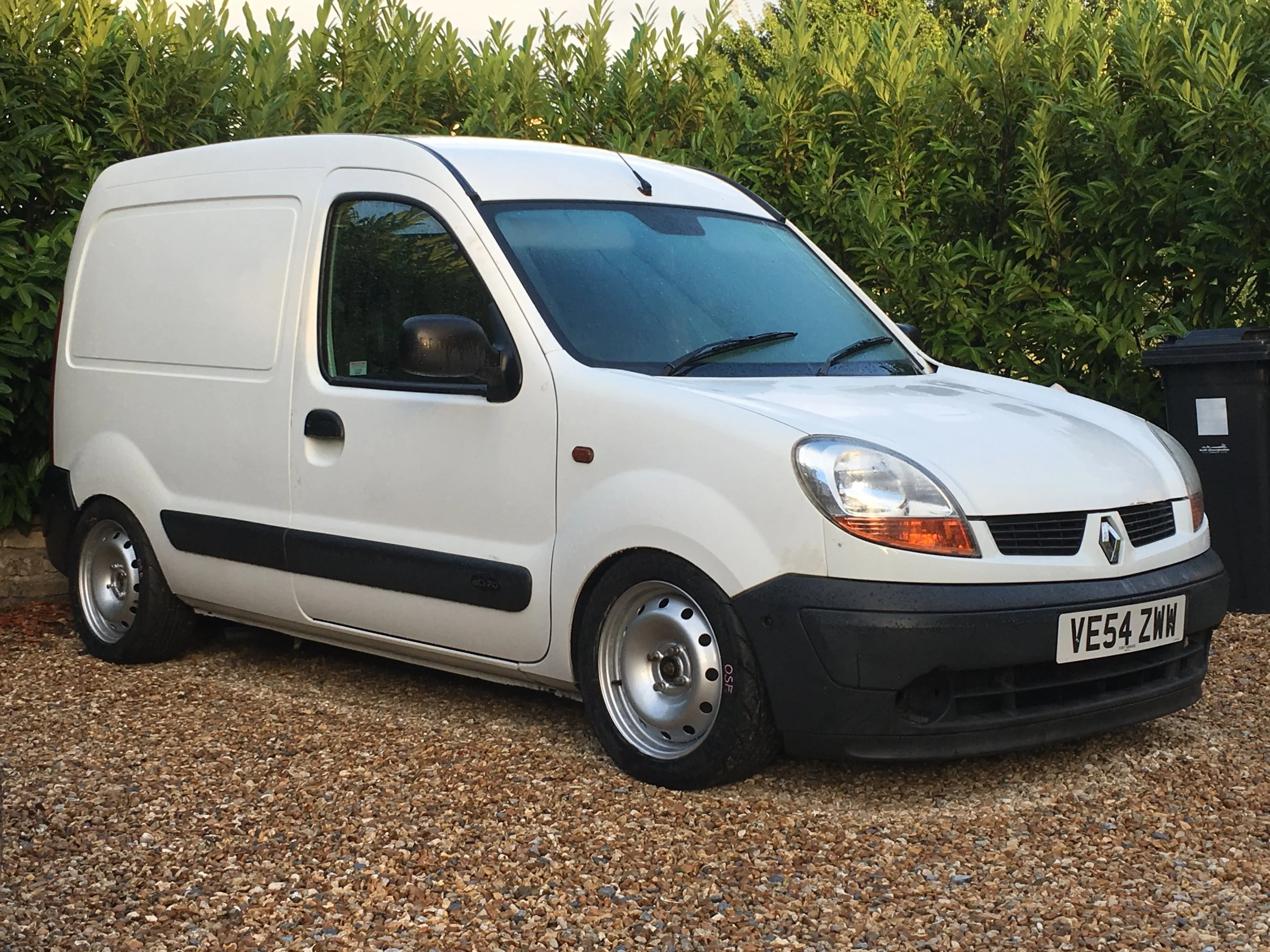

Spec is;
Kangoo van, no side doors
Clio 182 engine gearbox subframe bottom arms front and rear brakes.
Clio 182 front seats and steering wheel.
Ram air induction kit
Clio 182 Cup hubs
Clio 182 Cup driveshafts
Clio 182 Cup front shocks
Cheap lowering springs
New rear beam
Rear Torsion bars adjusted to sit 70mm lower

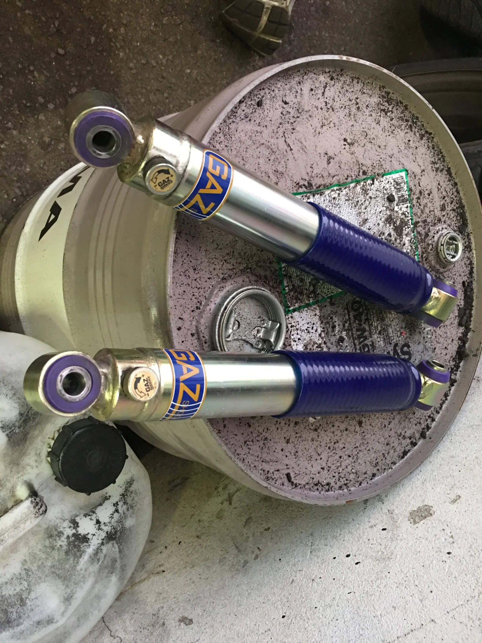

Gaz Clio 16v rear shocks
Brembo discs, Ds2500 pads, supergold fluid,

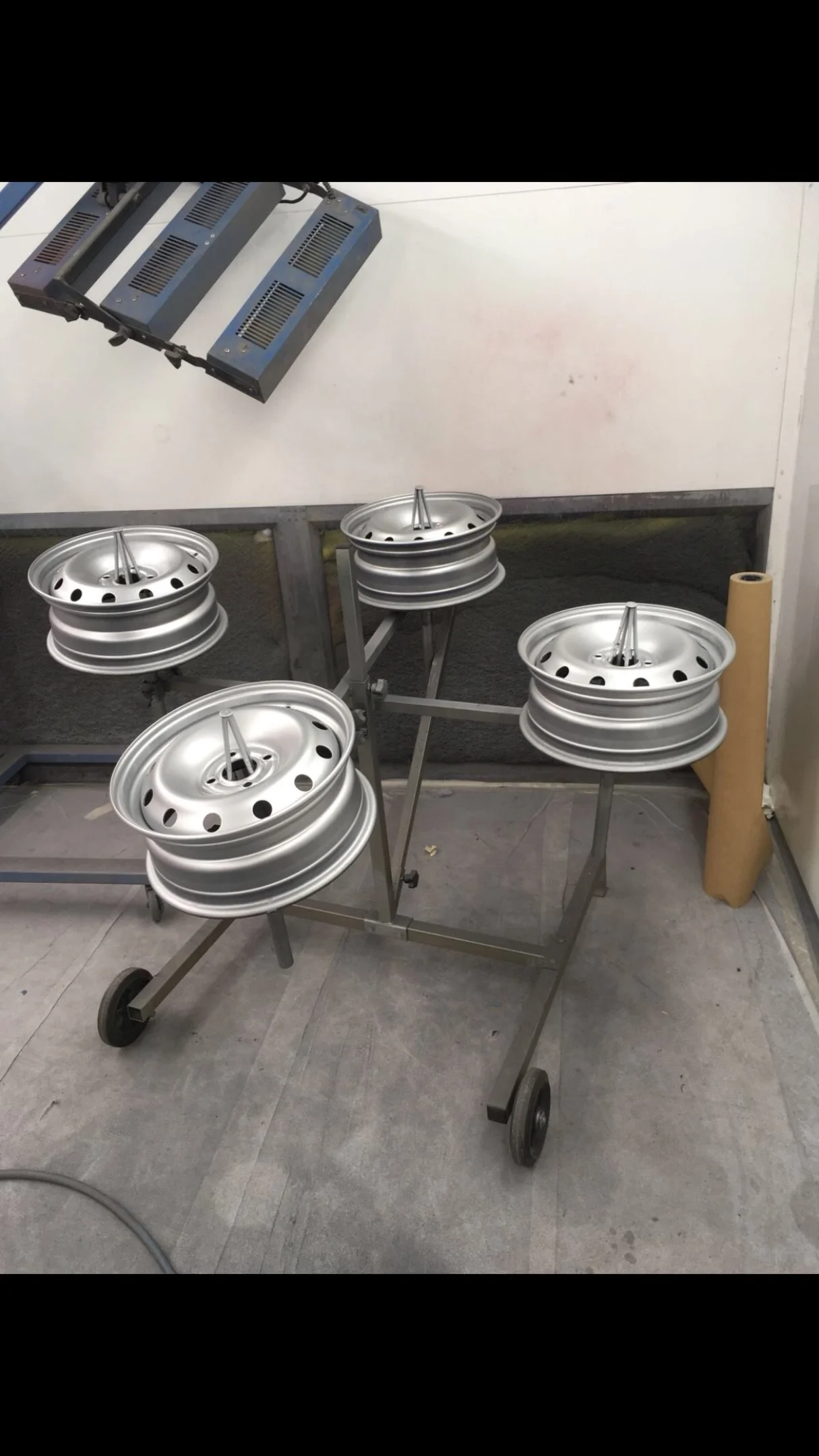

Mk2 Scenic steel wheels painted silver
195/50/15 NS2R’s
16mm rear spacers

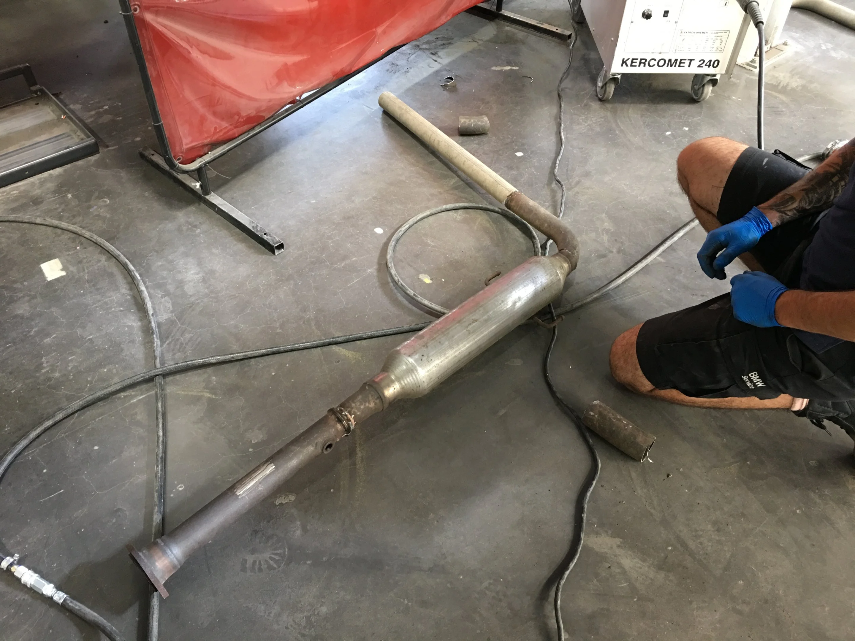

Clio 182 decat, Honda 2.2 diesel centre box running in to a side exit pipe

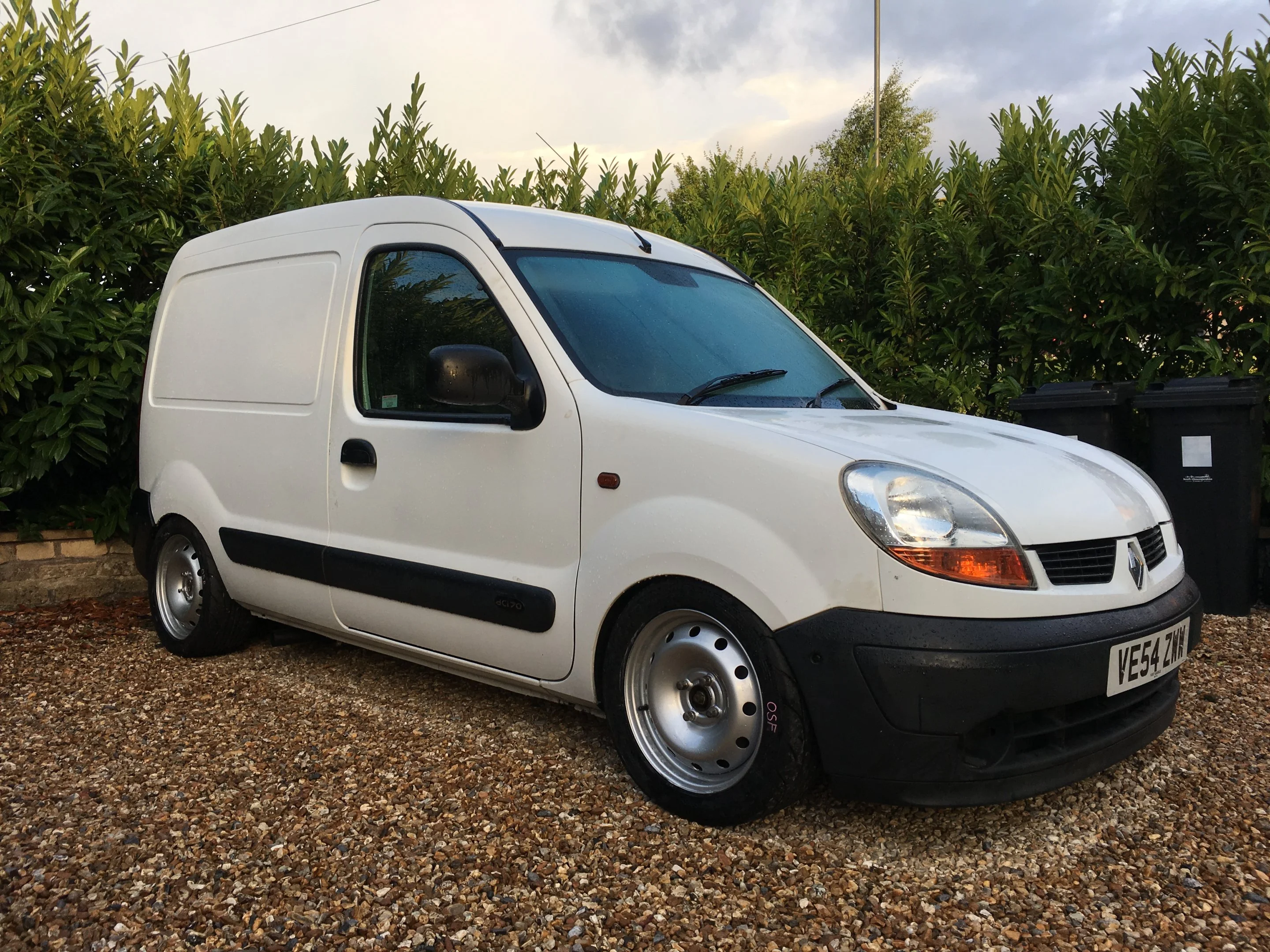

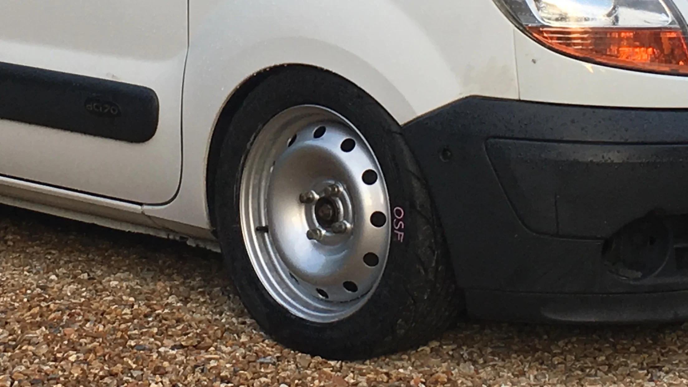

How the f*ck did you get it so low at the front with cup shocks?
The bottom of the van may be the same as a clio but the wings aren’t. These springs make a clio look a little bit lower than standard.
When I had standard 182 springs in it, everyone thought it was lowered. It’s just the location of the wing in relation to the running gear.

So are the arch liners that low too, scrub city?
Dicky Belly
  Whichever has fuel
The only thing that rubs is the front bumper and front wing. Everything else clears easy.
But I’m raising it back up at the weekend. It’s too low to be able to go fast. And that’s what I wanted it for in the first place.

How come you've gone for a side exit?
Dicky Belly
  Whichever has fuel
This is epic, moreso by the fact it's on steels. Proper stealthy.
Local exhaust place wanted £400+ to build a stealth system.
So my scrap bin rummage was free, paid a mate £40 to weld it together, mich easier to go out the side than to try and make something go over the rear beam.

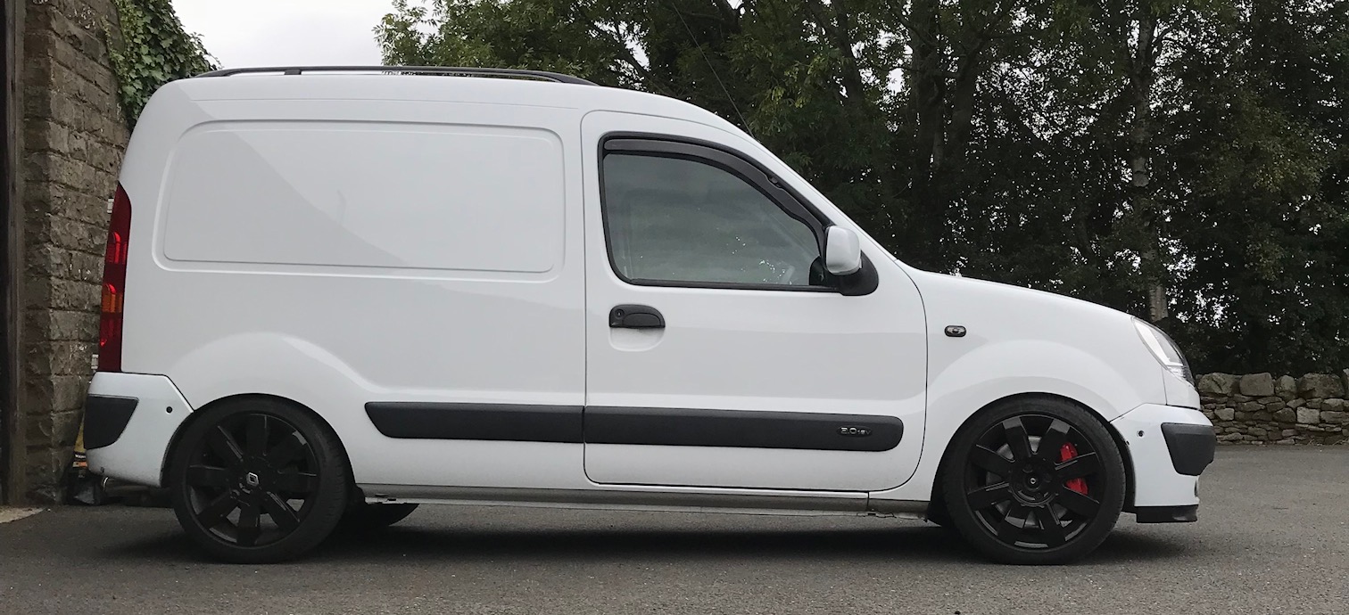

Having a blast in this thing so far!
Today I managed to find a set of Eibach Proline springs so fitted those and it’s sorted the front out by raising it from the horrible eBay springs I had. No more scrubbing and no more bounce.
Also found a set of camber bolts so they went on too along with Brembo HC discs, DS2500 pads and some supergold ATE fluid.
Just a couple of minor little niggles to sort and it’s there.
Went out tonight to bed he pads in properly,ended up having a tear up with a new Leon FR and the bloke applauded me at the next set of lights whilst grinning his head off, and then a bumper to bumper 0-120 with two guys in a Corsa VXR who again when we stopped, were laughing lots and the passenger shouted ‘BEAST!’ Then he noticed the smoke pouring from the brakes and looked rather worried... lol
It certainly brings a smile to people’s faces.
A quick pic after I filled up with fuel. Which I keep having to do as the bloody fuel gauge doesn’t work..

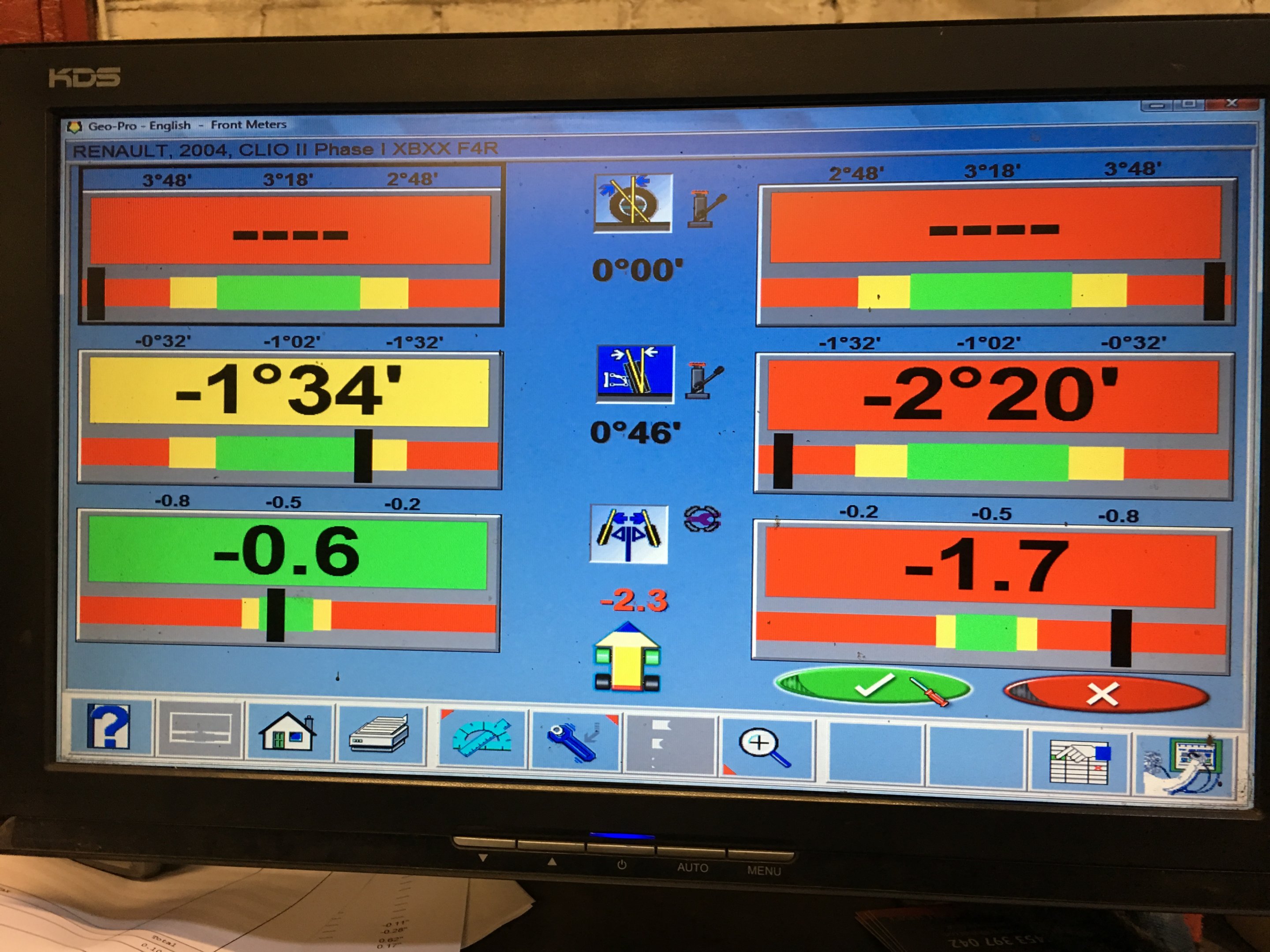

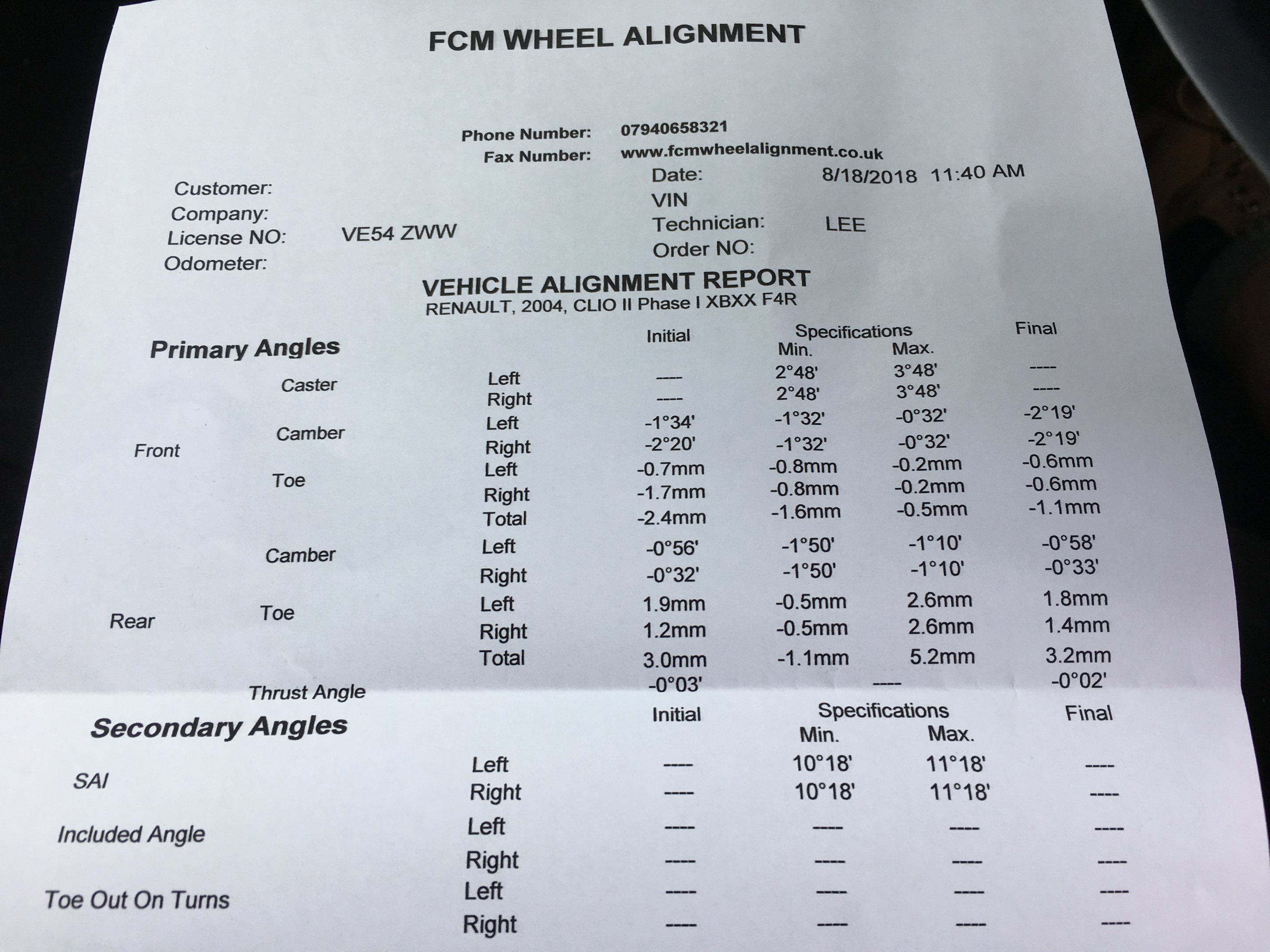

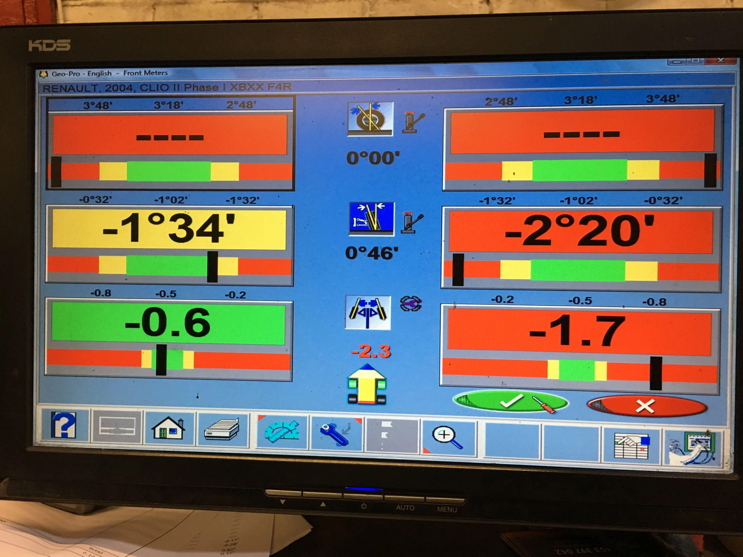

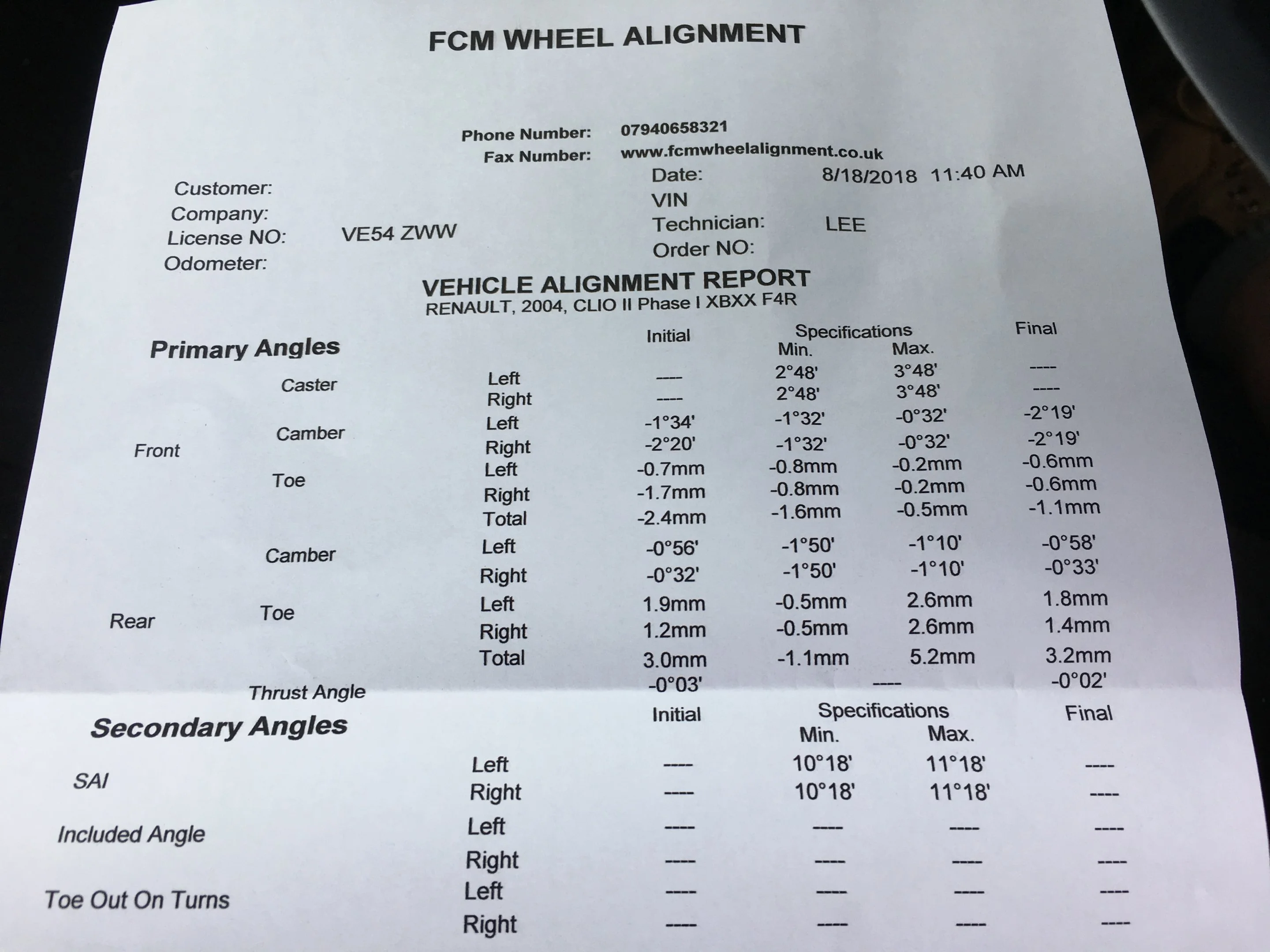

Today I took it for proper alignment, as I’ve fitted camber bolts and 182 cup hubs and the wheels were all over the place. The pics below should show this... lol
So my prep for CSF will consist of Monday night doing another engine and gearbox oil change, fit two new ABS sensors, for polybush dogbone, and a quick spanner check.
After alignment today and cutting out some of the front bumper, (for brake cooling as well as wheels) I have no more rubbing and to say I’m pleased with it is an understatement. It drives LUSH and I cannot wait to get it on track. ?
