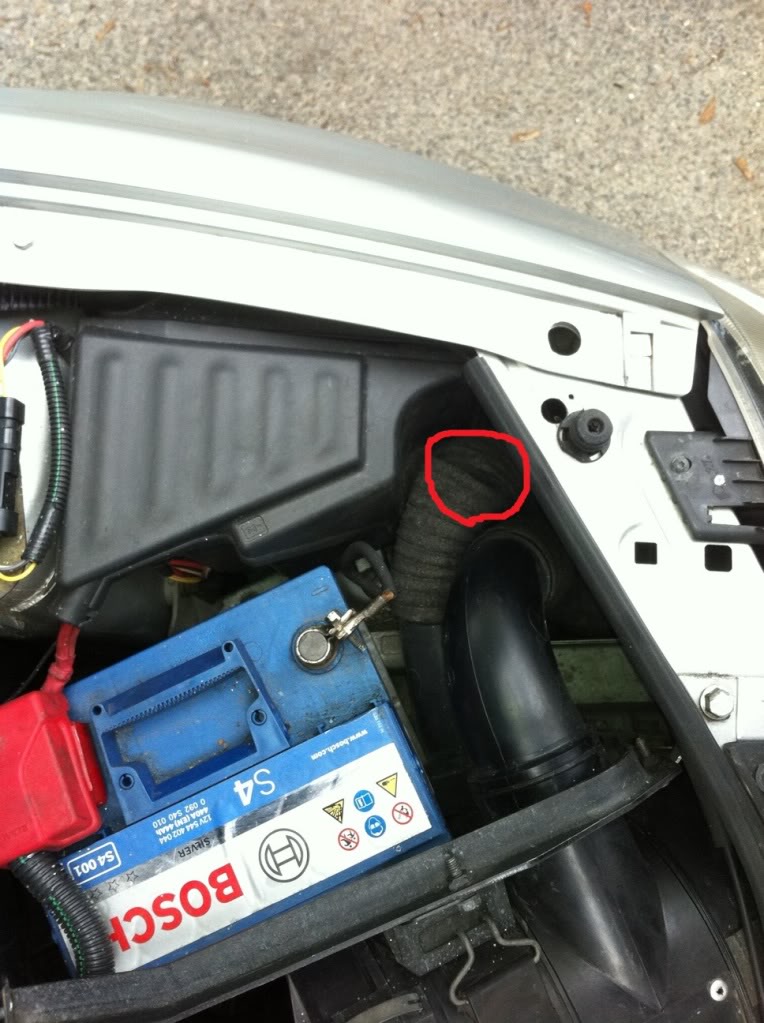

My 01 ph1 172 has been developing problems over the last few months which i assume are related to the throttle body.
Its idling now at 2k rpm & engine is now hunting. I've also noticed one of the pipes from the airbox has perished. (Highlight in red below).
I'm going to get a mechanic/mate to clean it tomorrow but just wondering how much these cost in the UK.
