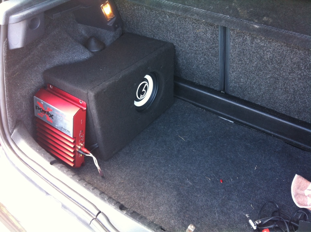

Or if your feeling creative make you own. Here's my attempts cost me £30 for bits and £15 for a second hand amp. Just need to tidy the wiring up and work out where I'm going to put the amp

From here in, all you might want is a small sub, which will help free up the standard speakers to deal with non-bass.
And that, sir, is a stage 1 ICE Remap :)
