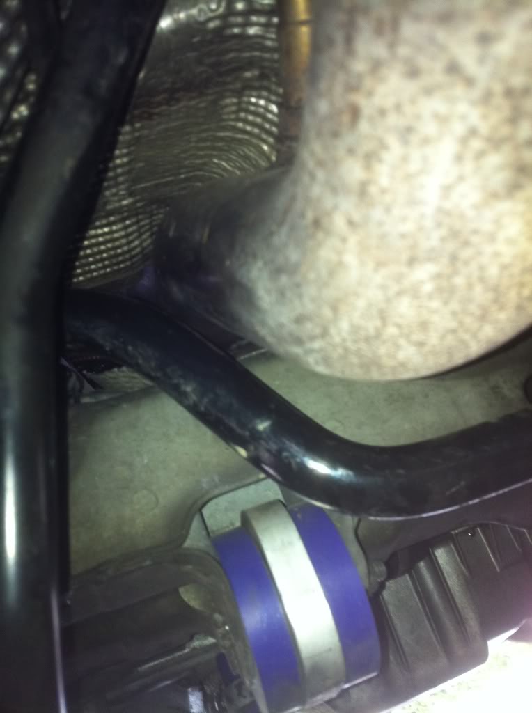

recently started getting some vibration when accelerating hard, git under the car and had a look and notice that the anti roll bar was really close the the exhaust
like so,
that surely is far to close for the exhaust to sit :dapprove: ?

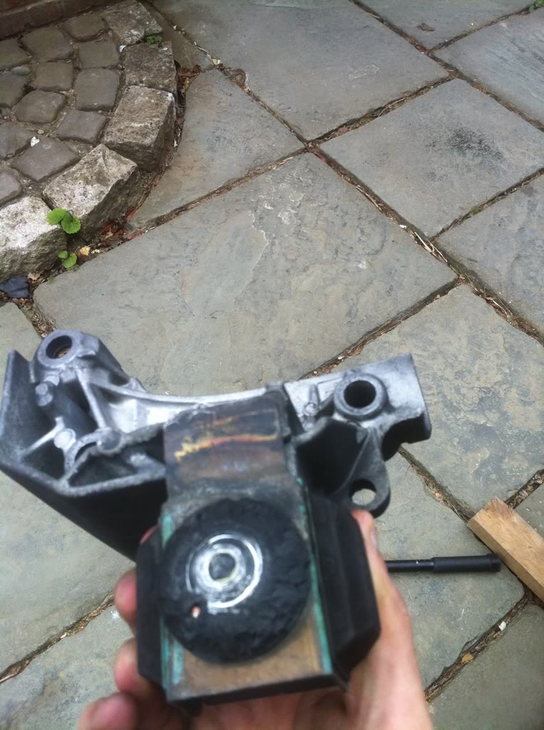

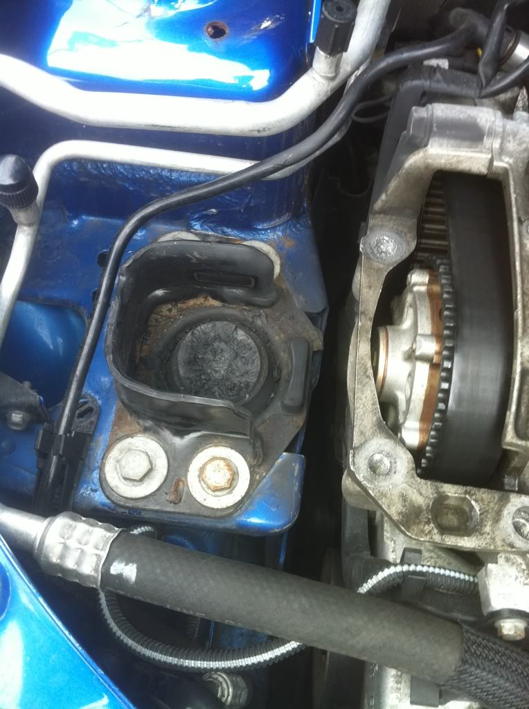

As i then removed the mount i come across this,
so all i ask is when i get my new mount through the post has anyone got any ideas on how to get the exhaust to sit a bit further away from the anti roll bar as it has obviously been touching as the paint has been taken off the anti roll bar and there is a mark on the exhaust.
