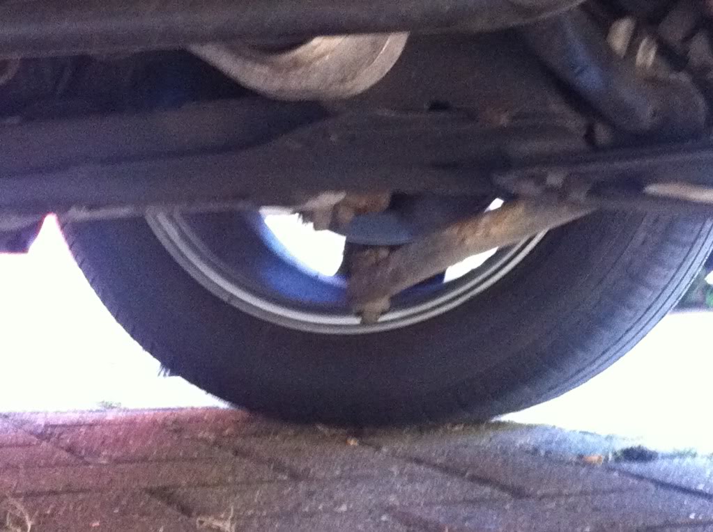

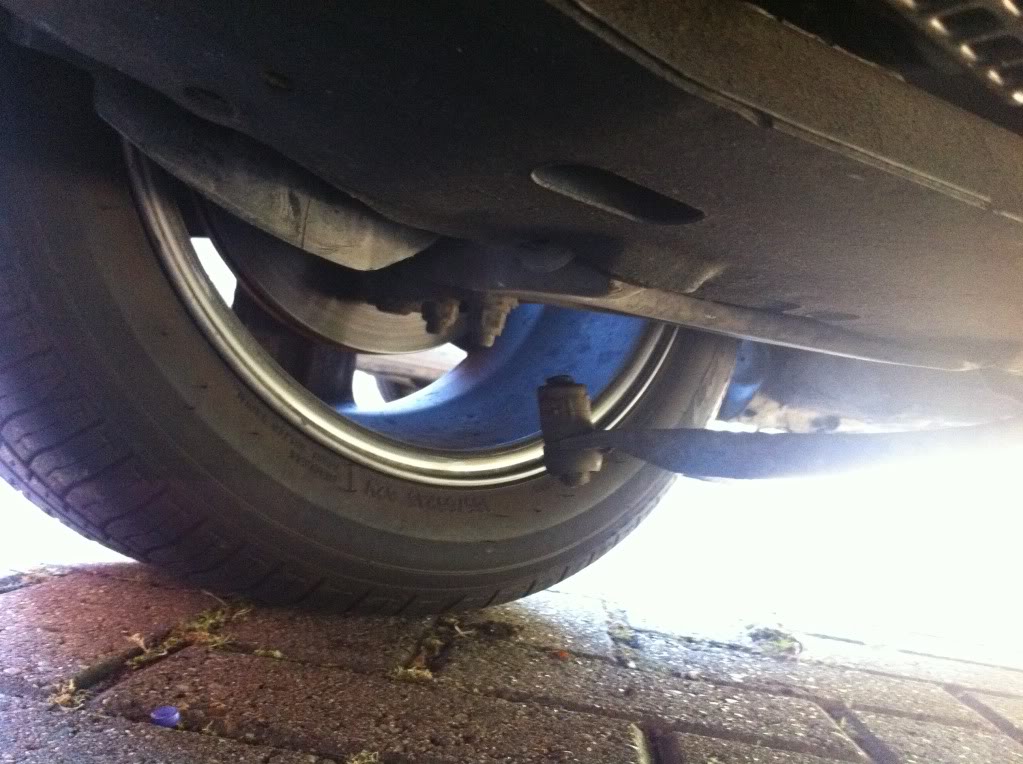

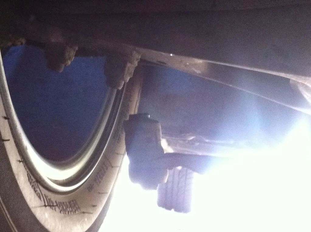

So I go in for tracking, and the guy says my antiroll bar has fallen off! :/
Sorry for shocking iFail pics but its like this at both ends:
What parts do I need to fix it?

my 1.2 clio done this but it had cleareley sheared off, yours is slightly less obviouse id say you need a new drop link. best to do both tho.
they're an incredibly common failure, bit of a **** to fit new ones, wouldn't fancy it without the room a ramp gives you for leverage
I don't have access to ramps ATM do I'm paying a garage to do it.
I wish I lived closer to you 519!
It shouldn't cost a lot matey, they're front arb links consisting of a bolt, rubber bushes and a nut. So you will need two. As Danny said, really common issue but don't let a garage rip you off. The parts retail at around £7-£8 a side iirc. Don't know what your looking at for labour though.
As Jack says, parts are cheap. On Heathers car (Jacks' mrs) it proved cheaper to replace the bottom arms at the same time as the balljoints were buggered too, and the drop link bolts were seized solid in the arms and rounded off, so labour would have been at least as much as new bits
