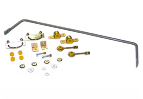

Hi guys. I have ph1 1.6 Clio and I want to improve handling.(it's on coilovers)
Does it really improve handling and is it worth money?
I was looking at whiteline anti roll bar, plus I'll putting front strut bar.
Cheers.
Don't bother with a front strut brace, they rarely do anything.
Rear ARB is a decent upgrade, but if yours is a 1.6 it'll probably make it too stiff at the rear and put the handling all to s**t.
Can you fit a 172/182 front ARB first?
