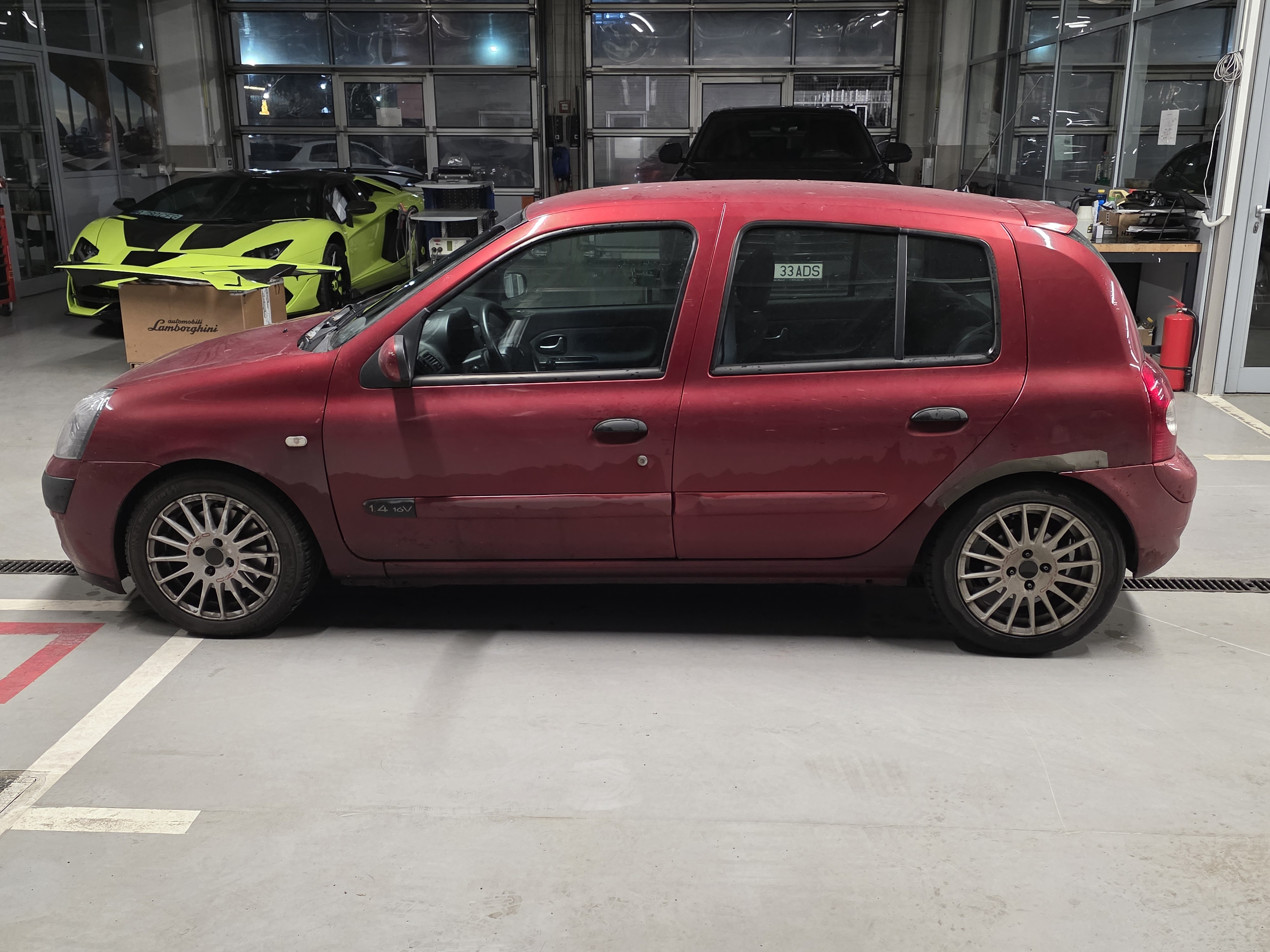

I ve put every suspension bit from a clio 172 to my stock clio but with coilovers from Gaz , car is wider now and more stable also im running michelin pilot sport 3 on it .

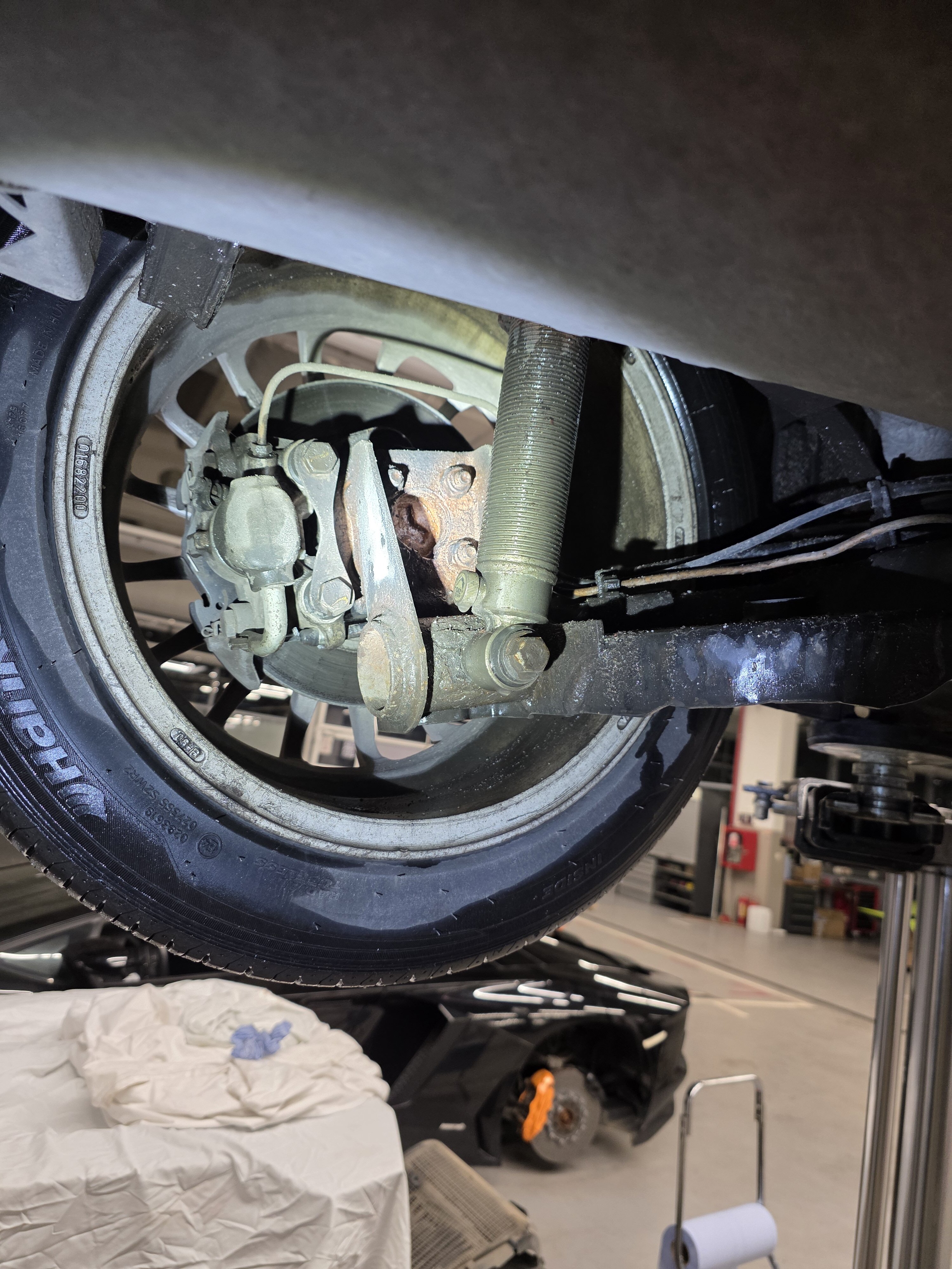

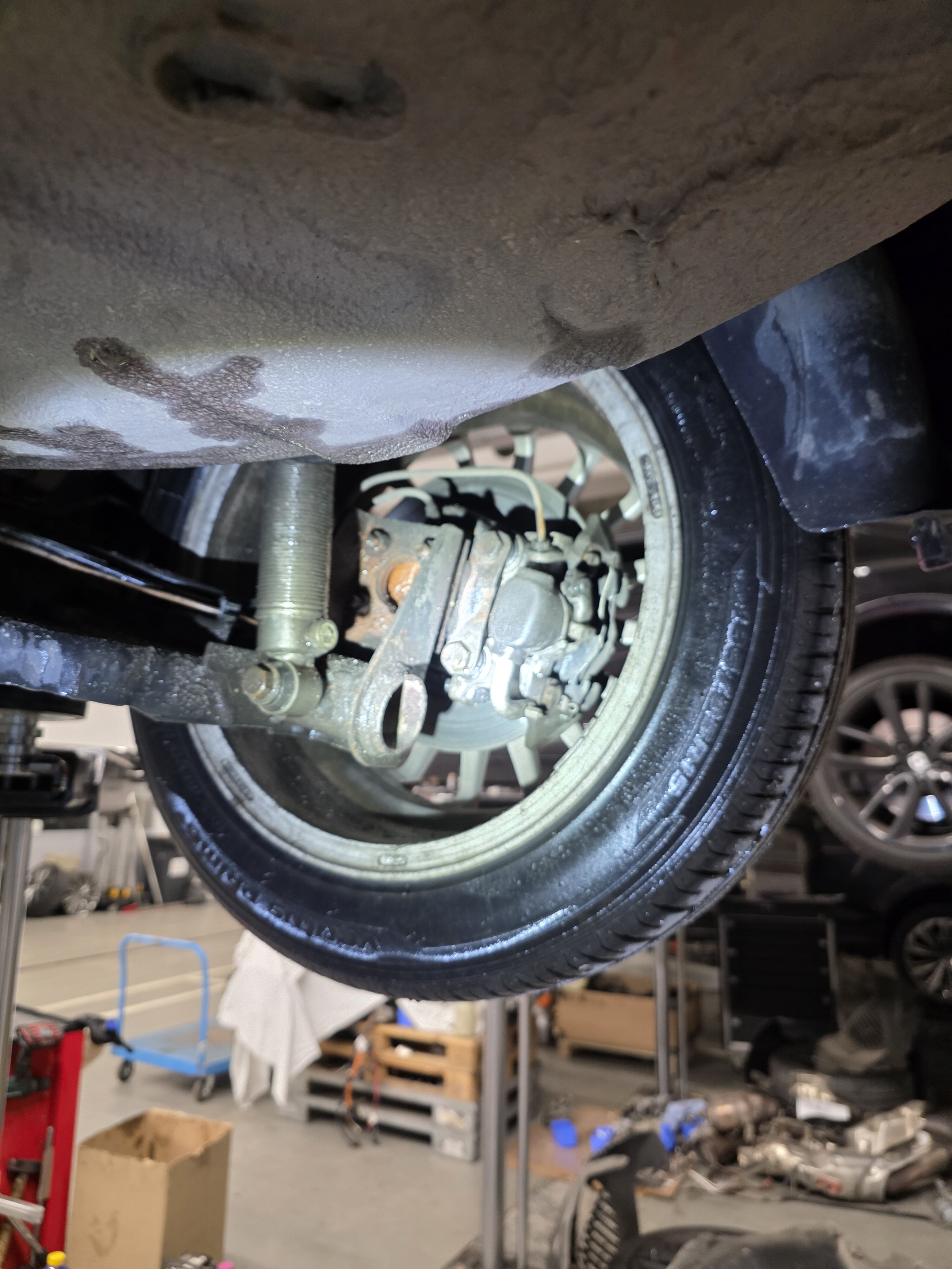

front hub carrier (because they have the 54 mm spacing to use the 172 suspension ) caliper carrier and front calipers from clio 172 , front lower wishbones from 172 , front antiroll bar with all brackets from 172 if you want 172 driveshaft you need front hubs too or you can use your hubs with your driveshafts regarding rear parts it s all about disks and there you need everything , rear disks with caliper carrier and caliper , stub axle on both sides with the washers that go behind the disks , brake pipes you need to manufacture from zero , i will post some pics on my car what i ve done .
As you can see the car is wider and the wheels are sticking out a bit , regarding rear brake in my country i couldn t find the flexi pipe for rear calipers and just done a complete rear pipe from copper , i know is not perfect but maybe i will find those flexi pipes .
