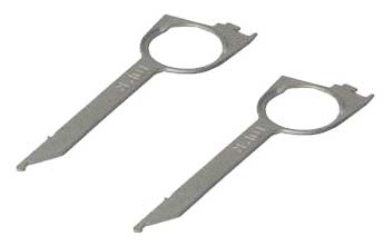

if you have the pocket underneath the radio itll be a breeze to fit as there is plenty of room.release key wise you want these:
but you can make do with these
