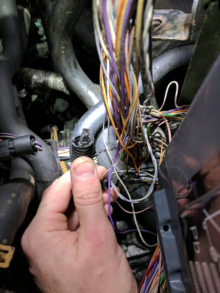

when my car was acting crazy it was because of a loose earth wire. There are are 4 i think in the engine bay. the one that gave me problems was attached to the back of the gearbox under the airbox.

This is the wiring loom earth mentioned in post 6.It should bolt to the rear of the gearbox behind the battery.

Could one broken earth really cause all the fault's with the windows light's wipers etc
and all the relays clicking.
I'll check this wire tomorrow thanks.
Very possible.

So I checked but couldn't even find that earth connection, however as I suspected it was the UCH I removed it and sent it away for repair, and yep it was the UCH, cost £60 and had to send the key with it, but two days later it was back and with a new key fob
