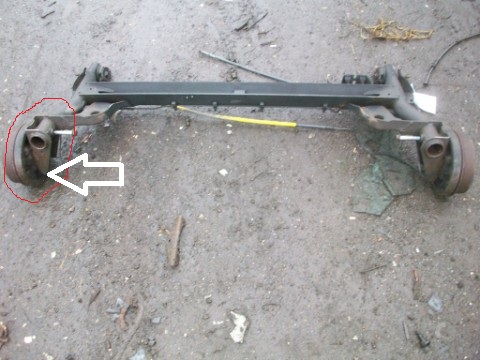

have had it up and to me it looks like the hub is bent down ?
this is NOT mine lol
but were the arrow is its bent to the right on mine,
could this be the problem ?

FAIL! sorry did see the word rear!
then yes, either youve knocked the rear axle out of alignment, or bent it! :(
