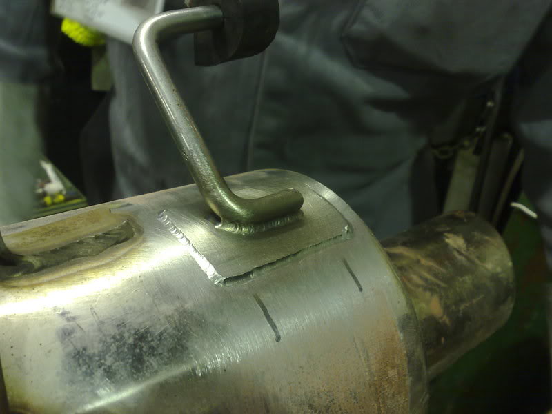

I aint bad though ;) I had to repair my ProSpeed after it fell to bits.
Bad design + bad welds =
Laingo + Practive + Instruction =
