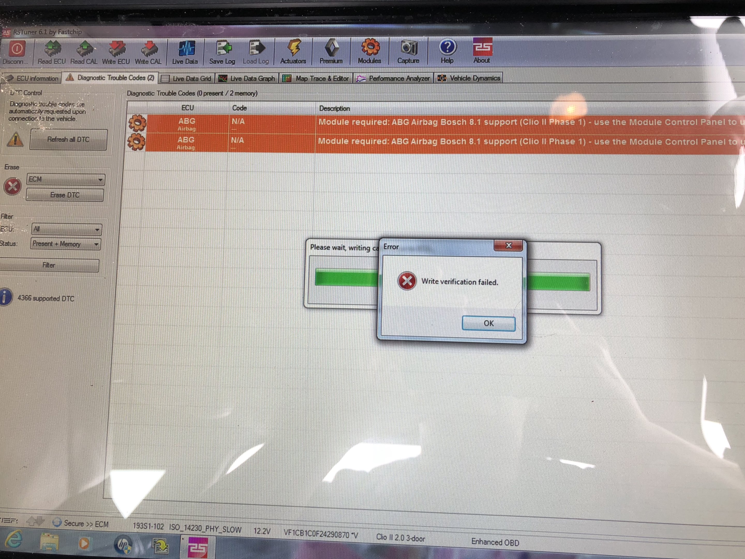

Waited 5 days to get unlock code and file and when it does finally arrive I get this error below, I then have to reinstall the old cal backup file to get car running again.
Emailed Hank or what ever his name is and all I get back is instructions he sent the first time around, I'm not f**king restarted there is something wrong with the file.
Anyone else had any issues? Guy has gone quiet now.

I believe they have stopped supporting 2nd hand rs tuners so that might be your issue if it’s been used on another car before.
Ant1
Brembo! Brembo! Brembo!
Unlock I’m code works just not new map. If they don’t want to support why offer?

I did exactly the same as you have a couple of weeks ago. I had to upload the most recent RS Tuner software. I then had to upload onto the ECU the most recent software. I then uploaded the new map no issues. Runs much better than the previous map.
There was a part of the instructions that confused me a bit. To do with when you write the ECU. I watched the two you tube videos.
I also run an optimate on my battery while doing it as if voltage drops too low that also causes problems
