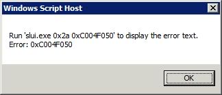

I've got to a point where one of our Windows 2008 servers is (I believe - it's virtually impossible to tell) acting as a KMS host. Any licence file I apply to it however gets rejected with an error code that simply means the licence key in invalid. I've triple-checked this key with Microsoft and it is indeed correct.

What is the error code that is being generated and what version of 2008 server are you using?
I get the following message appearing...
I haven't looked at all the causes on here yet http://support.microsoft.com/kb/938450 - but most of them seem irrelevant, tbh. I'm running Windows 2008 Standard Server x64 on the one I'm trying to setup as a KMS host.
