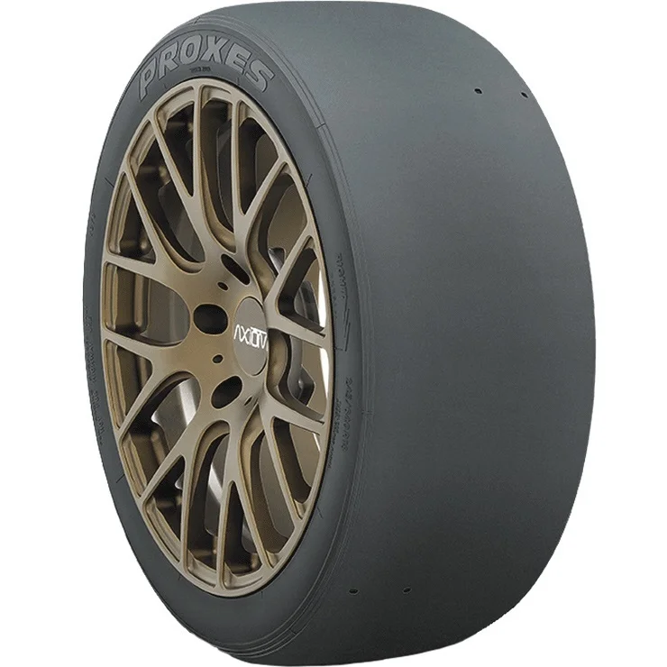

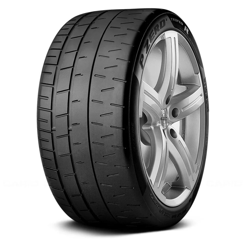

Can get hold of a new pair of Toyo RS1 slicks (GG compound) cheap and was wondering if anyone had ran slicks up front and R compound tyres at the rear? The rears will be Pirreli Trofeo R's which are pretty much a cut slick anyway, all 4 tyres are 205/50/15. I would purchase a full set of slicks but he only has the 2 available.
Thoughts?

I haven't personally but spoke to a chap with a mk1 golf with a 350bhp VXR engine in it and he ran slicks up front and R888 GG's on rear as he was worried about not getting slicks up to temp, he liked the balance like that for his application
personally I've never had a n issue with lively back end with slicks, seem to get the temp into them fine, but realise this isn't the choice you have with what your looking at so i'd say suck it and see tbh

Yeah @JamesBryan has mates who've ran similar set ups on their track Meganes. I've ran track tyres up front and road tyres at the rear without issue but I know I'll be going quicker with slicks so will be different.
Gonna take a punt, if it gets to hairy I'll just throw the slicks on the rear.

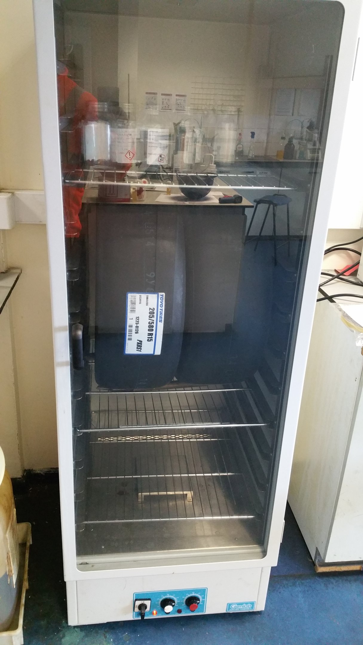

Could really do with heat cycling them at least the day before but how do you go about that on the road, lol. Got a big oven heater for heating frozen chemicals in work, will just bang them in there for an hour or so...similar to what Toyo now do.

Got them up to 70c using the industrial oven and IR heat gun to check the surface temp, but think they will need another cure with the oven turned up once cooled. As to the touch they just didn't feel as hot as a few laps around a race track. I could get the R888's to a point where you'd burn your hand, these where hot but not so hot where I had to pull my hand off them, I need something in-between.
