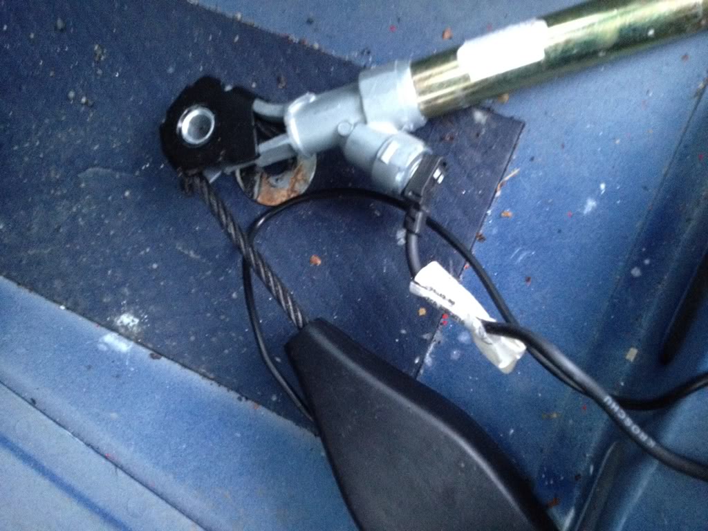

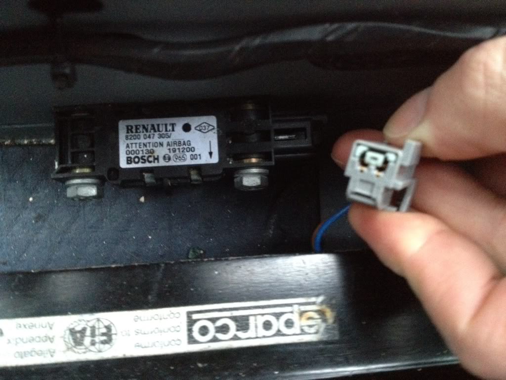

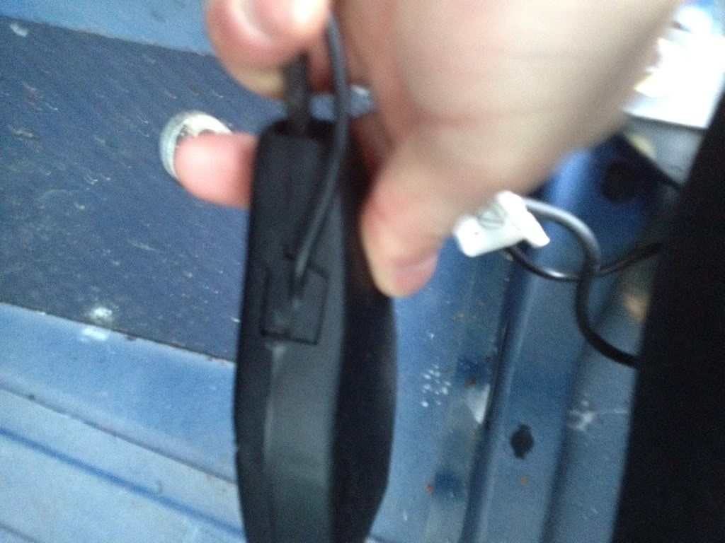

The pictures below is all of the connections i had on the seats, its the same set up both sides apart from the small black wire and connector going into the seatbelt clip.

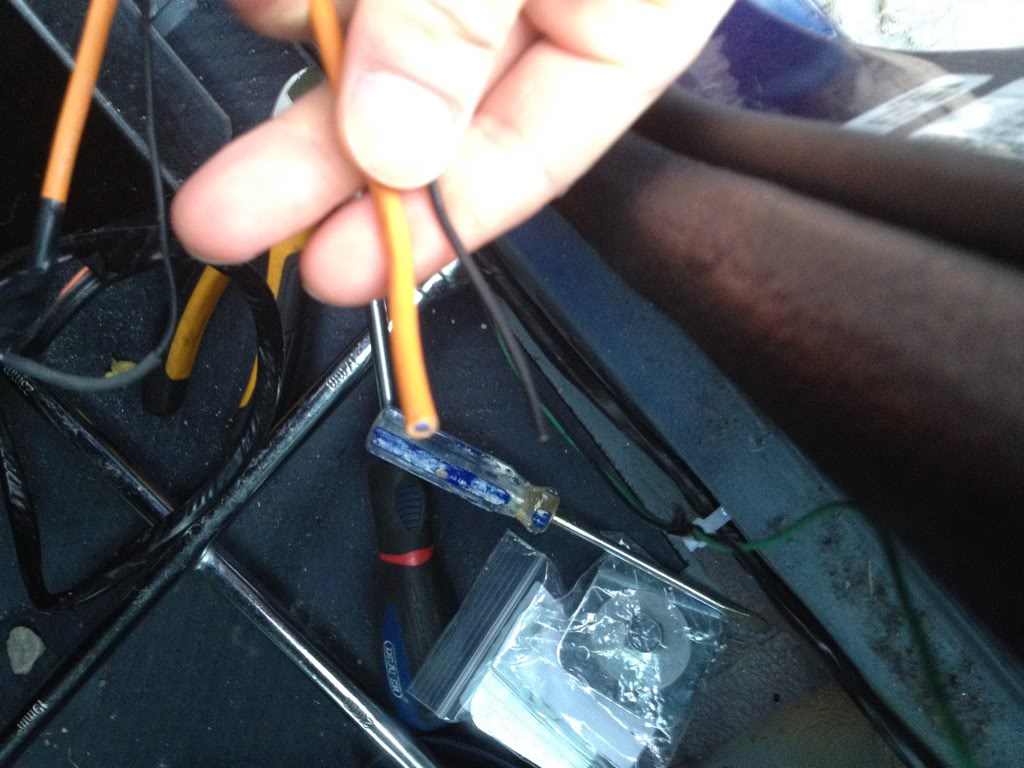

The orange sheathed wite has a brown and blue wite in it and had too be cut as it was connected somewhere inside the seat.
There were no other connections under to or connected to the seat. The seat does have airbags in it.
All of these connections run into the airbag ecu.

the cable that went into the seat is for the seat belt light, i swapped over some seats in my girlfriends car and came across that
ah ok, thanks for that mate. is the seatbelt and airbag light the same thing? or am i looking at the wrong thing?
