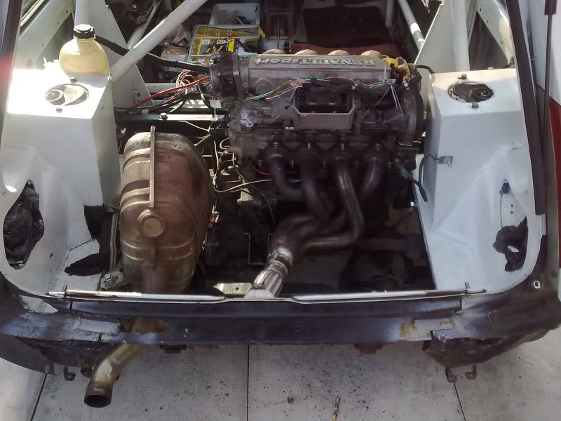

Hi there, I'm running or should I say planning on running an Emerald ECU on a relativity standard 172 engine. It's actually a phase 2 engine with a phase 1 throttle body with a considerable shorter exhaust (see picture below).
I bought my ECU from ebay :rolleyes: last year and when I finally came round to connecting to it via the comms cable - I couldn't! I've sent it to Emerald so I'll keep you updated with the progress and my experiences on this post..
But so far emerald have been very helpful giving me additional troubleshooting guides and later versions of software(despite not buying the ecu directly from them). Looking at the latest version of the unit they seem pretty full featured for the money especially with the adaptive mapping. I have quite a bit of confidence in it, as the person behind it (Dave Walker) has wrote a book about Engine Management published by Haynes and is also the technical editior for practical performance car magazine and I have always found his coloumn "walkers workshop" very upfront. I'll stop here as I sound like a fan boy :)
