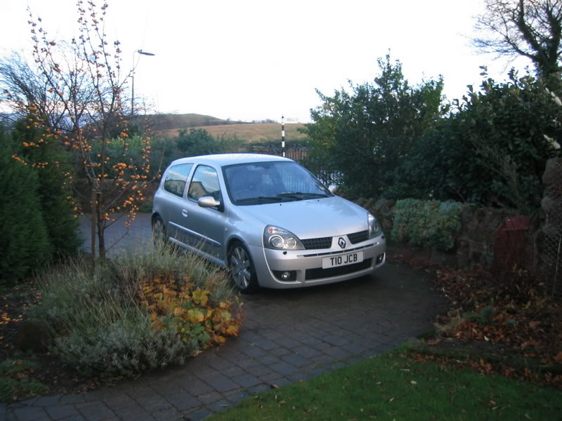

Ive got Eibach Sportlines and there are 1st class. Dont have a side pic, but think i have one of the front... 1 sec.
  BMW M3
Only pic ive got... not ideal, sorry.
