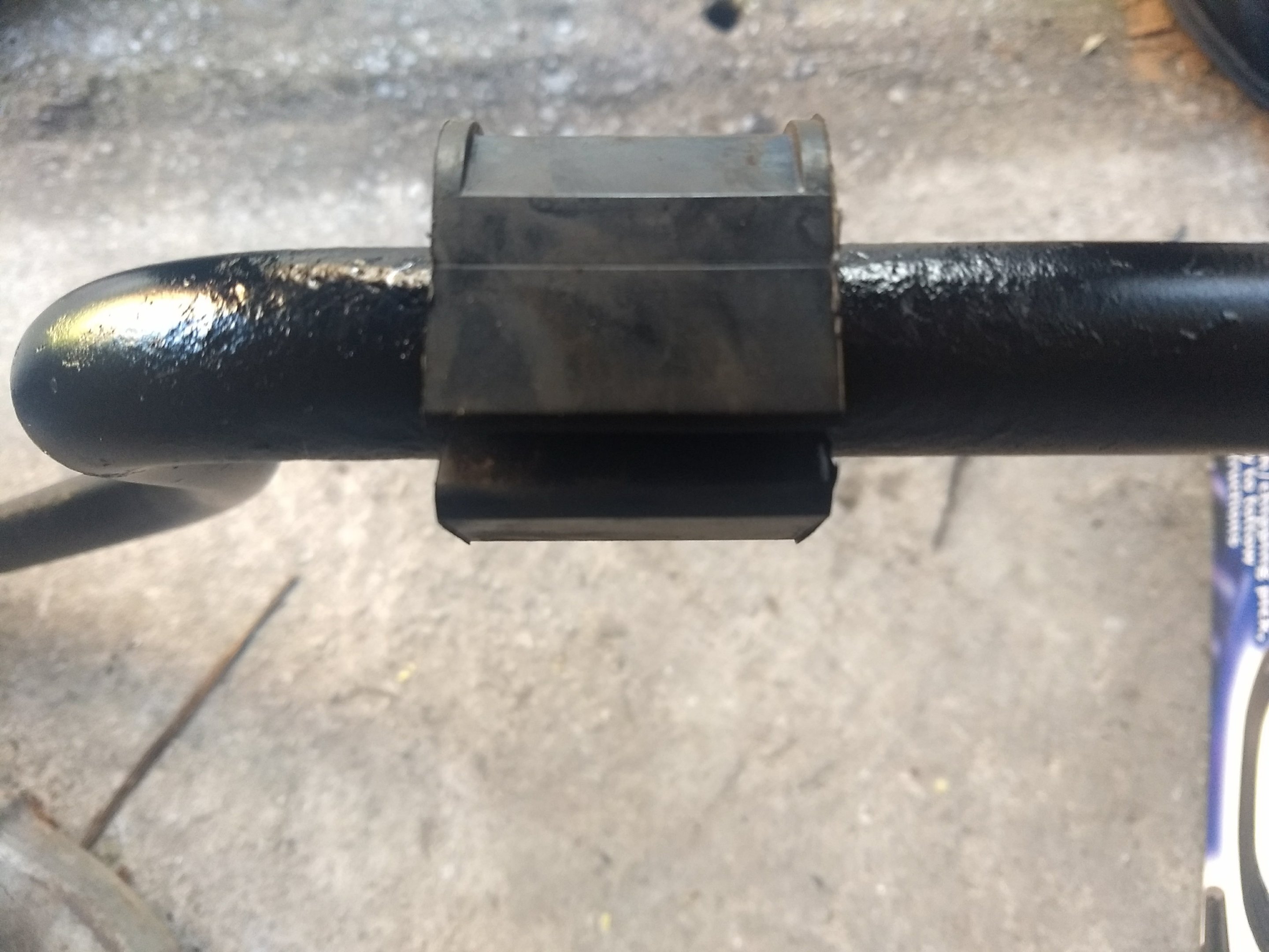

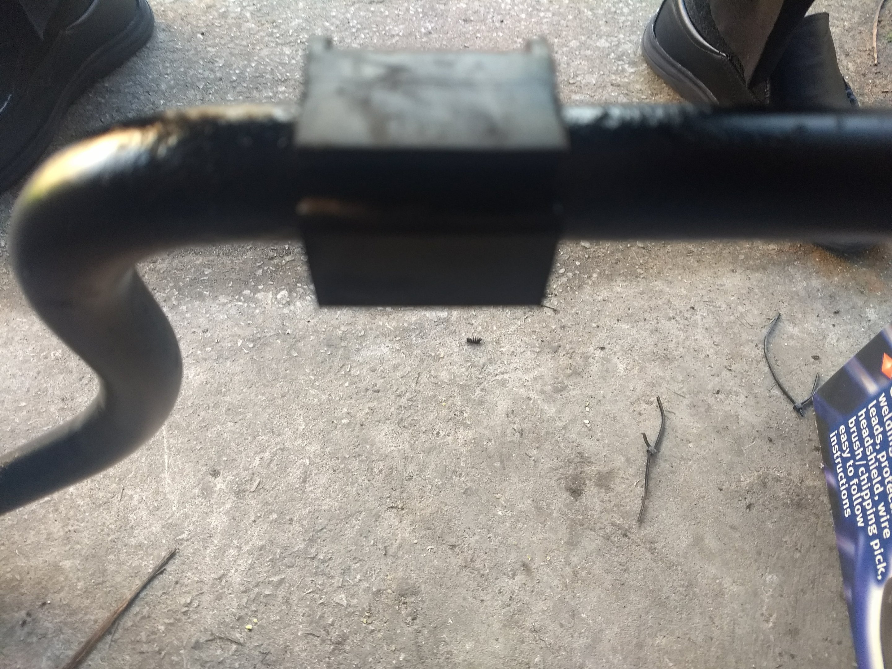

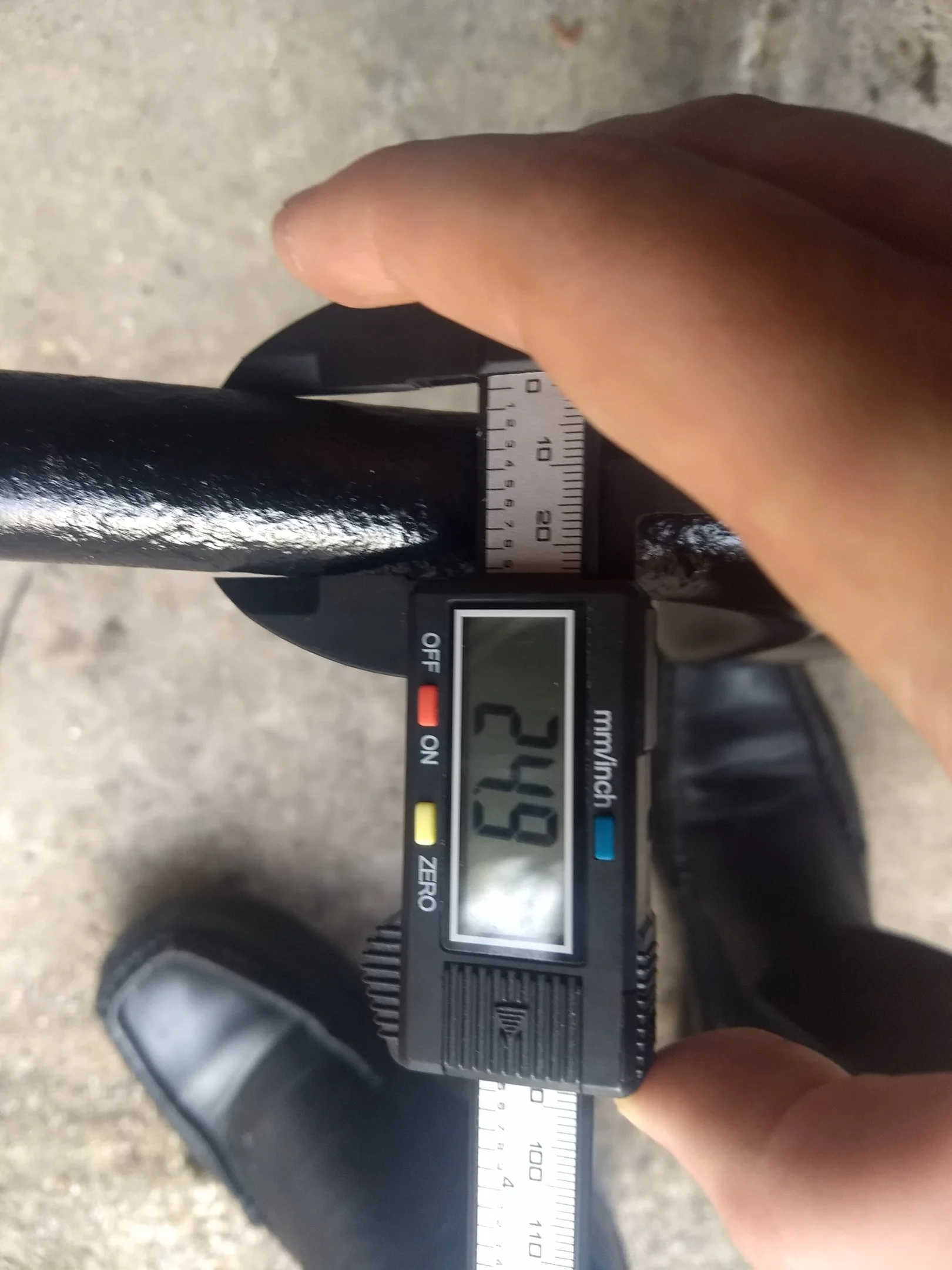

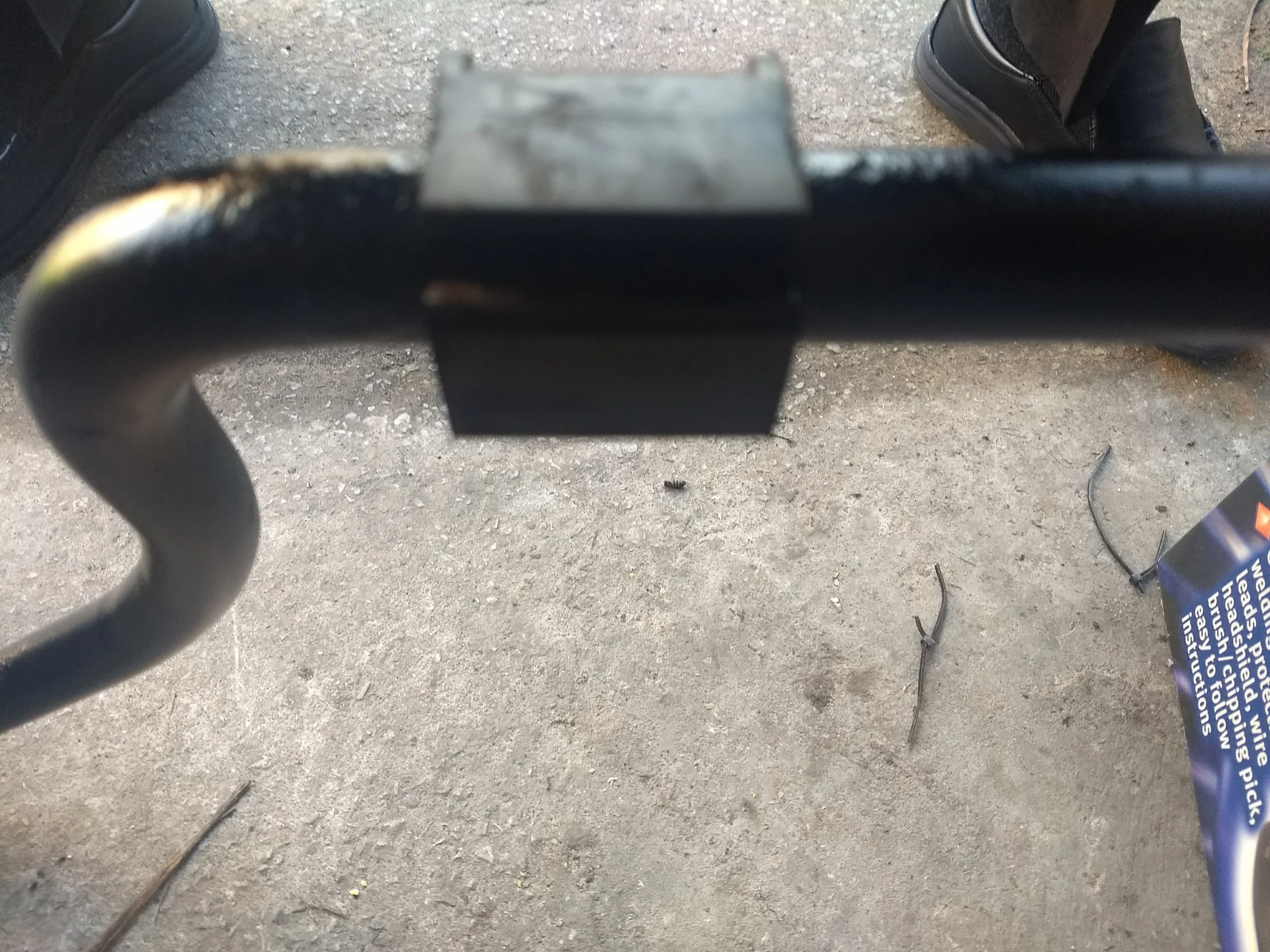

The arb was quite rusted so after numerous attempts at putting the arb clamps on i've removed, wire wheeled and painted the arb incase it was a fitment issue due to rust. while the arb is off the car I've trial fitted the bushing and I've noticed there is a massive gap where the bushing splits which would explain why i'm having such troubles fitting it as I could not see a gap in the powerflex bushes used in the guide on the forum which makes me think it's not the right size? the part i've bought is the 25mm inner diameter , having measure it the hole measures at 24mm.
help :)
i didn't get a pic of the side view but I'll post that when i'm home later to show the gap.

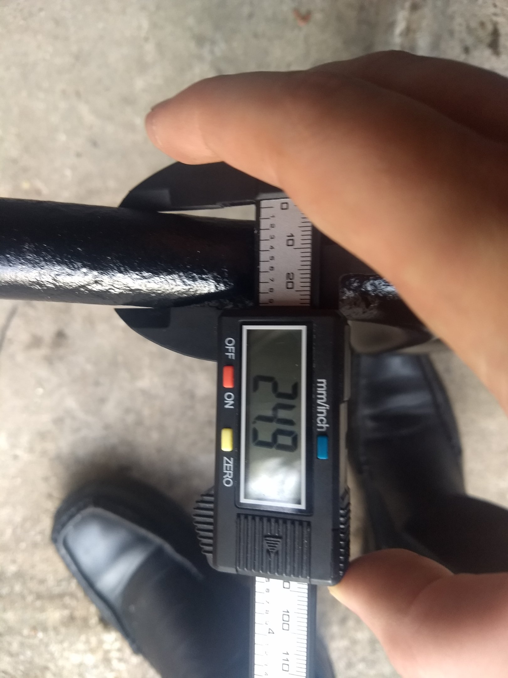

Have you measured the bar though?
Rust+paint could add some unwanted size.

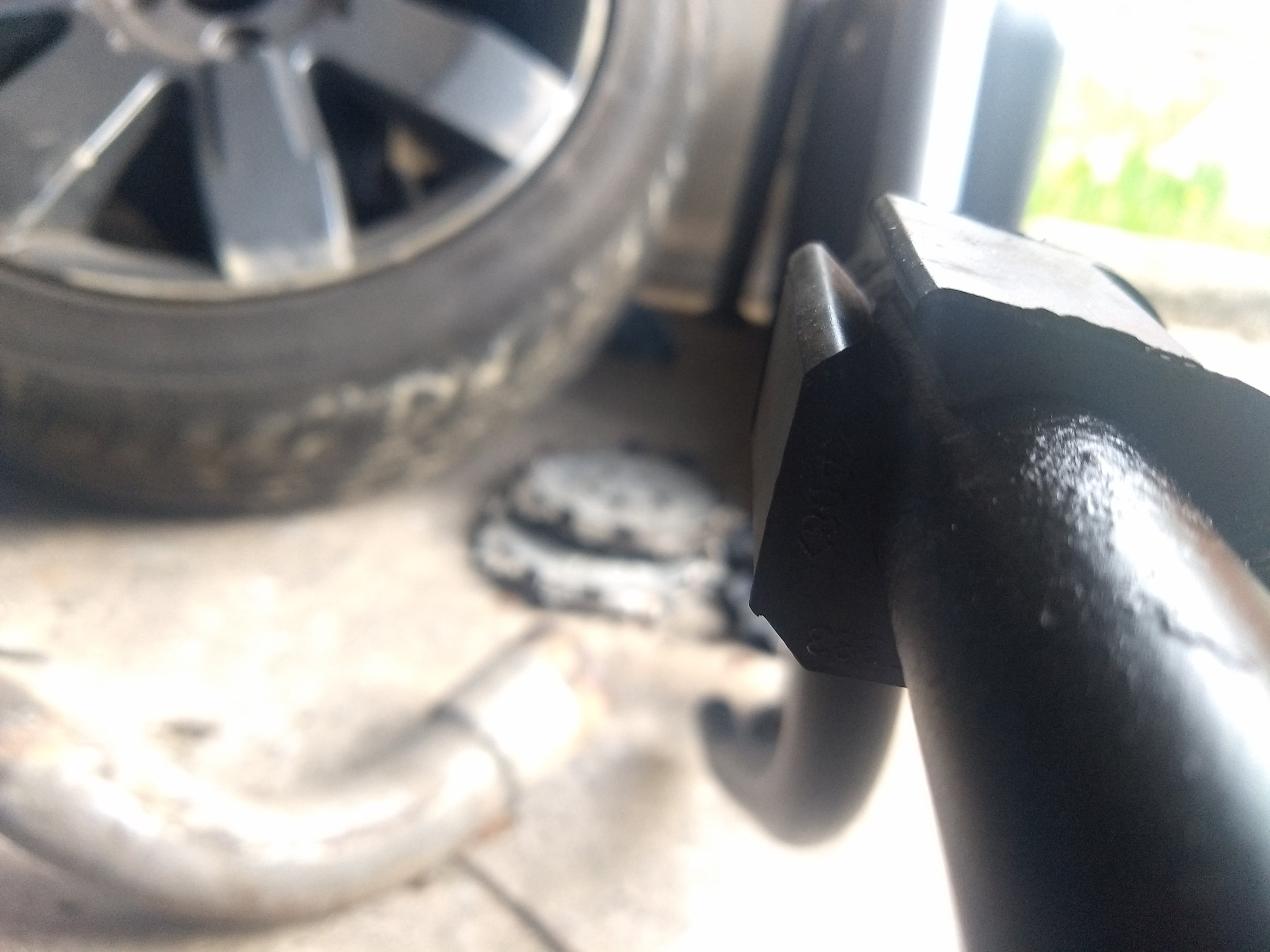

I've just measured the bar and its under 25mm, see pic. Also got pic of sideview
