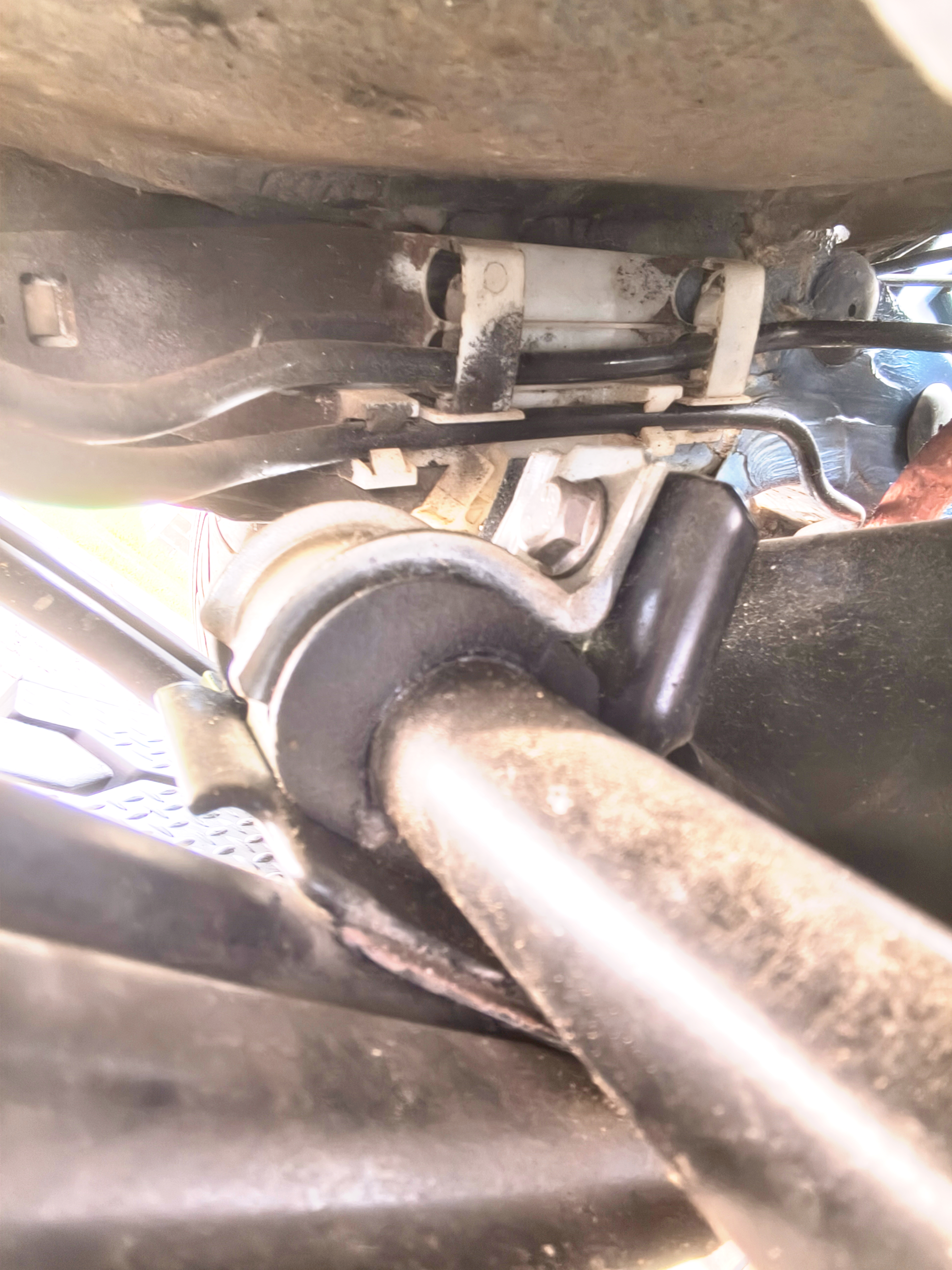

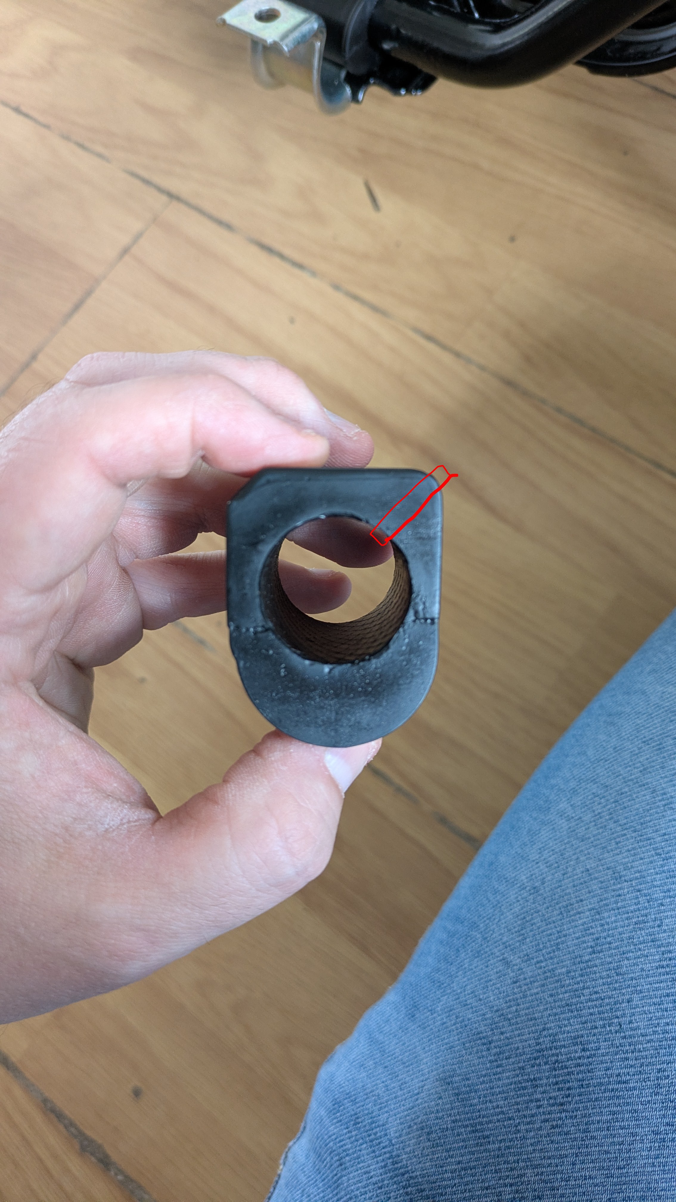

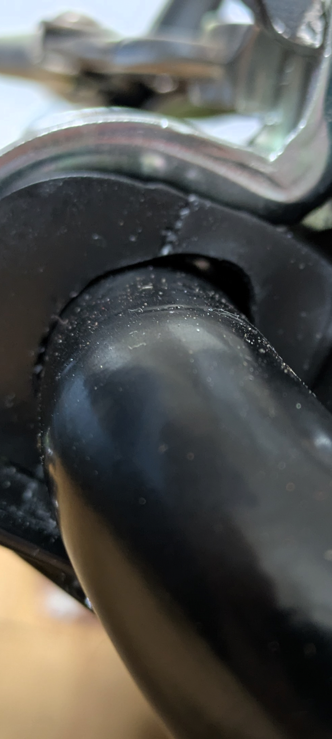

Hi All.
That pain in the arse Job of changing Inner ARB bushes.
The frame is off the car which makes it easier. I have managed to use the grips to squash it up but there appears to be a internal Gap on the bar!
I'm guessing this is not right?
Any ideas/Suggestions?
Cheers

It looks like it’s not sat fully under the arb. Haven’t a clue how to rectify it though 🤷🏻‍♂️

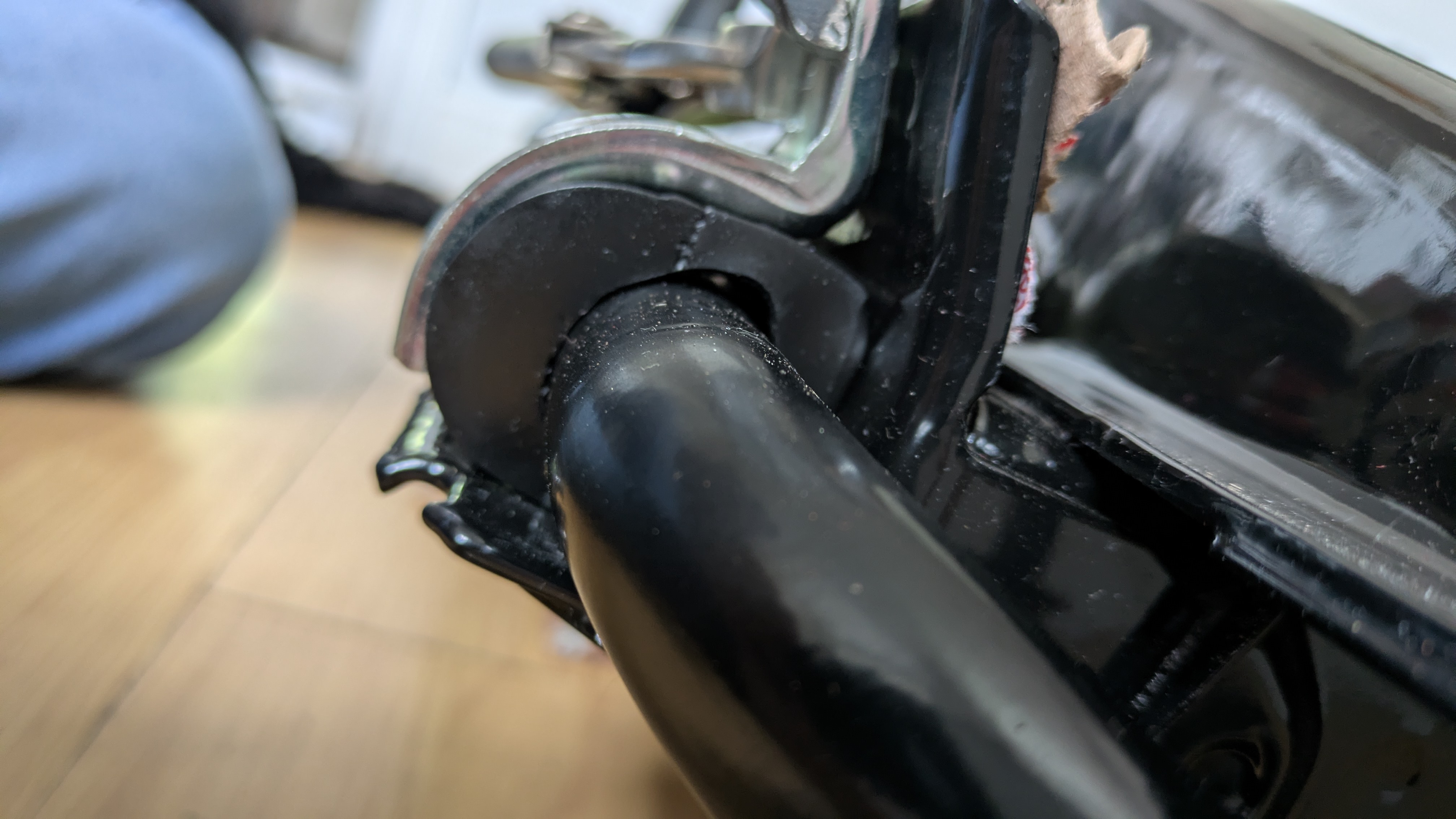

I was thinking maybe to trim the black but so it tightens up a bit more.
Like so maybe??

That's what mine looks like, it looks like you've got the wrong size bush. IIRC the cup models have a 1mm thicker ARB
That’s a good shout, forgot there was two sizes.

My ARB is 25mm I just found the vernier so no idea why it's not working.
Iv given up for today, my hands are hurting 🤣 (Pussy) maybe I will just got back to standard ones, maybe the purple ones will be the same as the black.

Mine are the black series ones and fitted no bother with a freshly powder coated ARB.
Yeah mine is Fresh powder coat as well. I just don't get it. Iv had two moles grips and used the Lube to help as well.
