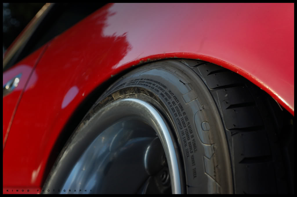

I ground away the inside lip of the arch with a grinder, worked a treat. That may be enough for you, left no mess and didnt casue any damage to the paint on the wing :D

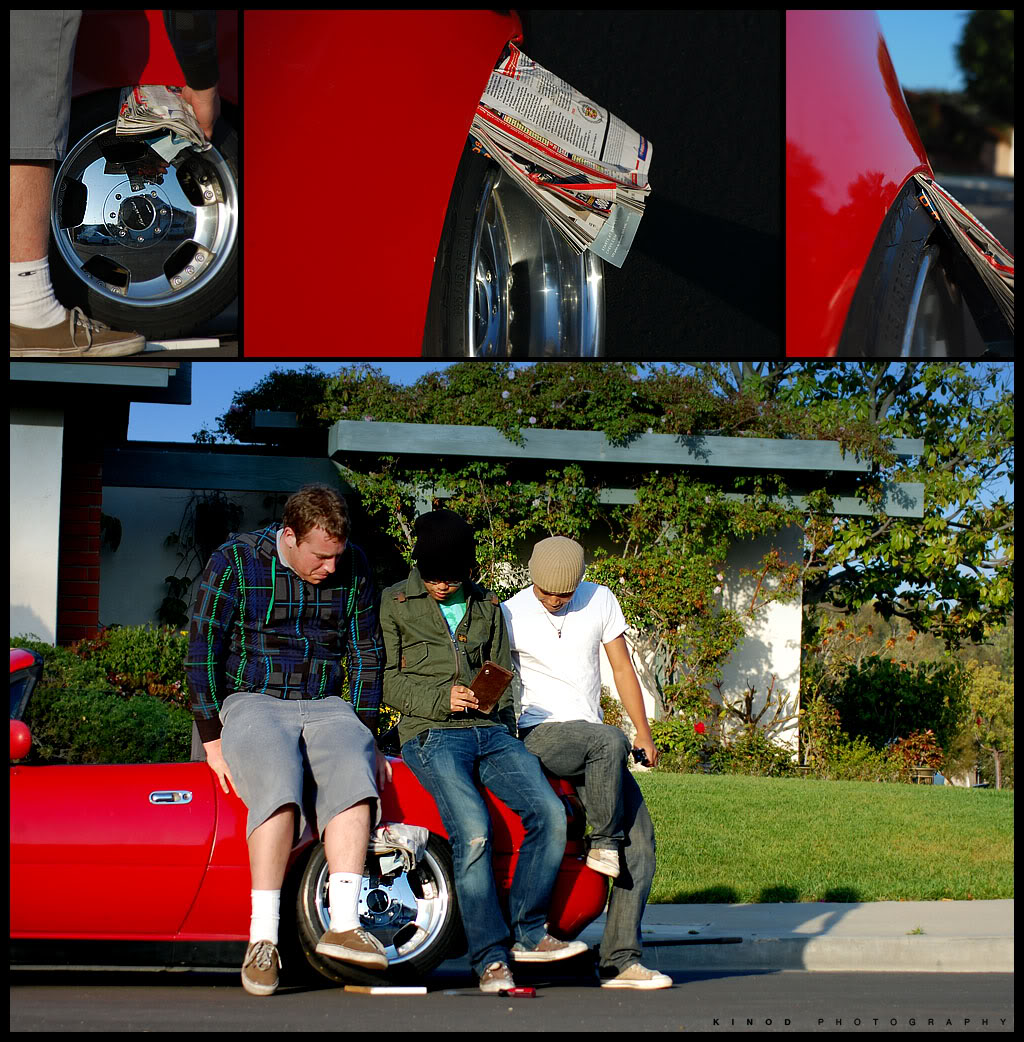

Heat gun + Magazine/phone book, mates sat in the boot, done.
