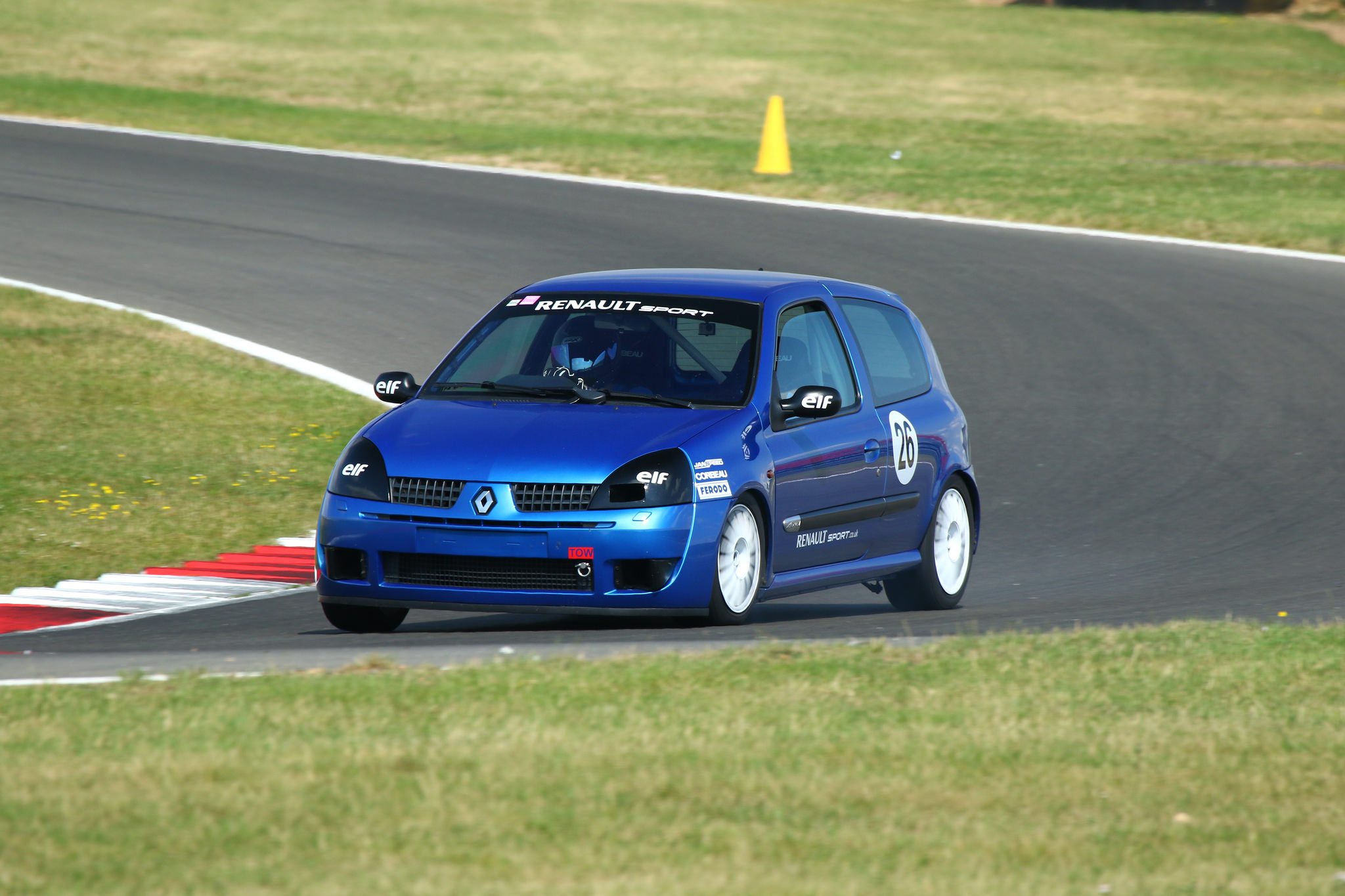

Few more from the MSV Photographer
SR_170710_MSVT_SN_1232 by danfullstop, on Flickr

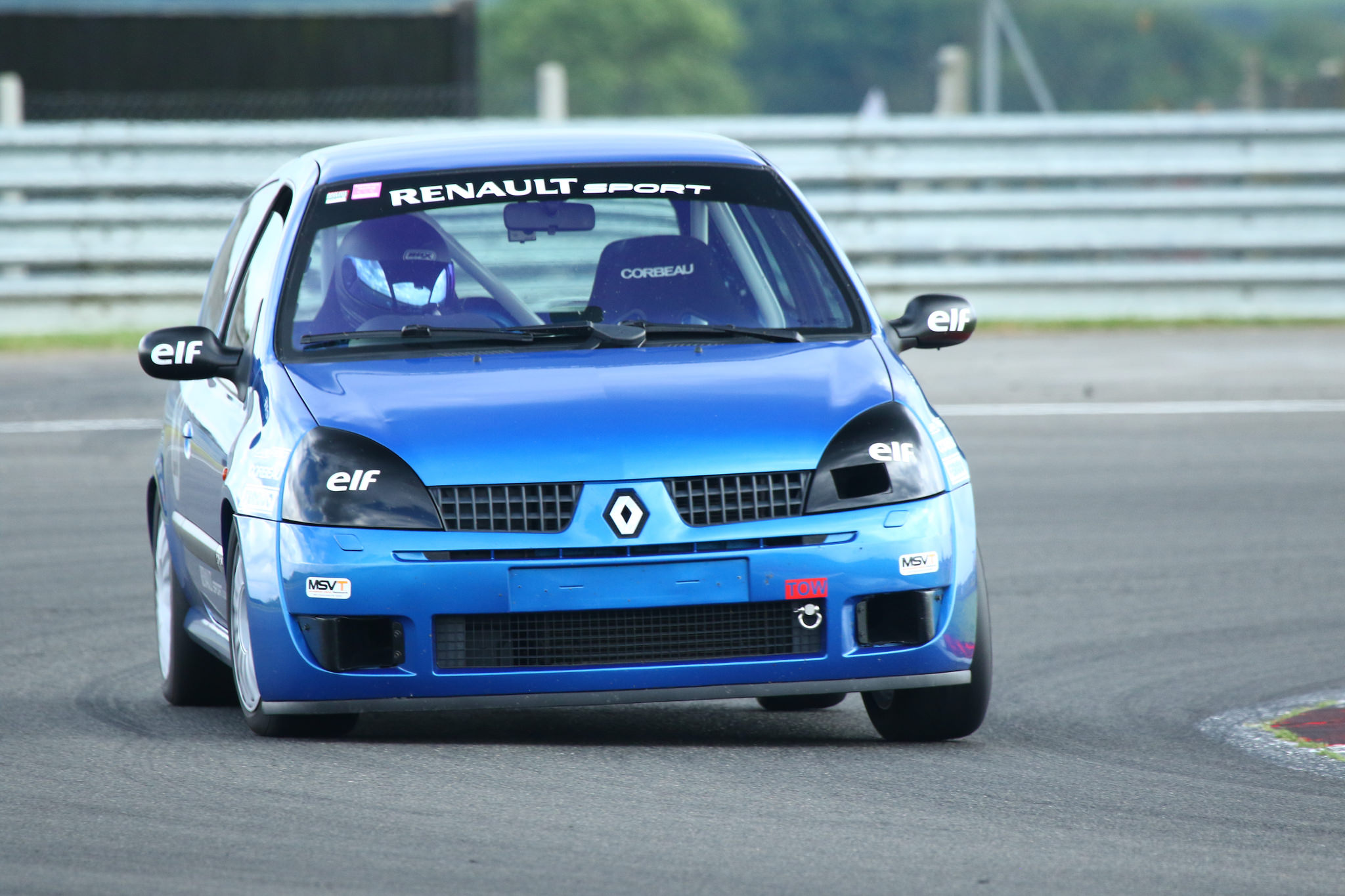

SR_170710_MSVT_SN_1720 by danfullstop, on Flickr
SR_170710_MSVT_SN_2360 by danfullstop, on Flickr
SR_170710_MSVT_SN_3419 by danfullstop, on Flickr
SR_170710_MSVT_SN_3422 by danfullstop, on Flickr
SR_170710_MSVT_SN_3824 by danfullstop, on Flickr

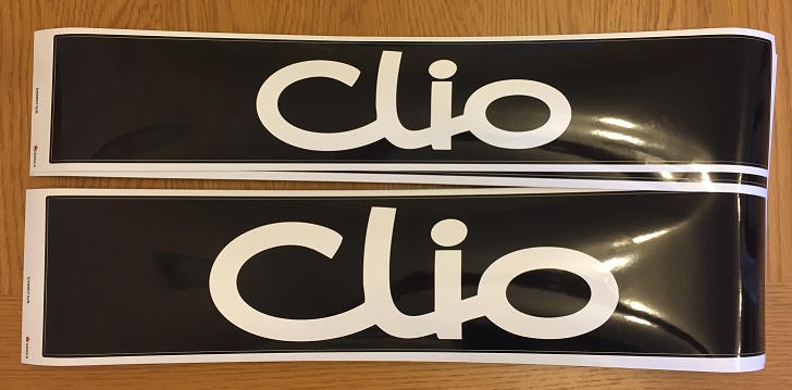

Struggled for months to try and find a place to make me up some Cup Racer style vinyl stickers, apparently no one could be arsed so I took matters into my own hands using the diginate site, designed what I wanted and had them printed.. 2 weeks later and £40 down I had these!

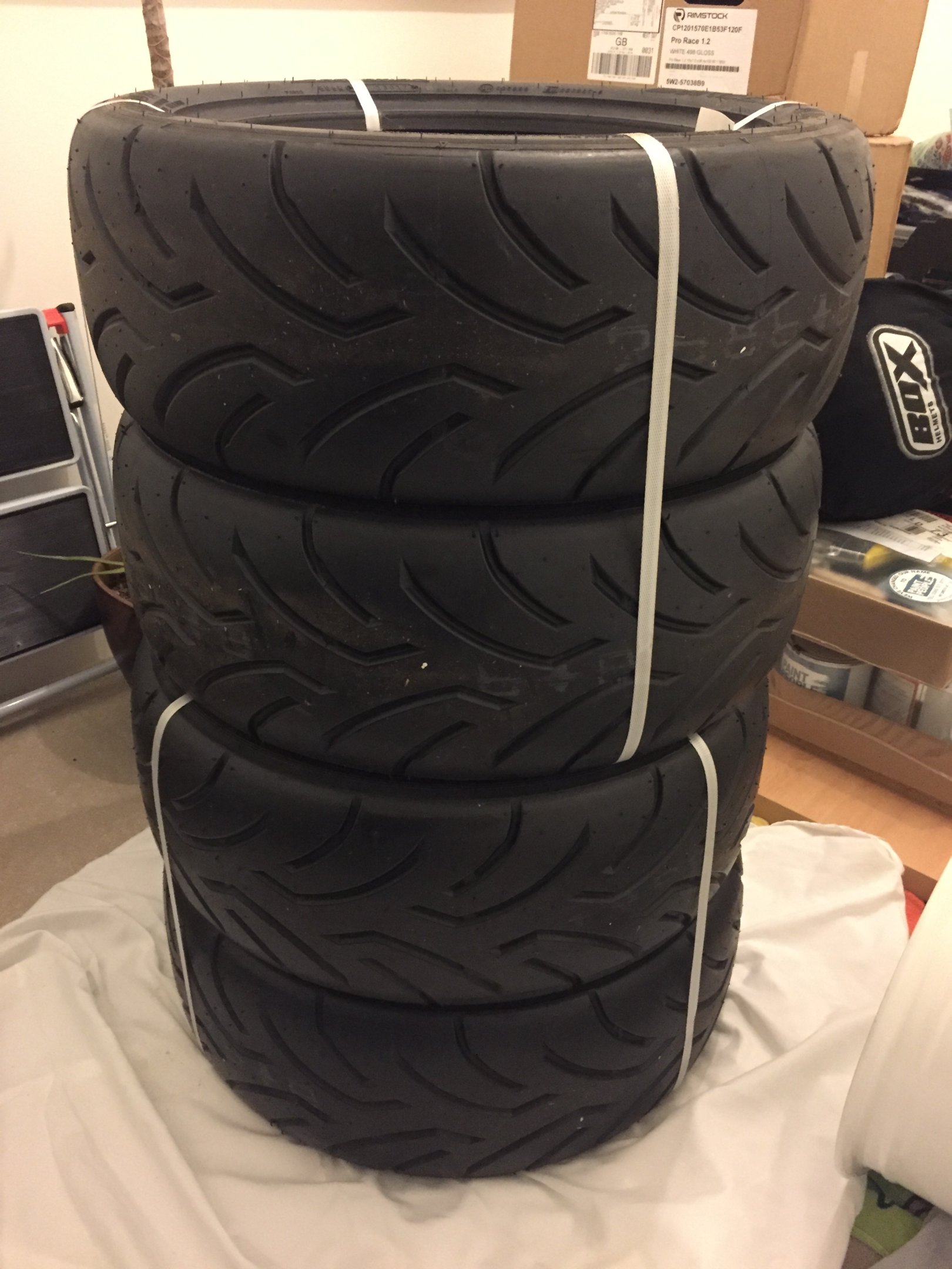

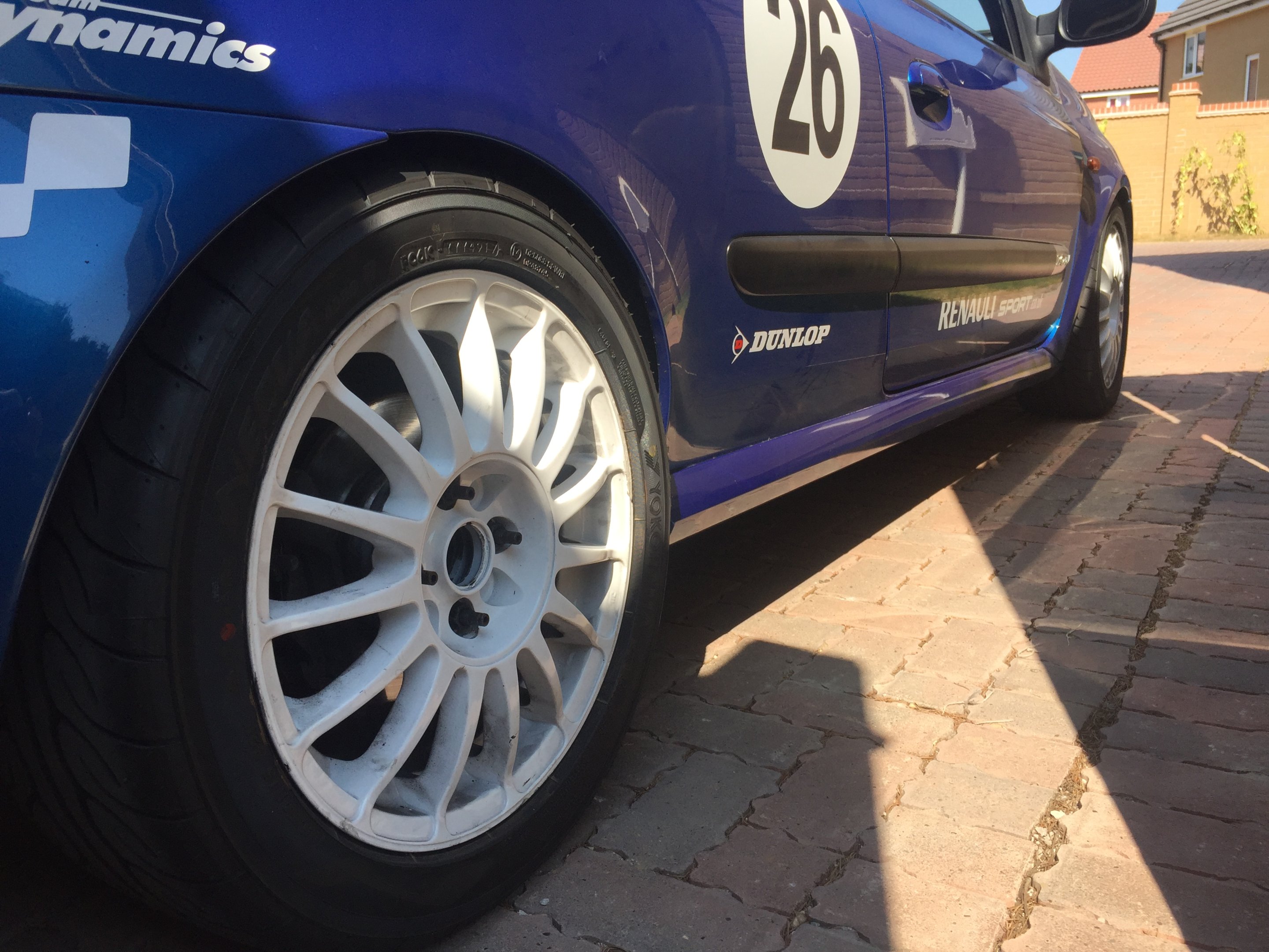

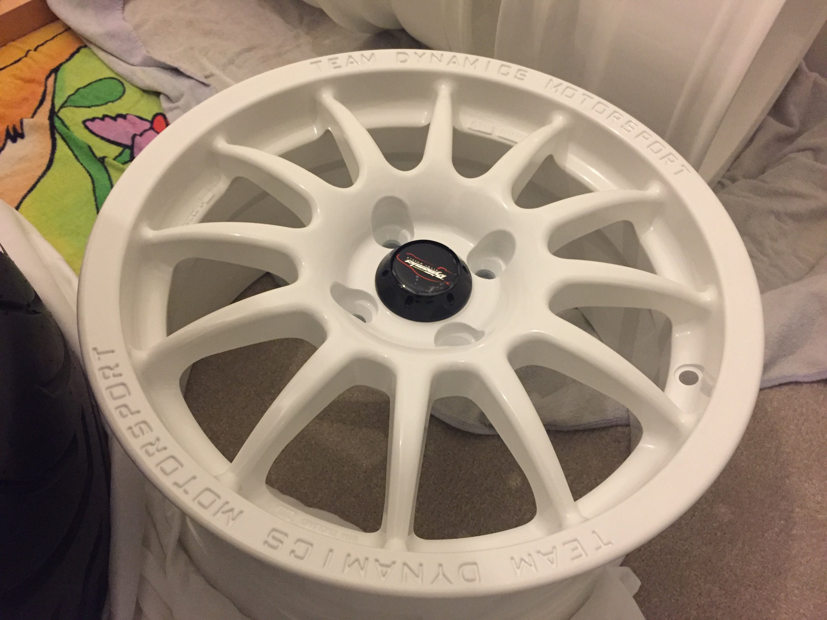

Finally decided what tyres to get this this year in the dry, ill be keeping my current RSR's for Damp/Wet as they have a shed load of thread left on them, not the perfect tyre for it by any means but there you go.
Took delivery of my Dunlop DZ03G R1's from Mrtyremotorsport and my Pro Race 1.2's ET38 from Justin @ Rimstock:

Nice, what made you go with ET38 rather than ET35 ?
Originally because I was going to run 205 tyres like I do on my current set of ET38's, they sit well enough in the arch and I have minimal issues with rubbing and I don’t have to run spacers, however as DZ03G's don't come in R1 compound for 205's I have to run 195's so in the end ET35 would have probably been fine. I can always run spacers if I want to, but I doubt ill bother in honesty.

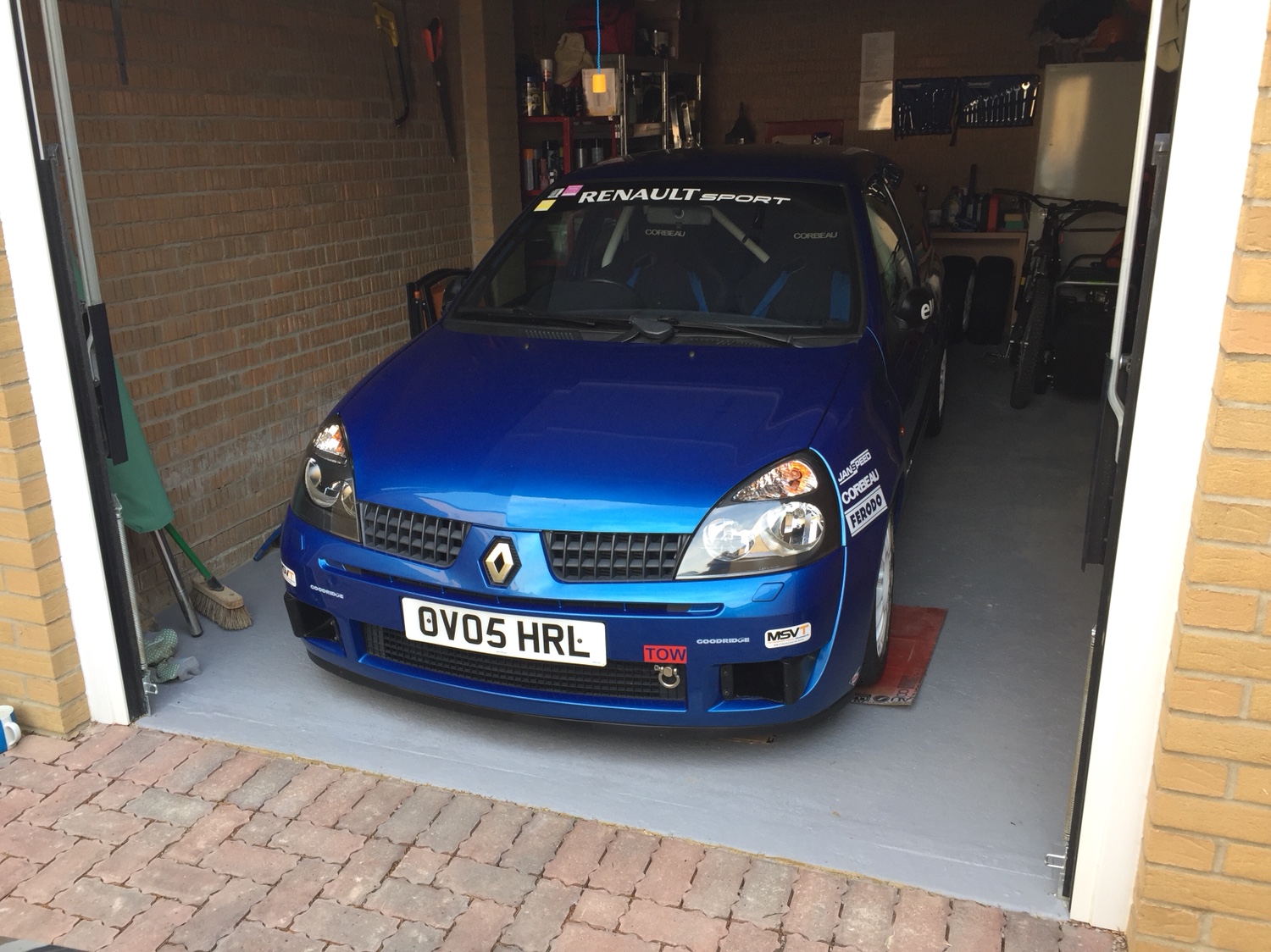

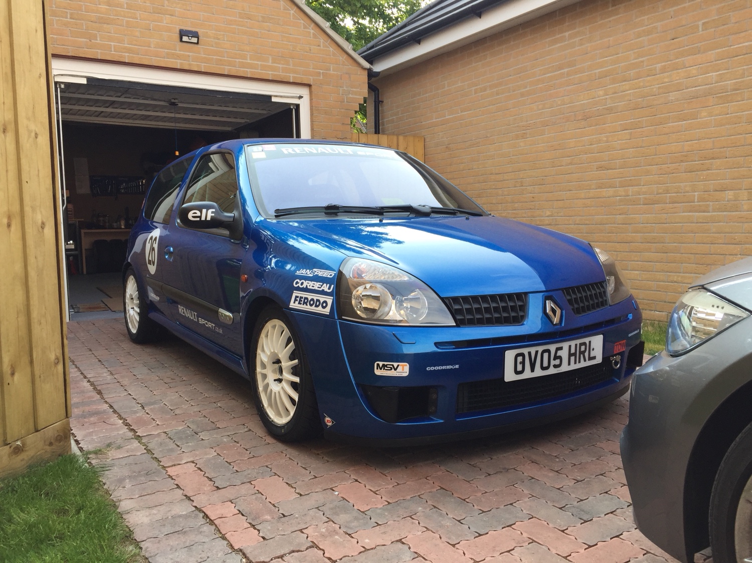

Fitted a rear strut today, ended up being abit of a nightmare as I messed up the spacing so now I have two extra holes but nevermind :)
Quick driveway pic with the plates and road headlights on:

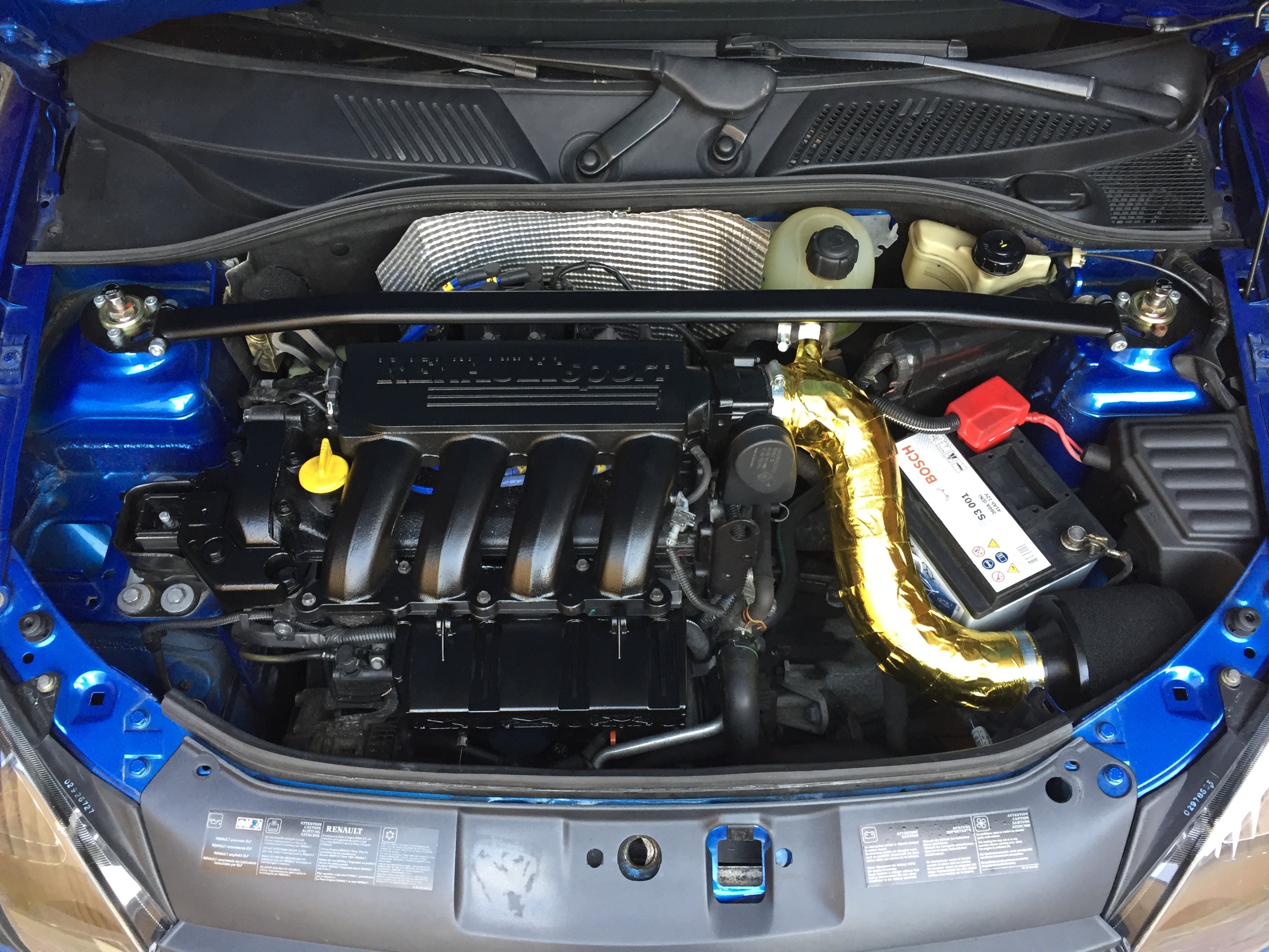

Fitted my 182 cat modded by Mark Fish ready for the MOT next year (lol) but will probably leave it in from now on as its far to loud with a de-cat and I can't be arsed with being on the brink of failing the noise test on track everytime so at least this removes a few db and rasp from the pipe!
Before
After
