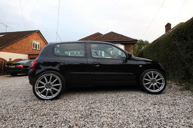

17s are too big. 15s are the nicest to drive, but the right wheel makes the aesthetics work at the end of the day. 17" ultraleggera, in grey on a black Clio, won't look too big. The 17" silver things you have stick out like a sore thumb against the black of the car's paint.

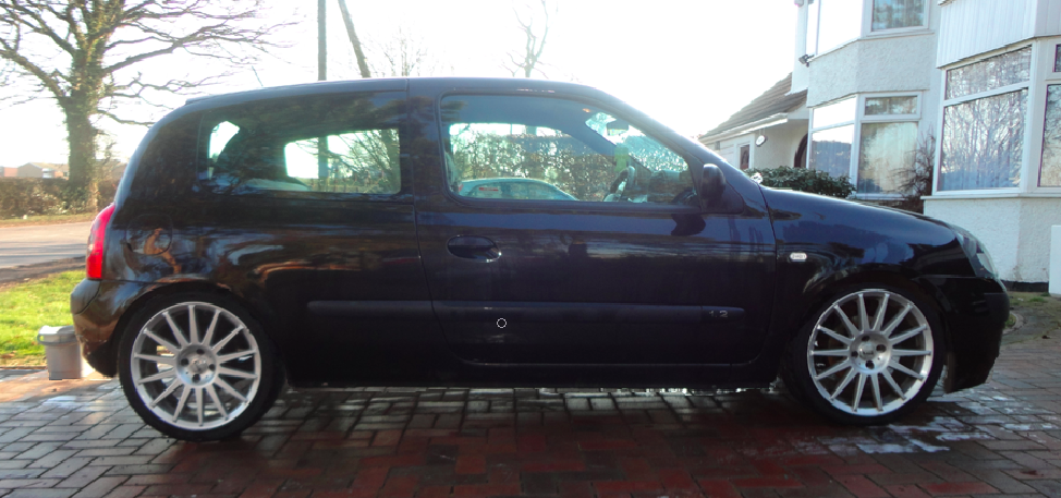

i had 205/50 15s on and changed to 205/40 17s and day to day drive feels the same apart from slightly harder ride dosnt tramline dose not rub/catch even with passengers currently running 60mm drop all round i prefer the look of 17s than 15/16s but all depends on the style of wheel and ride hight.
op drop it 40 or 60mm will look alot better.
