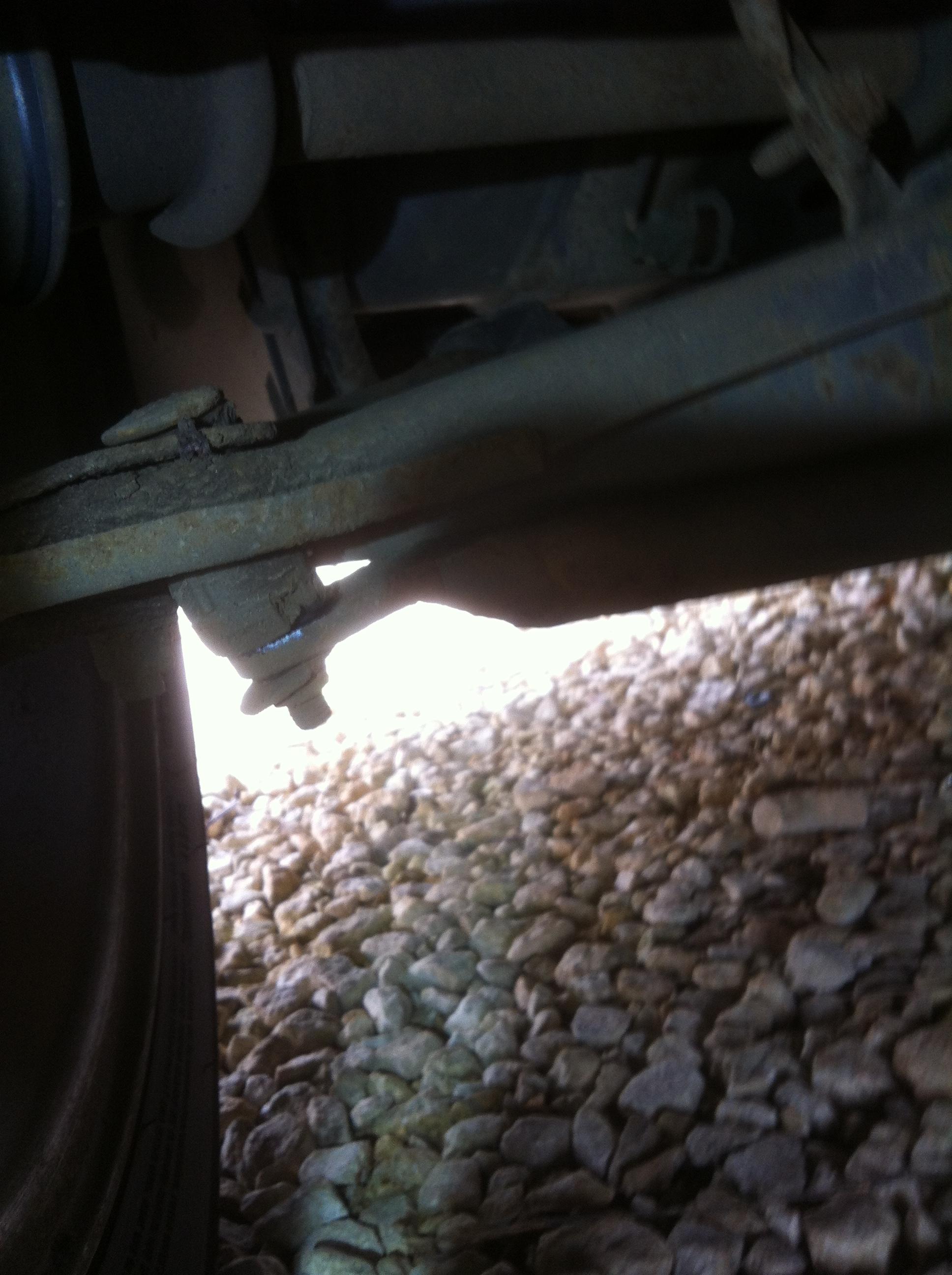

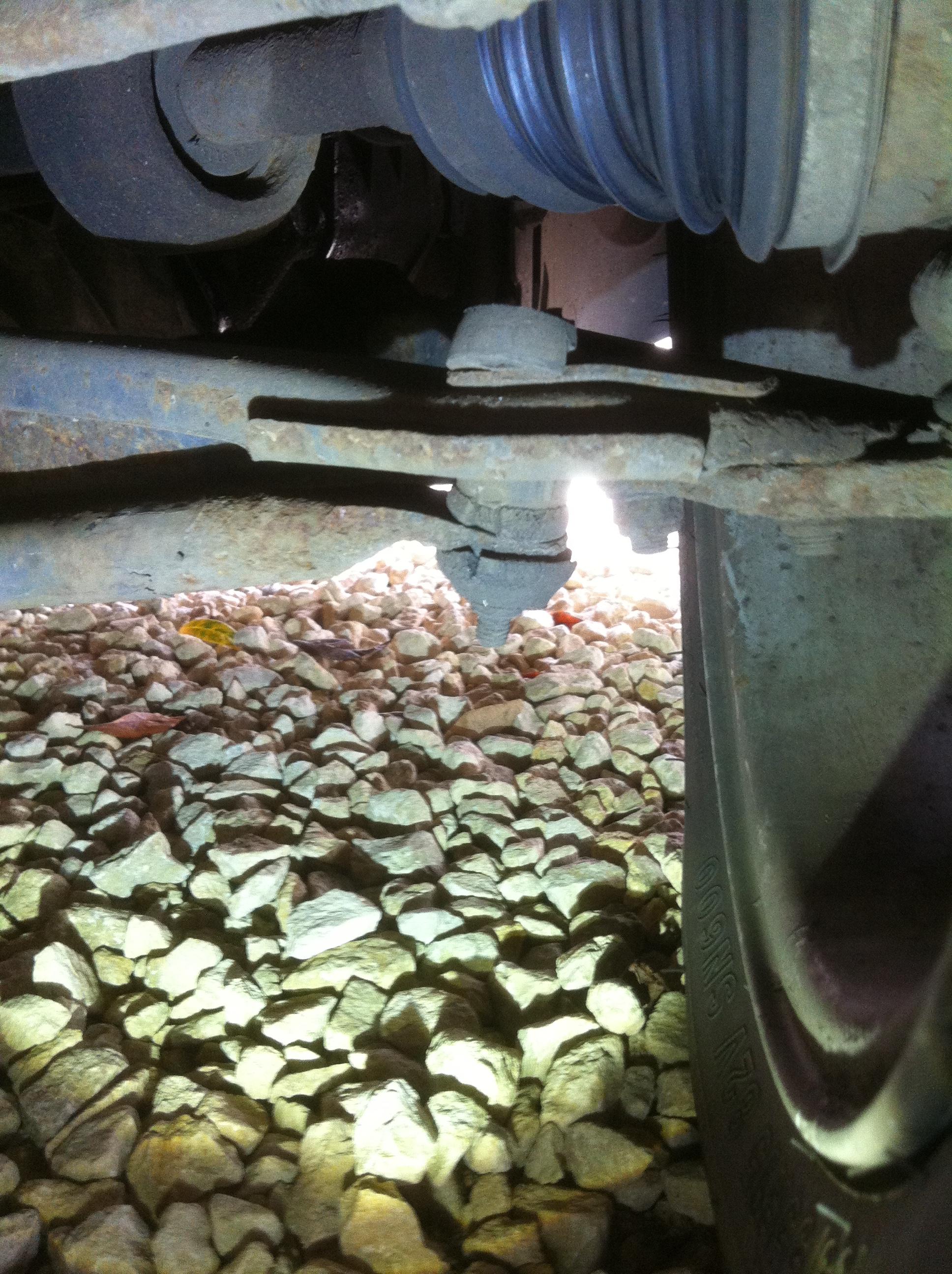

Are these ghetto link bushes the reason why my Clio creaks and knocks?
BPY
Car  16v 1.2
Secondly, is it dangerous driving in this state?
Drivers side:
Passenger side:
If you can shake the arb and it's loose on the bushes then they need changing. Only a fiver a side. Inner arb bushes are always a big improvement. knock is likely to be top mounts as they're crap
