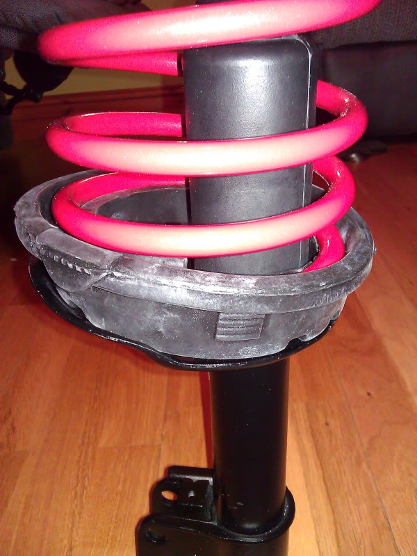

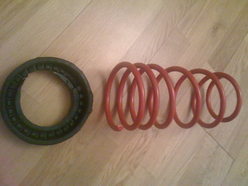

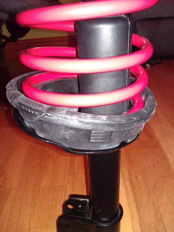

My 172 cup came with gaz coilovers which i'm changing for oe shocks with sportline springs but i'm not sure if i need to fit the black rubber spring seat think 7700419475 pictured.
I can't remember seeing them fitted to others 1*2 shocks in any pics i have seen.
any ideas?

I ordered all new front and rear spension parts listed for the 172 cup and thought i needed these too but now i'm not so sure.
they are new its just my crapy camera phone lol

Rubber that sits in between the springs and mounting flanges. I'd fit them. You'll need two per strut on the front, one below and one above the spring.
renault only supplied me with one per shock?

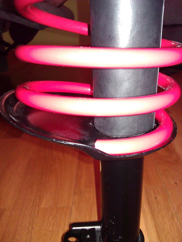

they seem to be a for the bottom of the spring but just not sure what to do...

There not fitted as standard and the springs won't move around without them...
... but as you have them you may as well use them.
Fit without, they're not there when it left the factory and the springs dont fit in the correct location with it in
right ok i think i'll leave them out, the spring does seem to fit and sit better when they are removed.
