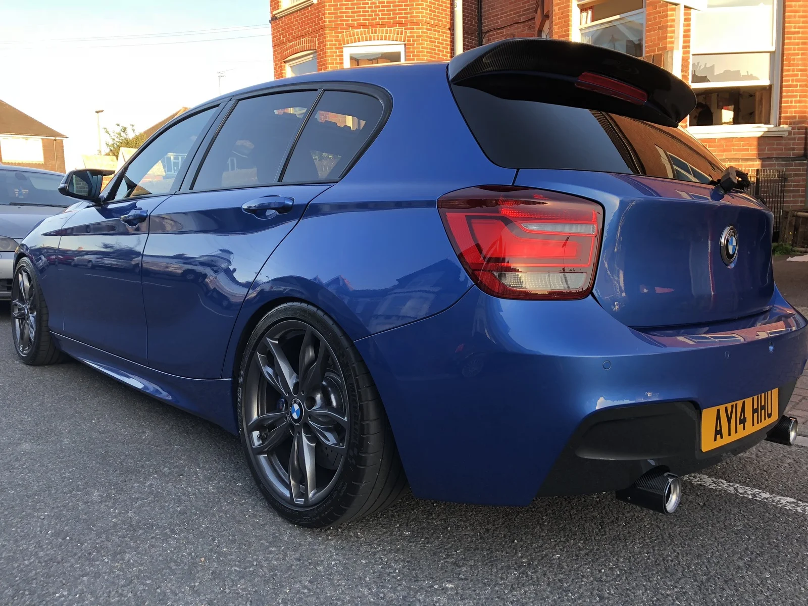

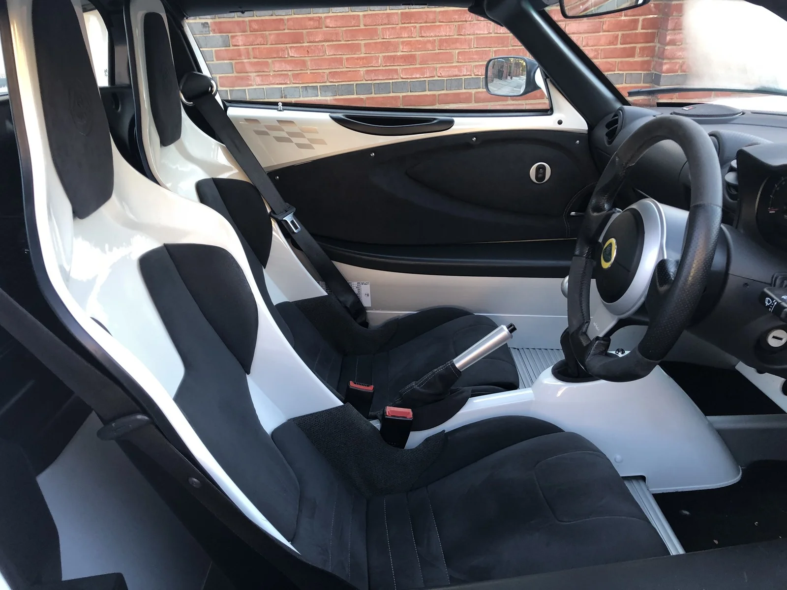

Since selling the Liquid Yellow 182, I have owned (in order)…
BMW 120d (the only car I have managed to take over to the Nurburgring!)

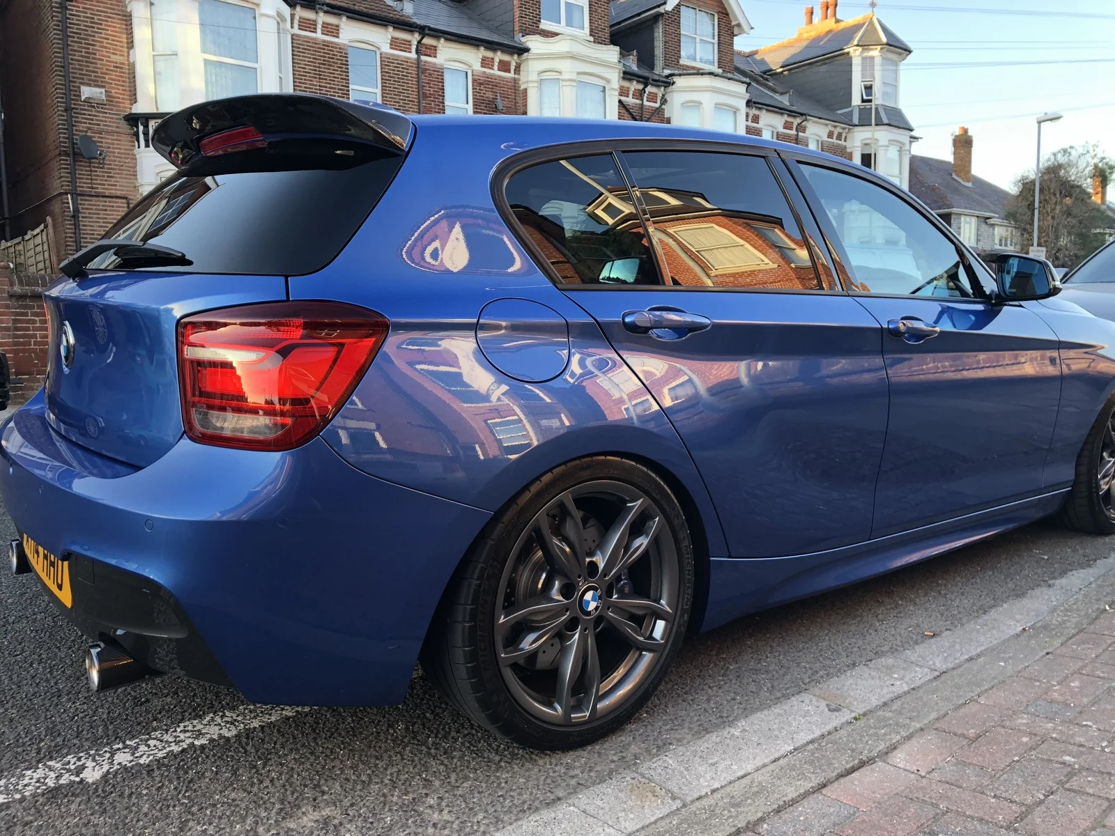

BMW M135i (running 420hp – great fun)

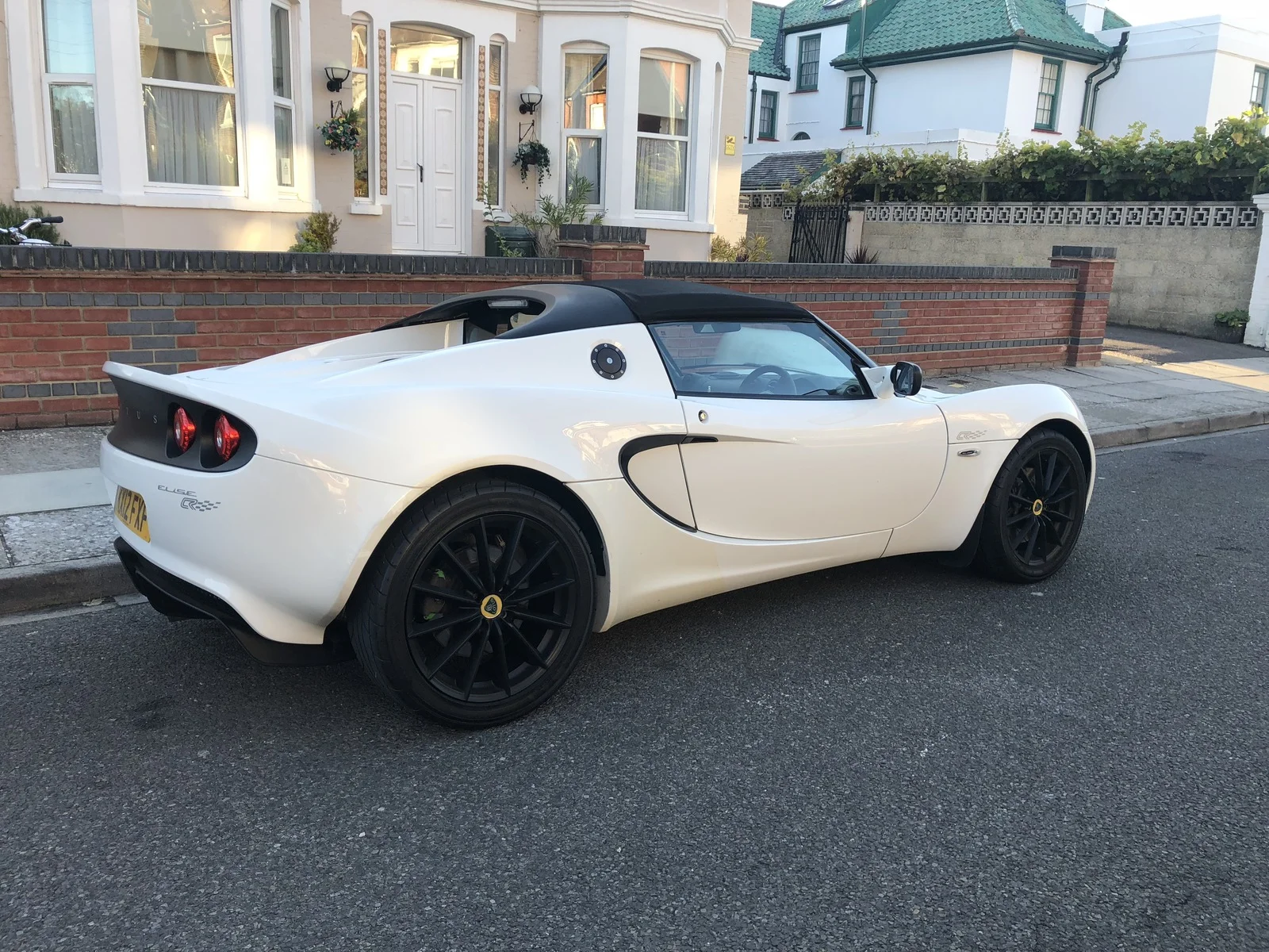

Lotus Elise Club Racer
Few pictures of each of the above cars..

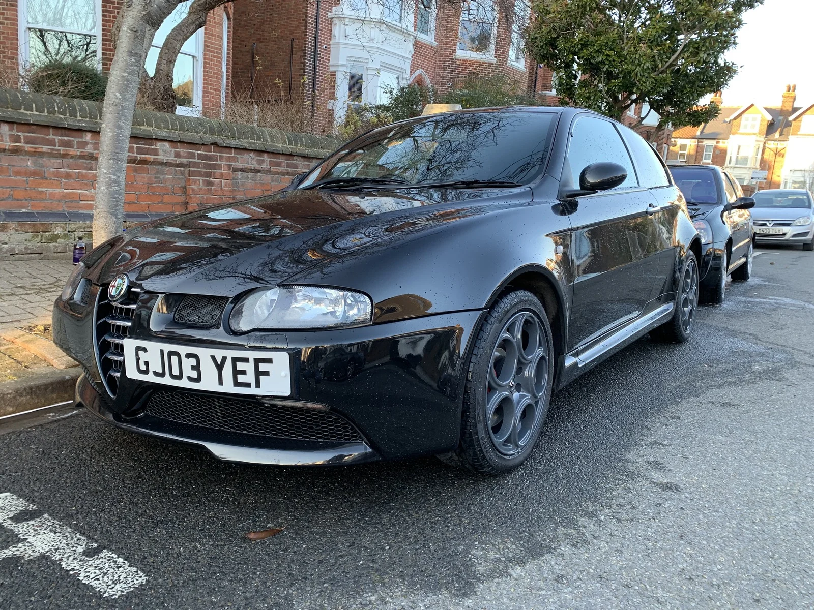

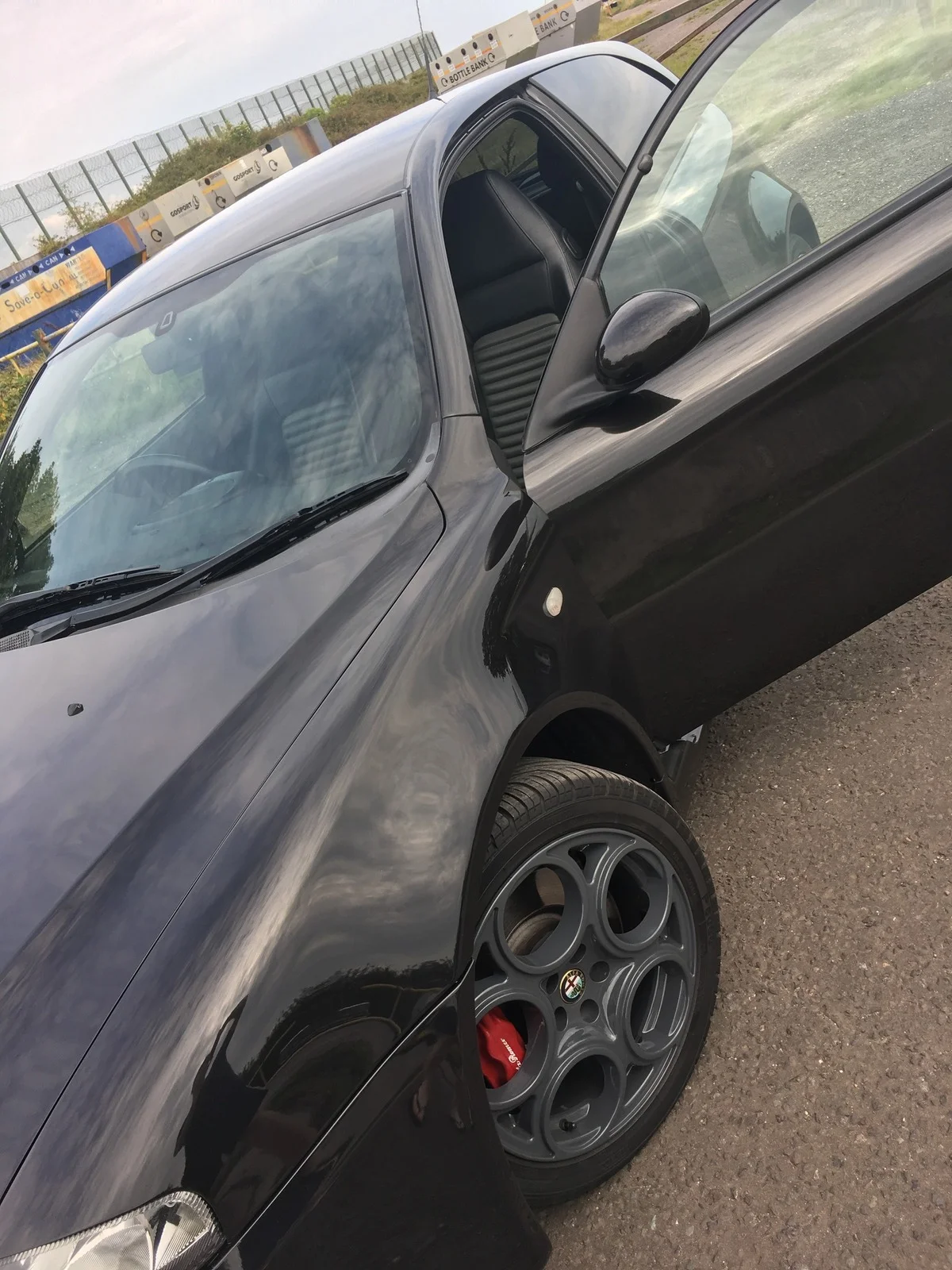

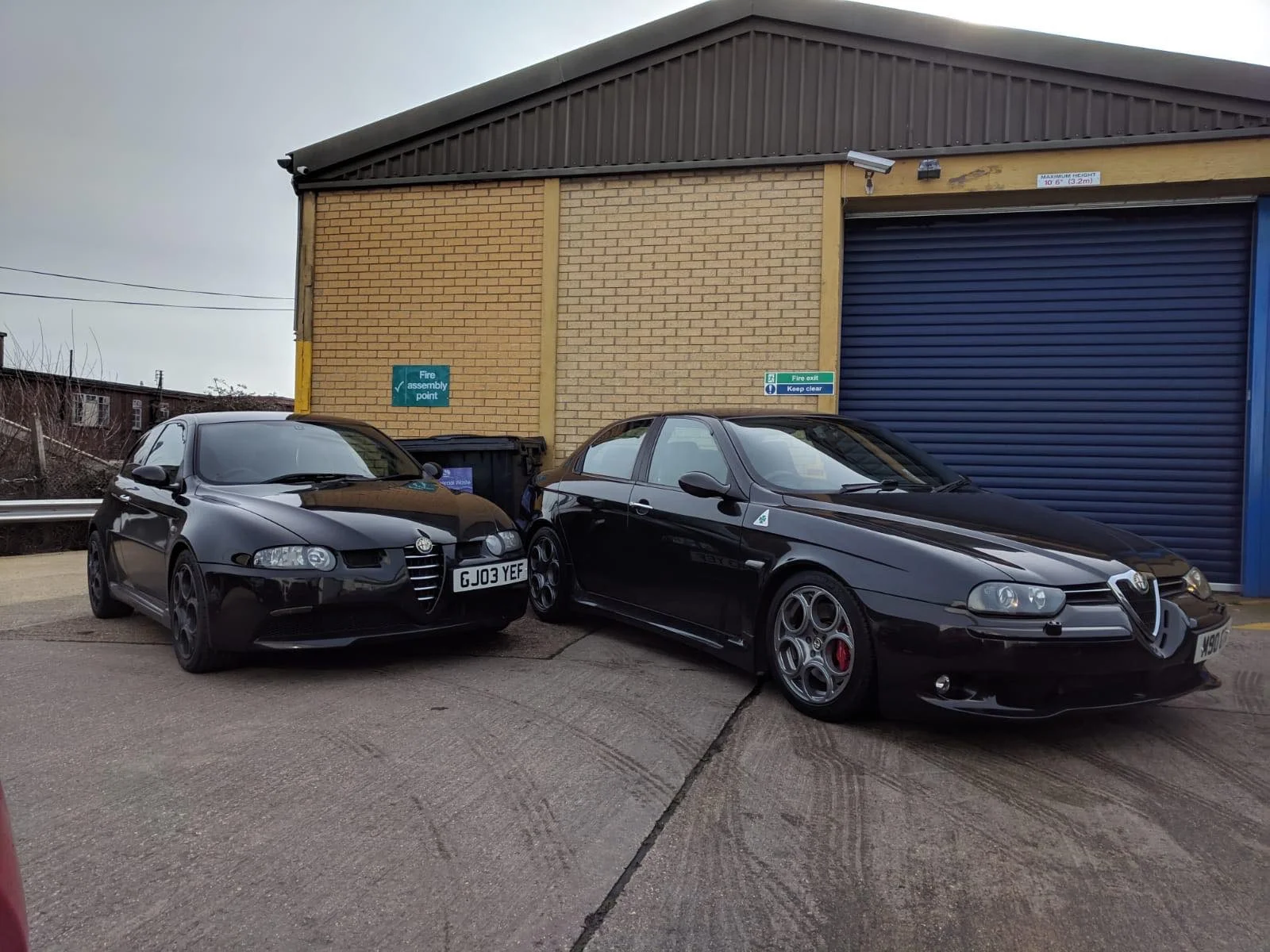

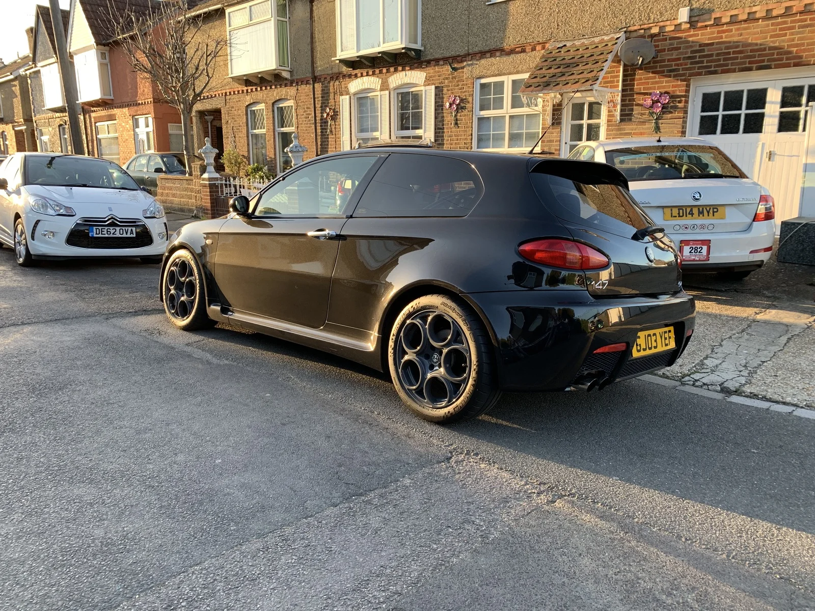

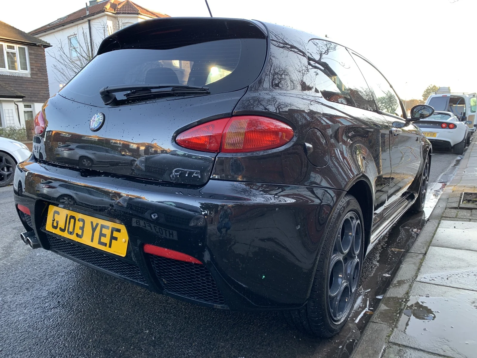

And now an Alfa 147 GTA which I bought in January 2019. For a brief period, I owned both the Elise and Alfa at the same time, but I decided having a second car mostly just sat around was pointless (and I don’t have a garage) so the Elise was sold a few weeks back.
I appreciate this is a Renault forum, but having formerly owned a few Renault Sport models (and hoping to own another some point soon), thought it would be ok to post and might also be of interest to some.
So, standard spec of the car when I bought it…
Metallic Black
3.2 V6 (legendary Busso V6 engine)
Black/Grey Leather Interior
Bose Stereo
69k miles
Full History

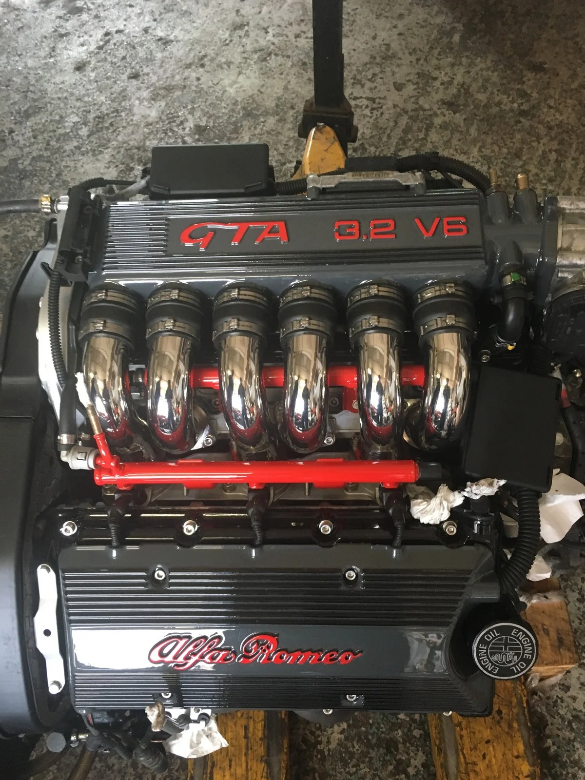

He also had the alloy wheels refurbished and an engine painting service carried out. They were both done in a matching flat grey, which looks a lot better in person than what the photos show. This was chosen to match the inners of the leather seats. The engine detailing was a complete engine out job as you will see in the pictures below.

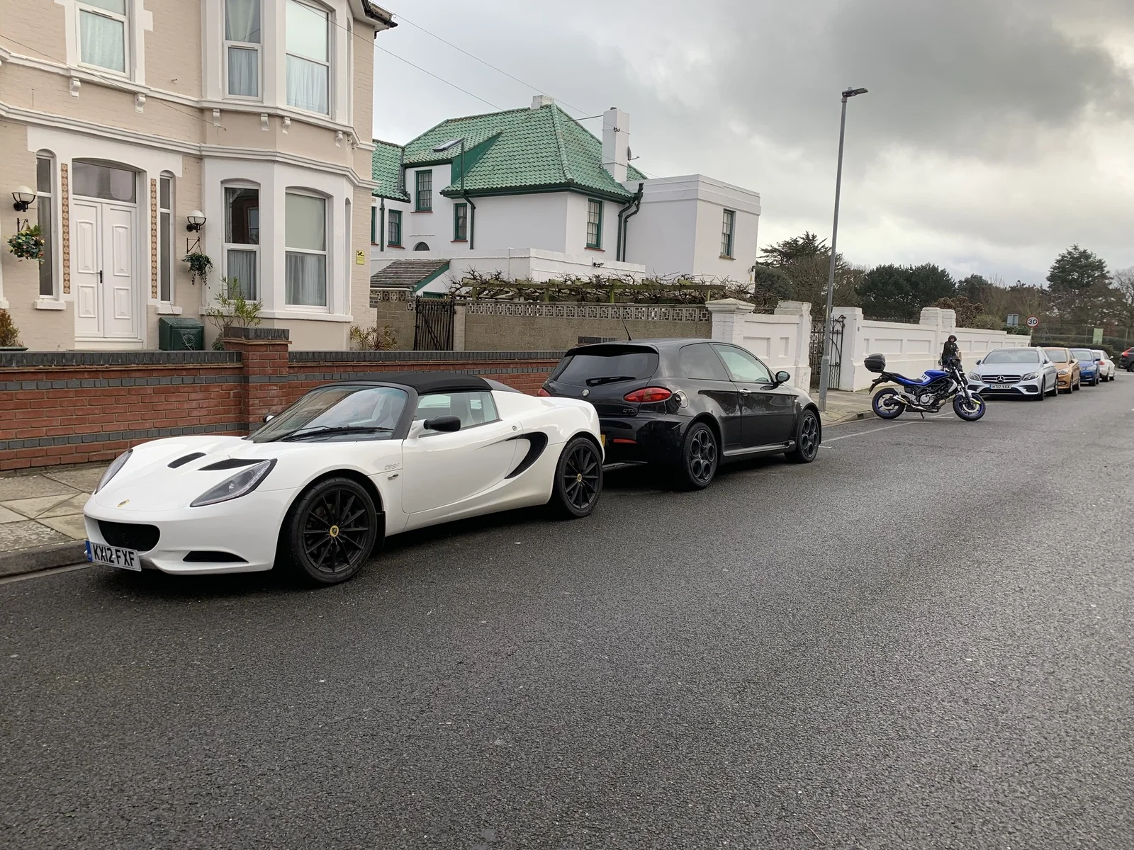

And one when I got it home and parked it up next to the Elise!

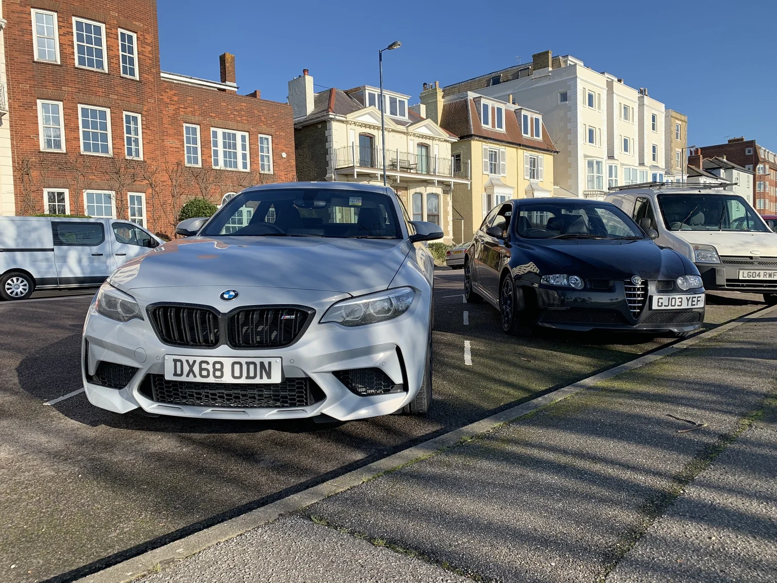

Also got one next to a M2 Competition which lives round the corner from me. I was seriously contemplating ordering a brand new M2 Competition in Hockenheim Silver a few months ago, so had to pull up next to this one and take a picture when I had the opportunity.
I had a pretty clear vision of how I wanted it to look and the modifications I wanted to carry out, even before I agreed to purchase the car!
So, in typical Ash fashion, the modifications began.

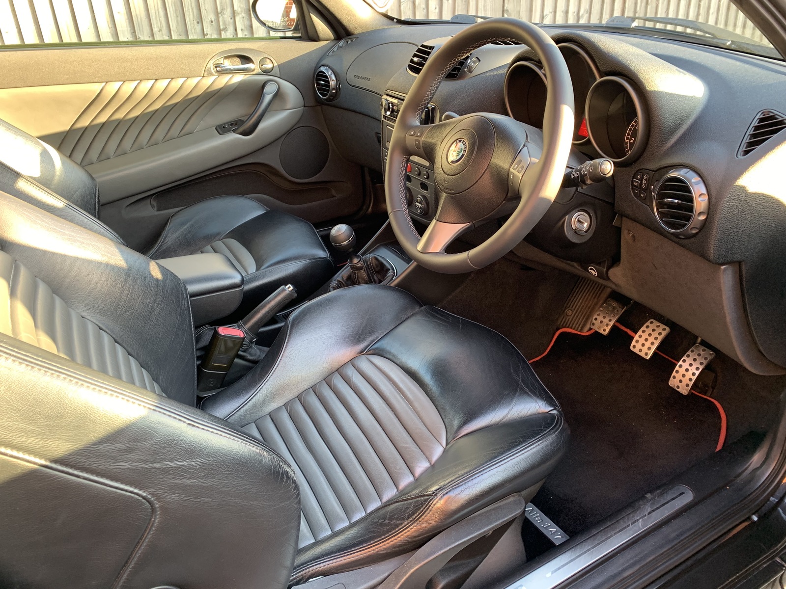

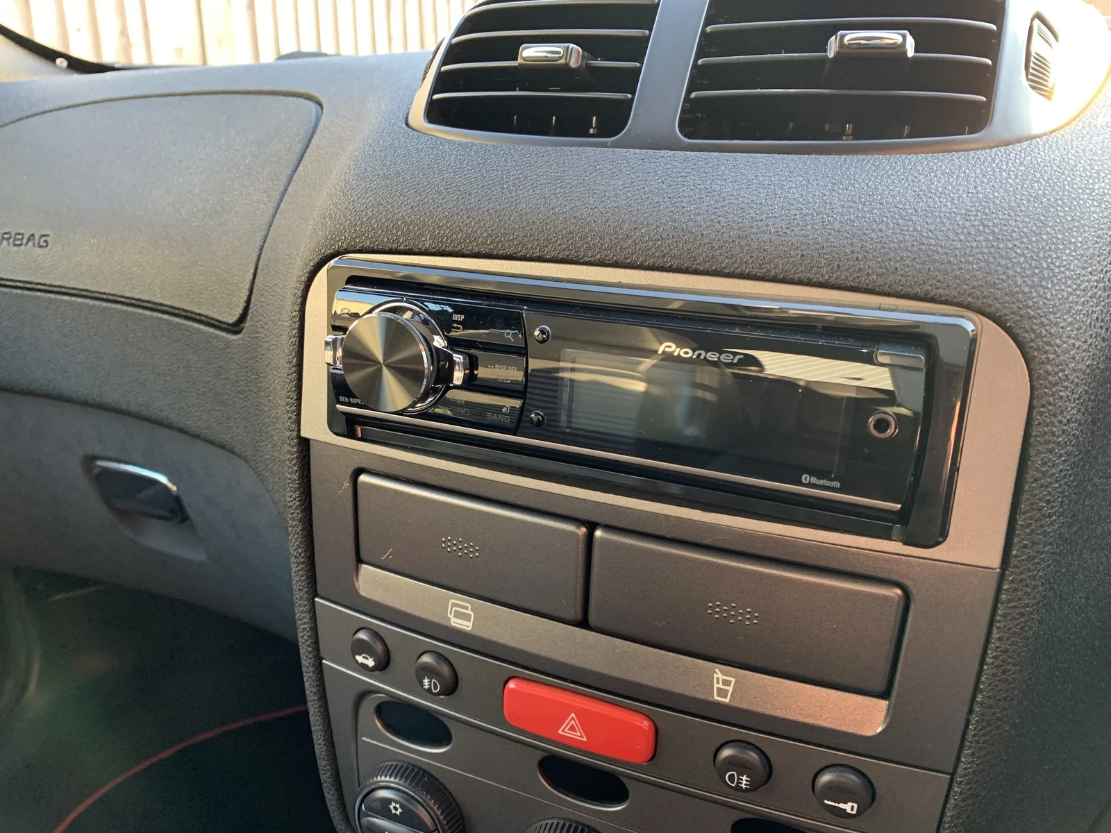

First of all, the standard head unit was swapped out for a top end Pioneer Bluetooth unit (so I could play my own tunes!). This coupled with the factory Bose sound system does make for a pretty awesome setup.

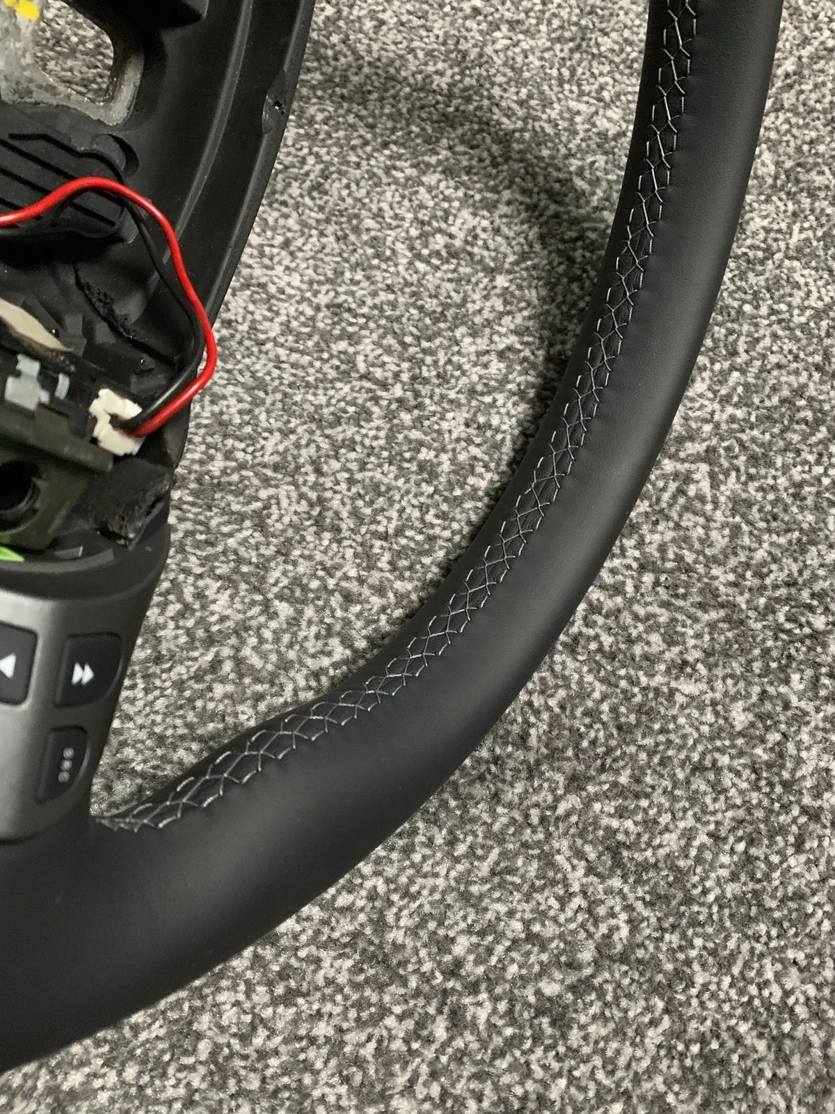

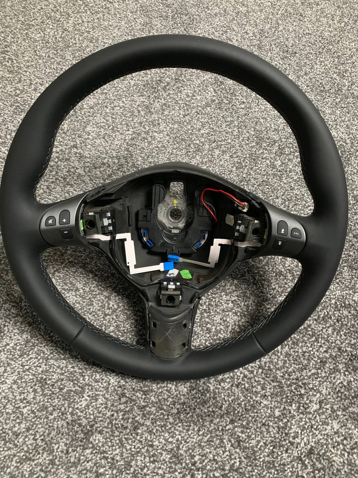

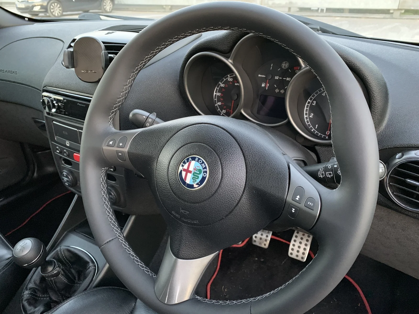

I was not a fan of the standard steering wheel at all. I think it was leather, but it felt more like plastic/vinyl. So, I got in touch with Royal to have mine retrimmed in smooth leather (sorry Snappy fans! I know his work is good too!). Royal have carried out a few steering wheel retrims for me now; typically I opt for Alcantara, but that would have been out of place in the luxurious Alfa interior, so I went for leather, with grey stitching to match the seats.
Then my OCD kicked in… I could not fit a retrimmed steering wheel with steering wheel buttons which were anything less than perfect! So, I ended up buying a brand new pair of OE steering wheel buttons (not cheap!), fitted them, then got round to swapping the new steering wheel in. Looks so much better, and more importantly, feels so much better (ooohh aahhhh!).

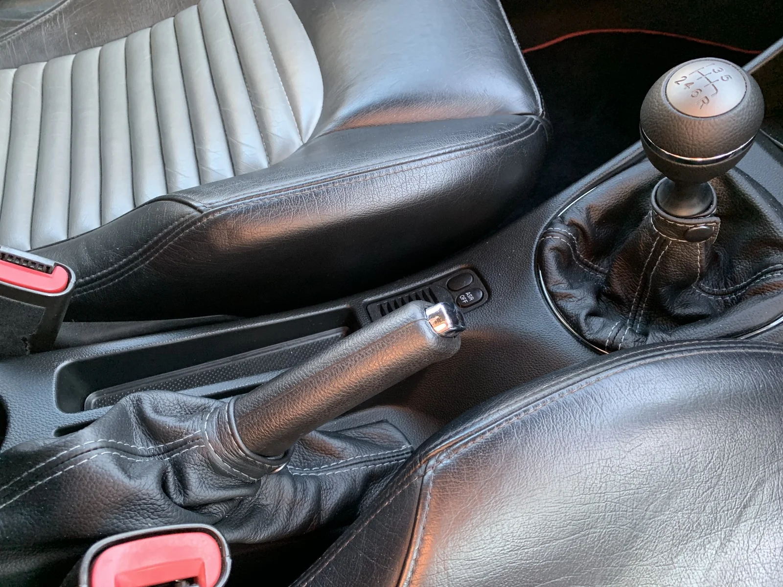

Next came some new handbrake and gear gaiters in leather with matching grey stitching. And the previous owner had just fitted a brand new OE gear knob at great expense, so I was happy with that.

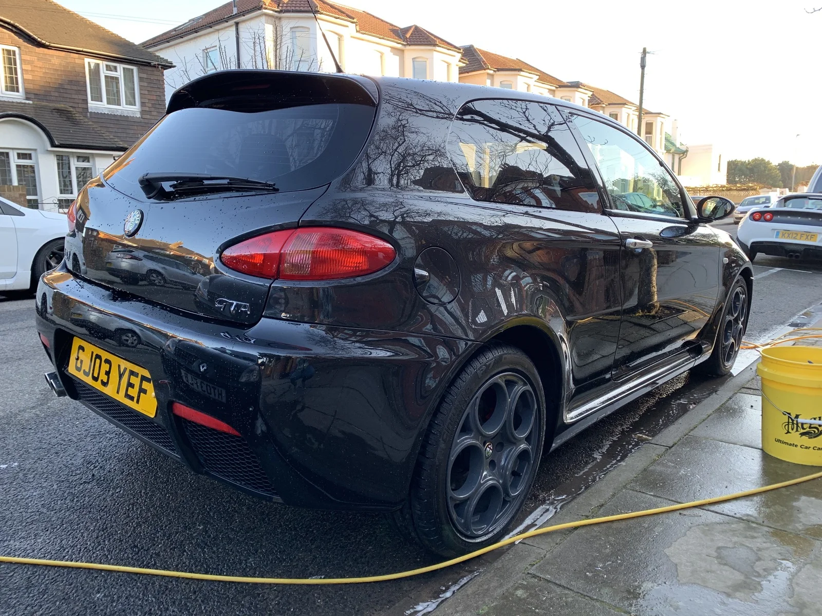

Then I wanted the bodywork attending to, just to remove swirl marks etc from bad washing techniques over the years. I enlisted the work of Auto Curators in Hook and left the car with them for 3 days to carry out a paint correction and ceramic detailing service. Couldn’t believe my eyes when I went to pick the car up. Needless to say, I would not hesitate to recommend them if you ever want some detailing work doing.
Then once getting it home, it had it's first clean post the detailing and ceramic coating. Oh so easy to clean and maintain! You can see the Elise in a few of these photos, and also the Clio 172 which I bought for my dad in the 6th & 7th photo!

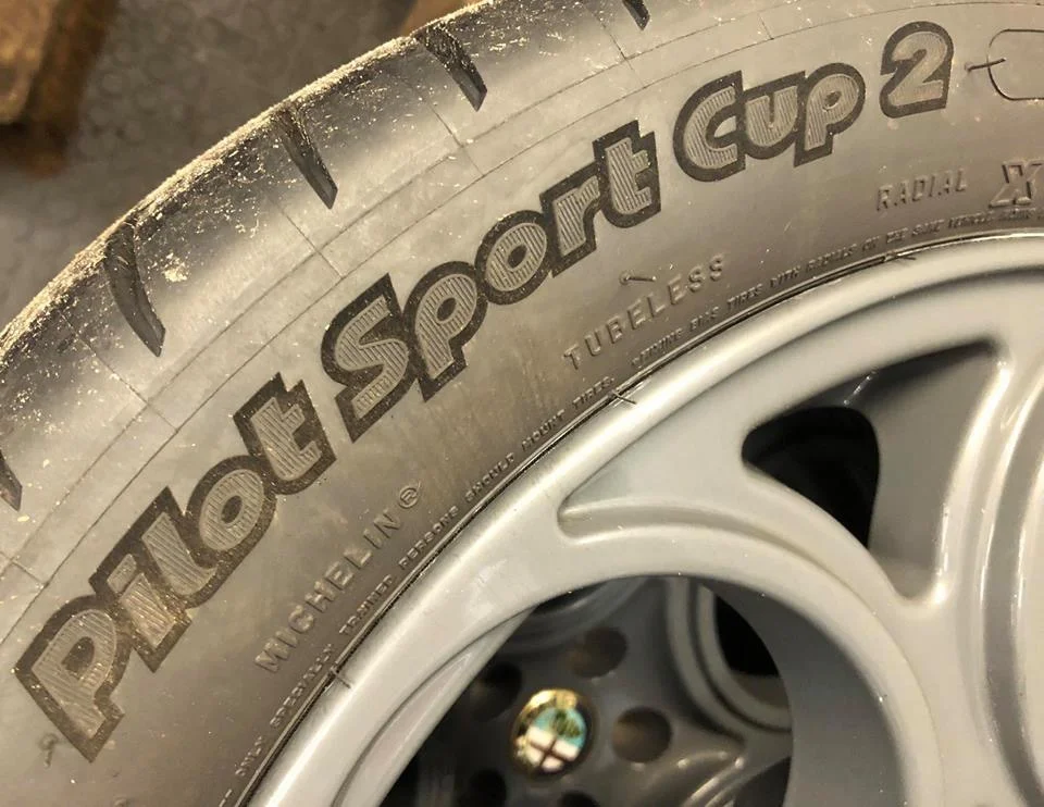

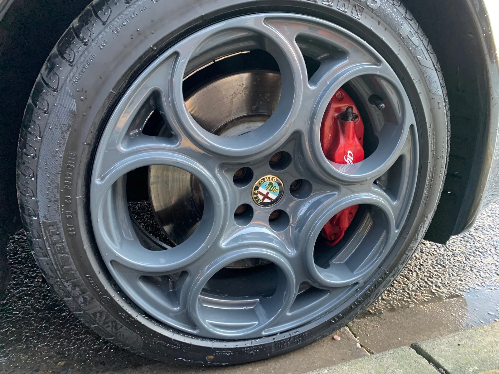

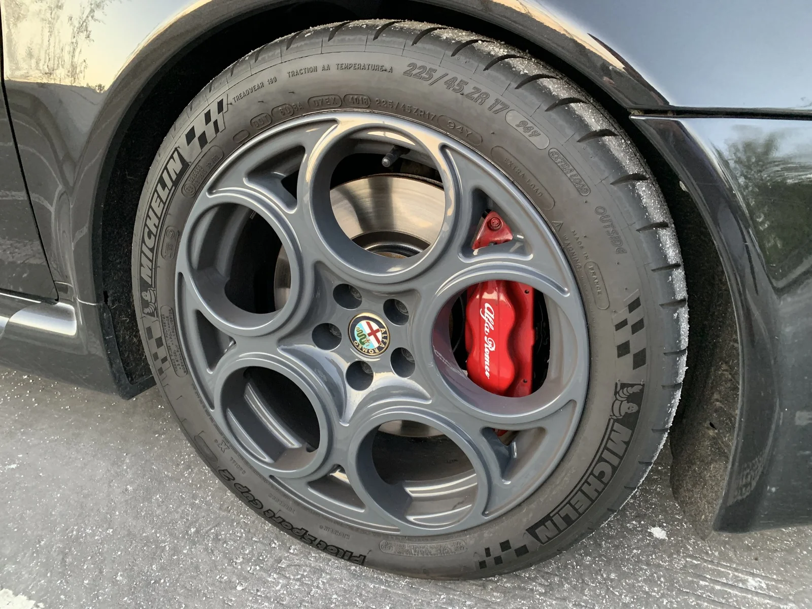

The car was riding on shite Pirelli tyres, so I set about looking into tyre options. I was about to purchase Pilot Sport 4’s, until seeing that Pilot Sport Cup 2’s were available in the OE tyre size for the GTA, so I took advantage of an offer Blackcircles were doing, and put a set of Cup 2 tyres on. One word…. awesome. They even look awesome (yes, I have a bit of a tyre fetish it has to be said!).

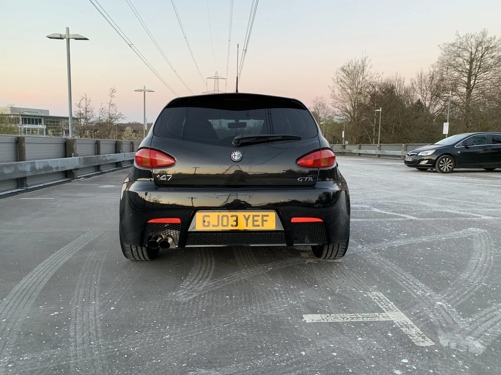

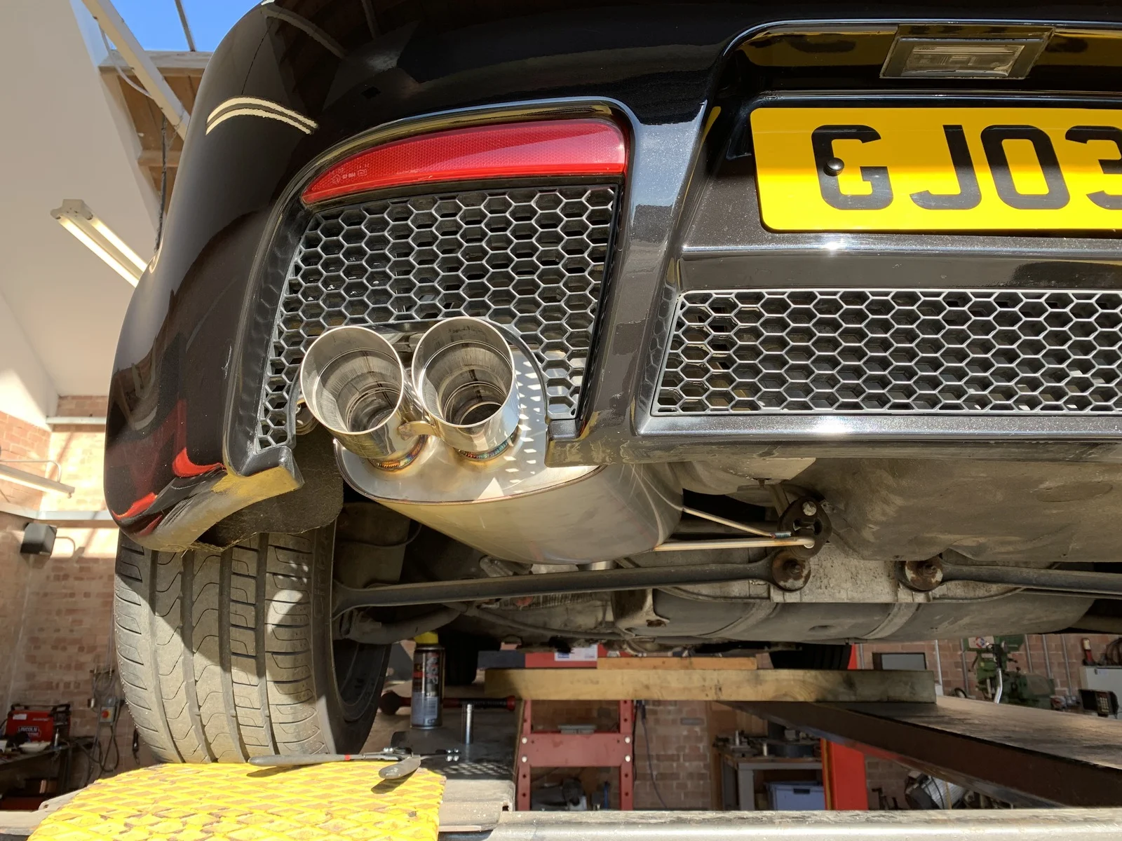

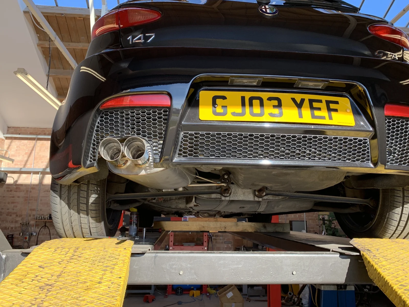

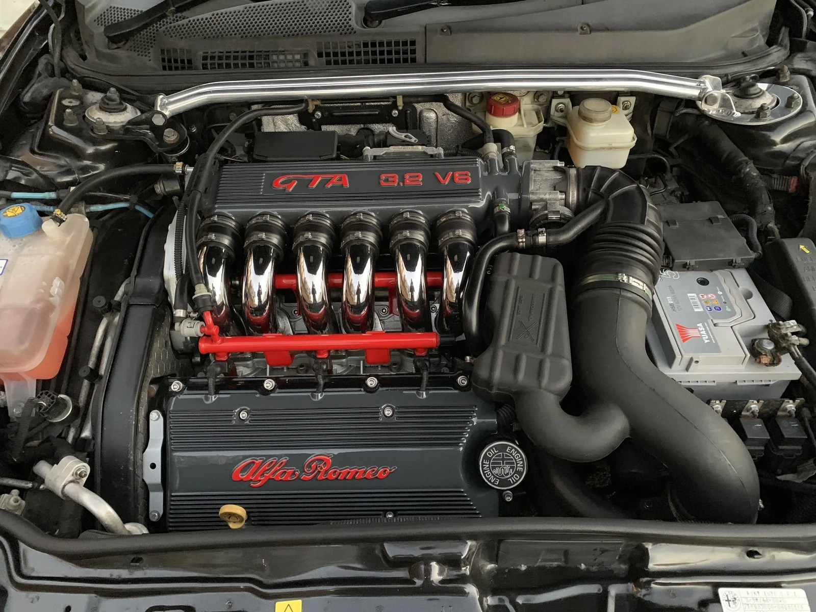

Next, I wanted a bit more noise. As standard, the GTA comes with manifolds that have cats in them, and this is a big contributing factor to head gasket failure, as the cats get very hot and then end up cooking the head gaskets. A popular mod is to fit what are called CF2 manifolds from earlier V6 model Alfa’s as these do not have cats in them, and bolt straight on. The previous owner had this done, along with a pair of Wizard downpipes (Wizard is synonymous with aftermarket Alfa V6 exhaust systems). The rest of the system from the centre cats back was standard.
The car sounded amazing as it was; you knew you were in something special. But as always, I just wanted that little bit more. I got in touch with Wizard exhausts and agreed on having one of their cat-back exhaust systems installed, with an unsilenced centre section. So, I took a trip up to Bicester where the systems are fabricated to have one fitted. Now it really does sound like a piece of exotica! It can be quite raspy at low revs, and on the cold start, but as the revs climb, boy does it sound good. Sometimes I think it is a tad too loud (I am sure my neighbours would agree) and consider going back to the standard system, and other times I love it and would not even contemplate changing it. In reality, I can see me having the centre section swapped for a silenced version at some point, just to tone it down a little. The exhaust is a work of art though, and is very, very light compared to the factory system.

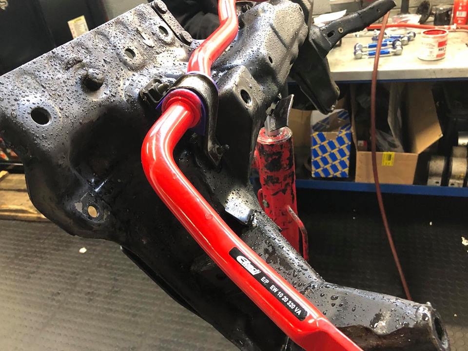

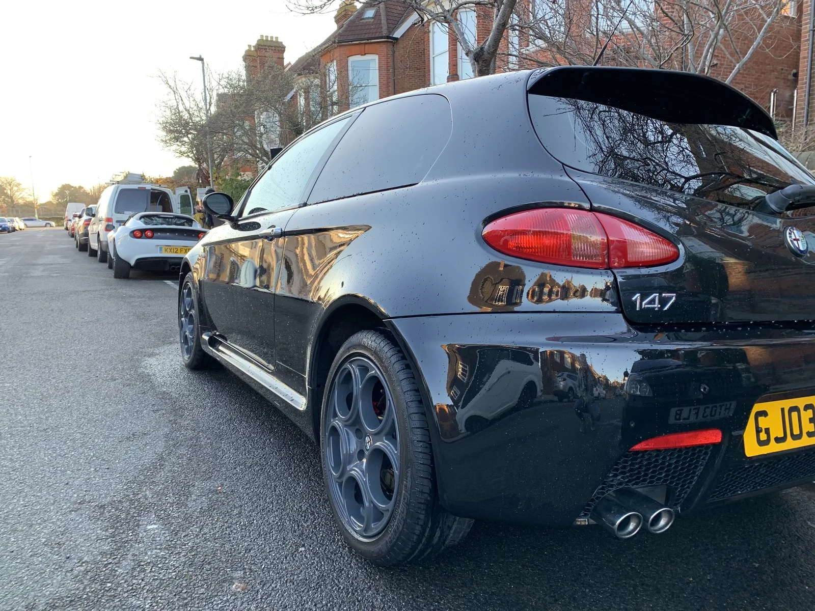

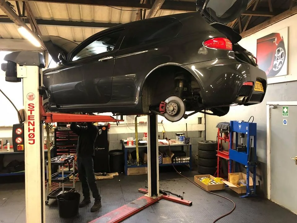

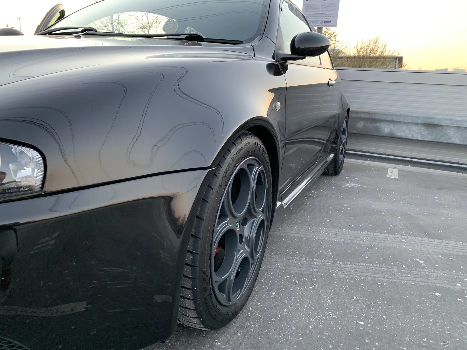

Then came the big work. From an aesthetics point of view, I wanted the car sitting lower and slightly wider, to fill those lovely wide arches at the rear. From a performance point of view, I wanted it to be a back road weapon!
The nearest specialist to me is Autolusso in Bournemouth, so I booked it in there at the beginning of March to have the following done. Some of the parts I sourced myself, some were supplied through Autolusso.
KW V1 Coilovers
Eibach ARBs with Powerflex Bushes
New OE Front Upper Wishbones
New OE Front Lower Wishbones
New OE Front Top Mounts
New OE Rear Top Mounts
New OE Rear Trailing Arms
Uprated SuperPro Drop Links (Front & Rear)
New Front OE Brembo Discs (330mm)
New Front Uprated Brake Pads (Performance Friction)
Brake Fluid Flush with Super Racing Blue Fluid

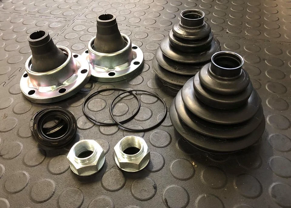

Driveshaft Rebuild with new Outer CV Boots & Uprated Inner Aero CV Boots
New Gearbox Diff Oil Seals
Gearbox Oil Change
Engine Oil & Filter Change
New Pollen Filters
New Rear Engine Mount
Short Shifter Upgrade
SuperPro Uprated Gear Linkage Bush
H&R Hubcentric Wheel Spacers (12mm Front, 15mm Rear) & Longer Wheel Bolts
Full Steering Geometry Setup

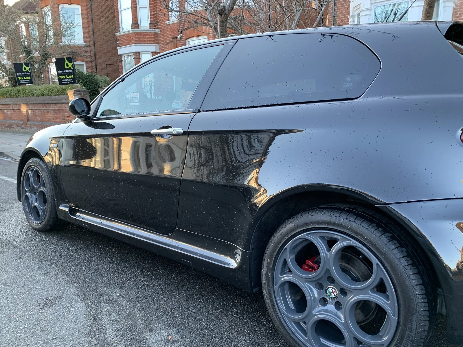

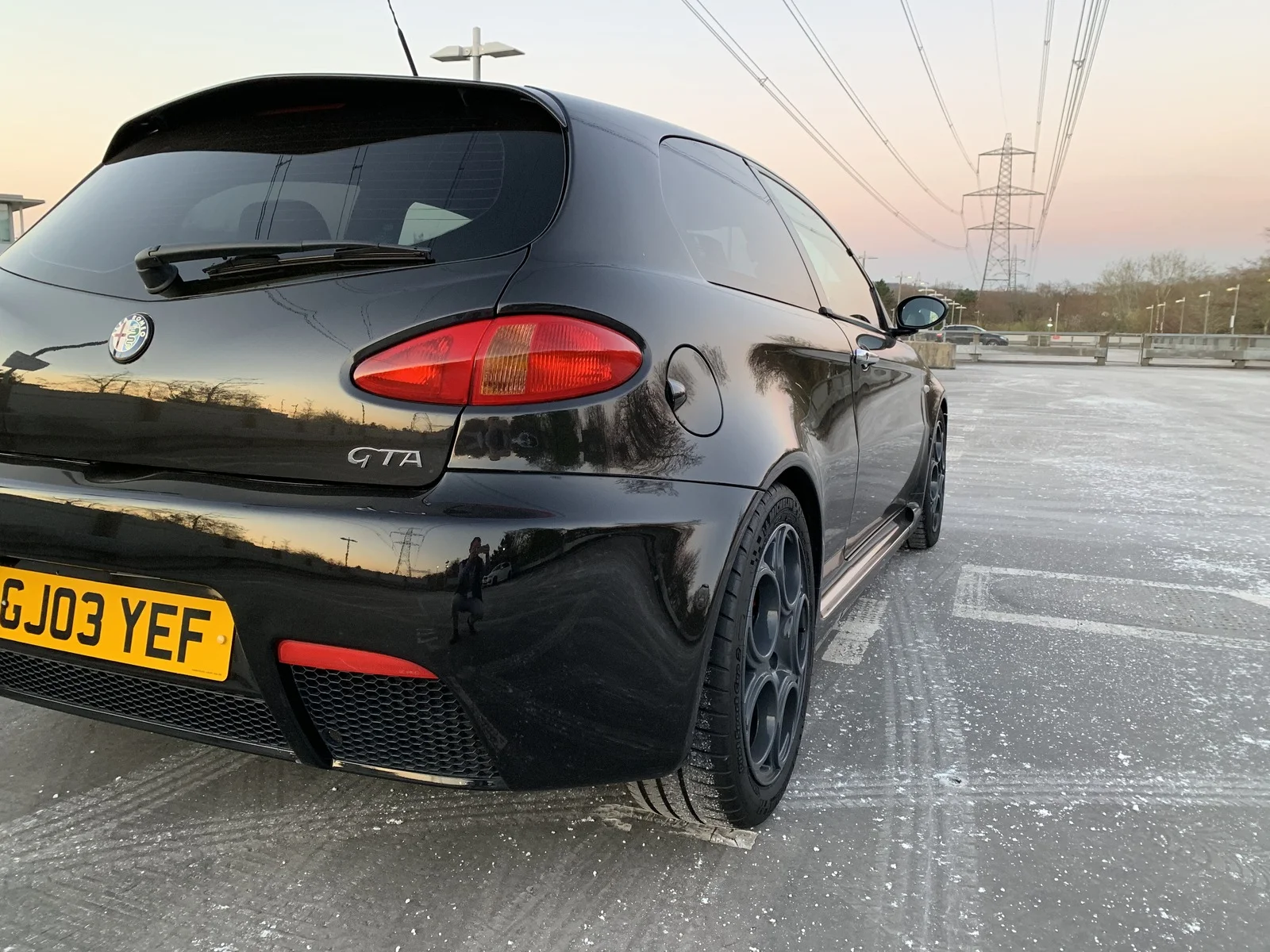

The result is nothing short of amazing, both in terms of how it looks and how it drives.
The combination of the diff, KW suspension, Eibach ARBs and Cup 2 tyres culminates in grip levels which are nothing short of astonishing! It also feels very alive and on its toes; proper little drivers’ car. The only car which came close was my Black Gold 182 running Trophy Sachs and AD08R tyres, but in current setup I would put the Alfa one better, it really is that good. The steering is slightly quicker than the 182 and takes a bit of getting used to, but you don’t really notice any extra weight over the front axle when pushing on. Then again, I’ve not driven a 182 for a while so maybe that opinion might change. The only negative with the Alfa is the turning circle is absolutely shocking! But I love the car for that, who doesn’t want to perform a 3 point turn around a mini roundabout?!
Add the engine and the noise into the mix, and I would defy any petrolhead not to fall in love with this car.
The stance is now absolutely spot on; it sits at a sensible height, and the arches are filled perfectly with the addition of the spacers. And….. #Michelin Pilot Sport Cup 2.
Pictures during the work, and after...

Possible wheel refurbish - love the current colour, but think silver would look fresh! Thoughts?

Love that. For me, silver wheels would make it perfect.
Yep, you will notice in my original post that I mentioned thinking about going silver. The grey actually looks a lot nicer in person than in the pictures, but I am seriously considering having them done in silver.

As for wheels, yes I have been seriously considering silver as I mentioned above and probably will get it done. Definite no to the Sharkfins though. They do look good, but not as good as the Teledials for me. Plus I have it sitting just how I want it now, having being lowered and running spacers. The Sharkfins are 18s whereas Teledials are 17s; I would not want to run bigger wheels as it would upset the ride and the handling (and I might even get scrubbing issues now it is lowered). It looks purposeful as it is. And rides surprisingly well given it is on coilovers (KW), quite a few people have mentioned how comfortable it still is (or bearable perhaps is the better word) - you can obviously tell the suspension is firmer/stiffer but not to the extent of being uncomfortable.
