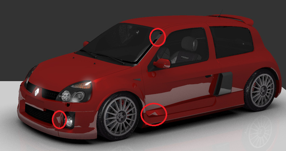

don't know if its the model or your software, the circled bits are weird

Yep - you are correct; those areas you highlight (and a couple others not visible in this render) need a bit more work. In reworking the mesh a few problematic areas popped up which resulted in vertex normal irregularities and mesh densities falling too low (in places where more fidelity was/is needed). The fog light surround also needs reworking.

well since this is a render...do a turbosmooth with 3dsmax and it should be better?
the model should look even better in renders/game if i put it through a tri-to-quad script then do a subdivision
but i can't be bothered :tongueclosed:

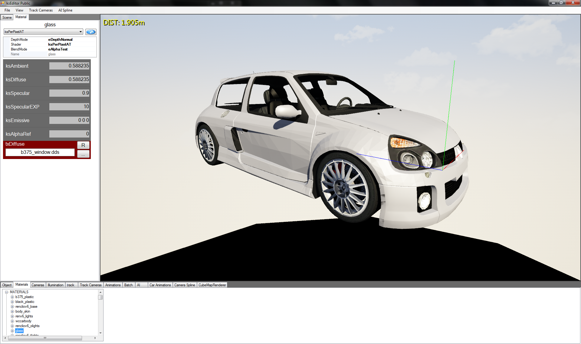

fbx export with the part structure + dummy objects to determine location, AC ksEditor to assign shaders to the textures, shader configuration, export as a kn5 file, done

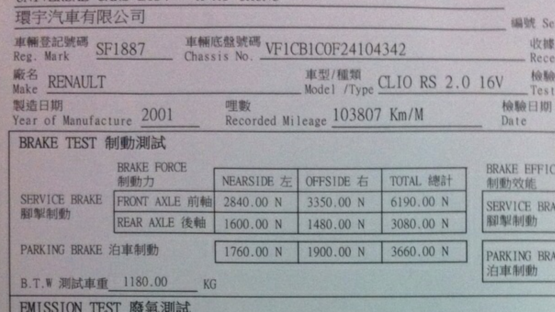

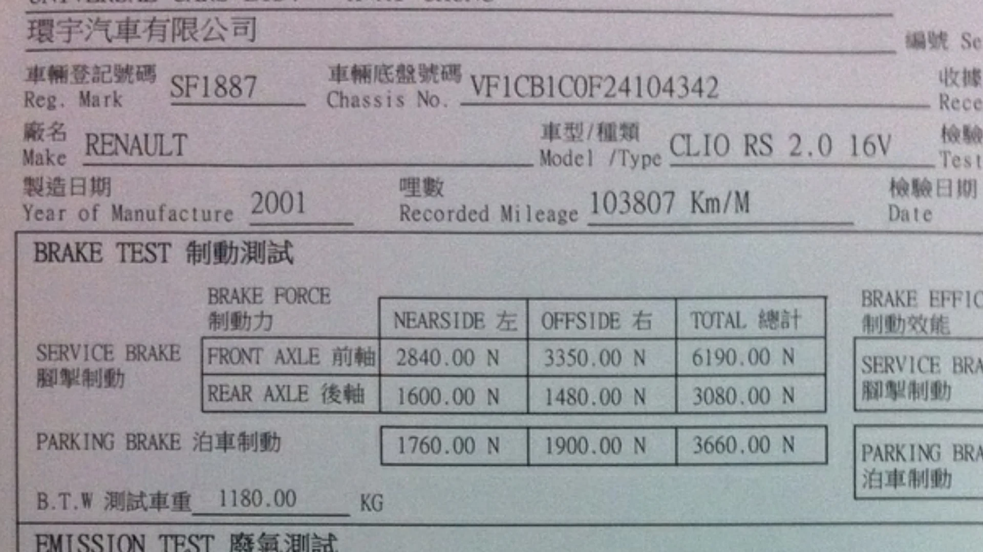

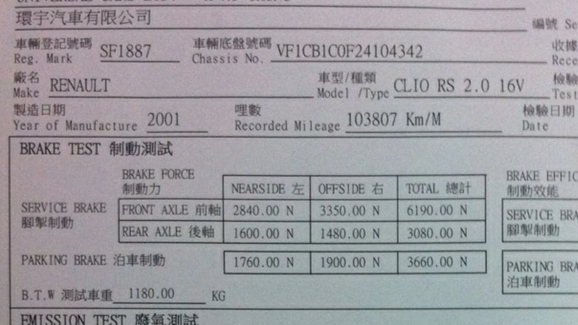

failed my mot...stupid airbag light came on during the test...so i got failed report and the data i want in return...
why the front right/rear left side brakes better..i have no idea...sticky calipers? fucked bias divertor? ideas guys?
