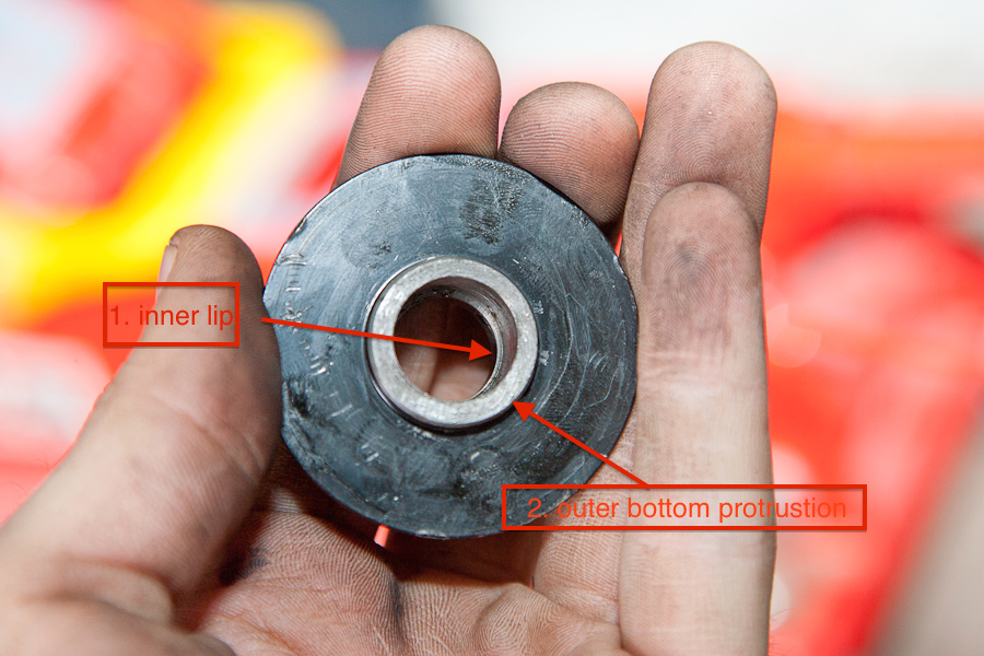

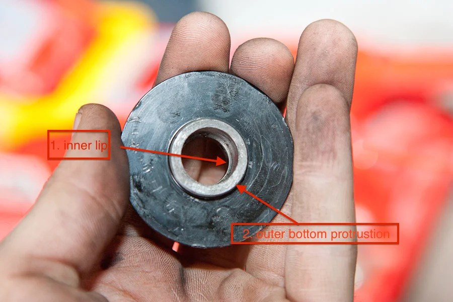

I'm having issues fitting the AST top mounts to the Bilstein B14 shaft. One of the parts supplied just doesn't seem to make sense. In other posts others have said as much and though I've read much relating to the issue, I am still unaware of any solution. Is anyone?

the inner lip (1) prevents the part from sliding down the smooth part of the shaft. If the lip wasn't there the part could slide down (apparently some people have removed this inner lip)
If the lip was removed it would mean the lower protrusion would create a gap between the two parts. Is this how it is supposed to be? Are you saying the sping load would push the lower black plastic part up the shaft thereby eliminating the gap?
I cleaned up the inside of the top bearing and wound it down. The inner lip wasn't an issue at all and It all seems to fit fine now. It sits flush on top of the main shaft ledge and when the spring is wound up it all makes sense.
No need for any machining at all.

You're right about the different thread pitch. I had a local machine shop to whip up a copy of the AST nuts with the thread from the B14. Make sure you get stainless HT steel. I think they cost me about AU$40 each...
The black metal AST part that sits on the B14 shaft needed to be bored out a fraction. And the internal flange on the same part needed to be machined back a little to allow the part to sit down flush on the b14 shaft... That was about it i think. Make sense?
