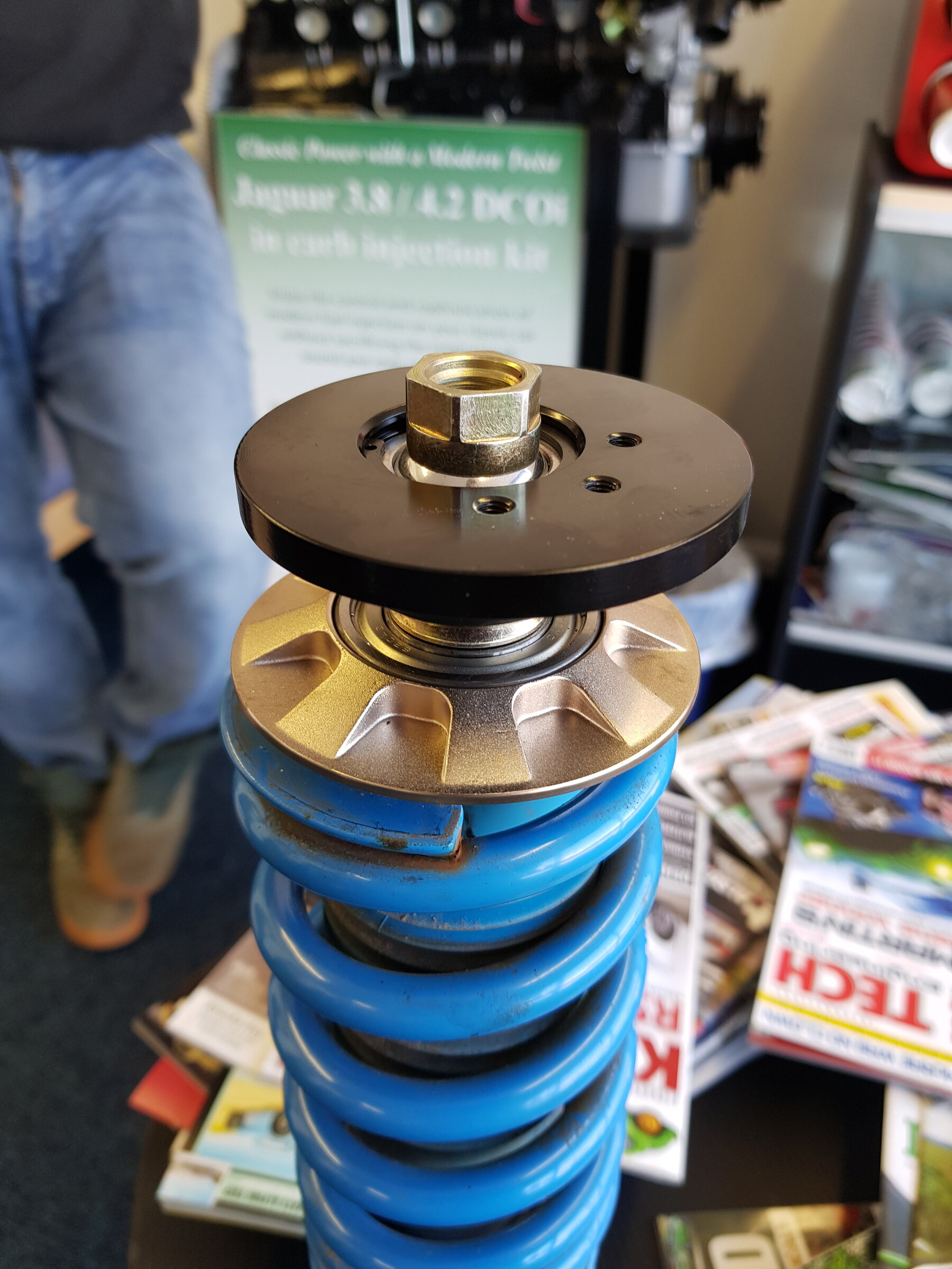

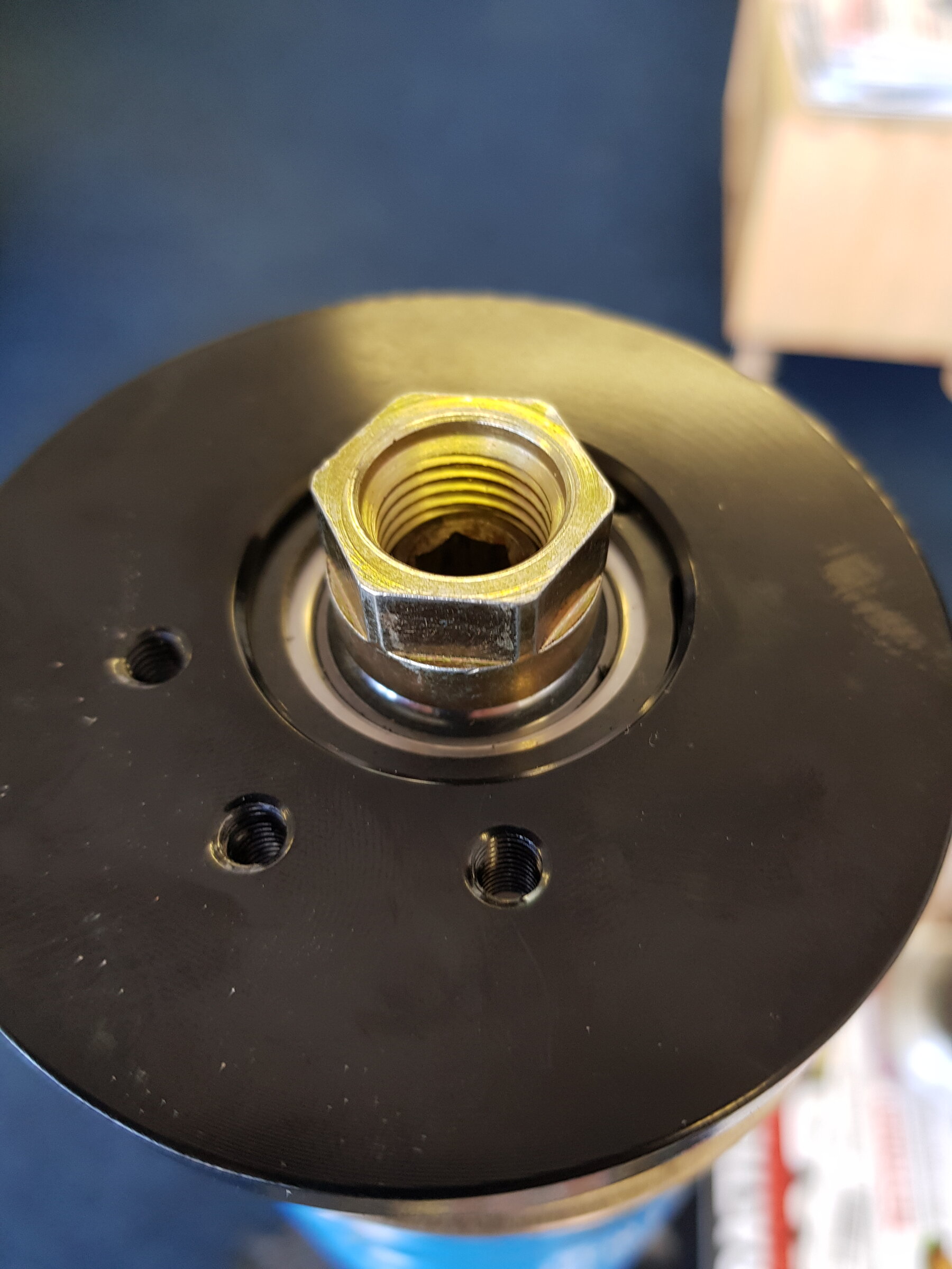

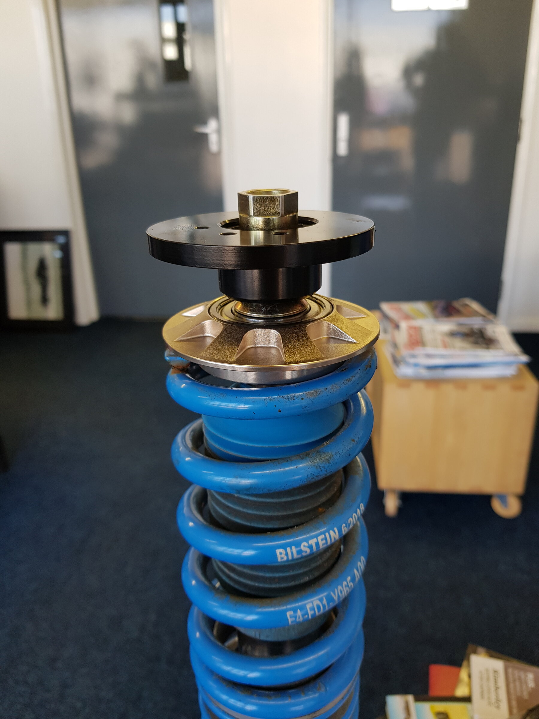

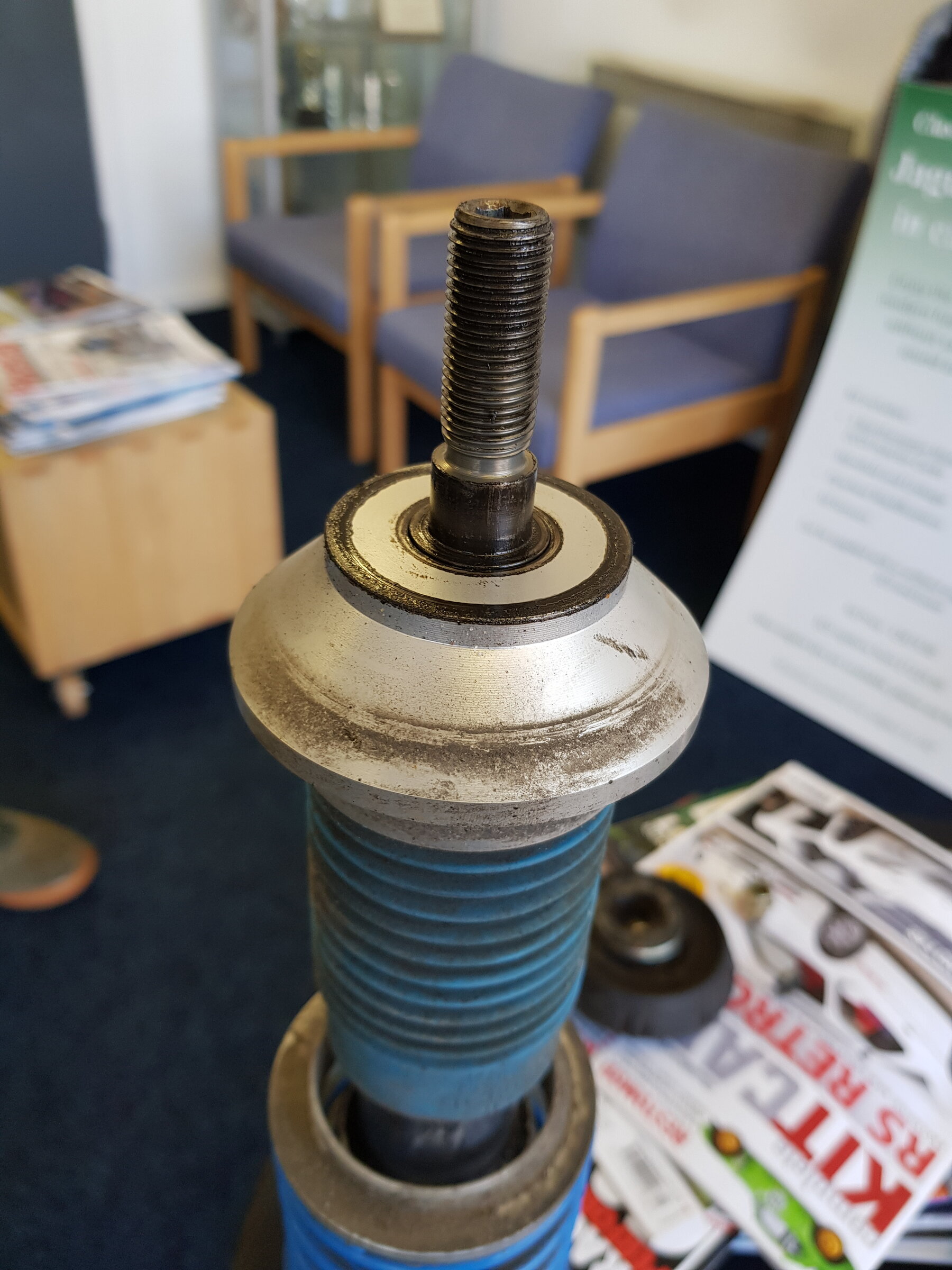

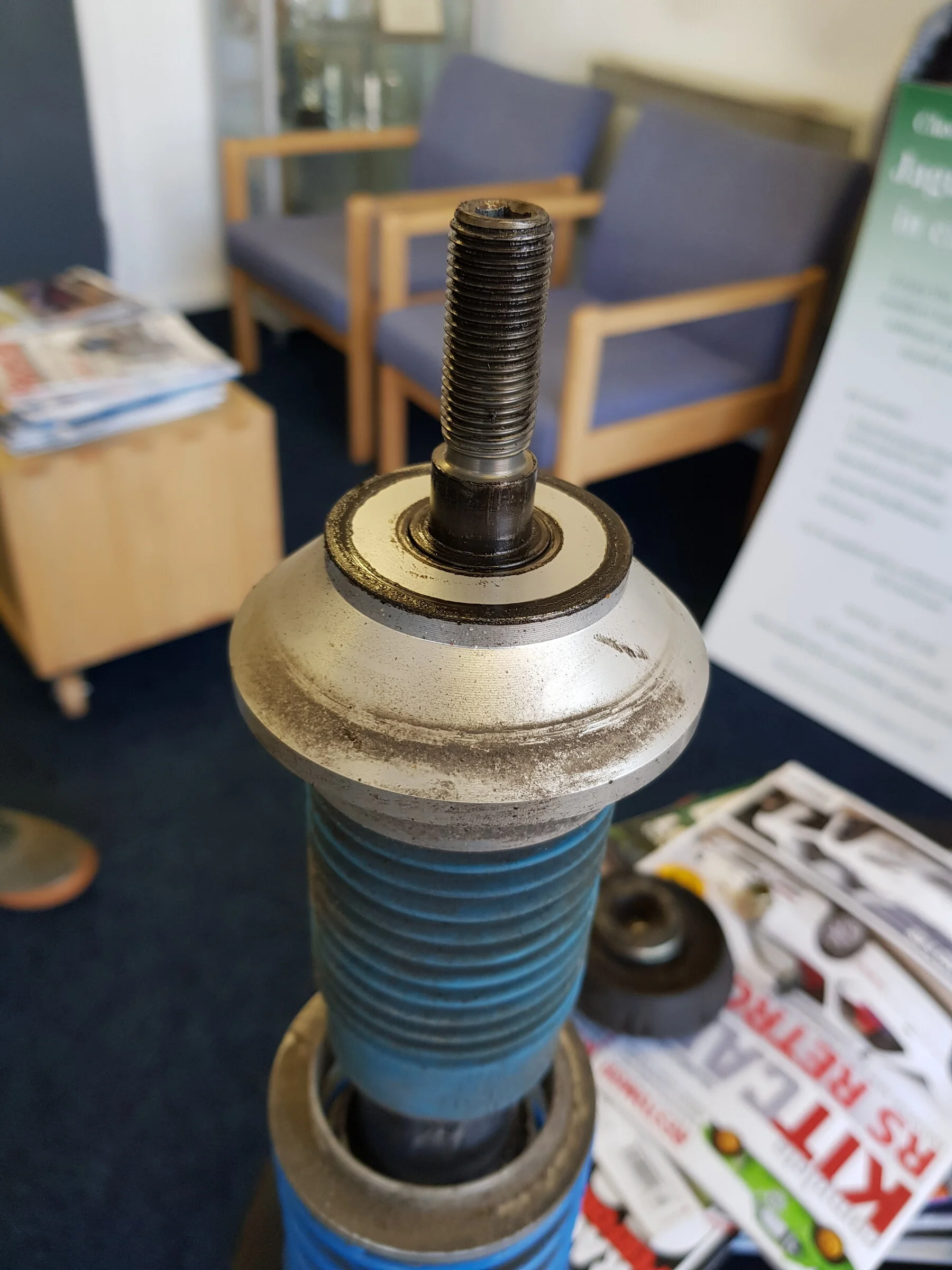

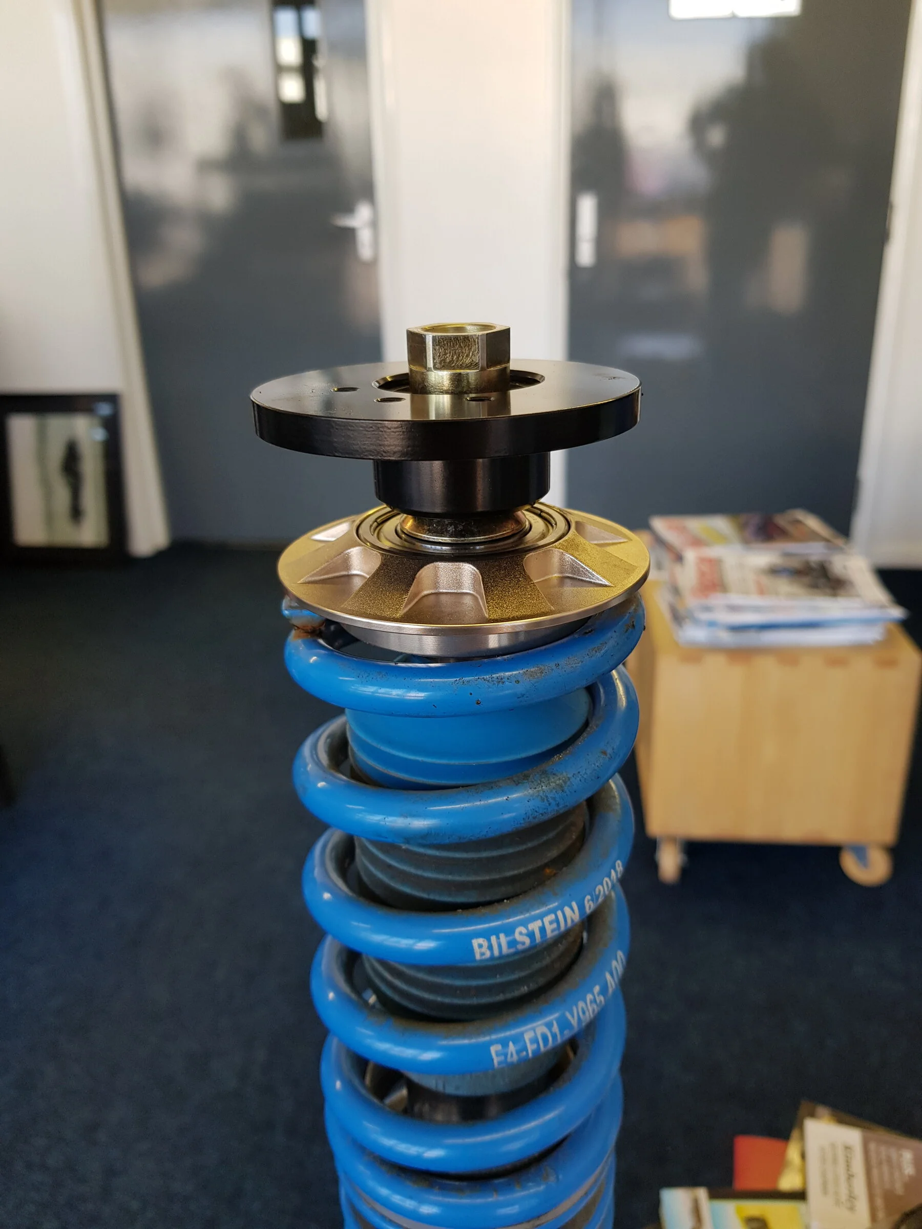

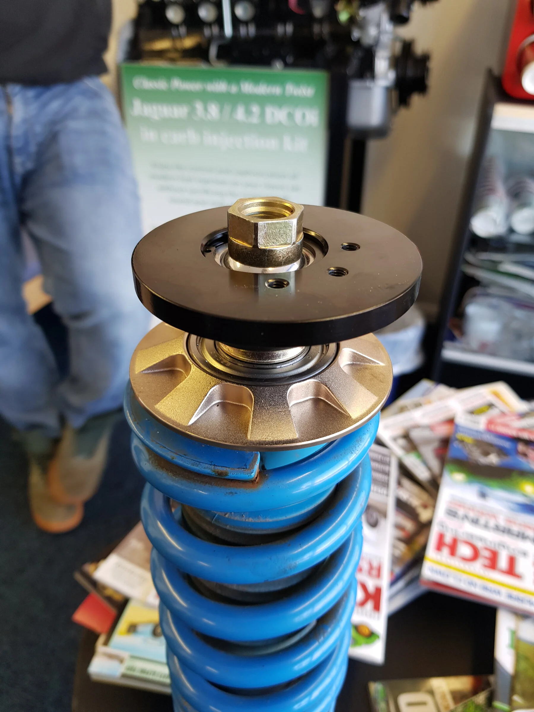

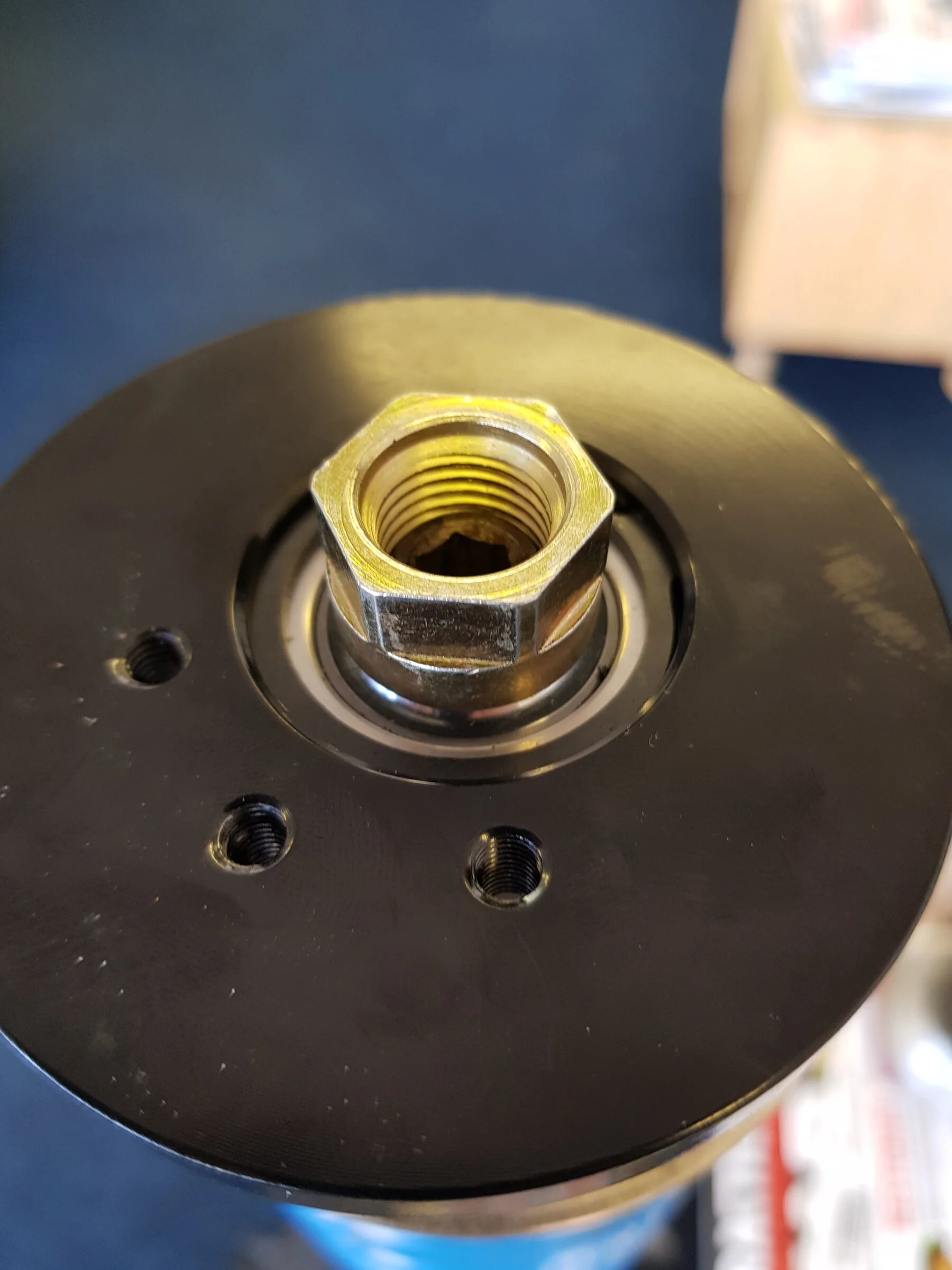

Hey guys. I'm after some caster adjustable top mounts that fit Bilstein B14s correctly. I've tried the BC top mounts but they don't slide down the shaft far enough and don't get enough thread engagement (see pics) The top mounts aren't wide enough to go over the thicker part just below the thread.
Does anyone have any recommendations?

Gonna say, it's upside down 😂
Plus you need to take the silver top hat off as well.
The black bit is upside down yes (Not sure why they put it like that when they took pictures) but that isn't the problem anyway. The top hat that sits on the spring wouldn't go further down to meet the spring. The top hat wasn't wide enough to fit over the thicker part of the shaft

Right, fit these in the rain yesterday as I'm impatient! They fit perfectly fine. The mounts sit above the thicker part of the shaft unlike the standard top hats. Just had to re adjust the preload to sort that. Thread engagement is fine. I'm not sure what the fuss was about at the garage.
JamesBryan
They probably saw the spring was loose because of the gap difference and thought "this must be wrong they don't fit"
