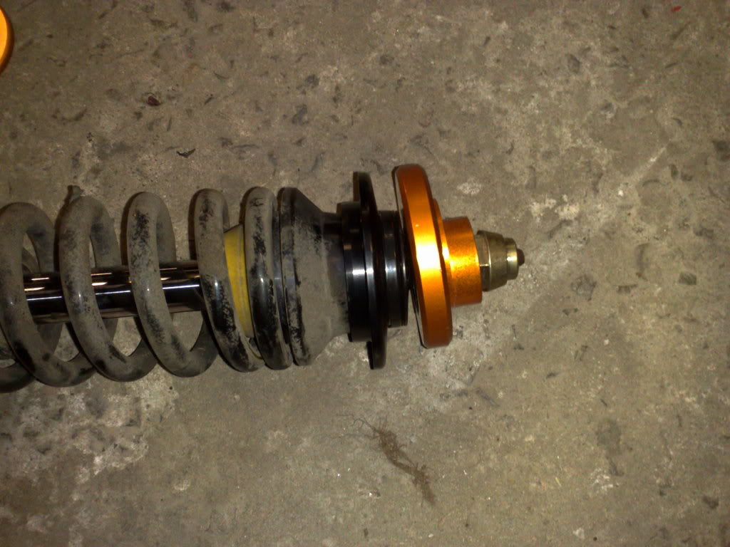

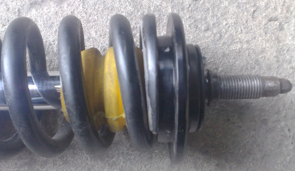

After I was told this was wrong I decided to whip the shock back off to try it without the hat, just mounting straight to the AST mount
I have had this back on the car but once it was all back in position it just didnt look right. I could also move the spring up and down
As you can see in the pic also the spring dosnt seat properly into the hat

In the first pic though the spring dosnt move up or down whereas in the second there would be loads of play
  Chocolate Bar™
the second pic is 'correct' however the black tophat should locate into the spring. but it looks too big so may need to be remachined or replaced.

The top hat should sit inside the spring. It might be a tight fit. There should be no fitment issue as AST parts are for standard coilover spring sizes so there should be no issue with that.

You have lost about 45mm when removing the tapered Gaz plate, so you would need to compress the spring to counter that.
The first pic looks fine to me! You cant account for viaration in spring I.D if not!
But I haven't fitted mine yet! So could be wrong!
powey who told you the first pic was the wrong way round? as from knowing nothing about these, the first pic looks correct to me if i was winging it!

the first pic doesnt look right to me, but then what do i know? curtis will clear it up
also you have the top nut on the wrong way round in the first pic ;)
i think it would look right if the nut was correct and the top hat was pushed into the top hat of the topmounts, properly.

Top nut was only holding it together, thats all the pieces tight together i.e the spring is sat into to hat then this is sat on the top mount

powey, dont worry i knew the nut was only holding it together. in theory i believe the ast top hat is designed for a 60mm spring which the AST/ FK/ and other makes of spring are. by the looks of it, the GAZ use a slightly smaller spring
  106 GTI
GHA​
= Adjustable height, adjustable damping with 2.25 inch/57 mm internal diameter race coil
springs to lower from 30-60mm
Just taken from dampertech, seems I need to get them machined
