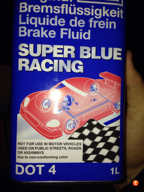

Got some of this today in preparation for fitting my brakes and I noticed it comes with a warning that it cannot be used on roads. Why is this? Just because of the colour?
Because legislation is much more lax if they write that. Same reason most pads aren't for road use, even if better than road counterparts. It will be fine, I've gad sone in my car for a year and a half
You will be fine mate, I've used it for ages
This. Been in mine for ages.
Just done a flush with it last week, MOT'd today all fine and dandy. It is also much better than the DOT4 it says on the Tin, but IIRC because they have only had it tested up to DOT4 so can't put on the tin that it is higher grade.
The actual reason is that while race brake fluids have very high wet and dry boiling points dispite being only dot 4, they are very hydroscopic.
They absorb water and deteriorate much more quickly than fluids normally in a car for road use.
Race fluids are designed to perform under extreme conditions but be replaced often.

So all the it will be fine brigade , did you ACTUALLY know why the warning is there .
I kind of know with regards boiling points etc but after speaking to various people over the years about what good fluid to use on the road and the occasional trackday this came high on the list of ones to use.
You will not get better than SRF , period , you might get cheaper.
However more to the point is why the warning is there , its not designed to sit around in a car like regular fluid , its designed to be changed often.
Every 3 months we used to do , alot of people do it every race meeting

It's all down to the fact that it's blue. It used to be legal in America until the DMV said that brake fluid MUST be amber or clear, no other colour, since that point ATE had to state that it's not suitable for road use.

Just to clarify, they have started putting that warning on the front of the Ate Superblue tins due to it recently been deemed it not suitable for road use in an American state (Florida iirc) due to the colour
I appreciate people saying that the more race focused fluids need changing fairly regularly. But the Superblue says up to 3 years on the tin, although I'd personally advise people to change brake fluid at least every two years/every other service.
