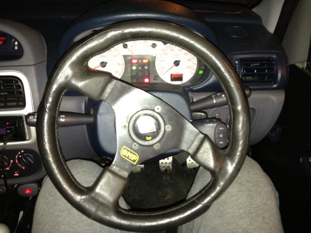

However I've come across a problem with the steering. When I'm driving its as the steering is too light? Also this is how my steering wheel looks when I'm going straight
But when I've just parked up on my drive and set the steering wheel straight and the wheels are straight basically when I'm driving it feels very light.steering wheel not straight and I'd in hit a bump or uneven road it pulls slightly?
  182, SQ7, Trafic
Your tracking and camber is all out by the looks of it, needs a good four wheel alignment done if you've got camber adjustment. If not standard tracking will be fine!

Will be either rack bushes shot or tracking out. No reason not to drive it steady.

No haven't got camber adjustment.. Ill take it to have all the tracking done then see if that helps. Danny do you have a pass driveshaft with cv boot?

Okay I'll try the full alignment see what that brings then move from there... I know my pass cv joint has gone as well as there was a fair bit of grease out of it
