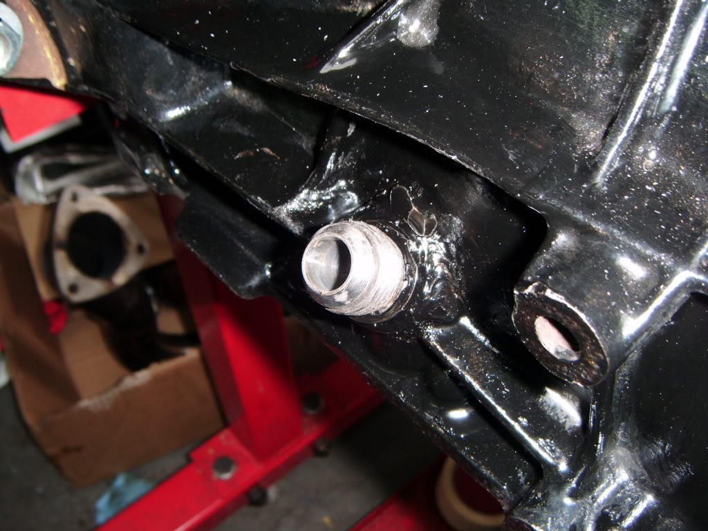

Weld on or tap and lock nut a fitting in both require removing the sump to be done right so I would go with weld on personally. Make sure that the drain collector is right for your turbo's central block.

Youll need to remove the sump for a weld on boss as well as I wouldn't want the dwarf to fall into the sump when drilling it.
I've wnt for a weld on boss to the block this time to make sure the drain entry will always be above the oil level. This is not always the ce with a sump return no matter how high it is on the sump.
Yeah if you try and weld it on when its on the car its quite low, so it would have to be a dwarf that did the welding.![]()
Dont drill the sump, do it properly and take it back In to the block,
This!
That just drilled out and the fitting welded in there?
Drilled and tapped not welded is the way to go.
Why?
Because welding a fitting into the block will be horrid as its cast iron, plus if its drilled and tapped then its replaceable easily in future.
Please bear in mind my post you quote was ONLY in the context of it going into the block, not the sump, the sump isnt strong enough to make do will drilling and tapping.
Sump is fine it's a non stress point.
