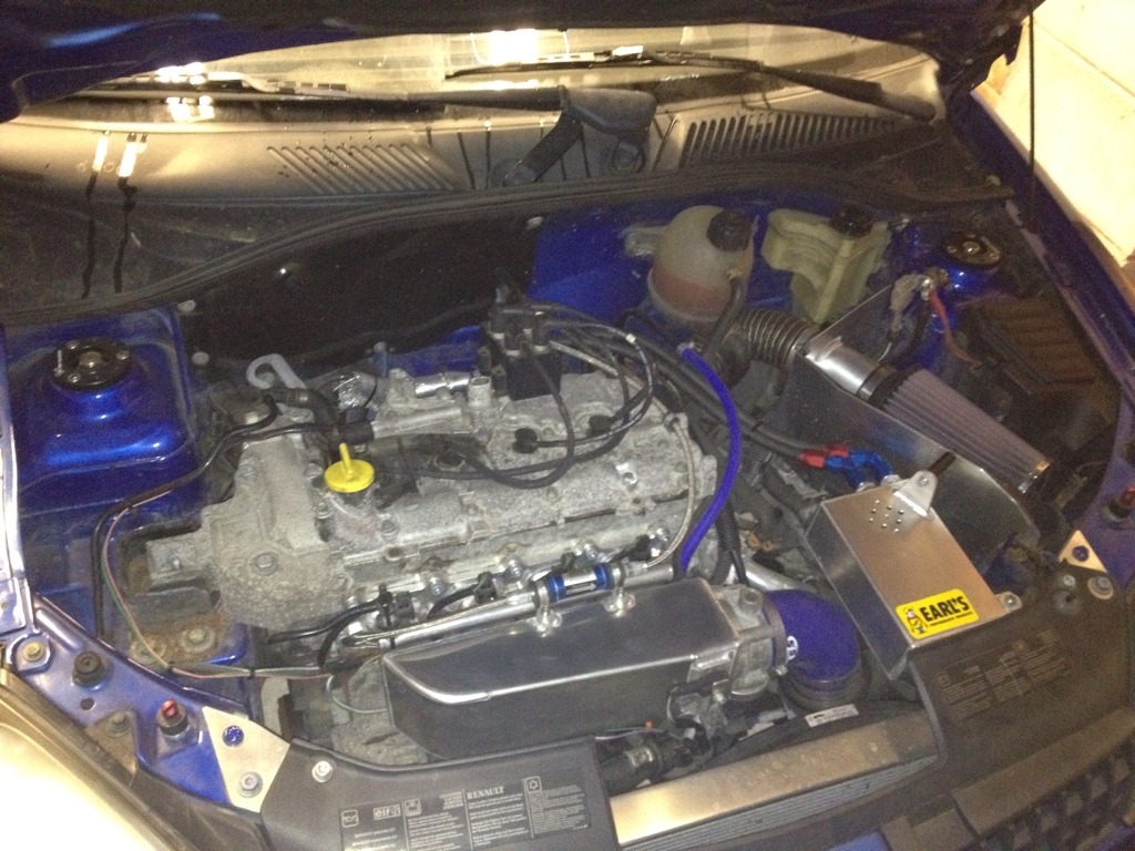

So yesterday had the day off work and got on with removing a few hits and bobs filter radiator inter cooler ect next thing I know I had removed the turbo manifold down pipe intercooler radiator induction kit all pipes,,
Start of day
Abit moved :)
I'll get pics of all the parts later on but I manged to get the turbo manifold and sownpipe all out withou removing the engine I undid engine mound and gearbox mount it moved forward a little but not enough to get it out so got the tool for the job... Fiat punto scissor jack LOL
Put the jack against the engine and the bulkhead and wound it out and the engine was moving plenty and managed to get it far enough forward to get everything out was well happy to say the least..

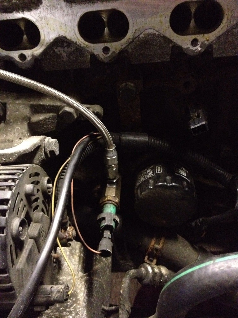

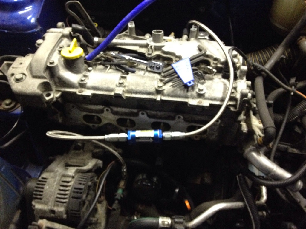

This is where the oil feed is for the Turbo
Will I be able to fit this in the same position on my ph1 or will I need to make a new feed on the sump..

The feed fits in the same place, are you getting mixed up with the oil return that goes into the sump matey?

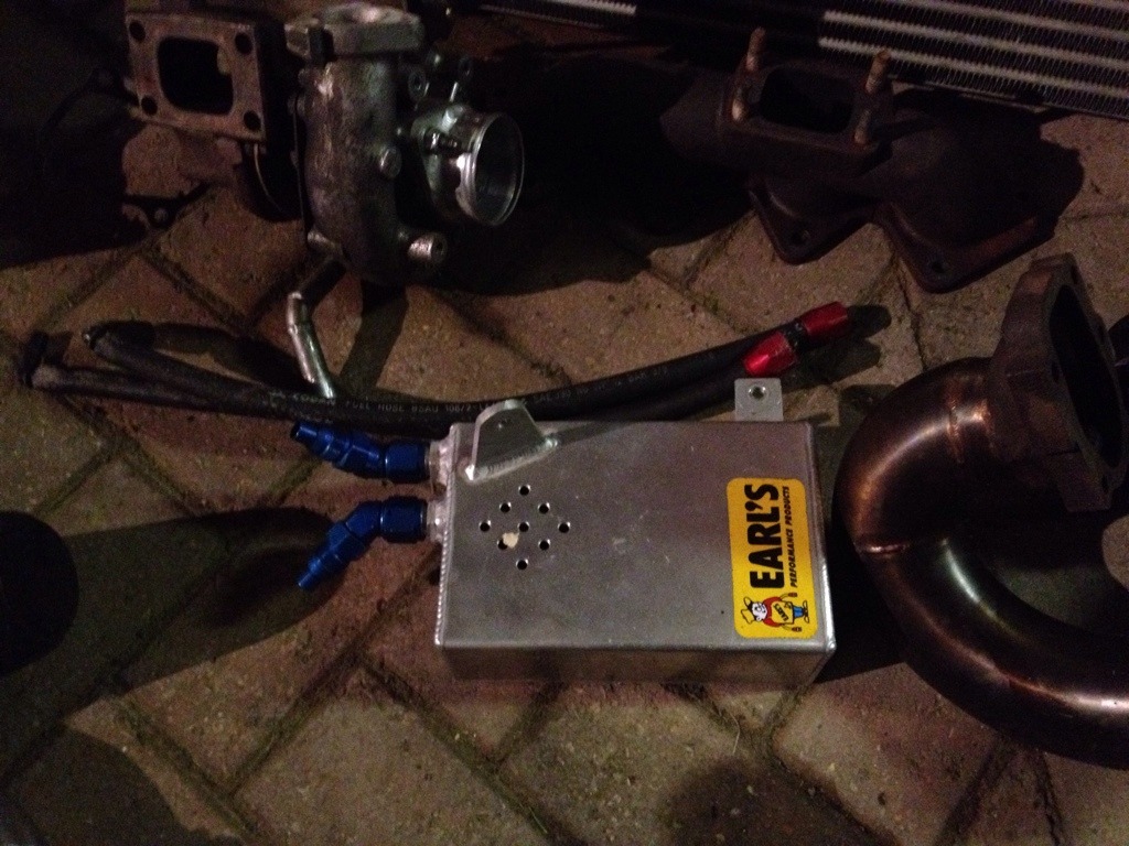

That's a great deal!
build looks to be well done too, proper manifold and catch tank!
  Ph1 T

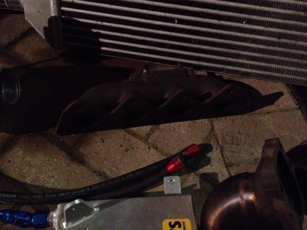

I was wondering about the manifold as I'd not seen one like that before on the other turbo cars looks like he's had everything fabricated himself

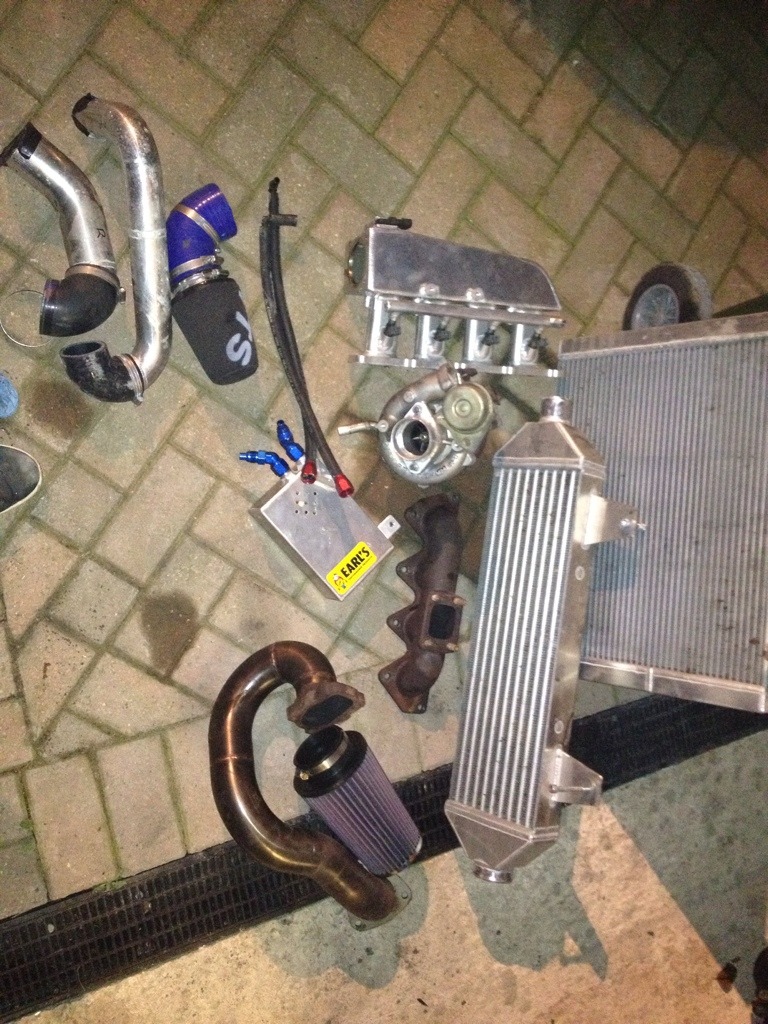

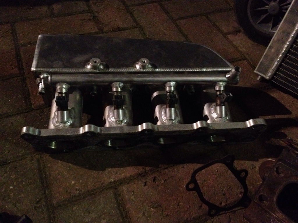

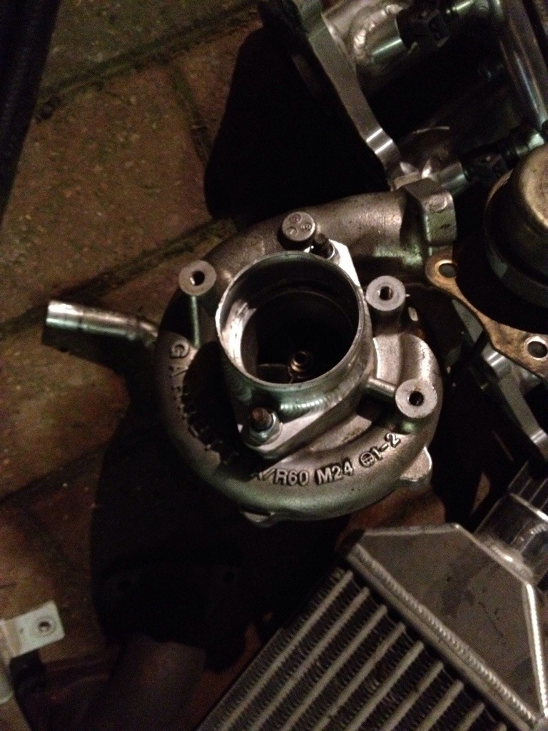

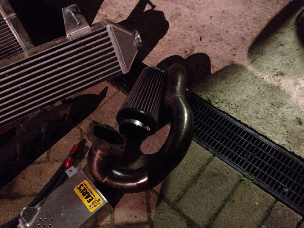

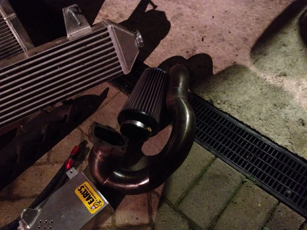

heres a few photos of what i removed yesterday and parts ill be using

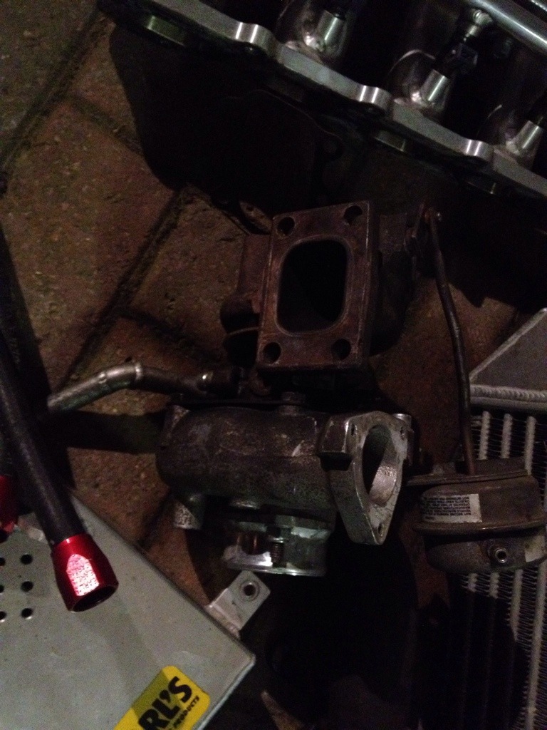

turbo :)
Im about to order my boost piping now ive measured each ends on the intercooler and one end measures 63mm and the other 50mm does that sound about right to anyone? also on the turbo the size is 63mm.

i dont like the look of the manifold looks rather dated what can i use or where can i get it freshened up?

Doesn't really matter tbh as long as it fits, i'd run the Turbo into the 63mm end so all the pipes are the same diametre then the 50mm you only need a pipe to go from 50-70mm and your sorted for the throttle body :)
If you want a cheap replacement intercooler, Chip is using a standard focus ST one on his ph1 (well at least thats how MWM built it..) and that doesn't hang about. Those intercoolers can be picked up for peanuts!
Ahh right I'll do that then like you said turbo into the 63mm side and other into throttle body,, yeah I think chip is using the st one if all fails I'll get hold of one,,

ATM ive got the exit on the side of the turbo is 63mm so im going to run that straight to the intercooler side which is also 63mm, Run the intercooler side which is 51mm up into the TB which will have a reducer taking it to 70mm to connect up. Then the exit on top of the turbo is 40mm so will direct that up and around for the K&N air filter,,

Your theory doesn't sound quite right there Dan, 40mm onto the air filter. The entry/inlet to the turbo is usually the biggest diameter entry to the turbo.
