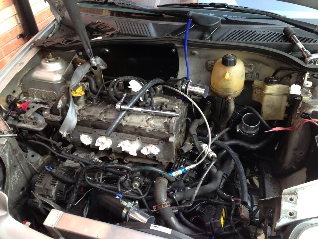

Due to me being a heavy handed b*****d today I've manage to snap the map sensor and the sensor connections off 2 injectors ...
Luckily I've got some spare injectors so fitted them but fuels pissing out of them so I'm guessing there shot!! Getting fed up now lol

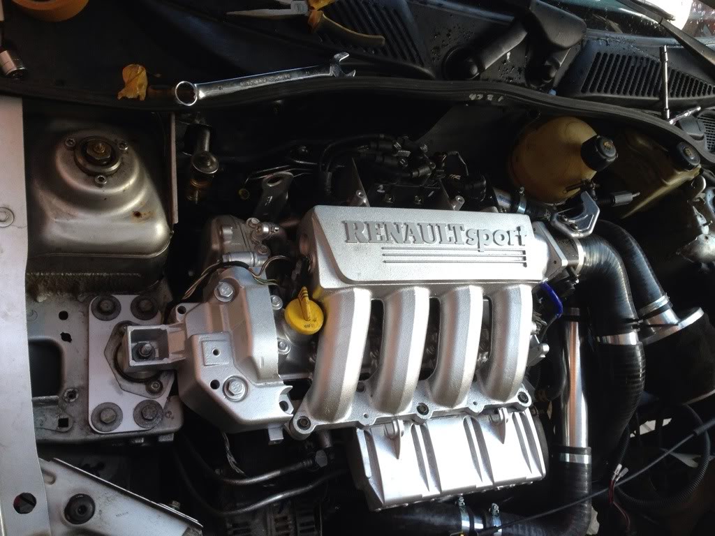

Had all the bits off this weekend and gave them a licking of vht paint then cooked in the oven at 250' nearly set the place alight left it for too long haha cured perfect though :)
Fitted my actuator tee and connected it upto that pipe off the fpr.
Fitted the new banjo on the water feed so it fits right and no kink in the pipe now.
Had the gearbox mount out and made sure I tightened it up fully this time so the knocking has now gone :)
Think that's about it for yesterday another few little bits done :)

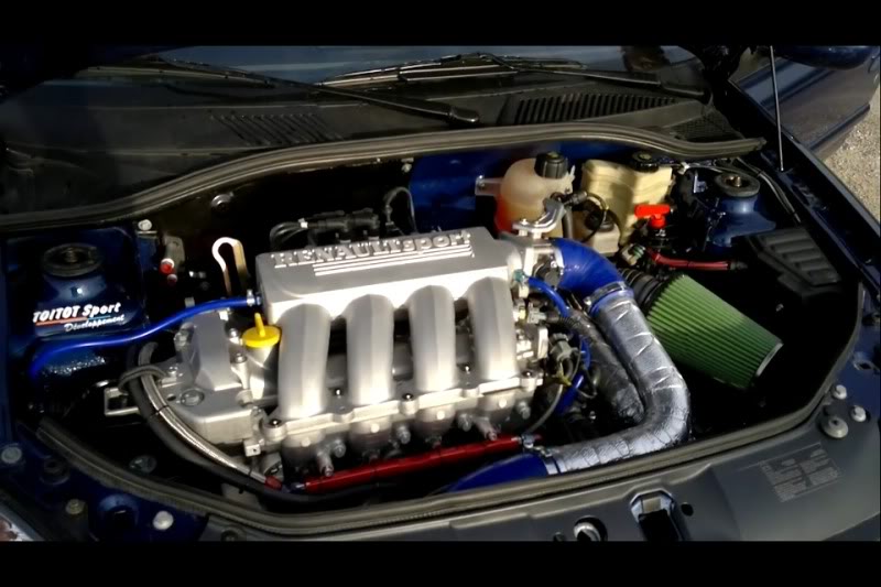

deffo looks better, not 100% sure thats the best way to fit the boost pipes but it'll work fine
Found it on a video , its from an oversea clio, looks the best way to do it tbh
Yeah does look better tbh im going to leave it as is until mapped as just wanna get it finished can swap piping round after
My routing is far from ideal (i compromised by keeping the battery in the engine bay), it's made no difference to power, and no difference to lag. If it fits then leave it :)
