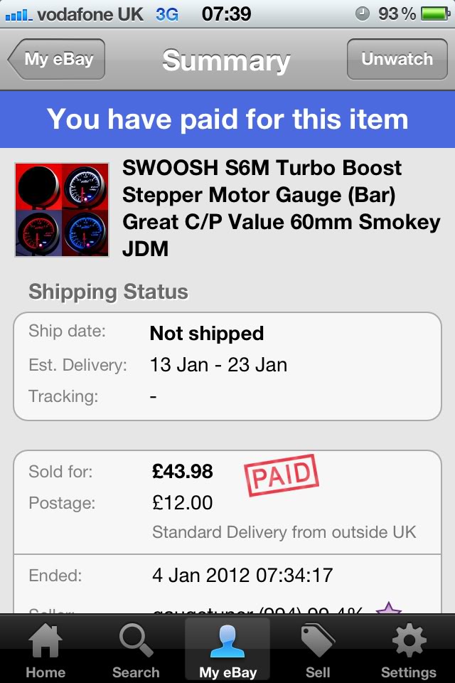

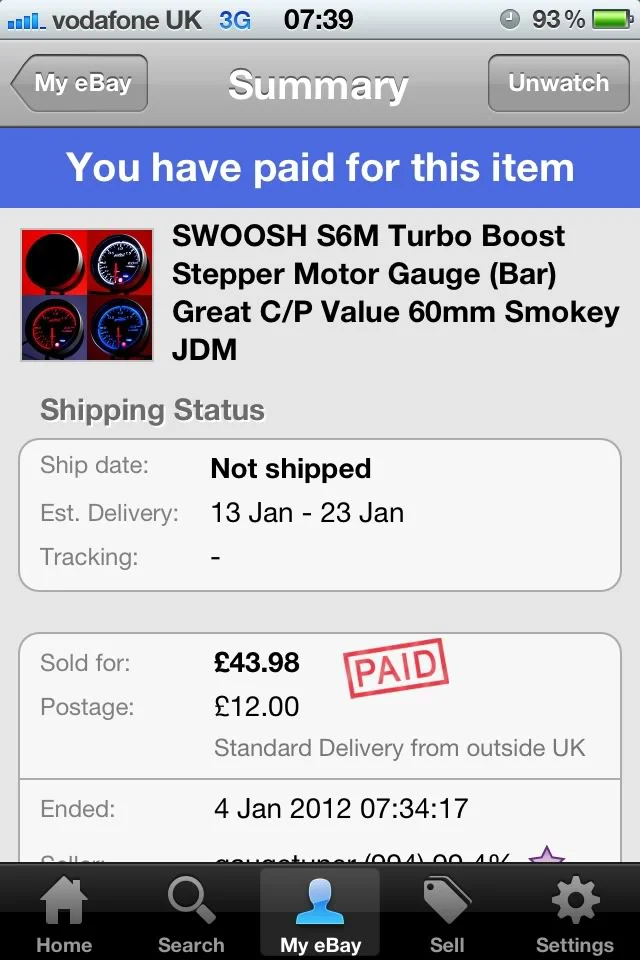

I did say my next mod would be the TIP that I talked about earlier in the thread however after discussions with my mate in work (Turbo crazy) he convinced me to get a boost guage to see that my actuator was set up correctly. Thinking about how important getting boost settings right I decide to invest in one so I had a look round the TT-forum and decide that for price and quality the Swoosh guage was a suitable one to go for. Upon looking for one this morning I found that both PSI and BAR gauges were ending within the hour so I went straight ahead and ordered a BAR one (old school).

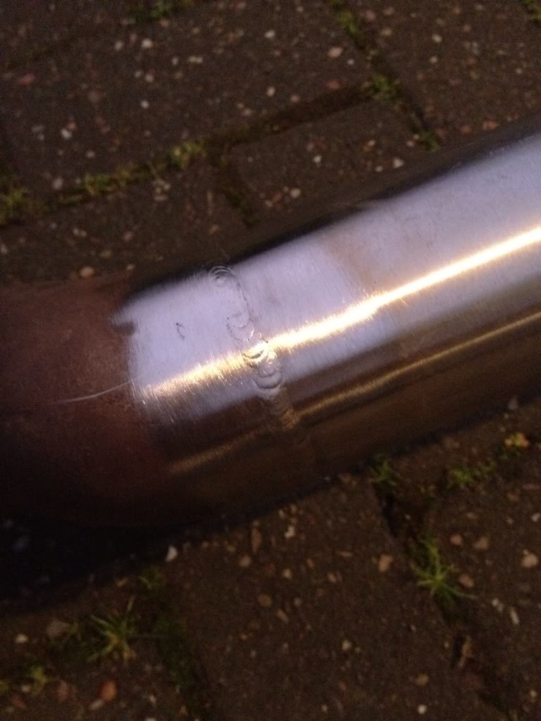

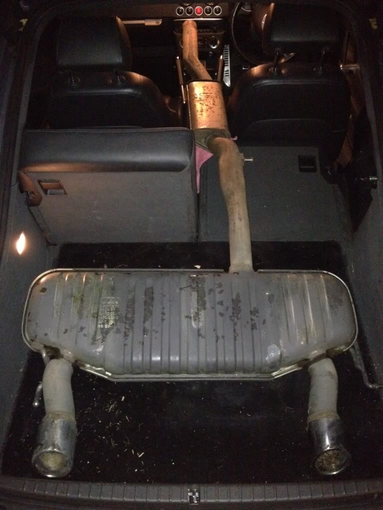

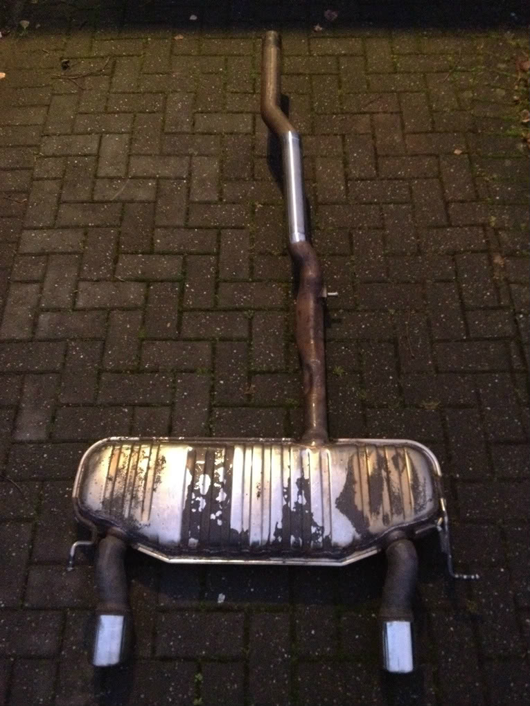

Got the phone call today to say my exhaust had been done and that I could collect it from the contractor. More than happy with the quality, the guys that did it really are top notch welders. Heres a couple of pics, 63mm hygienic pipe welded in where the mid box was.
Old:
New:
I've got a feeling this will be quite loud considering there are now no silencers but just the cats to restrict anything.

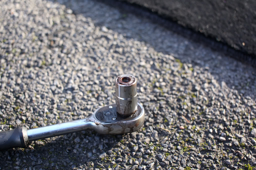

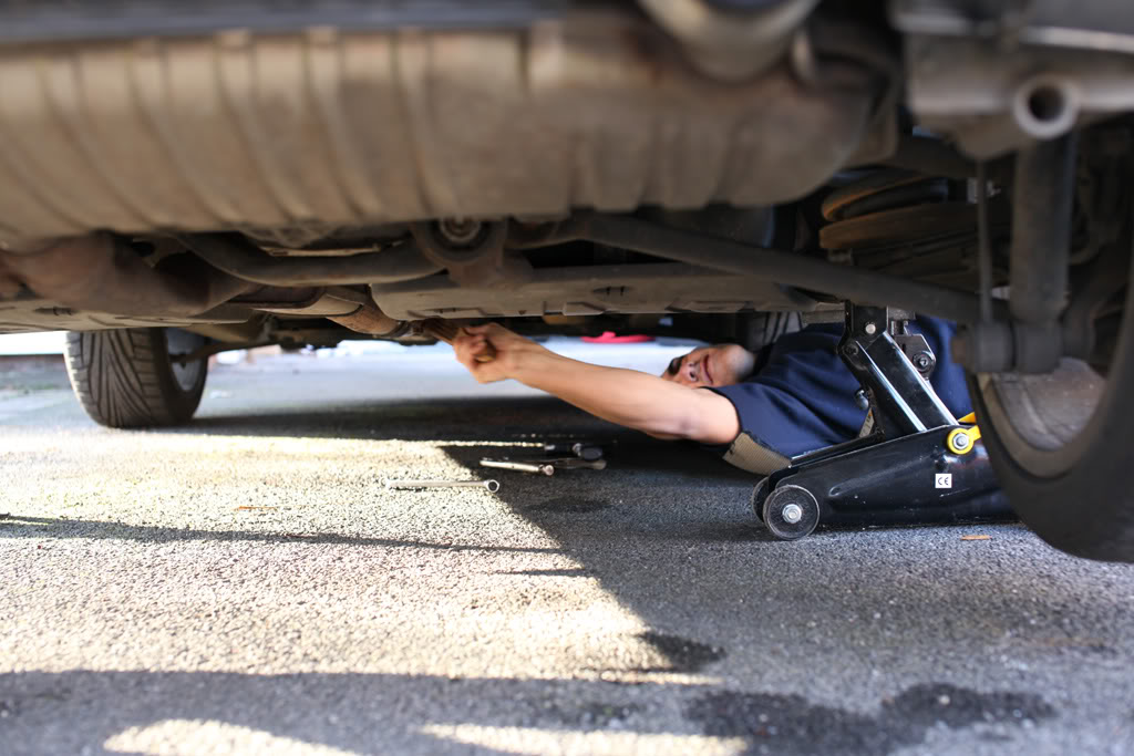

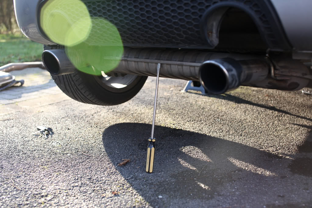

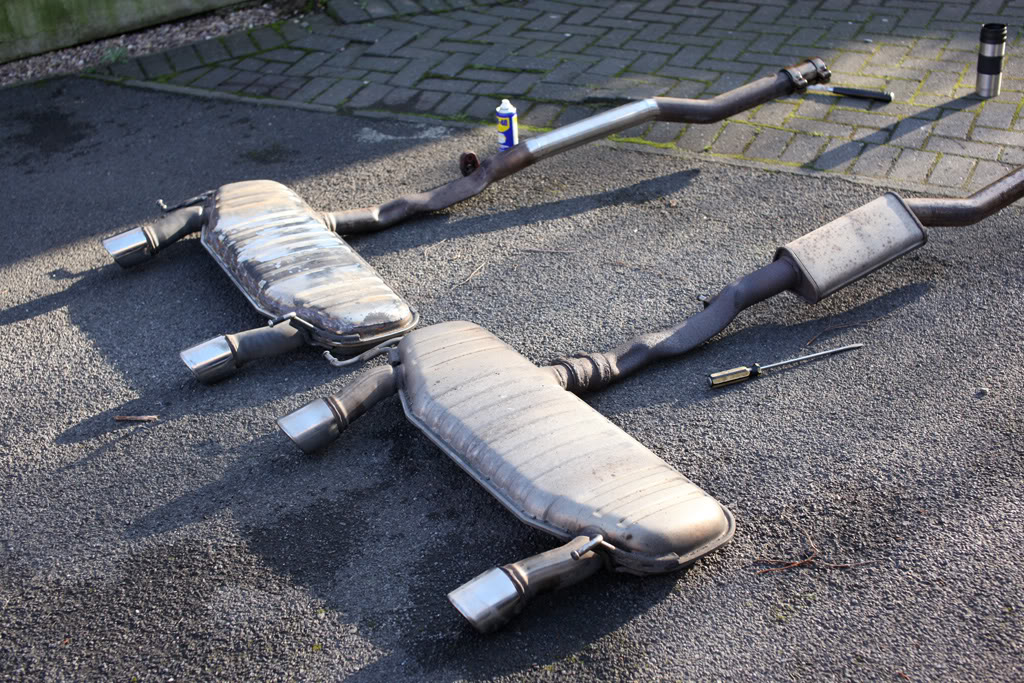

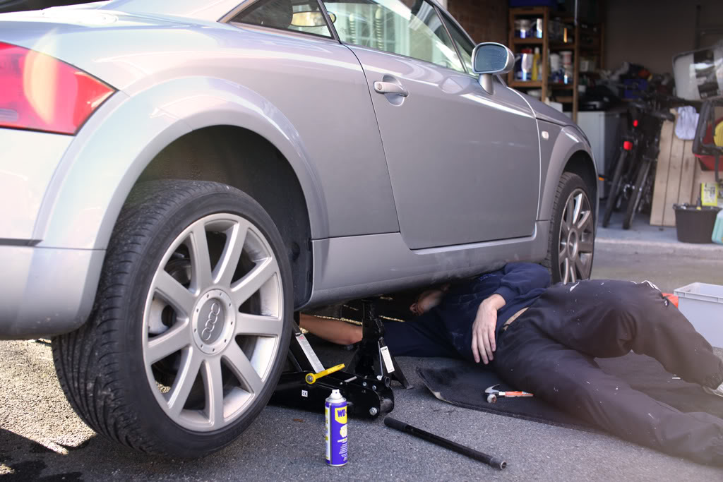

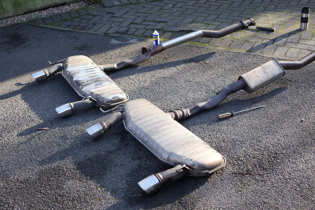

So I found it in myself to brave the cold yesterday and fit my exhaust. I got the car up in the air on my 2 axle stands and set about removing the exhaust clamp just after the cat. By this time James Bryan had come round with his camera to take some pictures and laugh at me struggling like hell to loosen the 2 bolts on the clamp. The bolts seemed to have turned to fudge after 9 years of road muck and grime. After rounding off both nuts with a spanner I managed to hammered on a 16mm socket and get them both off! I swapped the clamp over to the new exhaust and it flew back on. Had the whole job boxed back up in just over an hour. Heres some pictures courtesy of James and a video too!
