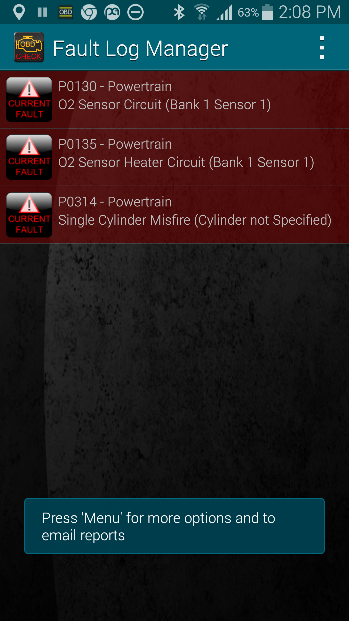

Not sure if that would do it... I've still got the engine light on but now i've got to sort out the misfire which is back where i started...

Ok so the only way to make it start is to check the codes, clear them and then it starts.
No idea why that is, idea thoughts?
And I've still got a misfire on cylinder 2. Its not plugs, leads, Injectors or coil as I've changed them.
Well the fault codes would lead you to believe you've got a lambda sensor issue there mate.
  Clio 172 cup
Agreed but the misfire is probably throwing the lambda sensor out as it's chucking fuel into the exhaust?
It appears that even resetting the codes isn't the fix. I've tried swapping the ECU, UCH and key but it doesn't make any difference.
I think it's clearly a sensor stopping it working so I'll start swapping sensors from the other engine one at a time, I've already swapped the lambda and it was covered in fuel when i took it out.
