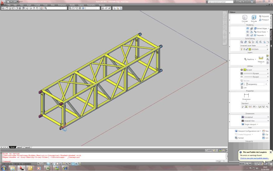

The company I work for design and manufacture aluminium structures. We also have a standard range of trussing components. We'd like to update these into Inventor and hopefully be able to have some kind of linked automated BOM creation.
Below is a typical truss section:
I presume that the main Aluminium frame would be drawn in one part file then the male and female connectors in two more part files and the 3 then combined into an assembly file which I can then create drawing files from? Is that correct?
After this how would I go about creating the BOM to list each section size, length and and any machining details? Would this update automatically if I change either the part or assembly files?

  1.2 Dynamique
I personally wouldnt do it that way (although that is probably down to limited experience).
I would model all the bars etc individually and then assemble them, then assemble the connectors onto it.
THEN the BOM should automatically update.
However, I have had little experience with the BOM tool.
