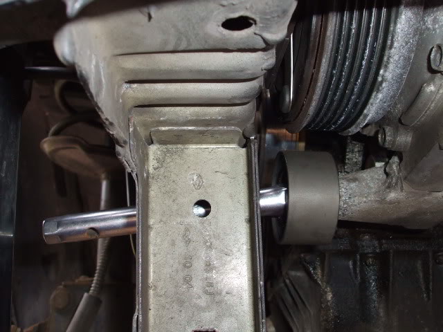

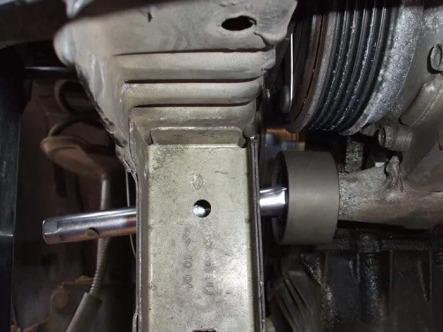

It occurred to me yesterday that I didn't change the roller thing as it didn't come with my belt kit. Looks like it's going to be a complete pain in the arse to get off and require engine mount off AGAIN but I shall do this and report back. Everything seemed to rotate happily but without anything to compare it with it's difficult to know if it's buggered.

I use a short 13mm then a wobble end extension.

Already bought what I was told was the whole kit and replaced the belt and tensioner. You're right though, that wheel on its own is £45!
Apparently this was "left out" of my kit and another one is being ordered in for me to collect. Soon hopefully.
