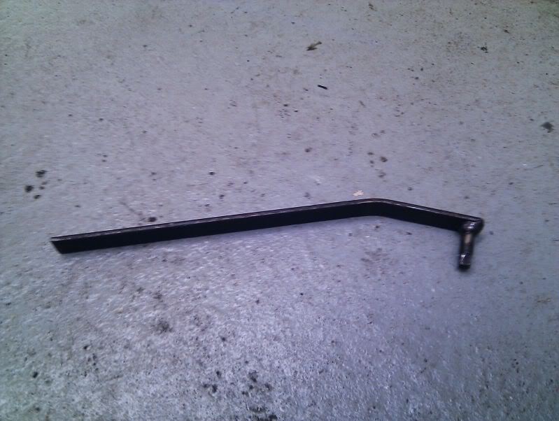

Aux Belt tensioner tool
I quite like the really pikey version of using a jubilee clip around the tensioner, means your hands are then free to route the belt as you dont need to hold it.
Sound like an horrific bodge, but actually works really well.
Short 3/8 extension works well too.
usually when anyone sees it the reaction is "what's that pikey looking tool......oh you've got the belt on already.....f**k that's quite good really isn't it"

Yep I like it too, have done alot of belts on these cars this way, however last weekend the jubilee clip popped off and hit me in the head! lol!
Hence me looking around for alternatives!

The exact same thing happened to, partly because it was a proper nasty jubilee clip. I've made a tool just like Dan's now.

and i bet it's brilliant. I'd make a batch of them if a few people wanted one. Wouldn't be too hard to knock up
It is Dan before I made it and just after the jubilee clip incident I was struggling with a small extension on a shitty breaker bar that slipped on occasion and nearly fucked me up lol
I reckon you'd sell a few danny, what sort of cost would we be looking at?
I assume you just take a piece of 3mm steel, bend it and then mig weld an old 3/8 extension onto it?
I would make one myself but it sounds to me like you have the formula pretty well sorted with the bend in the right place and the extension at the right length?
Jack, that really is all there is to it, Mike from MWM has made a similar thing that I have seen him using, just make sure you check that the bit of steel sits well first before you start welding, ie to make sure you have bent it in the right place for clearance, then mig a 3/8 extension on, not rocket science at all.
Cool thanks Chip. For the sake of saving faffing around making my own, I'd be interested to see what price Danny could knock some out at.
I've got a couple spare extensions and I've got a
It's a bit embarrassing really, I've been doing belts on these cars a few years now and have been making do with jubilee clips and 3/8 breaker bars :o
wouldn't be a lot. £10-15 i guess, i'll check out ebay and see if i can get a load of extensions to cut up for cheap. I have meters of the steel strip already

Apparently you can't anymore, he said renault won't offer any specialist tools to private customers as of a few months back. I just got a cheap sealey alternative for a tenner off the bay, if that fails then I'll crack the jubilee out!
2nd, 3rd or 4th the jubilee clip method, has worked well for me on 3 occasions. My initial attempt with a fabricated tool to match the renault item ended up snapping the alloy around the tensioner housing.
