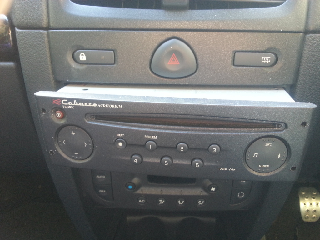

So I did a little reading yesterday regarding fitting an aux in cable to the clio sport headunits and it was suggested that you needed to know which type of headunit you had, and that there should be an empty socket on the back, adjacent to the yellow plug.

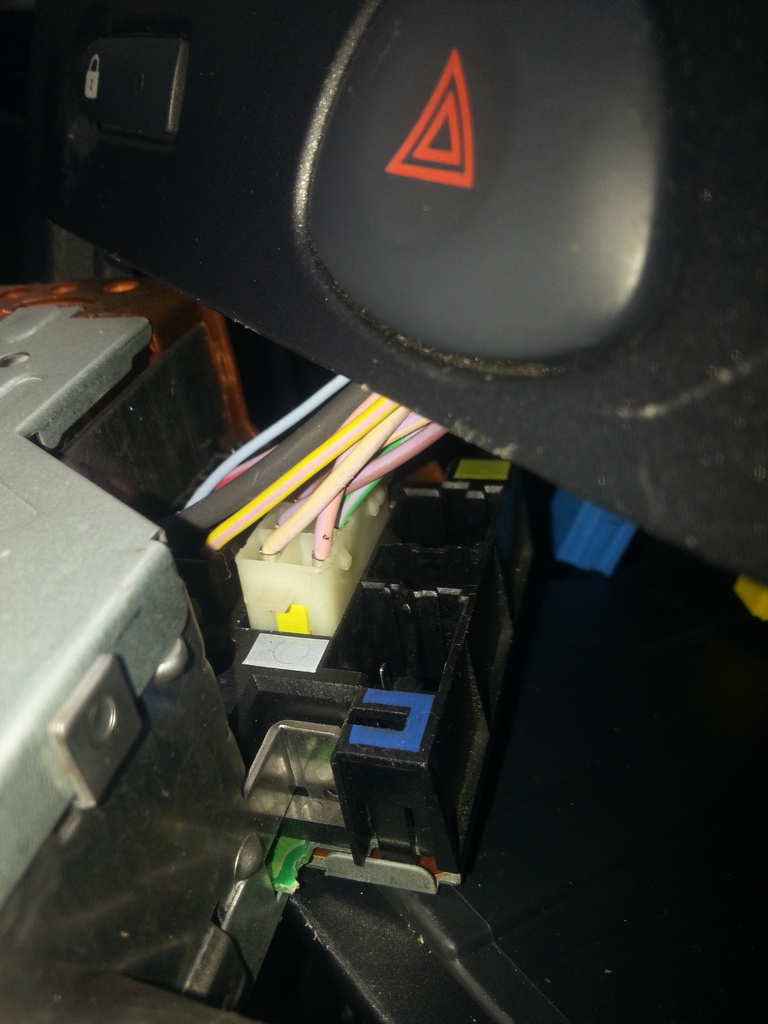

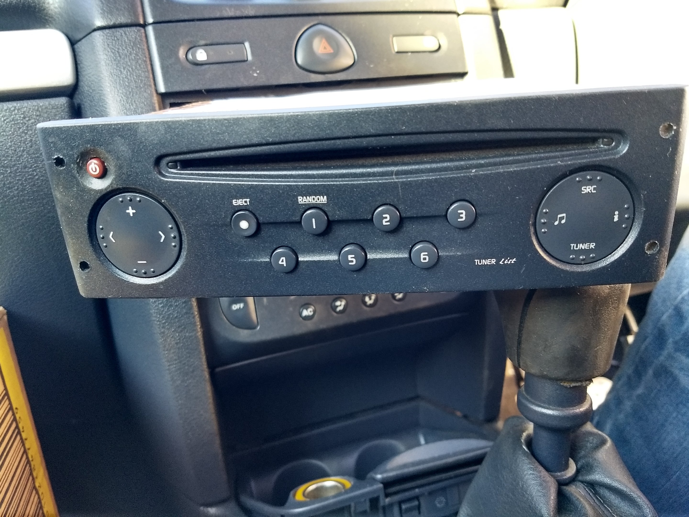

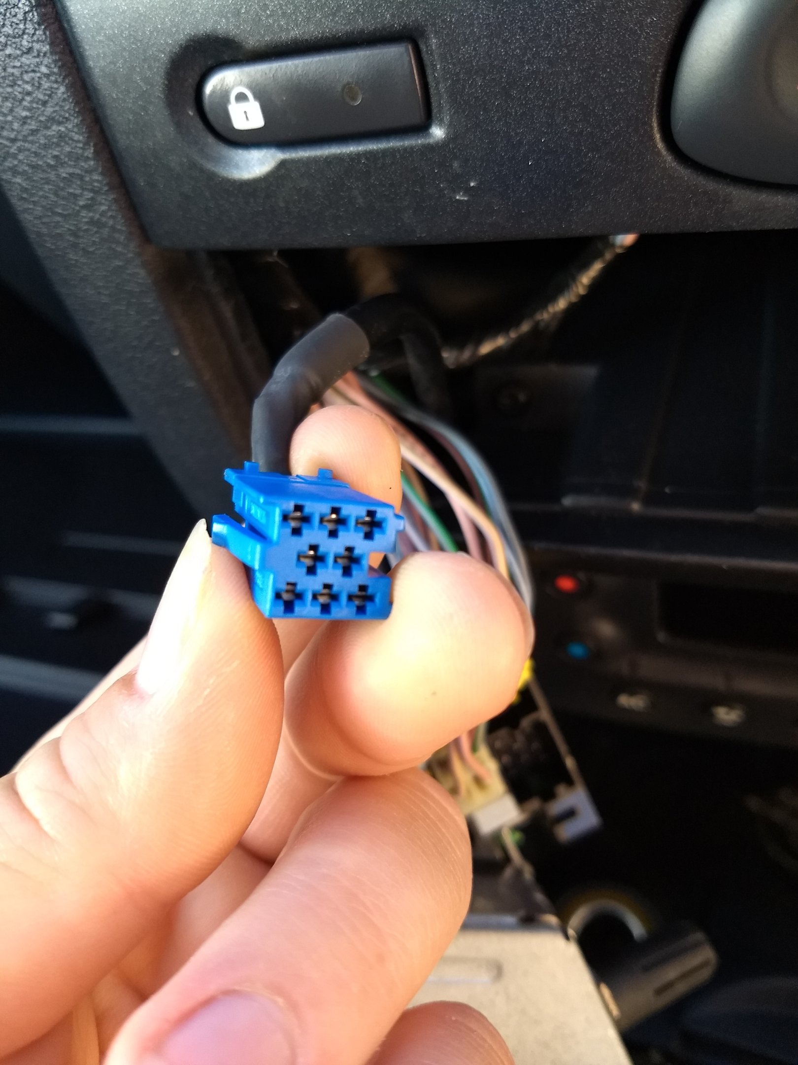

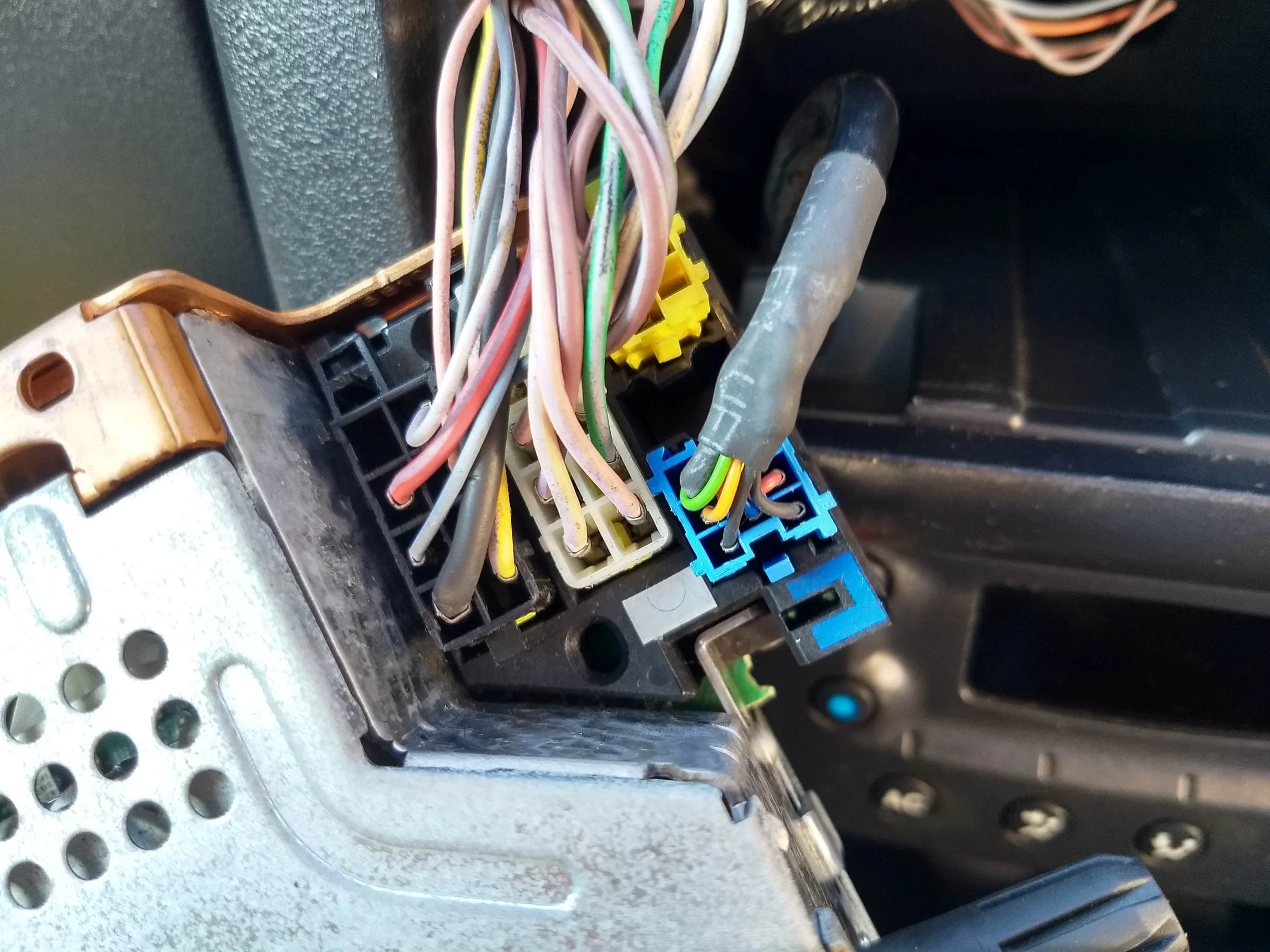

I pulled mine out of the dash this morning to get the serial number so I could look up the code (which it accepted). It's a Tuner List headunit. Unfortunately the socket is populated with a blue plug. Does anyone know what this is for? And how I might fit an aux input to the headunit?

Iirc you clip a plug to that then plug them both in.
Check my mk3 aux in fitting guide for reference. I’m aware they’re different head units but it might give you an idea

It was a cabasse auditorium in mine.
Blue cable can be seen in the back from where i disconnected it)
FYI You can't run one of those aux cables, pretty sure they dont work in these.
You can instead get a connects2 box that has an aux on it. I personally had one that went to a 30pin ipod connector as you could then hide away an old ipod. You could also get a 30pin to aux adapter if you wanted, just allows best of both worlds.

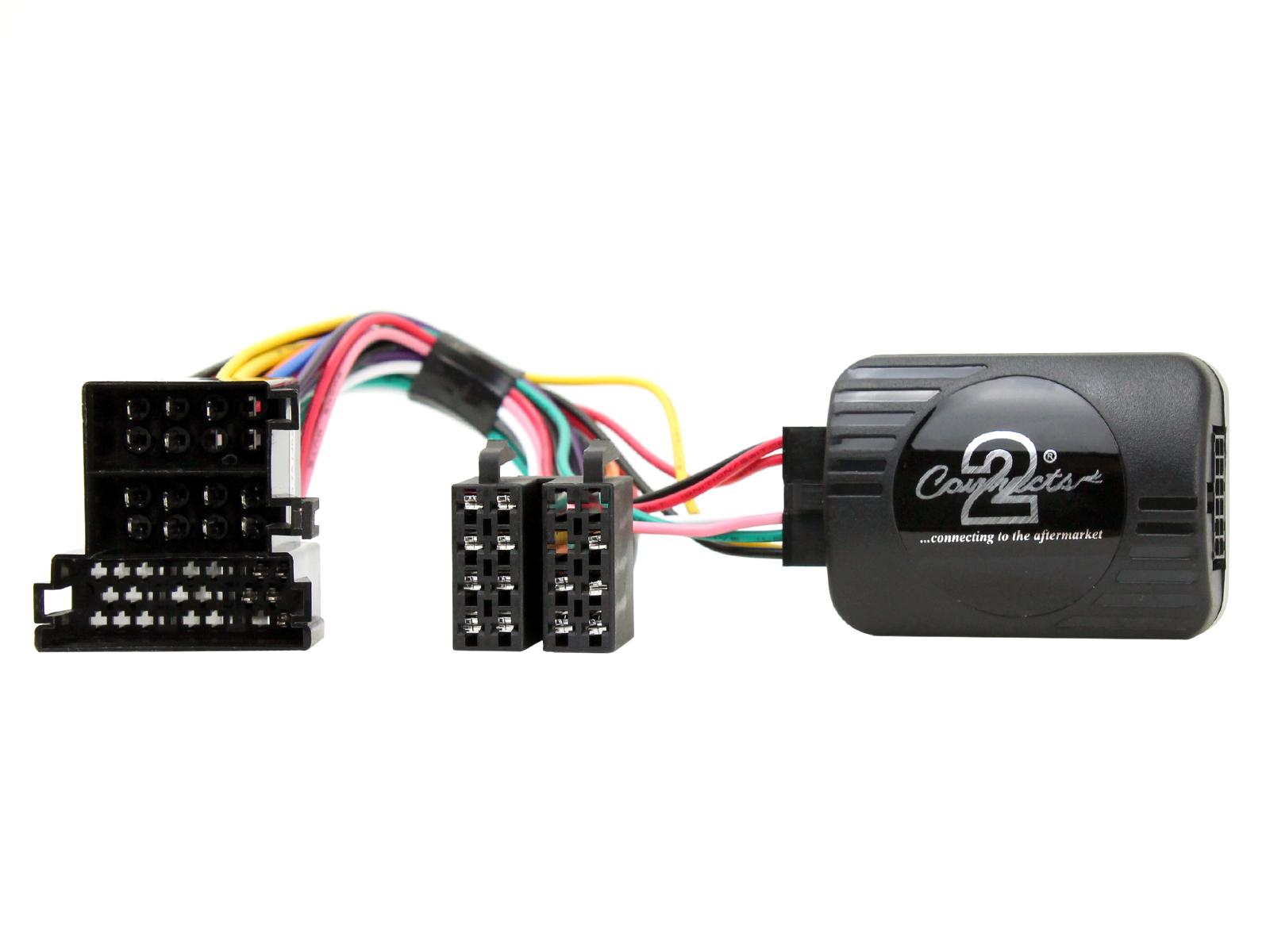

You can get a connects2 box for about £15 on here, they come up often.
(One here for auction, pretty cheap - should work just fine. Looks identical to the one i had)
https://www.ebay.co.uk/itm/CTSRN003-Stereo-Steering-Stalk-Control-Adapter-For-Renault-Clio-Kangoo-etc/123247043633?hash=item1cb218a431:g:AFcAAOSw~R1bR61Q&LH_All=1&_sacat=0&_nkw=connects2+clio&LH_ItemCondition=4&_from=R40&rt=nc
Connects 2 retains your steeering wheel controls too.

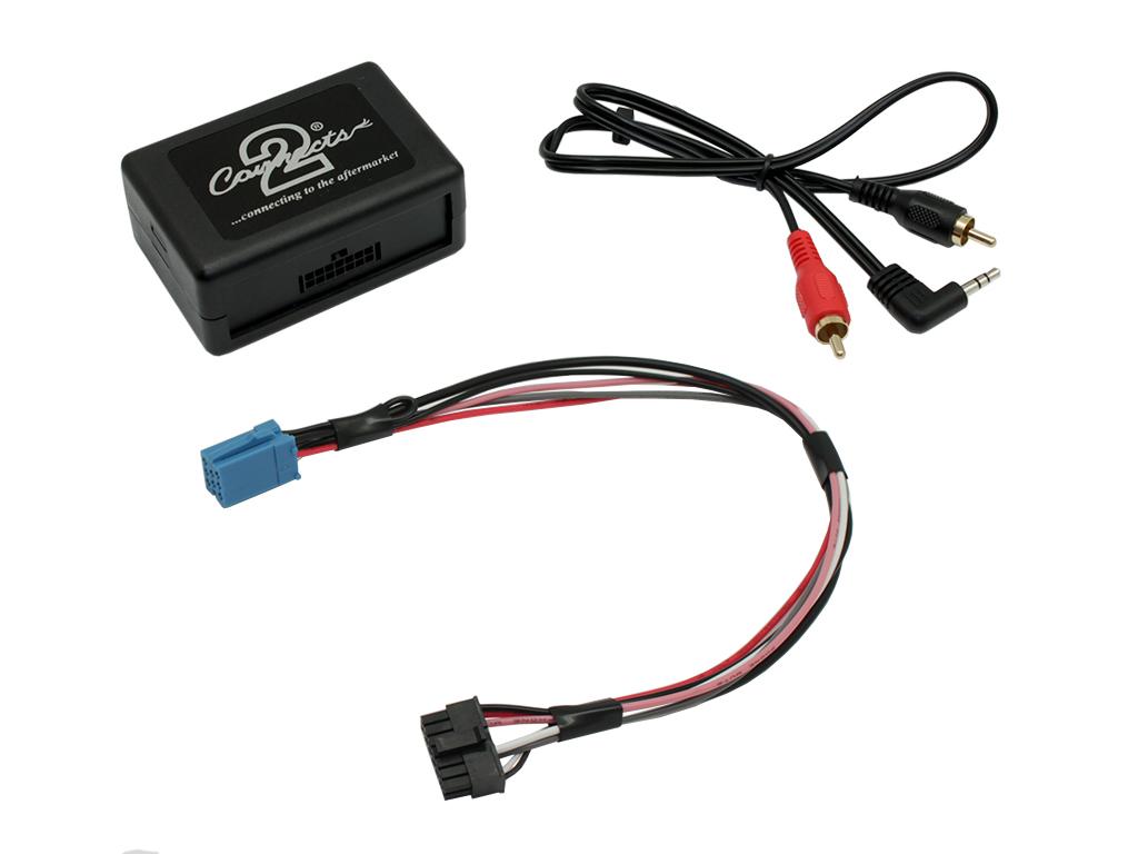

@Louis Ah so you get another cable to go from aux in (3.5mm jack) to the socket for the CD changer on that loom?
If you're running an aftermarket HU it most likely comes with an aux in.
If you're meaning with the connects 2, buy the one above and plug the blue connector into the place where that other blue connector is, then buy this - https://www.ebay.co.uk/itm/30-Pin-Male-Cable-Stereo-3-5MM-AUX-input-To-iPod-iPhone-Dock-Connector-Adapter/232136398413?hash=item360c68564d:g:y9oAAOSwT6pVuILo&_sacat=0&_nkw=30+pin+to+aux&_from=R40&rt=nc&_trksid=p2380057.m570.l1313.TR12.TRC2.A0.H0.X30+pin+to+au.TRS0
You can't use cd's after fitting the connects2.
@Louis This is the adaptor for adding an aux in to the existing headunit I believe, 3.5mm jack on one end and the CD changer style plug on the other with an interface box
http://www.connects2.co.uk/Product/ProductItem/CTVRNX001
Whereas this one allows for the fitment of an aftermarket headunit whilst keeping the steering wheel controls
http://www.connects2.co.uk/Product/ProductItem/CTSRN003

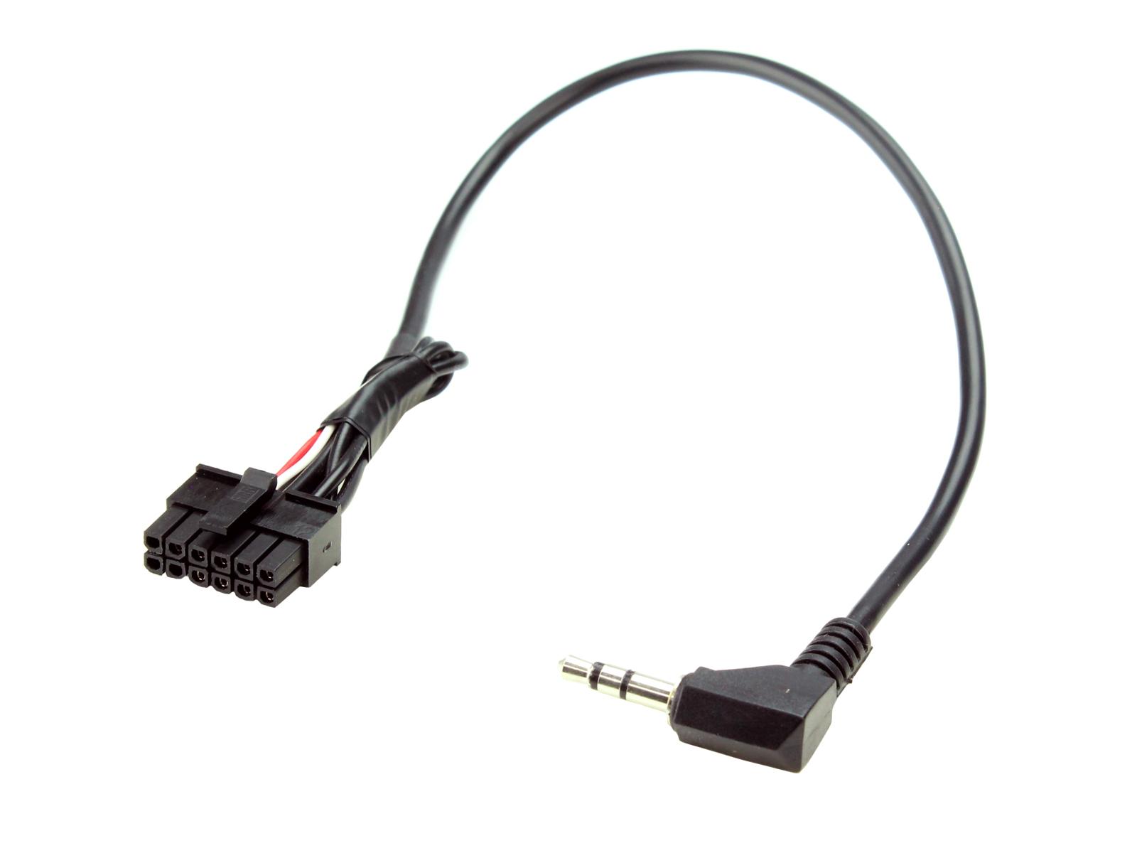

http://www.connects2.co.uk/Product/ProductItem/CTPIONEERLEAD (for pioneer headunits)
The one you linked me to doesnt have a blue plug?
And I've no idea where you'd use the 30 pin aux cable as it doesnt match any of the connectors on the factory headunit or the connects2....
I'm not following, sorry.
So as far as I see it, I have two options, either add an aux in to the existing headunit, or install an aftermarket headunit.
To install aux on the existing one, I need CTVRNX001 which plugs in in lieu of the CD changer (blue blug), and allows me to input a signal from a 3.5mm jack? Everything else stays the same, as it's the factory headunit.
To install an aftermarket stereo, I need CTSRN003 (The one you linked) which takes all connectors from the rear of the factory HU and provides a standard ISO plug. If I wish to retain the steering wheel controls then I also need CTPIONEERLEAD . With this I get my aux in as its a feature of the aftermarkey HU, and retain the steering wheel controls but not the dash display?

The ipod adapter i'm talking about is just CTVRNX001 but with a different plug in. (CTARNIPOD003) So you see on that one it has a cable for aux with 2 rca inputs, the other one i'm talking about has a cable for ipod 30 pin cable and no rca input. This means you can run an ipod and also use an adapter (30 pin to aux) to use aux. But if you're not bothered about ever using an ipod just buy CTVRNX001
